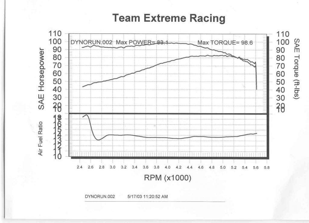

I have another dyno chart somewhere and the AFR is pretty flat at 13.5 to one upto 5500rpms

Hi Brant, I think I didn't explain well or the meaning in my post is mis-understood. The D-Jet curve I'd like to match is the end of the HP curve, where it looks at the moment mines dropping off early. The AFR of the D-jet I'll never be able to match as the car would always want to run richer with carbs.
I'd like to see the AFR of a stock D-jet just for curiosity and to gain knowledge and understanding of the "benchmark" and also as a comparison to what happens to the AFR through the rev range when you fit carbs.
I agree totally that stock classic car engines (of all types) on modern fuels and with a good few miles under their belts often benefit from running a little richer than 40 years ago when they were new and running on older fuel types and blends.
Geoff,
If you have another graph with AFR trace that would be brilliant! Better to have your trace as it goes with the data you already posted so the best info we could have!
Thanks in advance

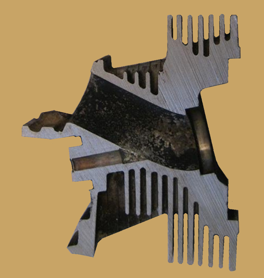

(aircooledtechguy pix),T4 exhaust,section thru studs.
The beauty of the DFI is the lack of cylinder wall washing by raw fuel,improving ring life.
Drill and tap a hole into the chambers,preheat and tig weld the barrel from the chamber side.
Final drill and tap for the DFI injector,then,machine the head complete.
A dry flowing int port can be reshaped,without the unatomized fuel pooling out of suspension.

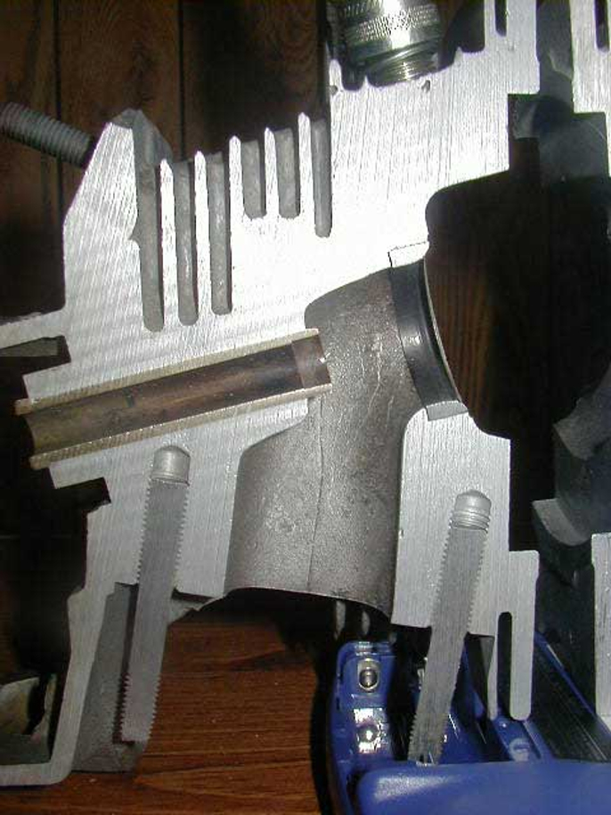

T4 intake,section thru valve guide and seat.
Good pix of the T4,T1 heads in sawn sections,as above.
http://www.thesamba.com/vw/forum/viewtopic.php?t=602256
Unlike the second plug proposal,a DFI install ought to enter the chamber from the intake,"fat"part of the chamber.

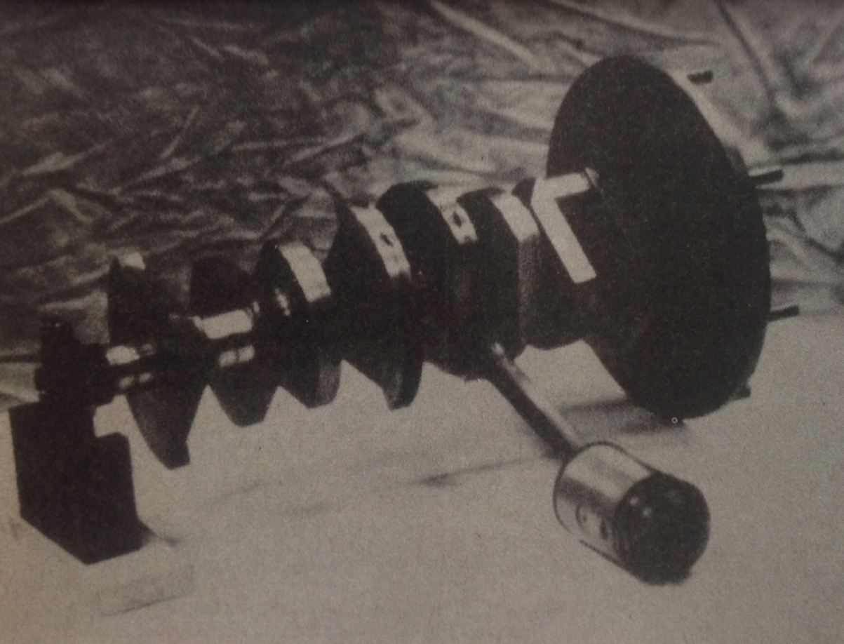

The main crankshaft with one(of four) rod and piston. The power is taken off this crankshaft while the top crankshaft operates the small top pistons to give favourable port openings. (Cars and Drivers)
https://primotipo.com/tag/bob-chamberlain/
Well,this '40s engine type would now be a viable proposition with the DFI tech available today.
Swinging the twincrank to beyond 12K,with fuel efficiency never before possible.
A moment cancelling design,smooth.
