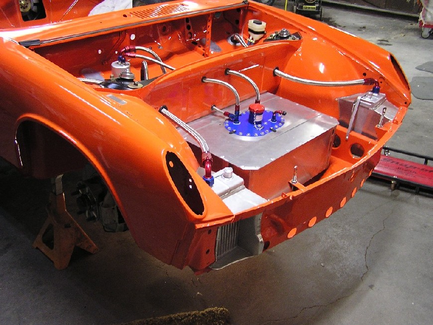

Jetsetsurfshop

QUOTE(Jetsetsurfshop @ Aug 8 2016, 02:16 PM) *
Perfect just what I had in mind! So looks like it's vented out in front of the tires, no problems with heat to brakes and tires? What oil coolers did you use?

maf914
post Aug 8 2016, 03:44 PM
Not a Guru!
Posts: 3,049
Joined: 30-April 03
From: Central Florida
Member No.: 632
QUOTE(wes @ Aug 8 2016, 01:21 PM) *
The orange 914 with the dual oil coolers belongs to Brant who posted a build thread some time ago. Great thread and a beautiful car. See the link below for more photos of the oil cooler installation. Impressive.

The setup in the orange car (post#4) eliminates room for the head lights.
OK for a race car 914, no so great for a highway driven 914 (post#1).

Realy amazed at the Orange car and thought at first it was my answer but yes after looking at the amazing build tread realized the race car had no need for headlights. Not giving up on the idea though hoping to see photos from Cairo94507. Wonder if it's possible to tunnel the air back from that location to another and exit out.
