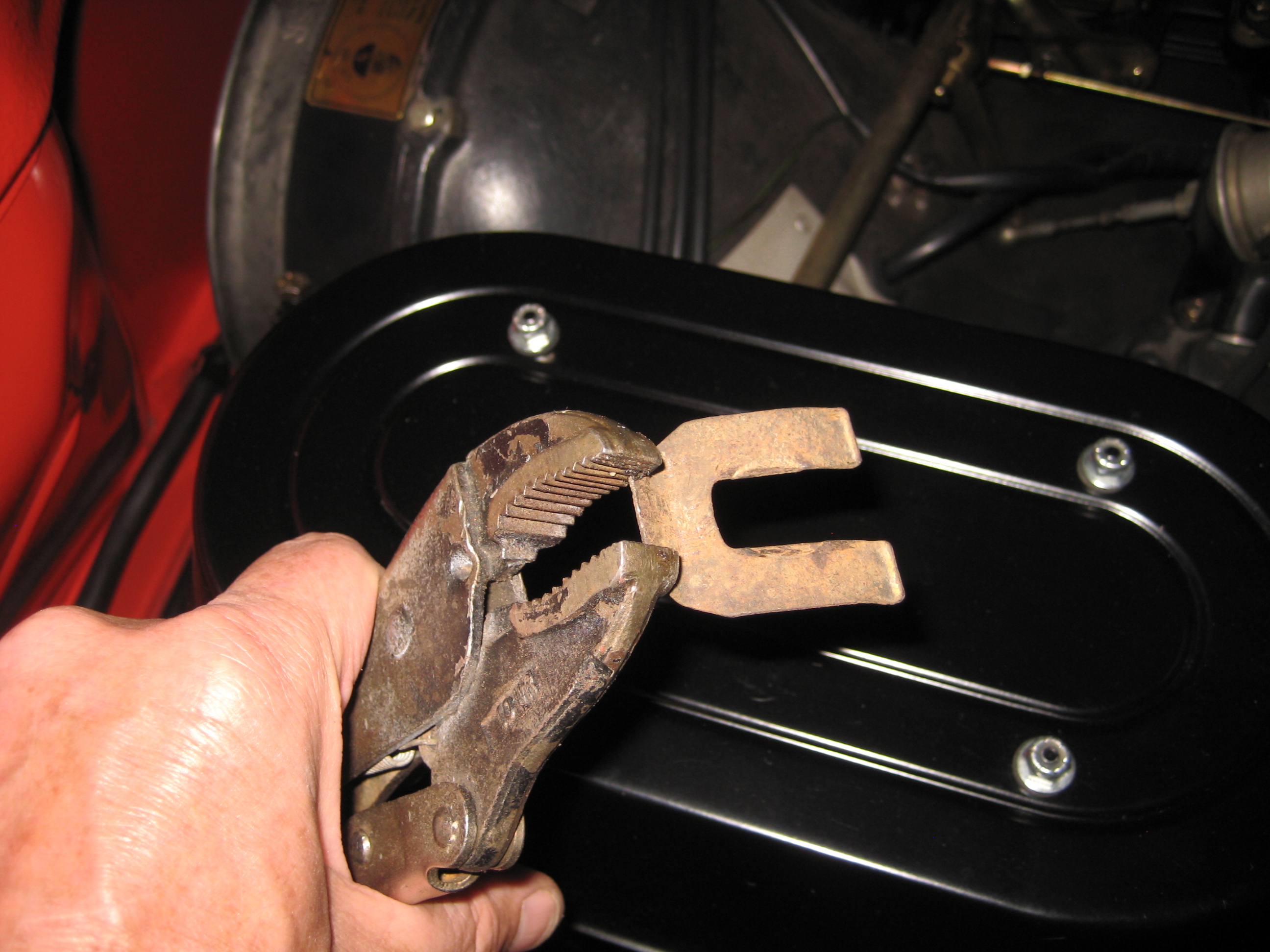

Try using a vise grip as shown in the photo.
Rotate it and pull at the same time, not too forceful. Use some WD40 and as soon as you can see a small opening in the clip use a flat screwdriver to lever the clip off.

Doing the other side, I hit on the "best" way so far. It is pretty easy, even in the tight confines to cock the retainer left or right so that the unreachable side sticks out from behind the mounting flange.....
(IMG:http://www.914world.com/bbs2/uploads_offsite/i723.photobucket.com-14731-1474827617.1.jpg)
once you accomplish this, you can "walk" the retainer out using a flat screwdriver on each side as the retainer peeks out side to side. Out in 15 seconds. Time to find it after it flew out about 1 minute!

I just completed this hose replacement, the '75 model year was a very good example without crud/rusting/etc. The "C" clip was the hardest part of the job and I was not bale to grab it across as shown, but was able to grab it by the 1/8" or so and wiggle it loose. If working on a crusty example I would suggest to saturate the clip upper side a day or so ahead of time
