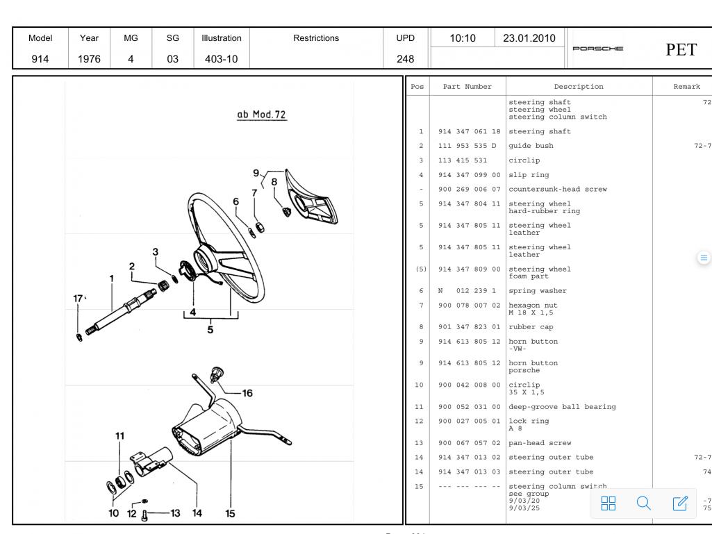

I think I'm missing the outer bearing. That seems to be easily sourced(?) Will the '73 /4 steering column shaft fit into this? It would allow me to use the later wheel which seems to be more available. Also, the lower circle, any body have/source those? The one that holds the inner bearing in?
This is all that came in the box.... (IMG:style_emoticons/default/confused24.gif)
Here's where I'm at so far, and I'm just going to use that early switch because I don't care so much about originality and which key it uses. Will the /6 plastic bezel screw onto my early switch? Anybody?
The lower bearing is held in place with "C" clips. The upper bearing that you have already installed has a slight interference fit. I believe that the steering wheel fits in there and removed all of the play. I believe the lower bearing is the same between 914/914/6 and 911.

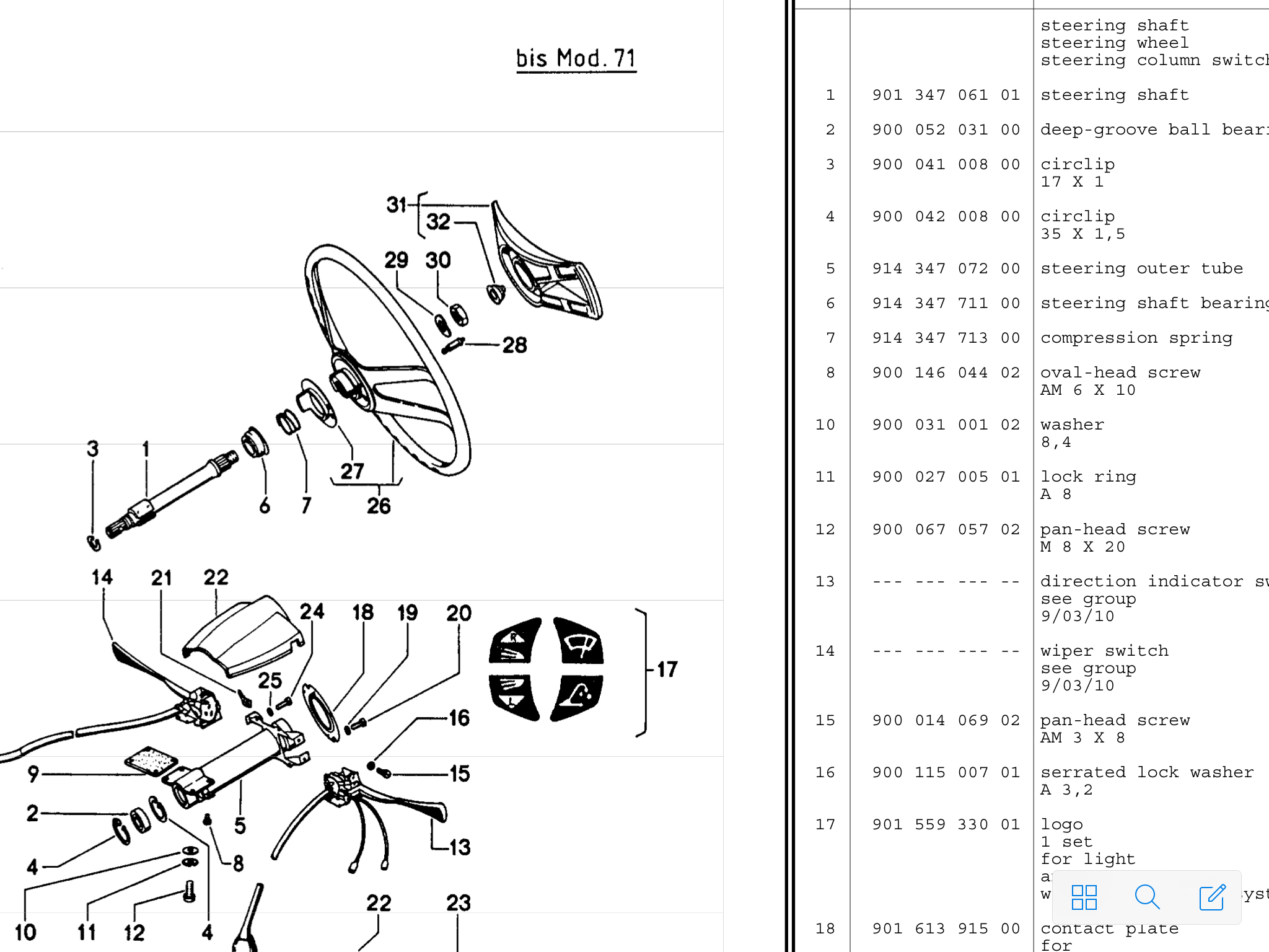

Lawrence, circlips are availiable from OPC, stoddard etc
I don't get the 35x1.5 dim, could swear the tube is bigger than that, should be cheap as chips if you can find a non Porsche source
Positive the late -4 column uses the same clip
-4 column parts, same bearing

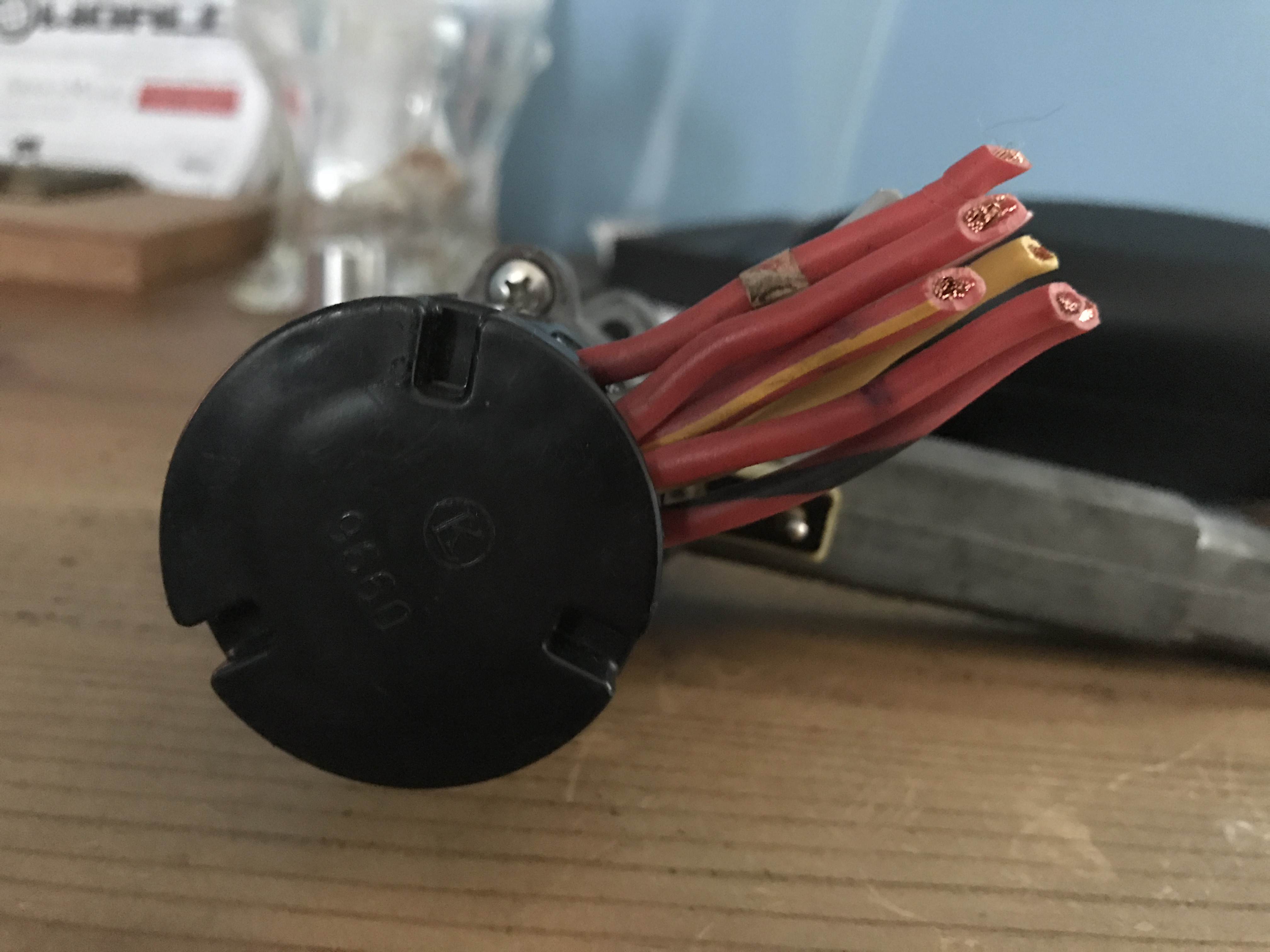

The electrical connections for the ignition switch and the wiper/turn signal stalks are obviously very different when converting to the 911 column.
Does anyone have a chart with the pinout locations?
Jeff B
I did a pin-out ID for the Ignition Switch; will take a pic and post later
Yes Please! That would be awesome! (IMG:style_emoticons/default/pray.gif)

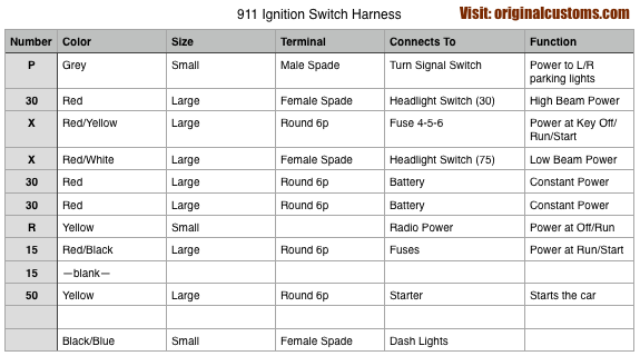

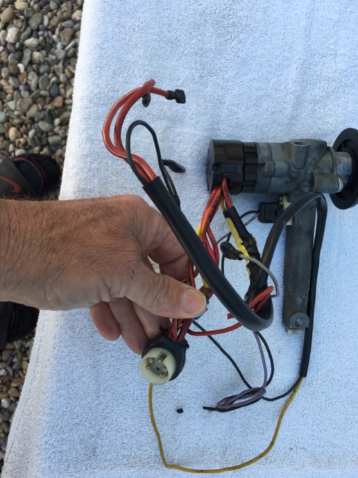

Traced out one of my 911 ignition harnesses today. I'll try to keep adding these one at a time cause it's a tedious process. Next time I'll add to this spreadsheet showing where these wires would go on a 914.
