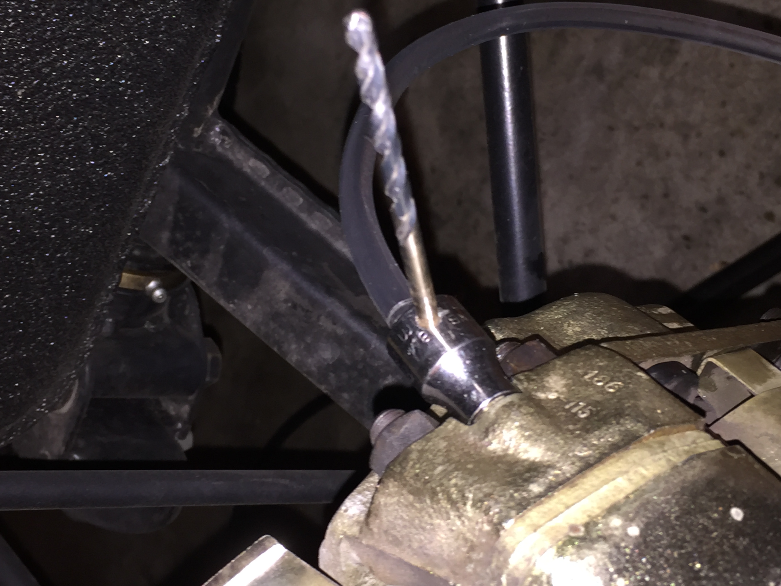

A few days back I was having difficulty working the bleeder screws on the front. I tried to find a thin bodied 8mm box wrench but nothing locally. So tonight I took a socket and drilled a hole in the side so I could twist it and drilled out most of the insides so my plastic tube had room to expand around the bleeder nipple.

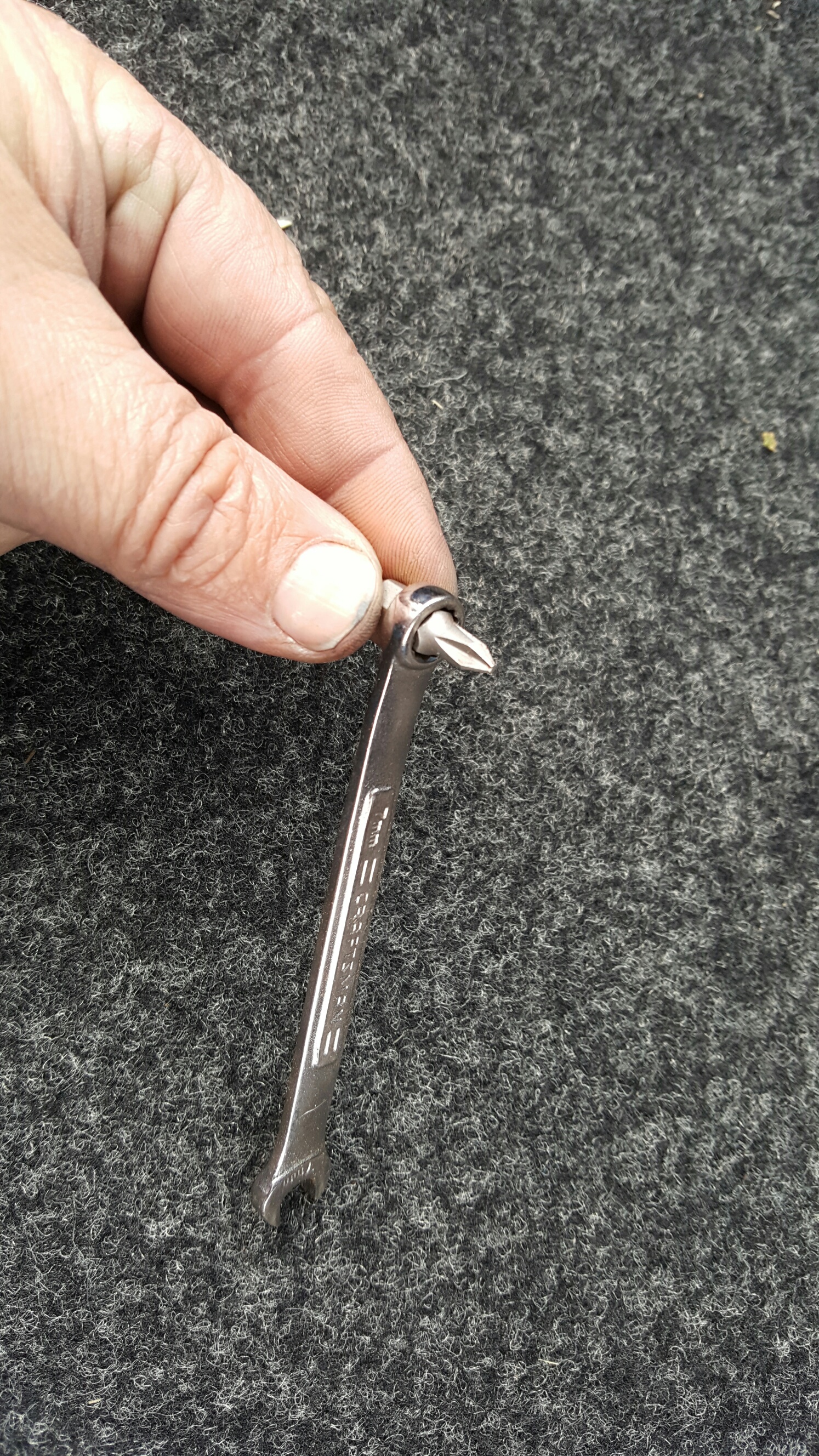

I made a new tool for taking the covers off the light assemblies (to get the inside screw next to the turn signal bump.
The little ball holds it in the wrench nicely.

QUOTE(matthepcat @ Nov 29 2016, 11:02 PM) *
Two words.
Speed bleeders.
They are speed bleeders. That's why I don't have room for a wrench

QUOTE(Mikey914 @ Nov 29 2016, 11:30 PM) *
Clever but that tool is already available with a ratcheting handle. I use mine to do the same thing. (IMG:style_emoticons/default/beerchug.gif)

QUOTE(76-914 @ Nov 30 2016, 08:55 AM) *
Actually couldn't find mine, just plain lazy.

youll cut your finger with that thing ,a Christmas story
Oreillys bleeder wrench is 6 dollars....
http://www.oreillyauto.com/site/c/detail/P...=bleeder+wrench
Billy great solution in a pinch, (IMG:style_emoticons/default/beerchug.gif)

Thats to easy for Billy, everythings gotta be tuff to solve (IMG:style_emoticons/default/lol-2.gif) I just went to the tool box... (IMG:style_emoticons/default/biggrin.gif)
