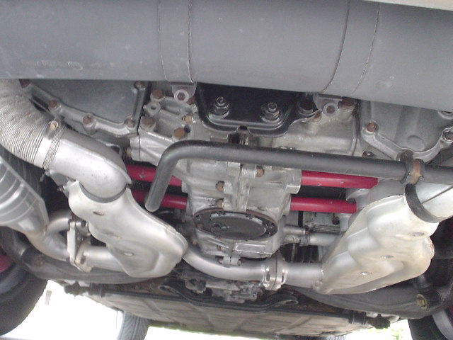

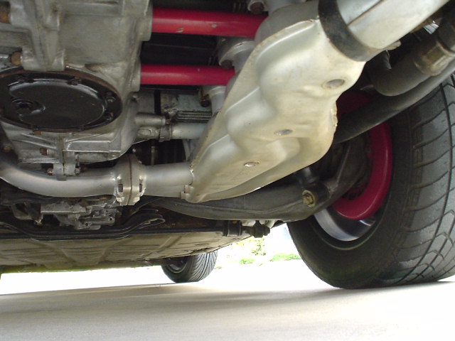

Lucky9146   I don't know if you considered it but I cerami...   May 4 2017, 03:21 PM
Tom_T   For those looking for a PC or Ceramic option close...   May 4 2017, 03:52 PM
horizontally-opposed   You might try West Coast Powder at 925 682-4828. I...   May 4 2017, 04:55 PM
mb911   Look up cerakote. Its a ceramic paint and is high ...   May 5 2017, 05:25 AM
Jett   :) I used stoddard grey on my 1.7 muffler and cera...   May 5 2017, 08:31 AM
