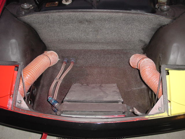

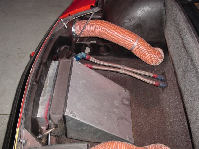

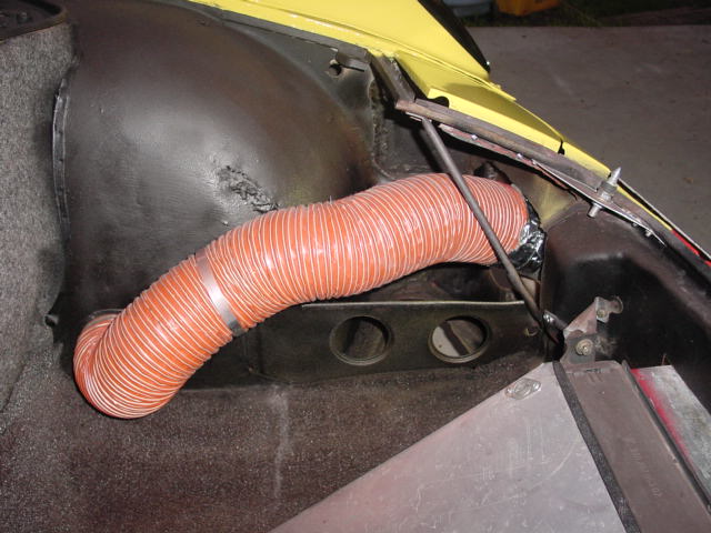

You've seen us run auto-x's with the old 628. We also ran that car HARD (2 drivers) at DE's and Time Trials. We never had brake fade....
Fronts: 911T vented discs and calipers
Rears: 944 S vented discs and calipers
You lose the parking brake.
Fluid: ATE Superblue
Pads: Porterfield R4's (race compound, not street)
Adjustable Brake Prop: Yes (I ran it wide open most of the time but at Sears Point I would dial in more bias. It would feel better under hard braking).
I like the air venting to the front brakes. We put in vents and never had a fade issue.
The Porterfields worked fine for Auto-x or track. The car was dedicated to racing. Not street legal.
Here are some pics of our vents.....
Bill P.

pic 2

pic 3
