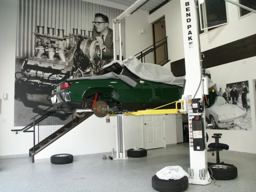

QUOTE(DamonsCarrera @ Mar 22 2017, 04:46 PM) *
I've always had good experience with Bendpak. They are a little more expensive, but not unreasonable compared to Rotary, etc. They seem very well made compared to some other brands. And they have great customer service. They will even paint to order.
-Damon
My OCD is pleased with this photo....

QUOTE(TM_Corey @ Mar 22 2017, 04:49 PM) *
-Damon
Lol... (IMG:style_emoticons/default/agree.gif)

QUOTE(TM_Corey @ Mar 22 2017, 07:49 PM) *
My OCD is bothered by the lack of appropriate oil stain under the car, but the real issue is my envy is off the scale!
