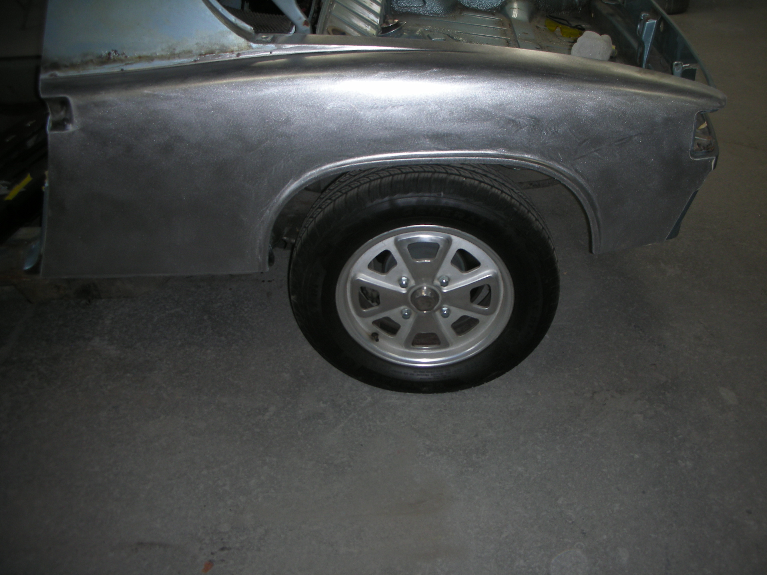

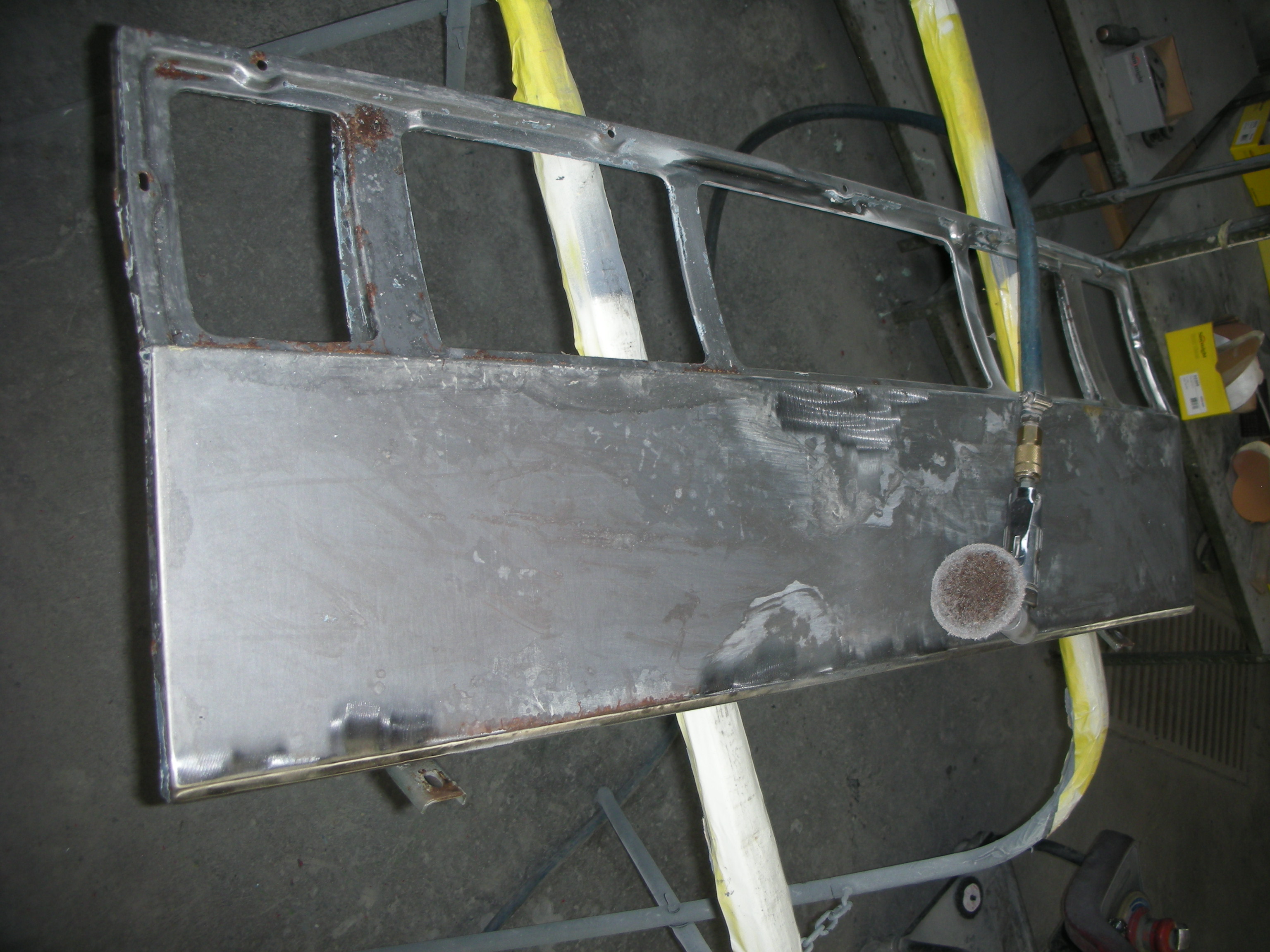

Still moving along on schedule.
Doors and Trunk lids are already done up with Primer. Body work starts in earnest on Monday.

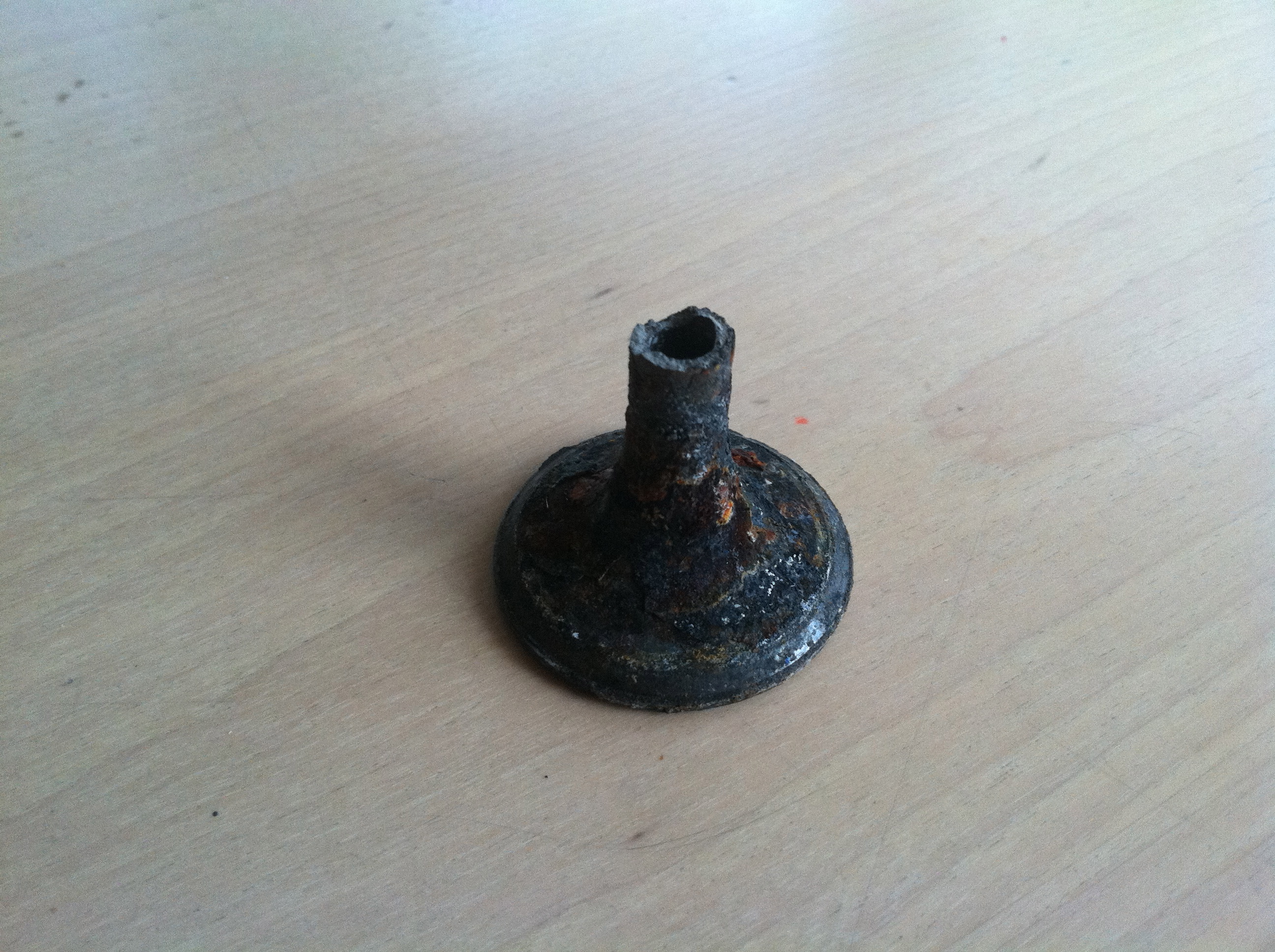

DO NOT re-use 40 year old sodium filled exhaust valves disaster waiting to happen !
This is what happened as I was dis-assembling my 2L head, just tapped valve stem with mallet to insure stems not frozen in guides when spring popped loose.
914-300Hemi
