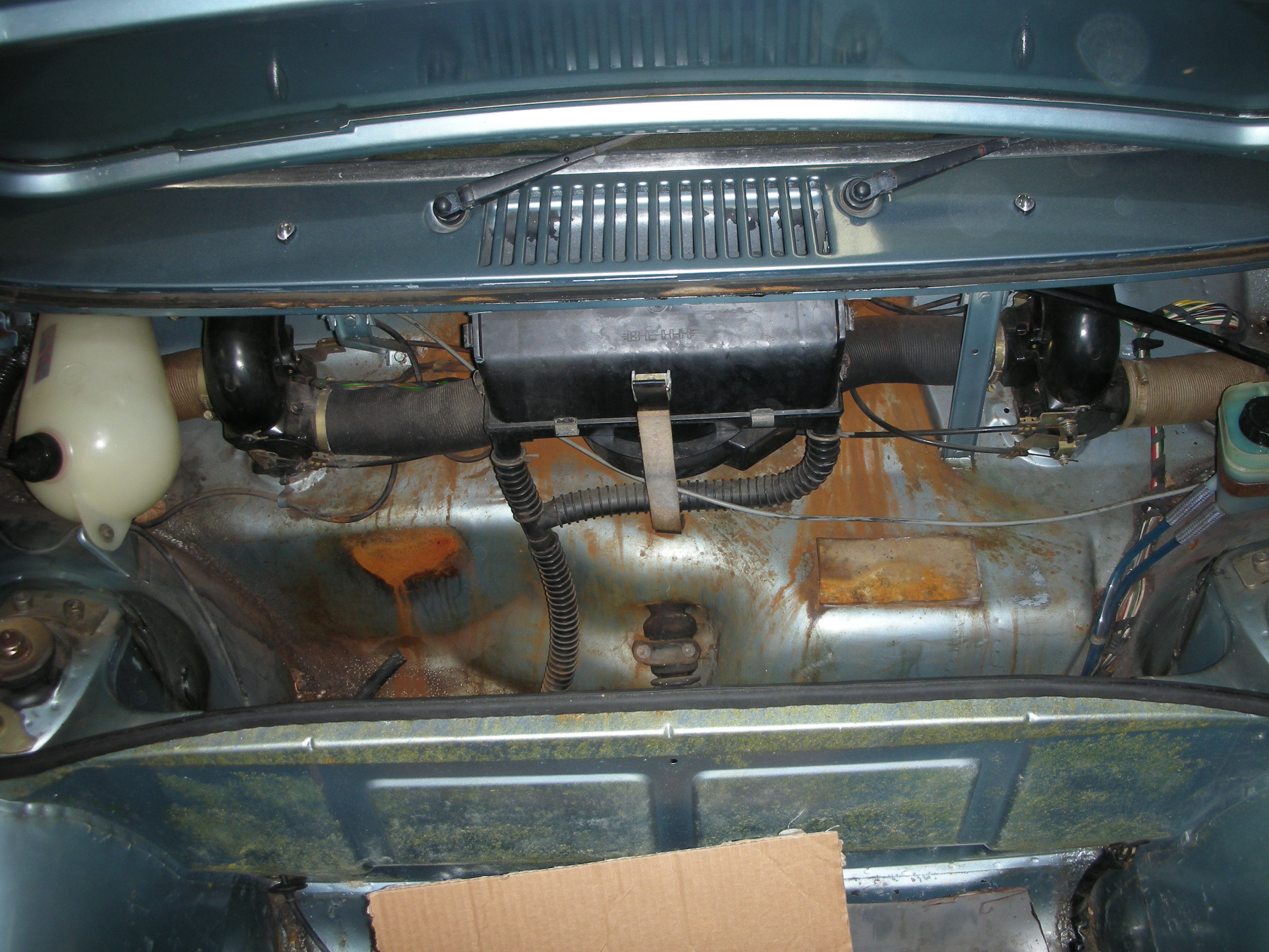

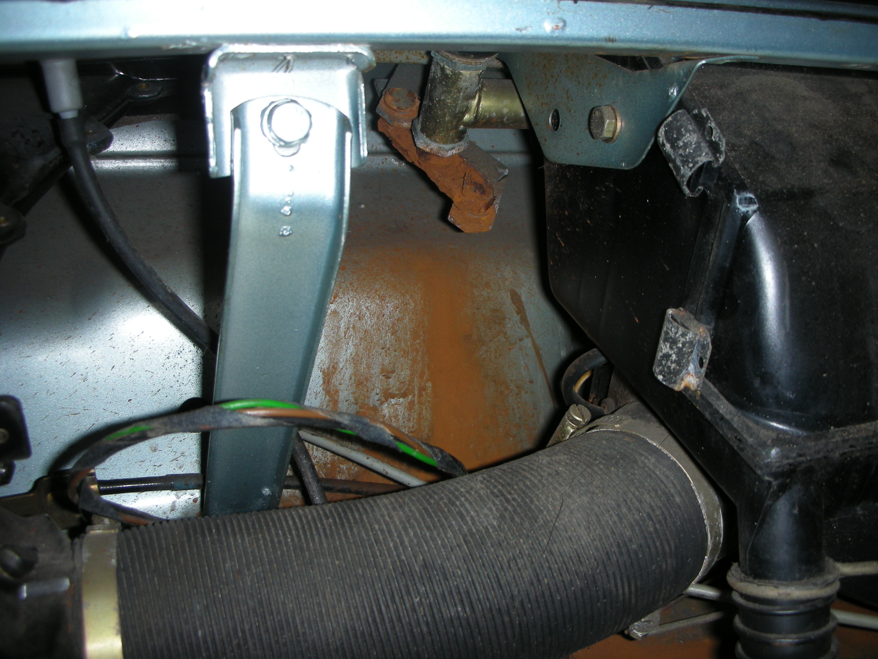

Calvinator2016   Not all is perfect however. Here are pics of the ...   Apr 21 2017, 08:28 PM

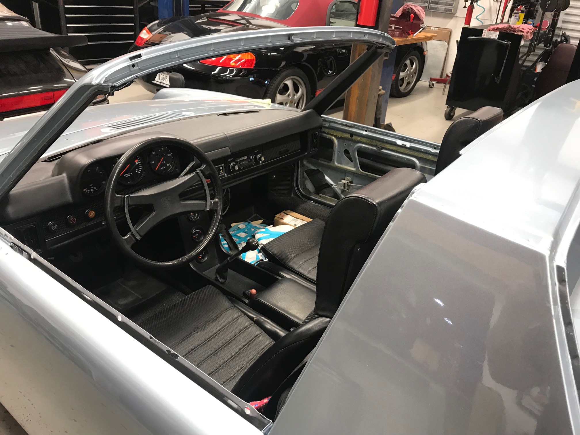

914 7T3   Today the awesome audio set-up was torn out. Car ...   Oct 2 2017, 06:23 PM
914 7T3   Engine, tranny, exhaust and gas tank removed. ...   Oct 6 2017, 10:20 PM
914 7T3   Interior stripped, off to paint! Thanks to Si...   Oct 7 2017, 01:47 PM
