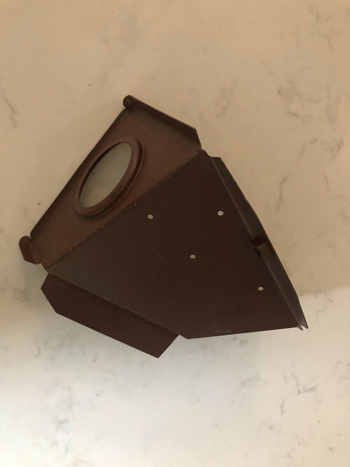

All the rain tray fitment issues stem from the fact that the battery tray is bolted to the quarter panel incorrectly. Tired of this oversight from the first go round so decided to source a NOS tray and support to be welded in and painted. Not the correct way to do it after the drivetrain was reinstalled and mechanicals dialed it, but it is what it is.
