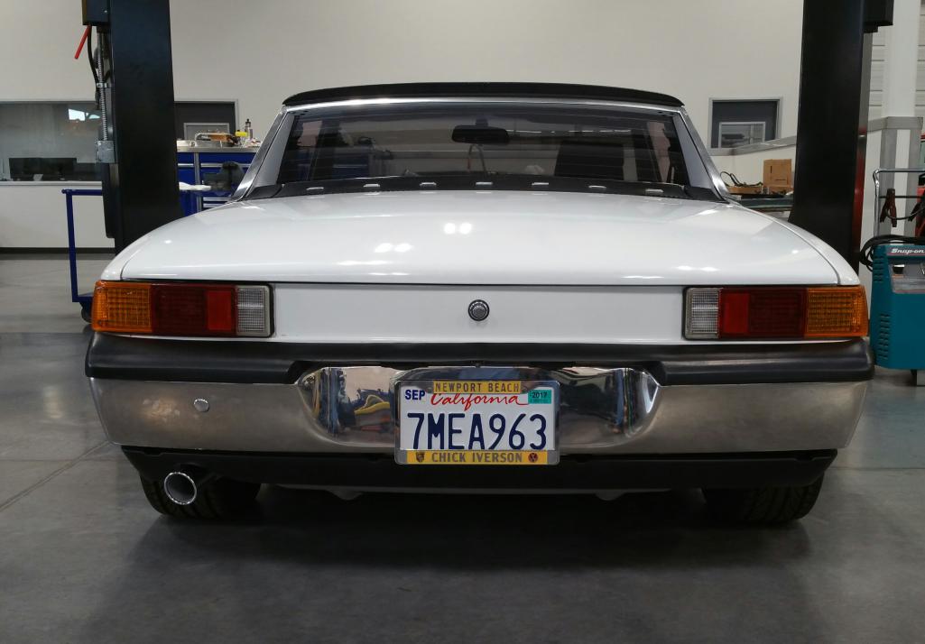

Purchased a stock 1.8 two years ago, car found in Suprise Arz.
Two part process beginning with full brake, suspension upgrade and back date bumpers, work done by PMS

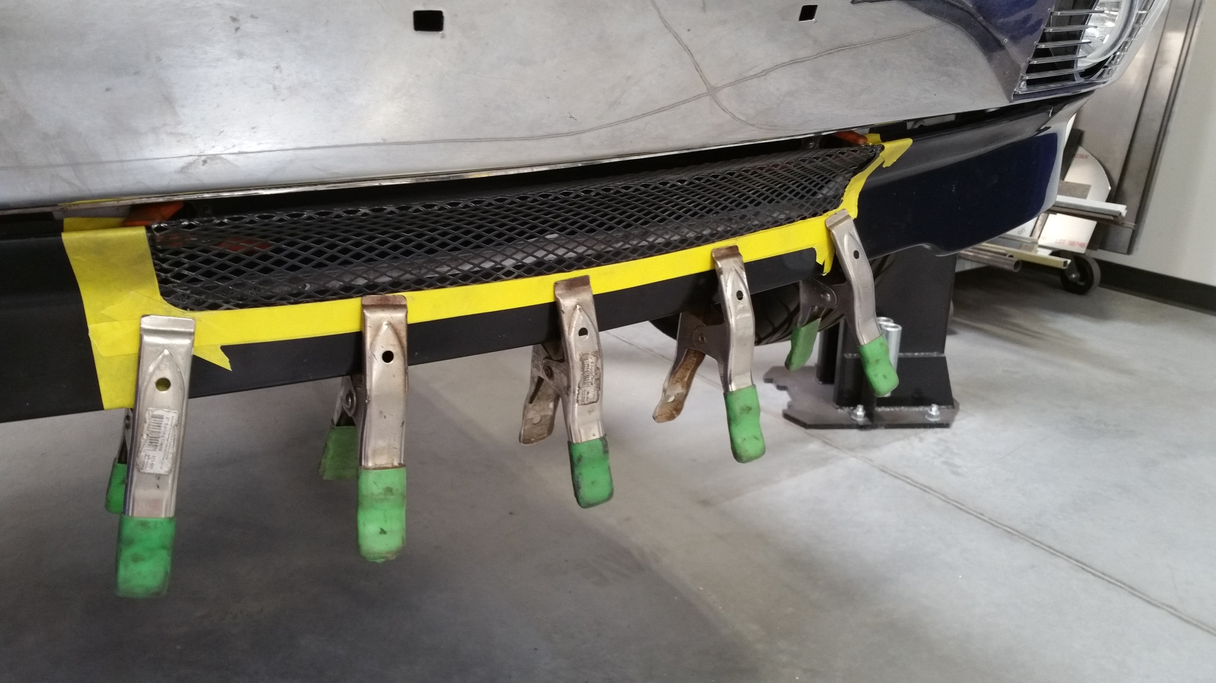

Coondog   Work done for the GT Cooler   May 5 2017, 08:08 PM

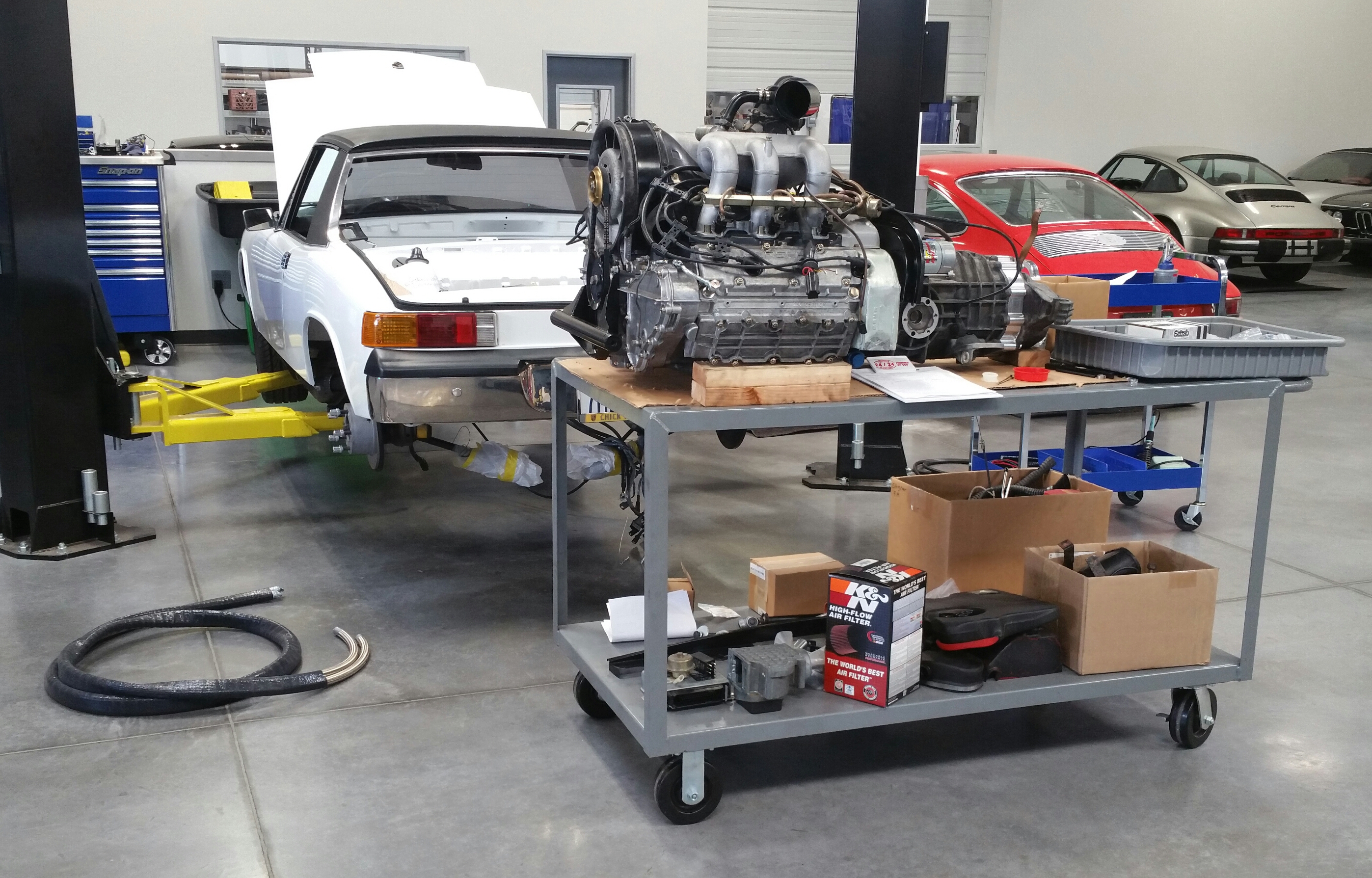

Coondog   Engine done   May 13 2017, 07:03 AM

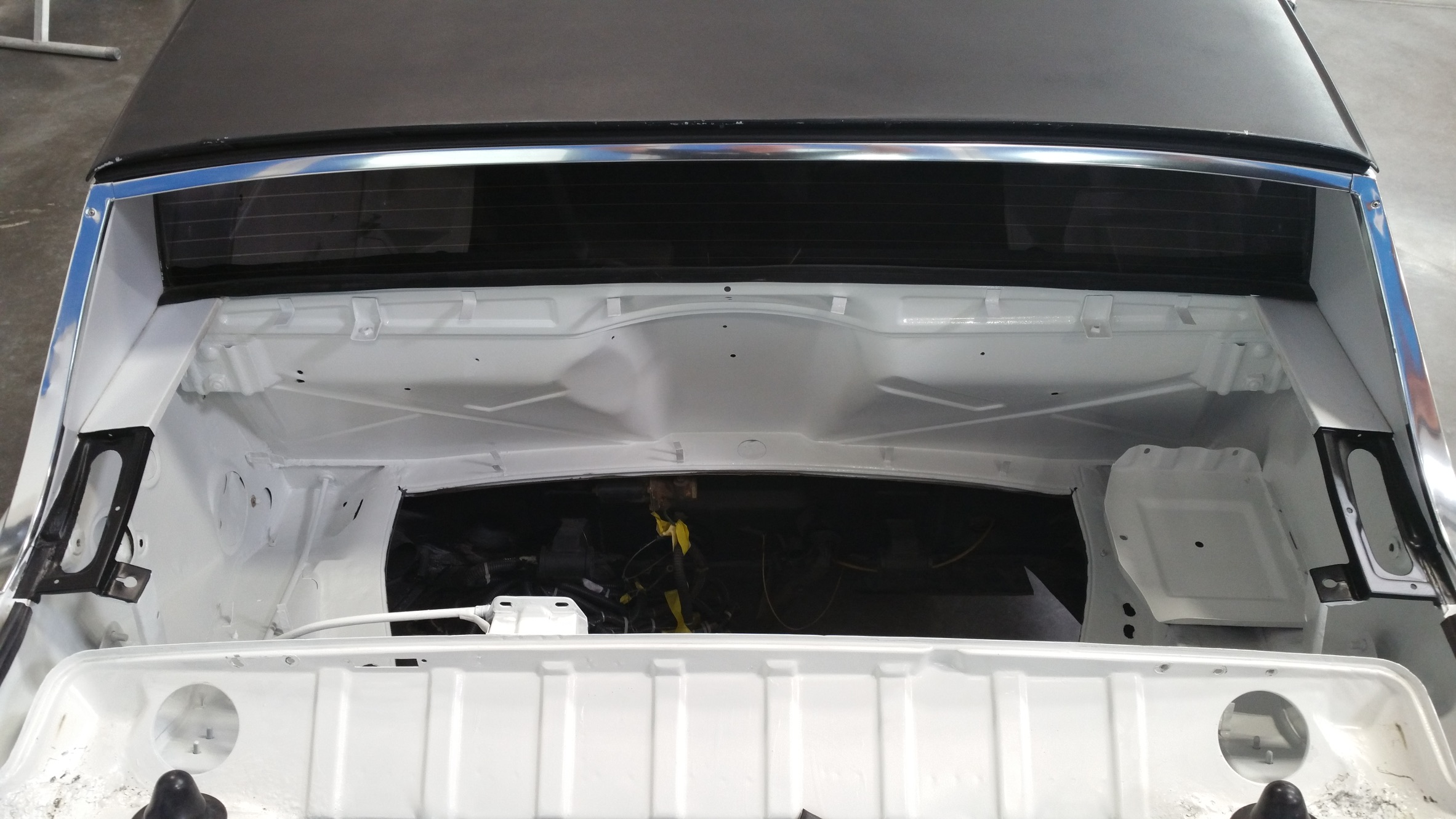

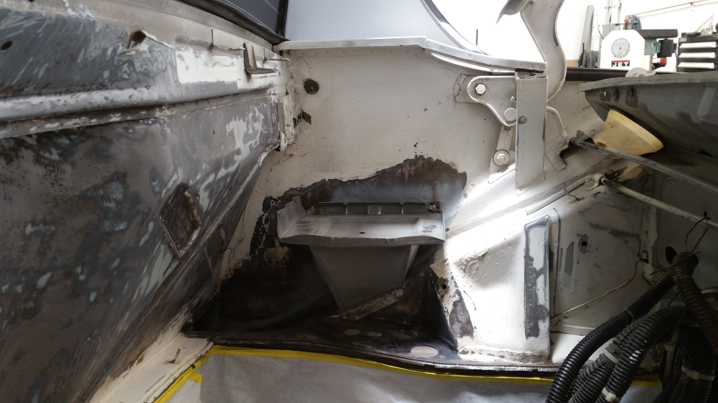

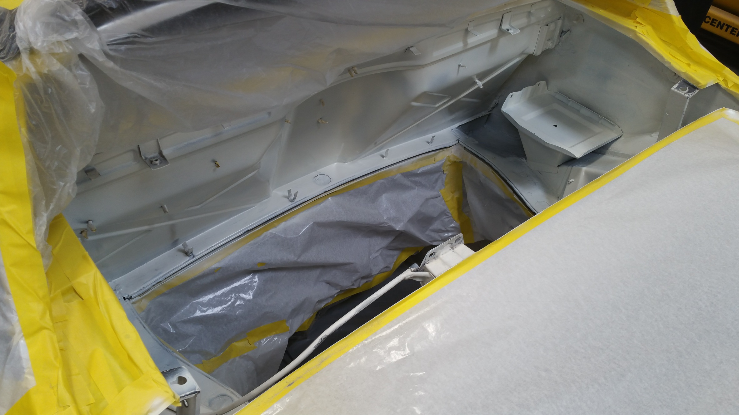

Coondog   Rust repair around battery tray done.   May 17 2017, 09:14 AM
Coondog   Primer put down, getting closer.   May 20 2017, 03:46 PM

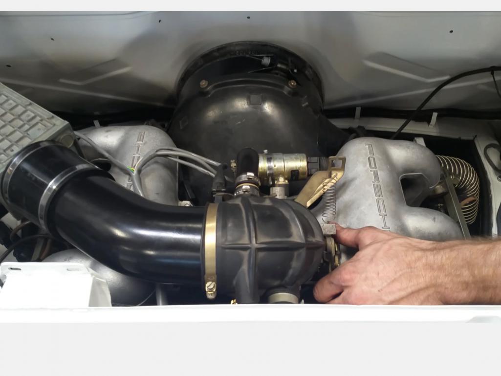

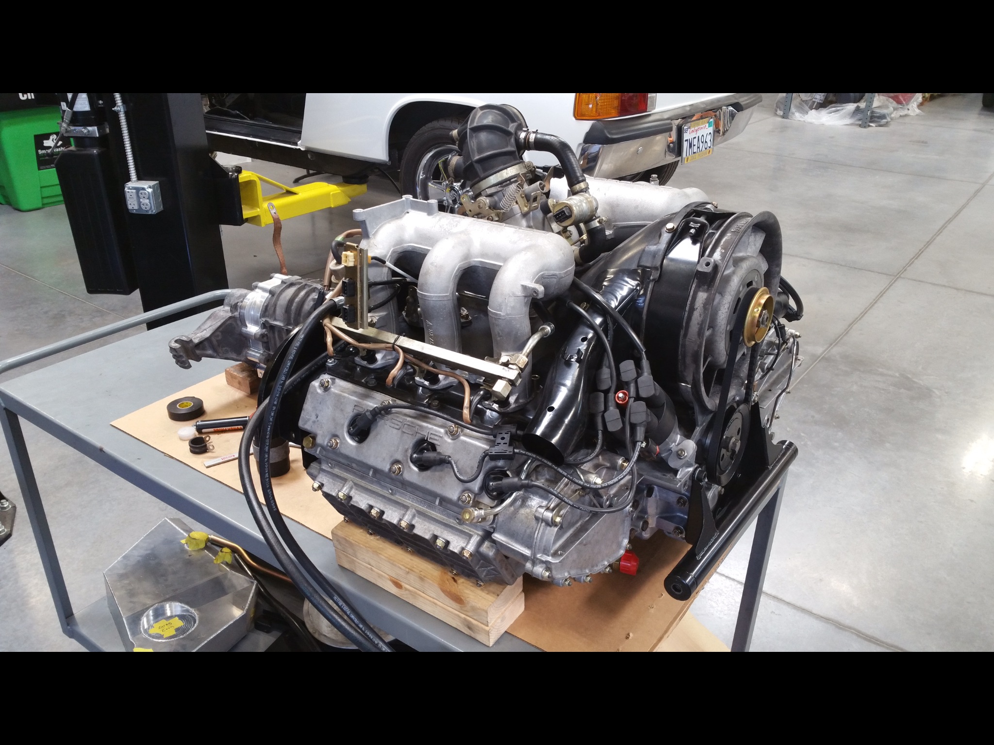

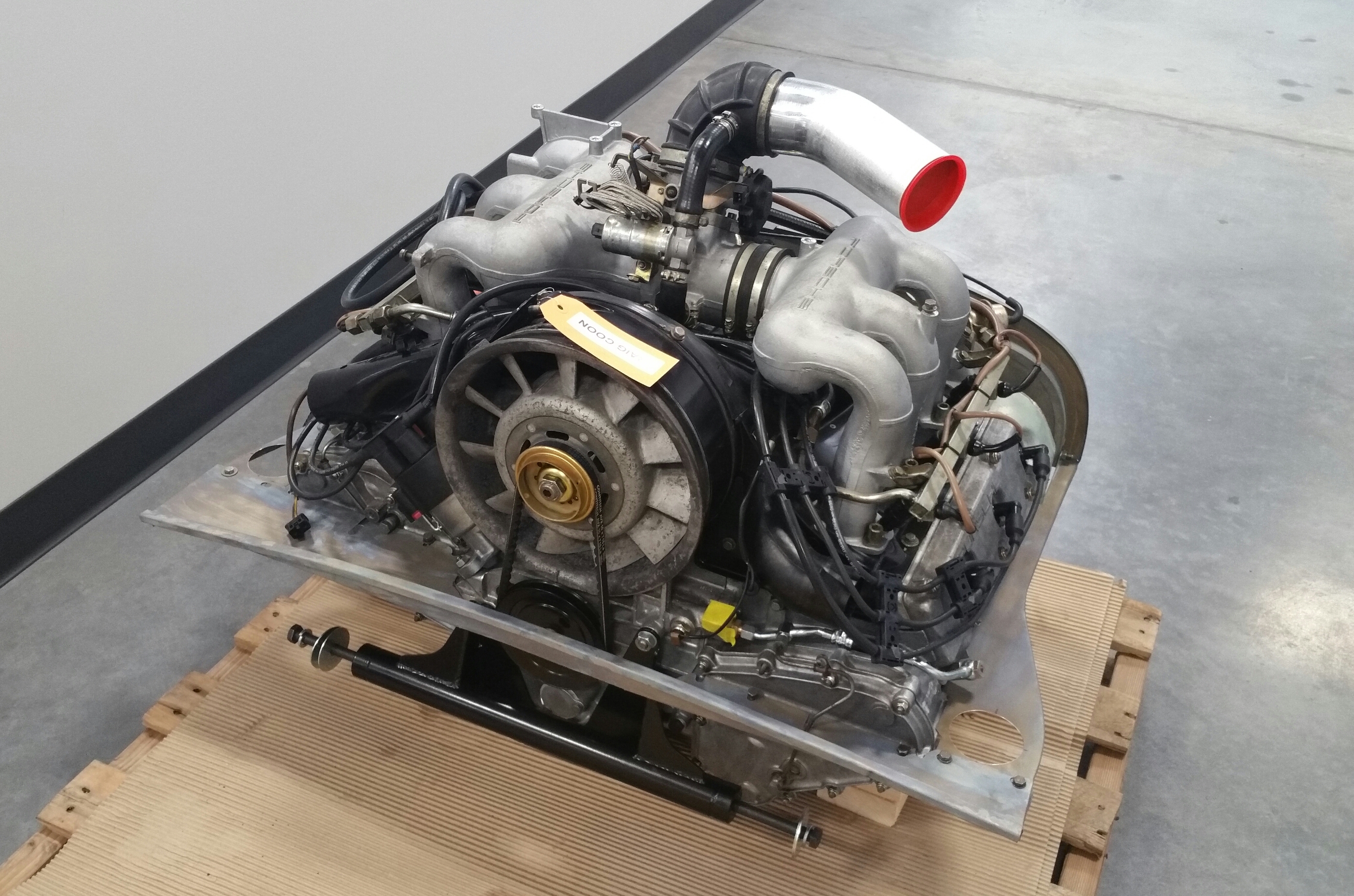

Coondog   Thanks to Perry my 3.2 motor is back in business. ...   Sep 6 2017, 03:06 PM
Coondog   More pics   Sep 7 2017, 08:16 PM

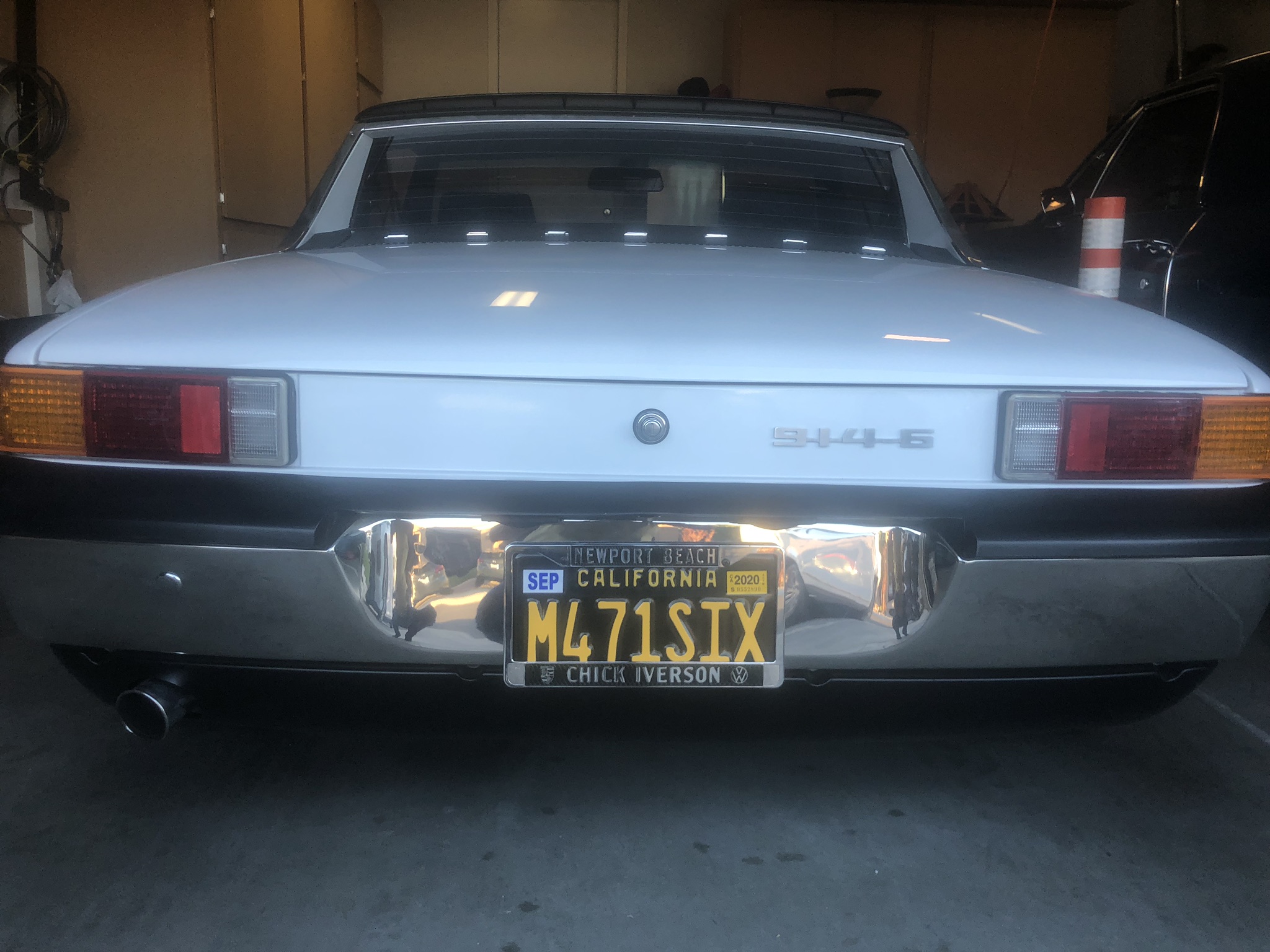

Coondog   Final tune and adjustment and this Patrick build i...   Oct 6 2017, 11:06 PM

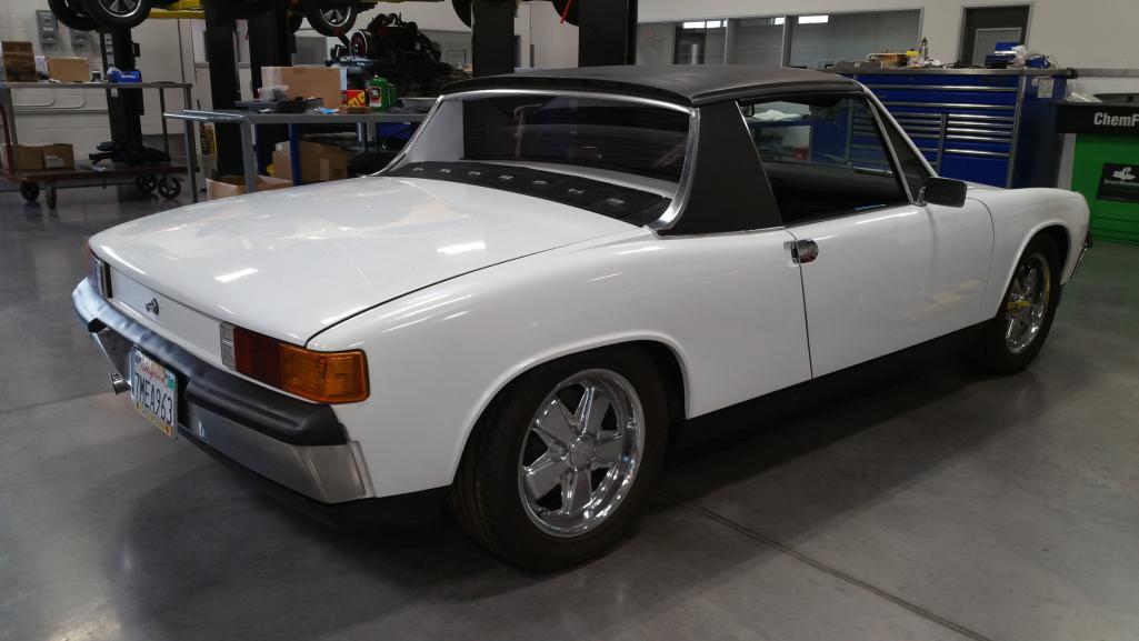

Coondog   Got a date set to pick my car up from PMS. Nov. 7t...   Oct 23 2017, 05:59 PM

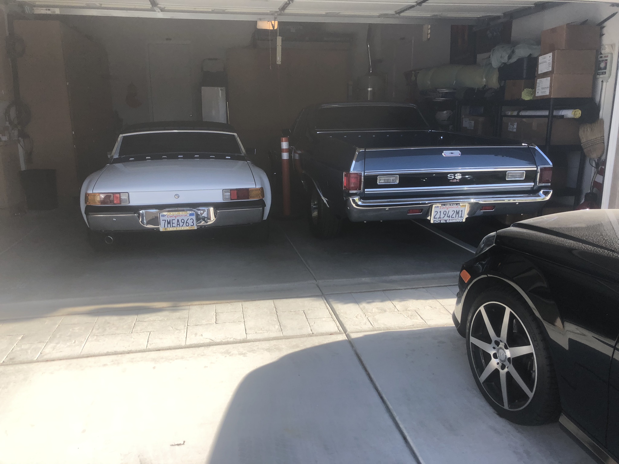

Coondog   Couple spoiler pics and underside.   Nov 12 2017, 12:39 PM

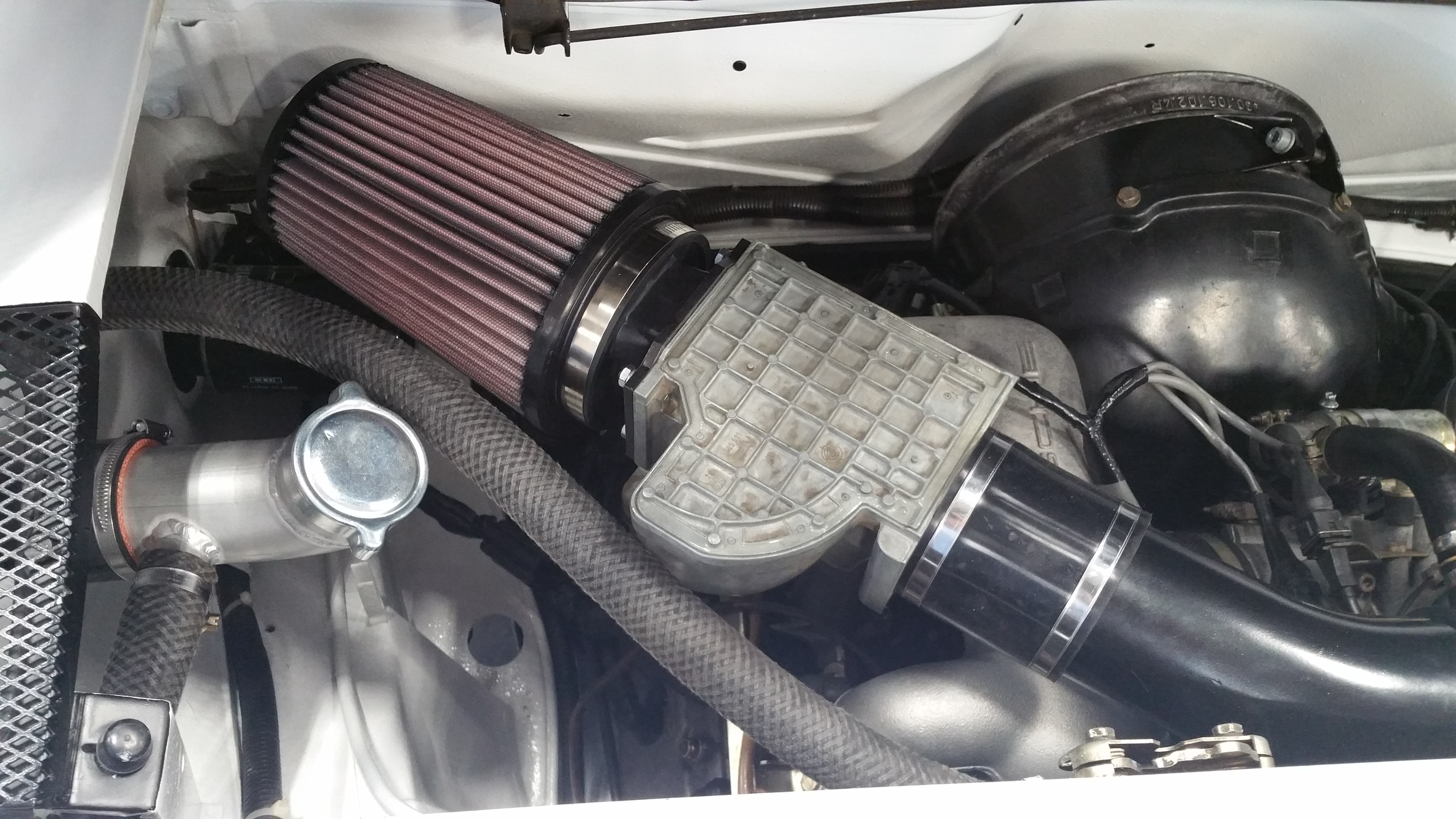

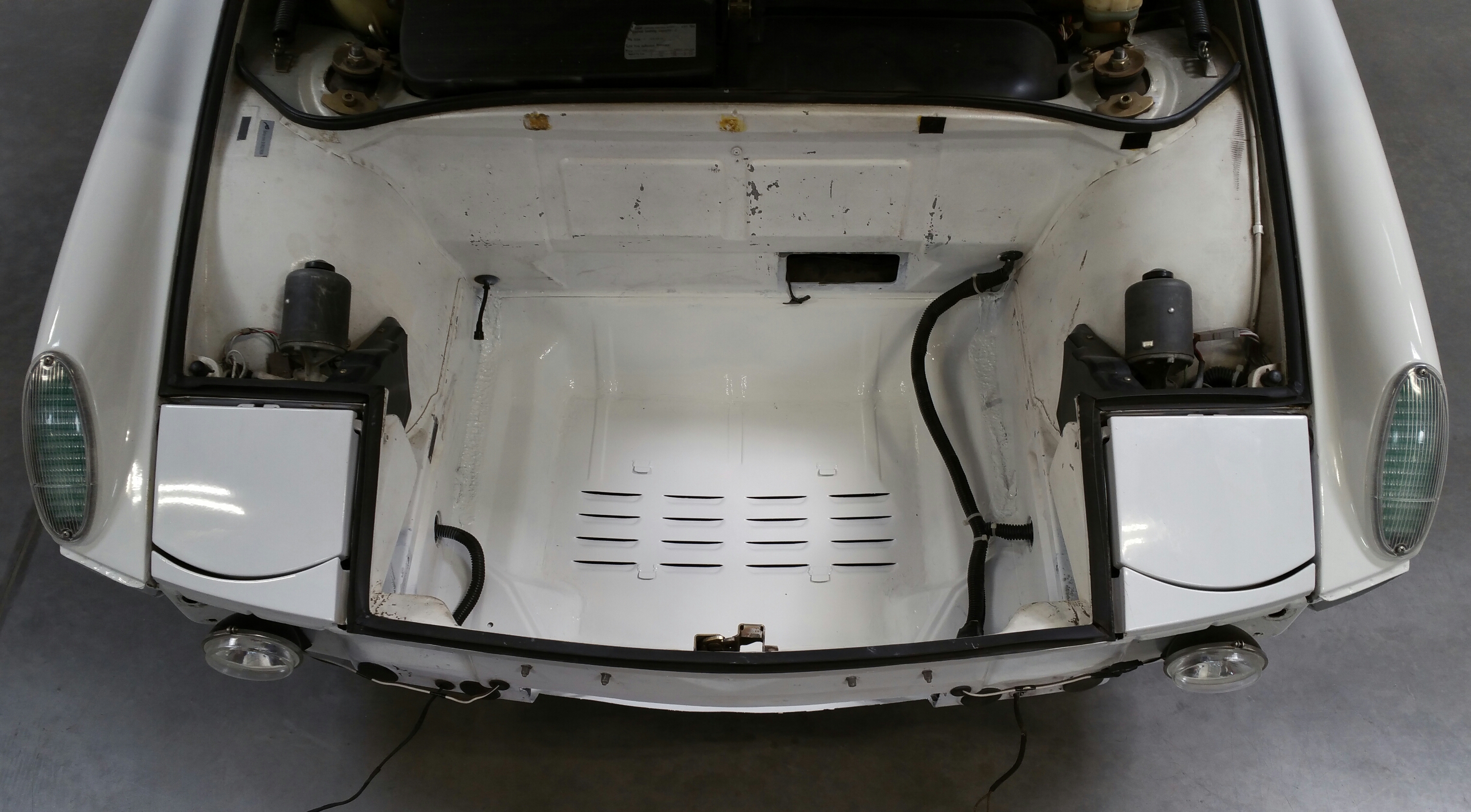

buck toenges   how are you planning to shield the air filter from...   Jan 18 2018, 01:24 PM
Coondog   how are you planning to shield the air filter fro...   Jan 18 2018, 05:36 PM

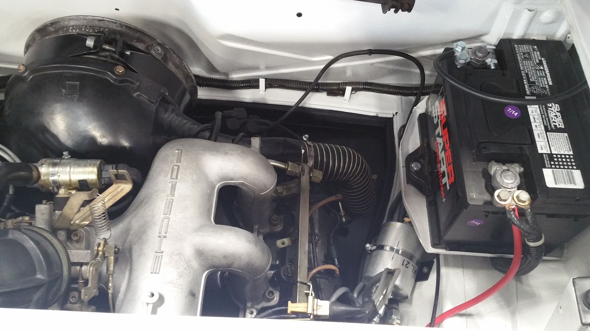

Coondog   Glued down the top half of the felt pad. Decided n...   Feb 3 2018, 03:33 PM
Coondog   Front trunk done, now just need to mount my Fire E...   Feb 28 2018, 05:05 PM
