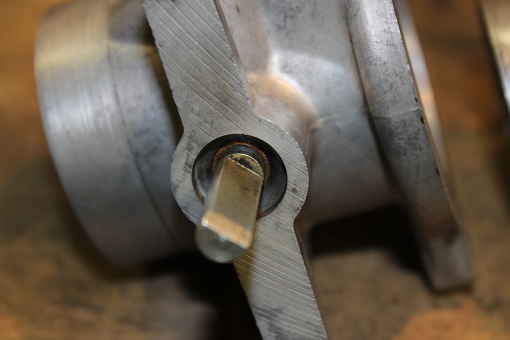

Installed the TB today set the TPS, Dwell and Idle.
Now I have to get used to not expecting the throttle initially sticking.
Thanks Mark
New bronze bushing
My attempt to grease the original throttle shaft a while ago
Top shot of the new throttle body

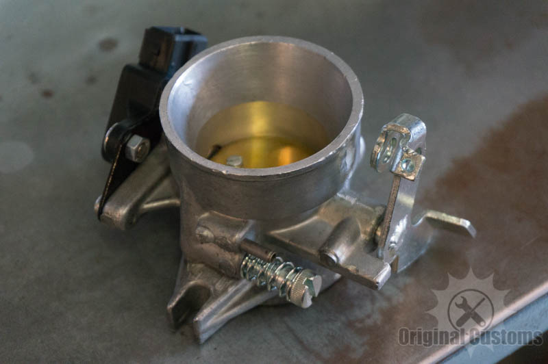

Got mine back a little while ago and finally took pictures. This'll be going on my 1.7 Turbo engine when I have time for that. I thought the part I sent in was in great shape. I didn't even think it really needed rebuilding...but what I got back was even better. (IMG:style_emoticons/default/drooley.gif)
Bottom line is that pretty much everyone needs this service. (IMG:style_emoticons/default/beerchug.gif)
Pictures- I sent my own parts for zinc plating, and the TPS is for my MicroSquirt setup.
