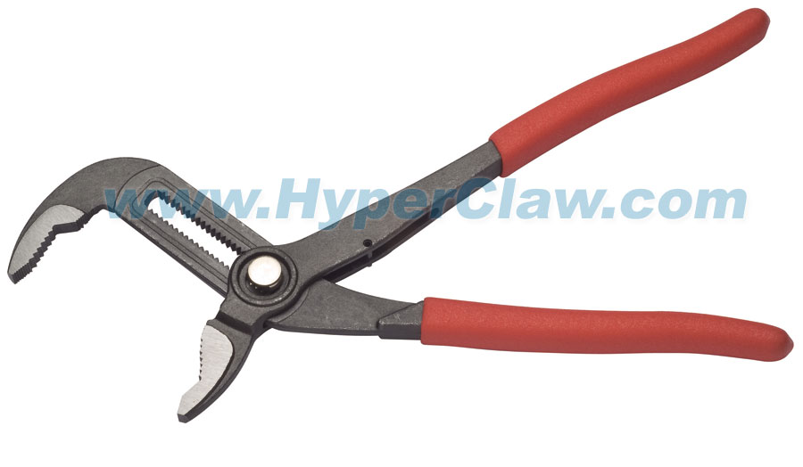

He's wondering about the ball joint from the control arm not the ball joint from the strut housing.
Without the tool, I did both of mine by using a pliers like these, or a pipe wrench. Either style with a breaker bar.
The design of this tool means that the harder you squeeze to loosen the bolt, the tighter the jaws get on the bolt.

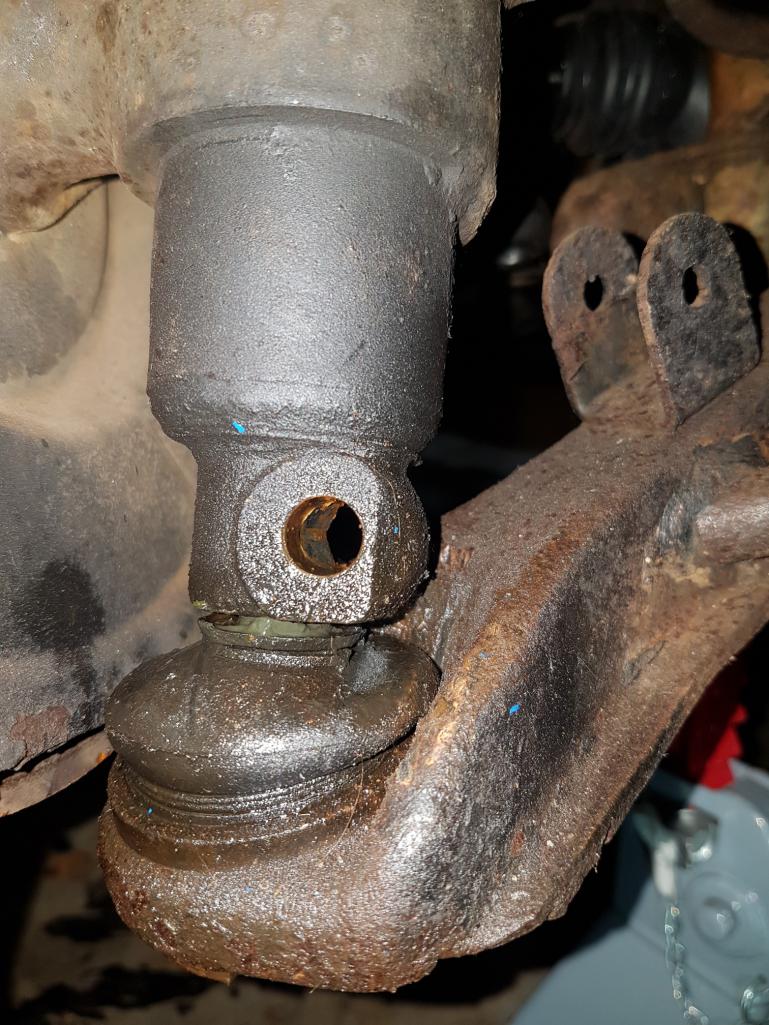

I wanted to ask for some tips or advice on this to avoid any damage!
I am trying to change my ball joints (73) which have rotted (rubber is cracked) Decided to buy the tool for the ball joint nut (Sir tool 4 pronged).
1. First off I've removed the cinch bolt from the base of the shock absorber but the ball joint pin seems firmly attached inside the base of the shock absorber/strut.
Can I heat that area to try and loosen it or does that risk damage to the shock/strut?
2. Is a pickle fork safe to use here, I'm concerned about damaging the control arm (not concerned about the ball jt as its going in the bin)
3. Is an impact driver best to remove the old balljoint nut (using the 4 pronged socket) or can you use a breaker bar? Same question for torquing up the new one. Wondered if people have used a thick walled ext bar on their breaker bar for more leverage?

The 4 prong tool is for install ONLY not removal.
For removal you need penetrating oil and the largest pipe wrench HD sells.
Trying to use the 4 prong tool for removal will only result in a broken tool. Don't even THINK of trying to put an air impact wrench on it.
Again. Take your #3 idea and throw it away. Use a big ass pipe wrench.
