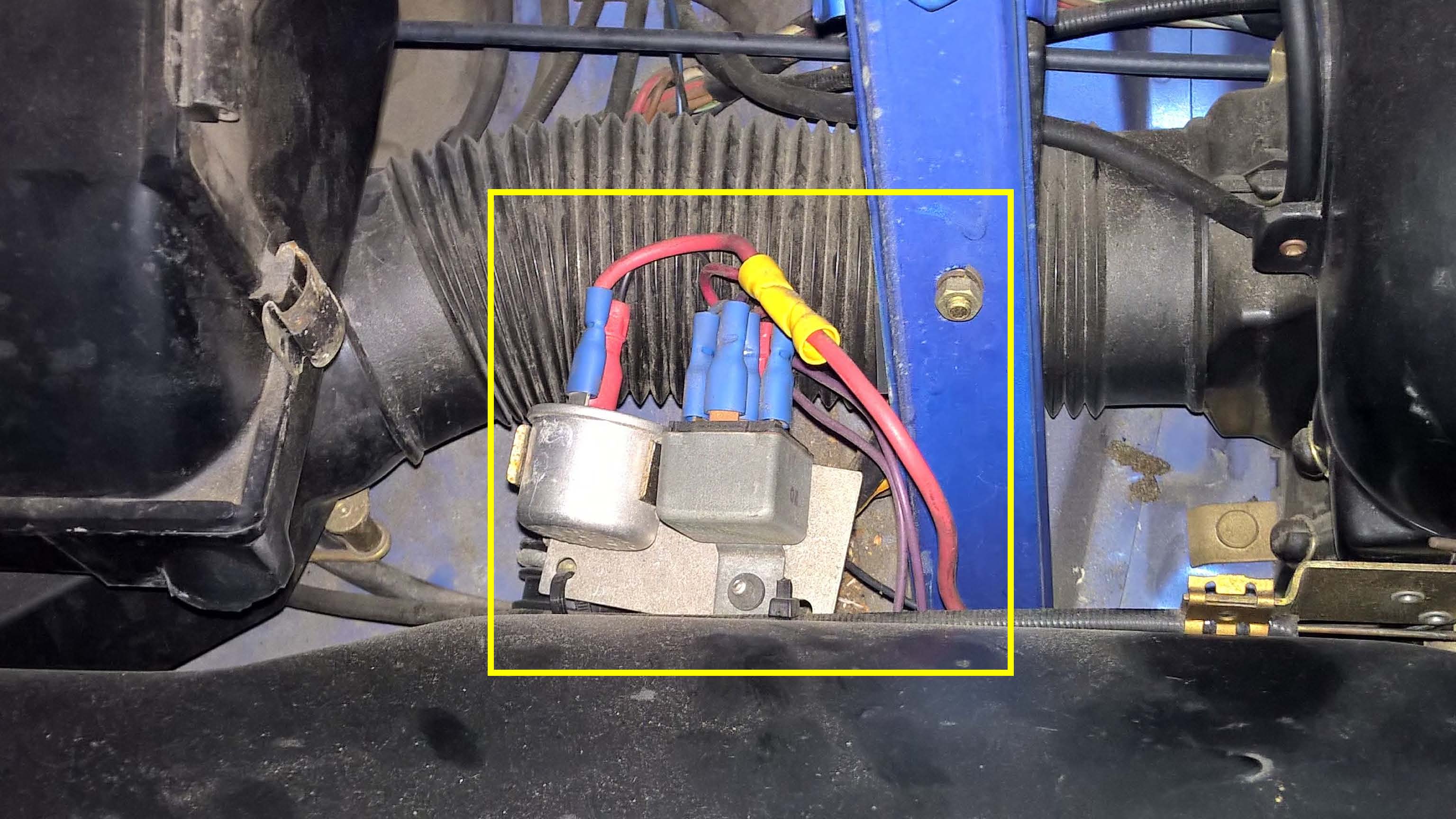

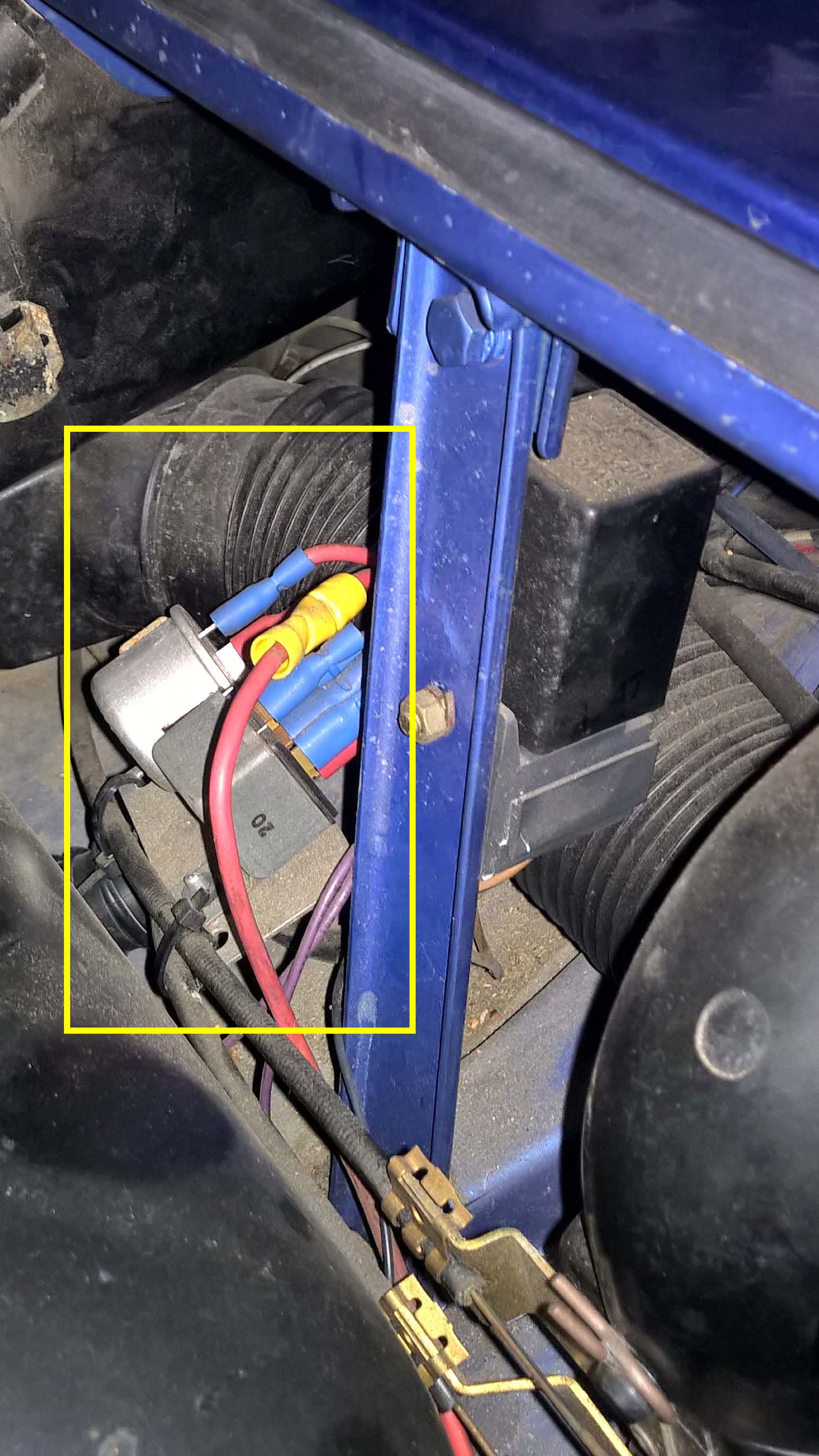

I was going to go in and replace my headlights and front turn signals lights with the 914rubber LED set up and Spokes turn signal boards, but ran into some wiring and relays that don't make any sense.
Before I got started I checked the existing operation and found everything works except for the driver's side high beam does not come on. Next I went and started pulling the headlamp covers off, but before I could I noticed these relays connect to the headlamp harness. Anyone know what this might be?
Secondly, you can see by the harness pictures where they had spliced into the wires.
passenger side light Attached Image
driver's side light Attached Image
Is this part of an alarm connection to the turn signal lighting? (I had an alarm system installed way back in '85 when I used to park my car outside in an apartment complex.)
If so, how do I get the wiring back to normal?

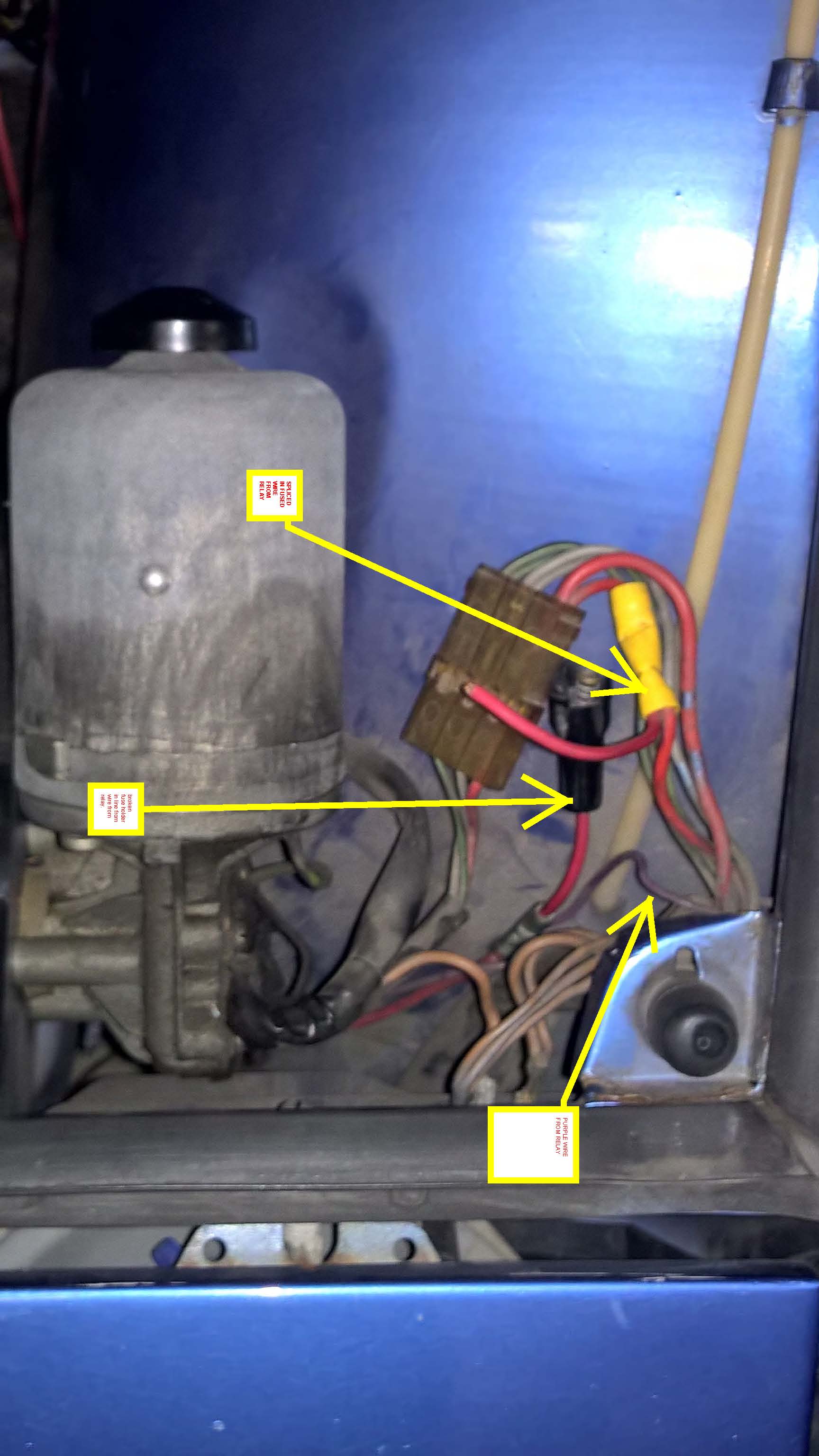

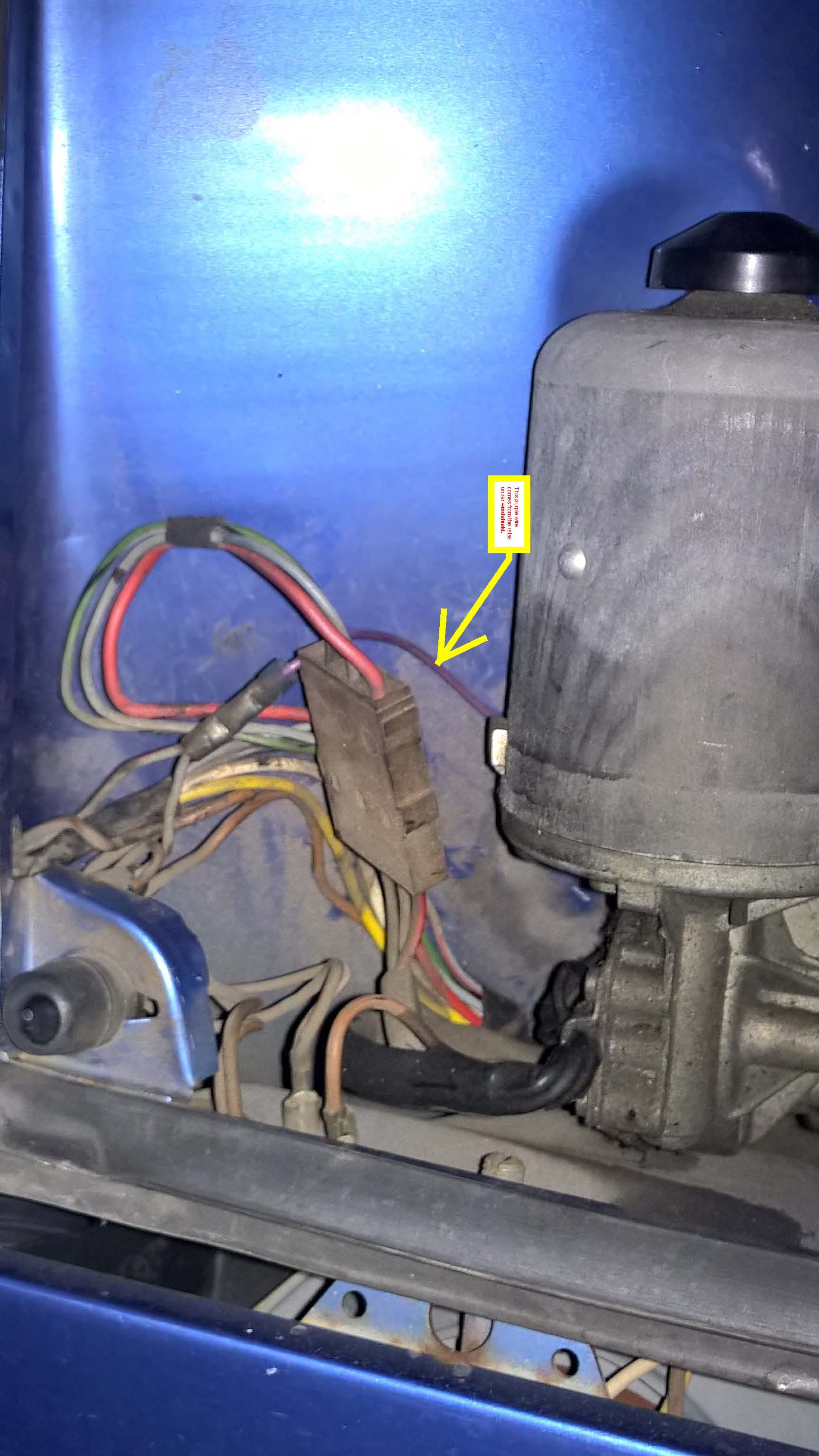

I am going to say you have an intermittent wiper function. The stock intermittent relay works as a single relay, changing a switch from ground to no contact into a six second delay between wipes.
The more readily available vw relay requires a stalk switch signal that goes from ground to 12 v. To get that, you need an intermediary relay. I am going by the position of the relays, not the wiring. How close did I get?
worn
post Aug 13 2017, 07:55 PM
Posts: 3,492
Joined: 3-June 11
From: Madison, WI
Member No.: 13,152
QUOTE(worn @ Aug 13 2017, 05:53 PM) *
Never mind. I see the wiper relay behind the strut. Clearly aftermarket stuff.

Andy thanks for the wiring diagram info. Ill start by seeing if there is any power to the relays or if they are dead anyway. Ss yo can see there is fuse holder near the driver light that is broken and disconnected while everything is still working. I am still thinking this is for the aftermarket alarm from years ago.
