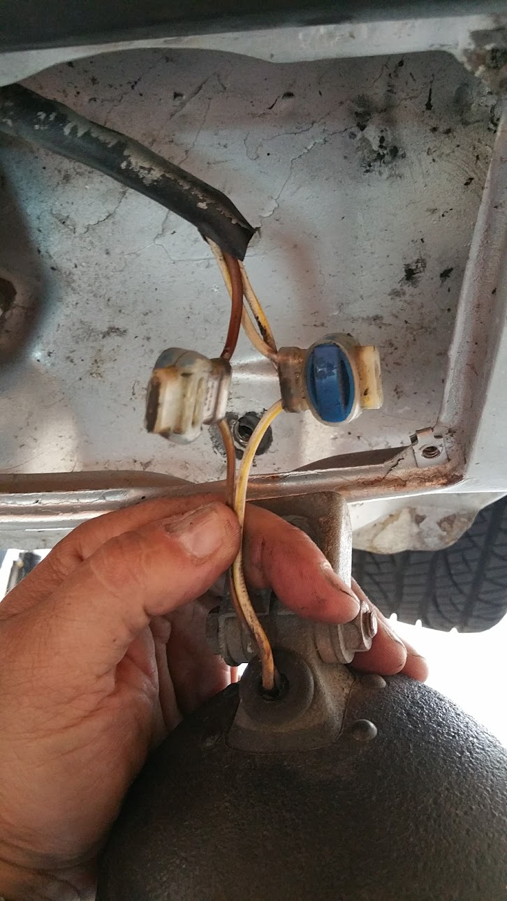

Working on my fogs and found this connector. It's a 3M. Looks like a giant Scotch Lock connector like I use for telephony connections outdoors. Makes sense given the wet location. Is it stock? And if I rewire these, are they still available? I'm thinking of putting some Cibie Iodes instead, with a custom bracket, so considering my options.

From: San Angelo Texas
Member No.: 3,457
Not stock. A DAPO modification.

Member No.: 3,457
DAPO: Dumb Ass Previous Owner (IMG:style_emoticons/default/headbang.gif)

Member No.: 18,995
Honest those connectors are a pet hate of mine,replace them with push pin male and female connectors and solder and heatshrink the connectors ok,you will be good (IMG:style_emoticons/default/biggrin.gif) .

Member No.: 419
Oddly enough, the factory had to disassemble the fog lights to install them... (IMG:style_emoticons/default/wacko.gif)
There are plenty of other connectors out there that would handle this just as well without looking so out of place. But the original setup isn't that bad. You really shouldn't be removing foglights all that much anyway. So if it were me, I would just resplice the wire ends, heatshrink with an adhesive lined shrink tube, and if you ever have to remove the fog lights, you can just do it the way the factory did.
I thought they actually looked fairly neat compared to a lot of the hack work I've run into. That said, they are off the car now. Thanks.
I'm planning to fit some old Cibie Iodes with yellow centers, so I'll be building new custom grills and mounts for these. Good time to redo the connectors.

Member No.: 15,176
That kind of connector came with my robotic lawnmover to splice the containment wire that you dig into the ground.
Just use some male/female quality crimp on connectors and heatshrink with glue inside it..

Member No.: 18,995
Yea.that was what I found on my car push pin connectors...sure they were original.
