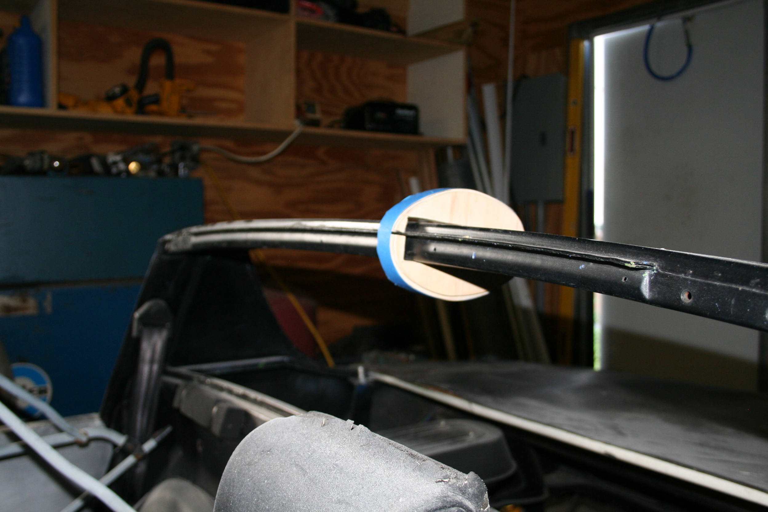

Oh and I'm working on a fairing for the targa bar.
Need to cut the top of that seat down. All of this concern about aero started with the Sparco seat. It's headrest is bigger than my pilot chute on my skydiving rig. I want the air to flow through the car. These are the patterns for cutting out the foam pieces that will be glassed over just like the foil. |

Looking good so far! Make sure there is room behind the front wing for the air to escape behind the wing, or you won't get good airflow under the wing.
Another aero thing you can do if you're so inclined - put a fairing behind driver's head, mounted to the engine lid. I did this on my 914. If memory serves, I bought one intended for an airplane and modified it to suit. |

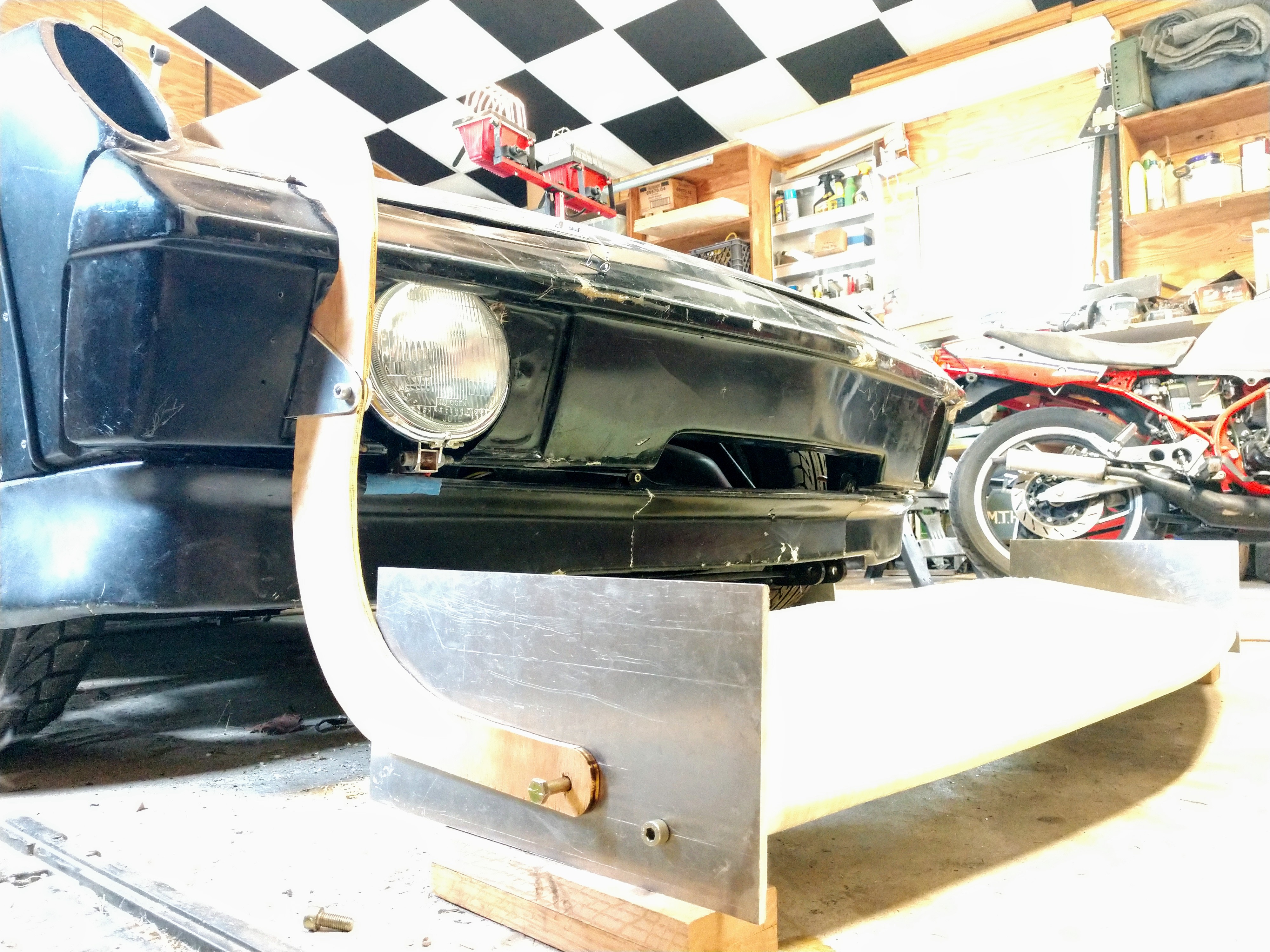

Are the wing mounts attaching underneath the wing? Maybe you could mount at the end plates?

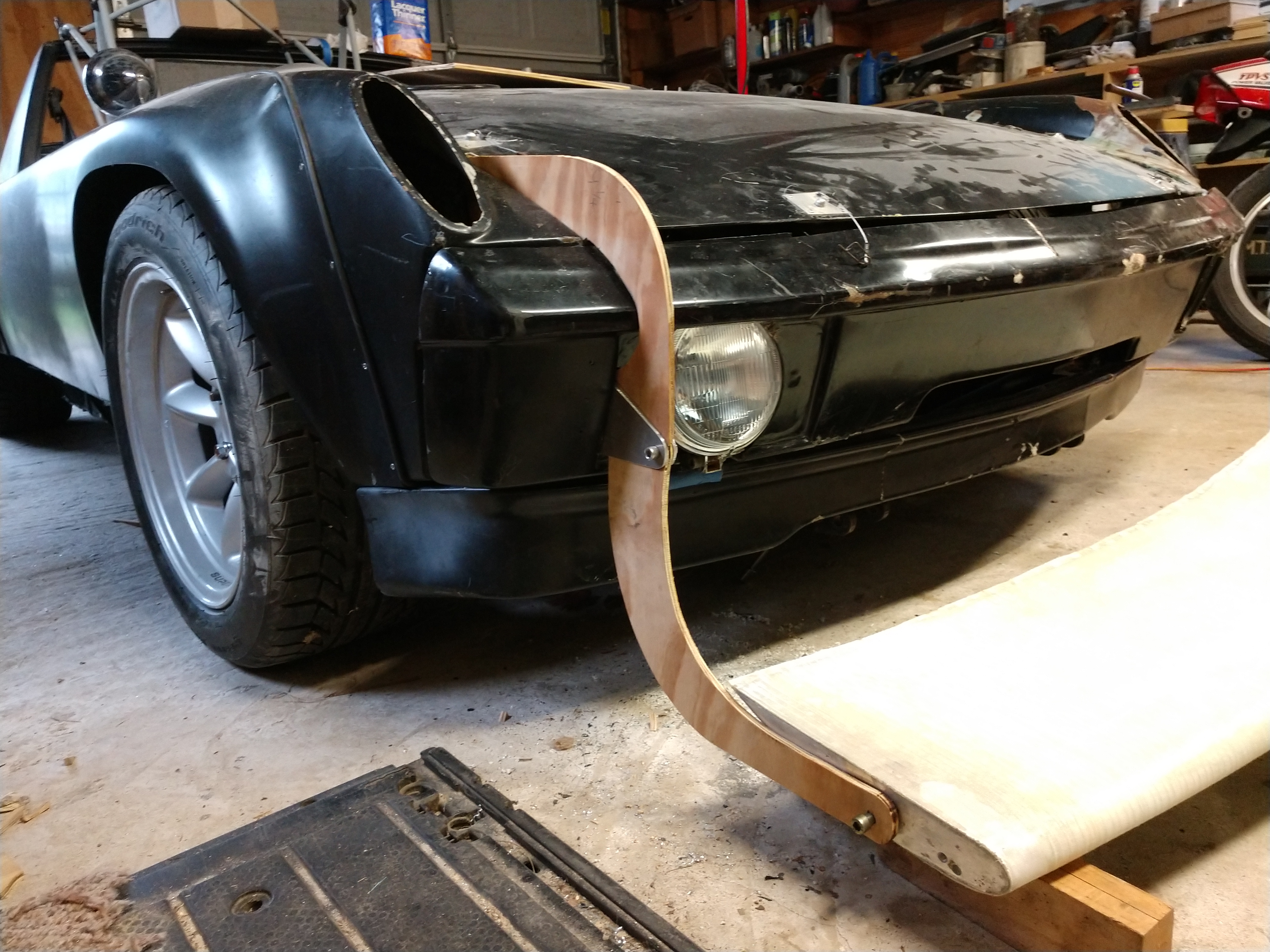

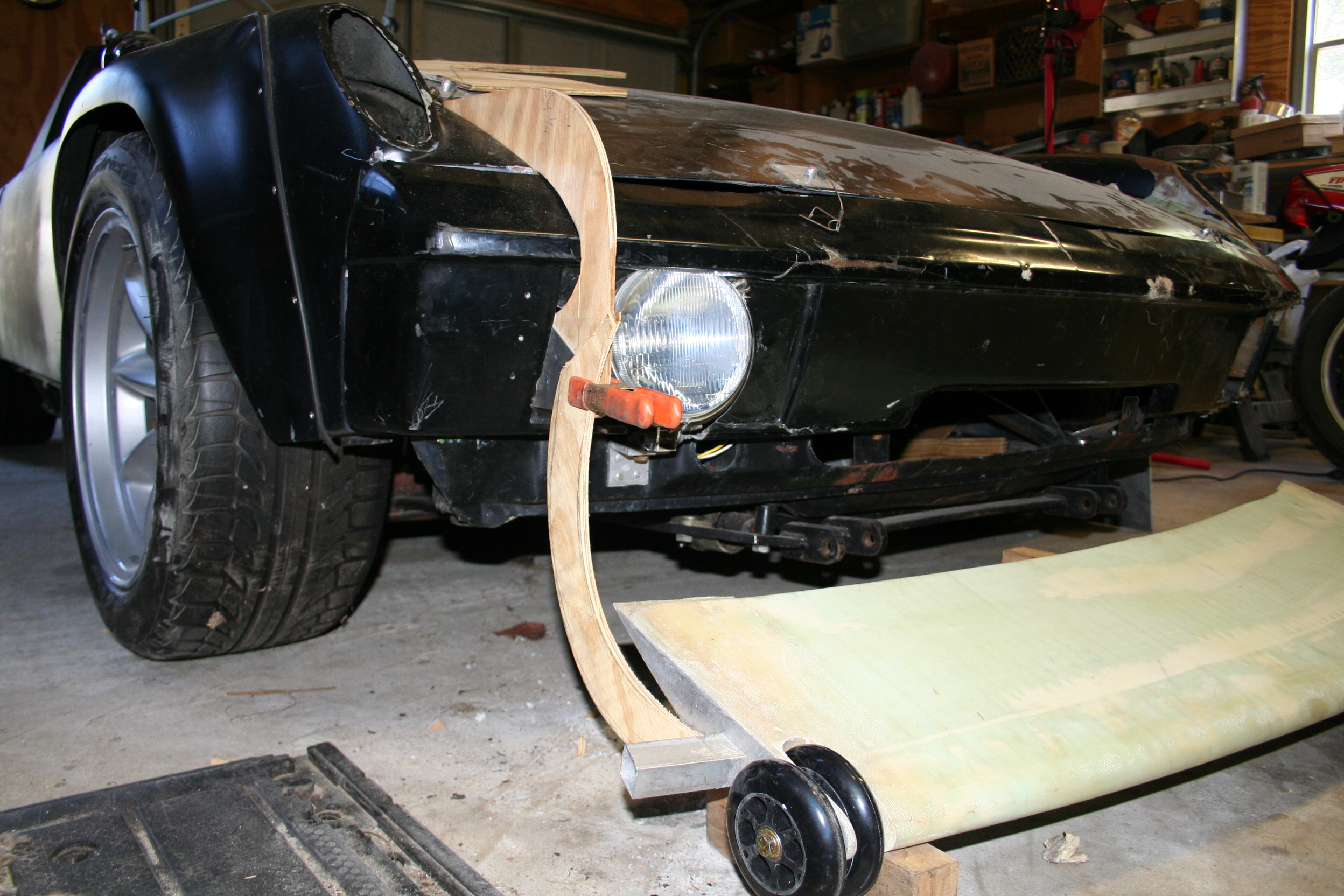

Really coming out much better than I thought it would. I'm planning on sandwiching a plate of aluminum (6" x 12") in between the Swansneck and the end caps about 3/8" above bottom of the wheels, about 2" off the ground. I can drill through the Swansneck, the plate and tap the end caps for adjusting the angle of attack of the wing. WOW!!! (IMG:style_emoticons/default/piratenanner.gif)
For now it will be painted trim black. |

Is the support structure beefy enough to handle the lateral stress? ... Will it handle the recurring side-loads whipping through tight turns?
... 'asking for a friend' (IMG:style_emoticons/default/laugh.gif) |

Hey Mark, probably over thinking all of this but I don't believe that I am over building it. Hows Dianne?
I have said this before and probably will again. If I knew what I was doing I would never have started this project. It has been a really fun project though and not very expensive. I know that I don't think along the lines of the average person but I really don't mind… I started all of this to add a little weight to the front of Carerror. Now it looks like I might be the recipient of the bonus of some Mystical Downforce. May The Downforce be with me. When I lower the front end I might have to raise the wing. Easy by just moving the bolt hole and the stop at the pivot down. Off the wall, out of my mind, out in left field or just thinking out of the box???? Probably another month before I get to drive her. (IMG:style_emoticons/default/evilgrin.gif) |

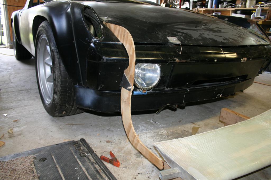

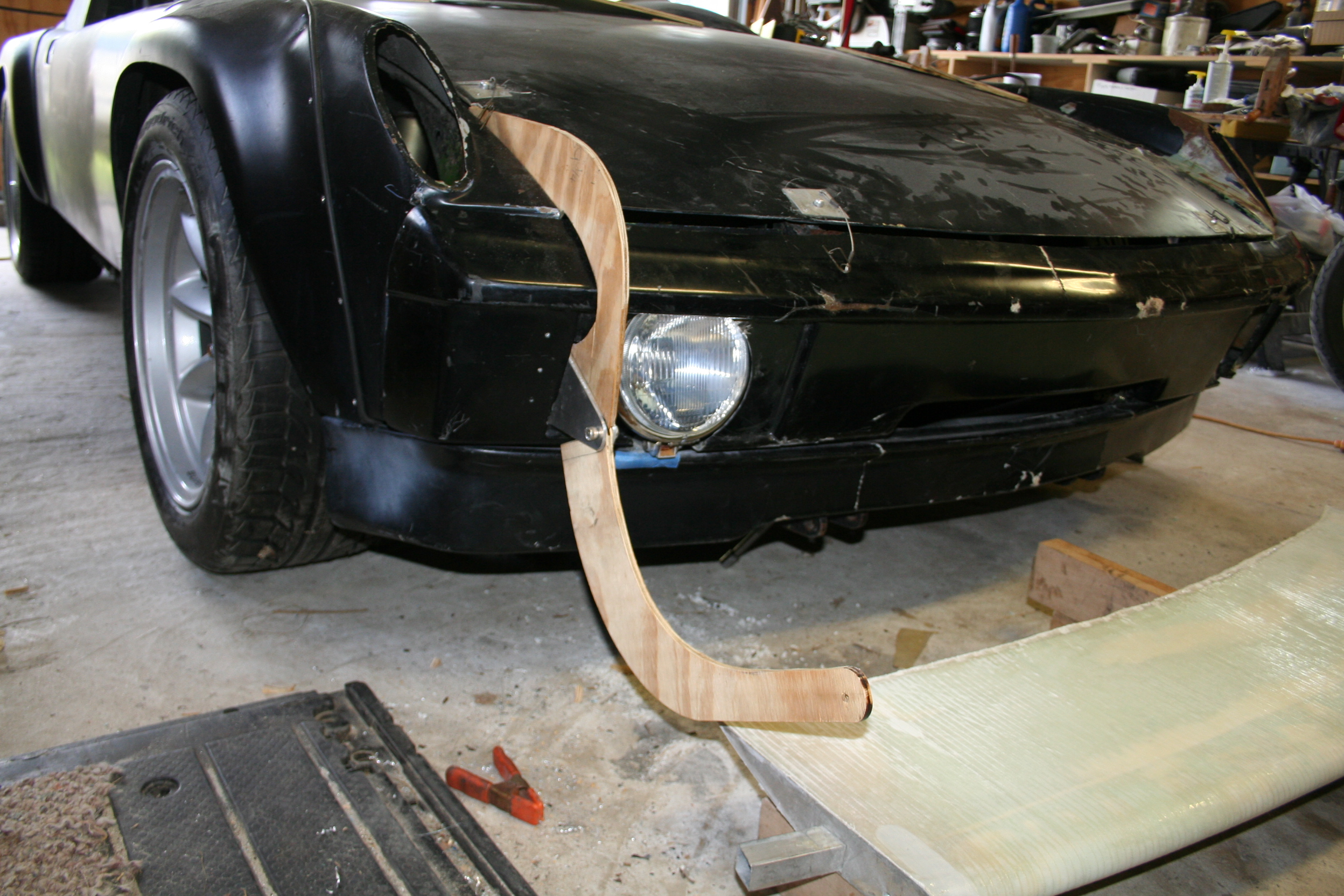

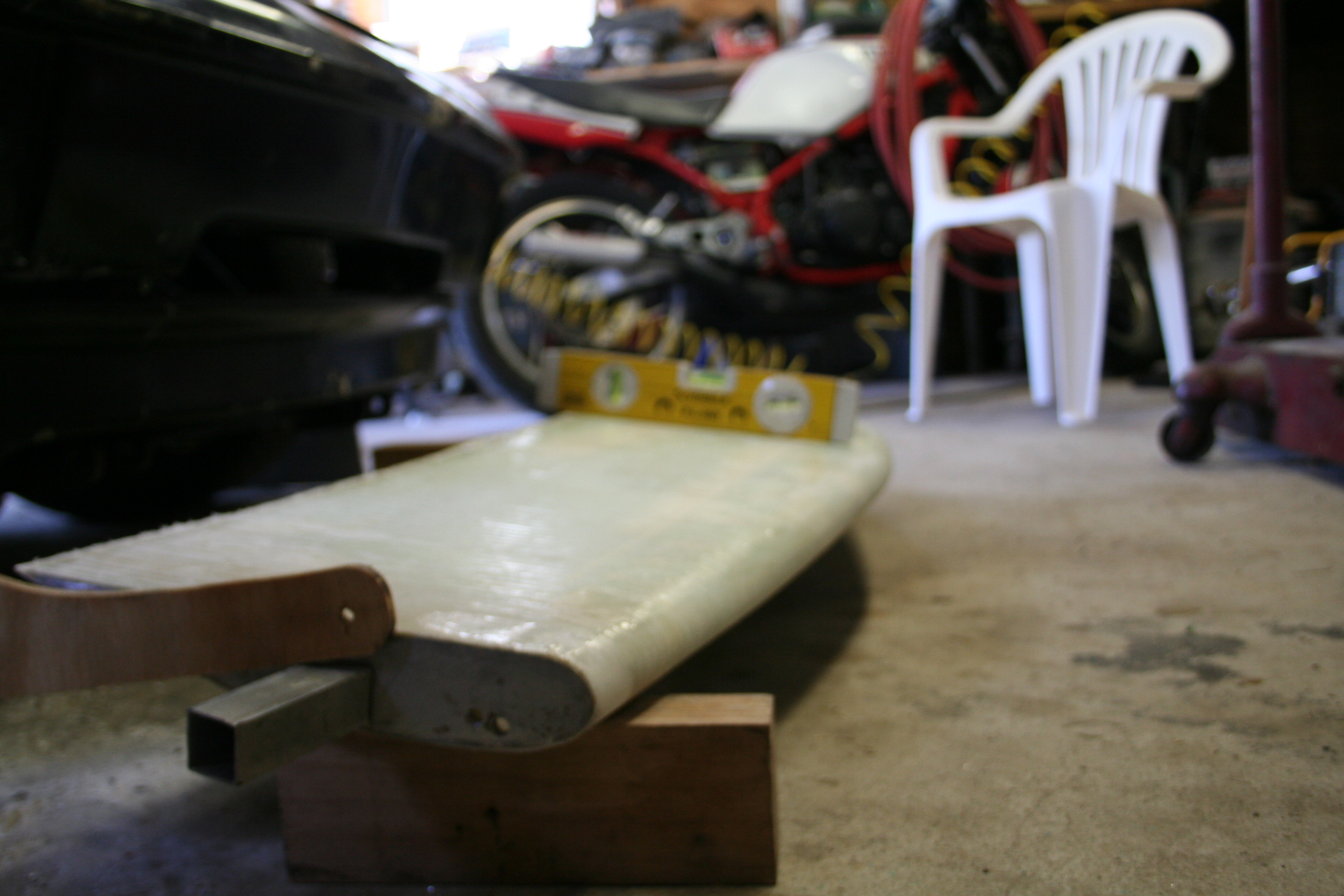

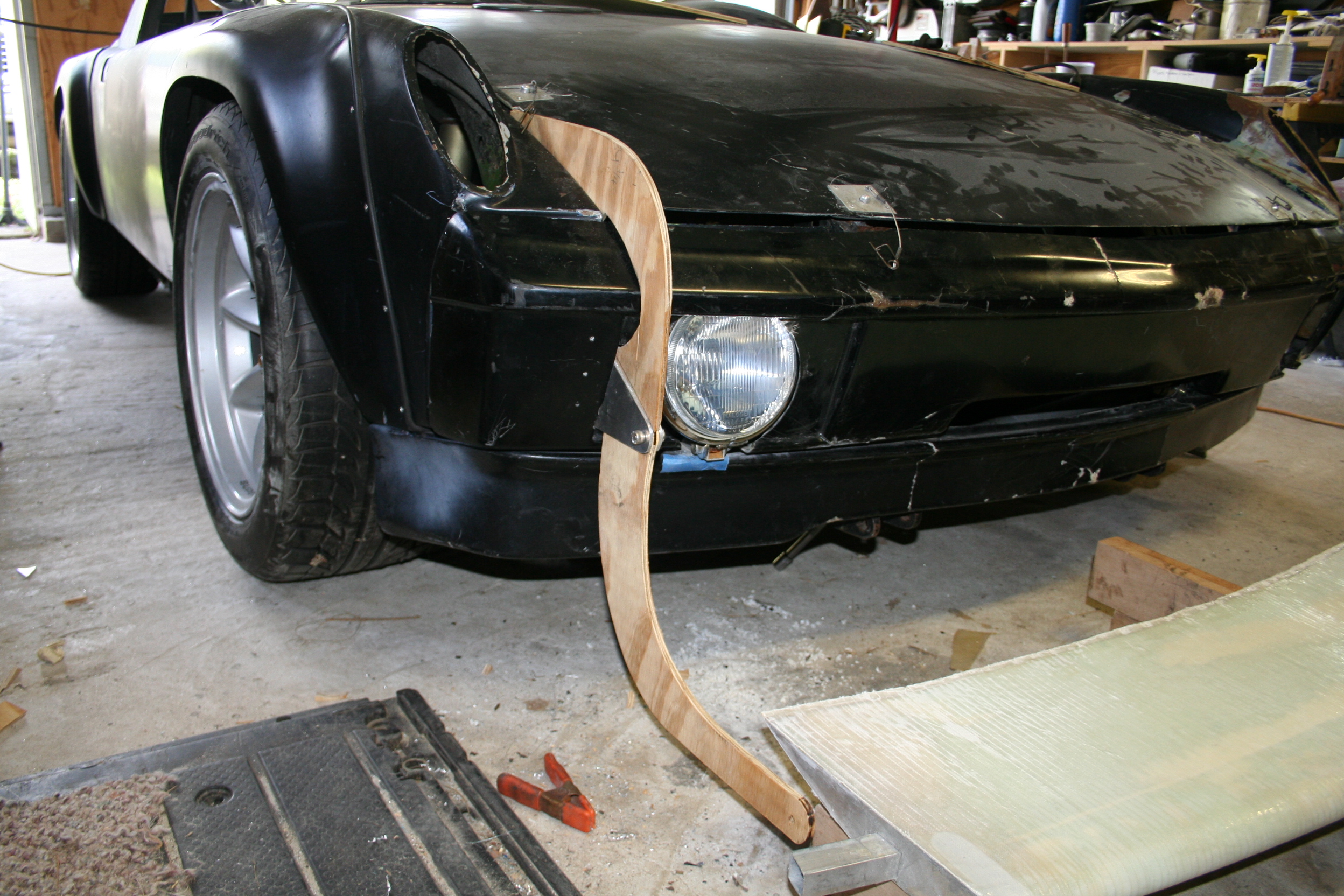

More pics, the wing is setting 2 3/4" off the ground with an angle of attack at 10 degrees, 9" from the bumper. The end of the Swansneck has a hole in it that will bolt to the plug I will fill the square tube with. Back to making parts.
Swansneck, I guess I can call it anything I want. It's a Big Falcon Swansneck. Nice jack huh? |

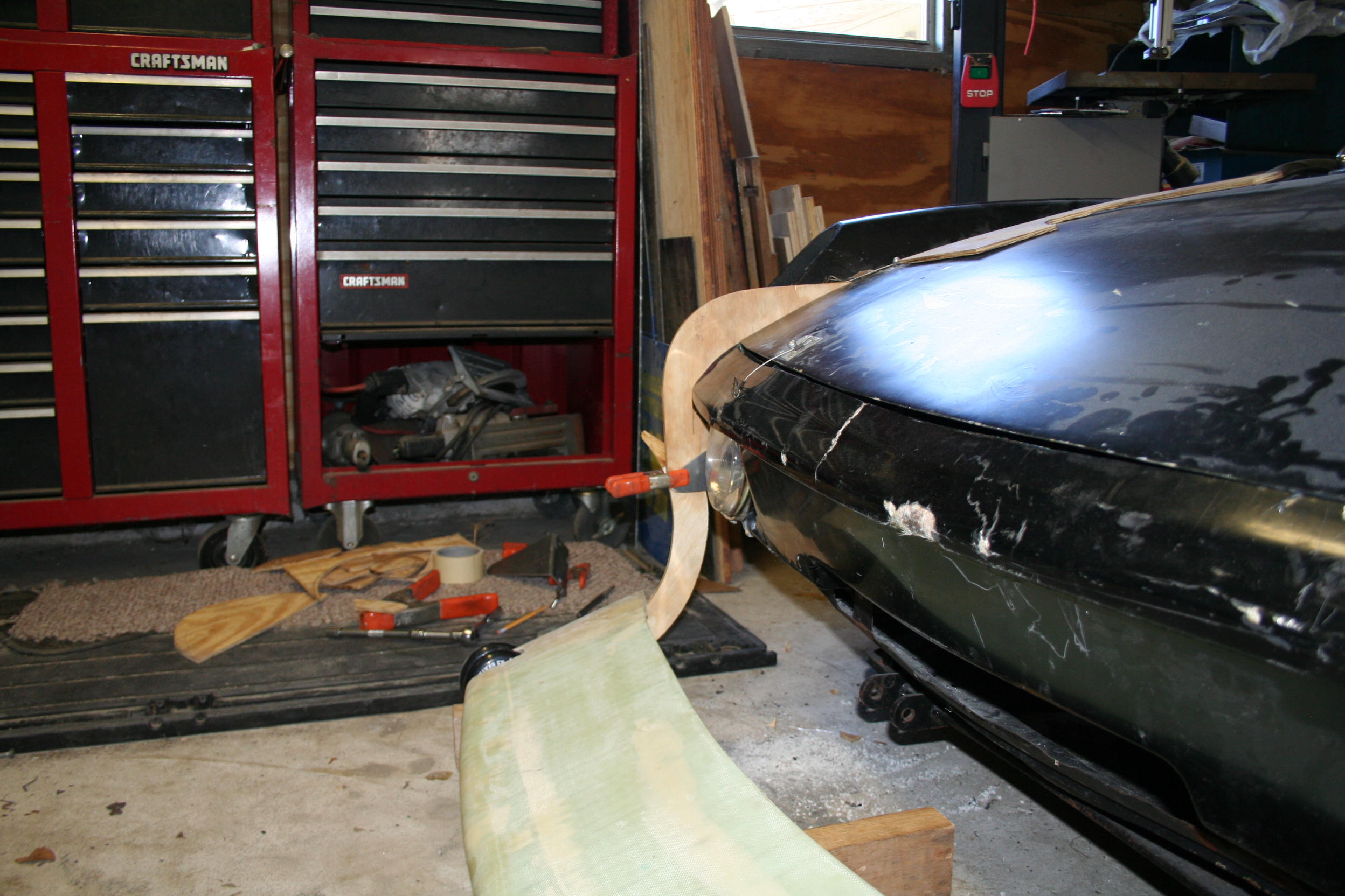

Yes, but that was a secret cause I haven't got that far yet. Something from behind the wing up to just above the pivot. Going to cut out the brackets today. I plugged the box beam yesterday need to drill and tap it and I will be ready to do the end caps. Still have to do some more glass work on the wing to make it finished then I can mount this beautiful piece of mechanical artistry. (IMG:style_emoticons/default/poke.gif)
Carerror does not have much body roll to speak of but putting the wing that close to the ground it needs to be flexible. |
