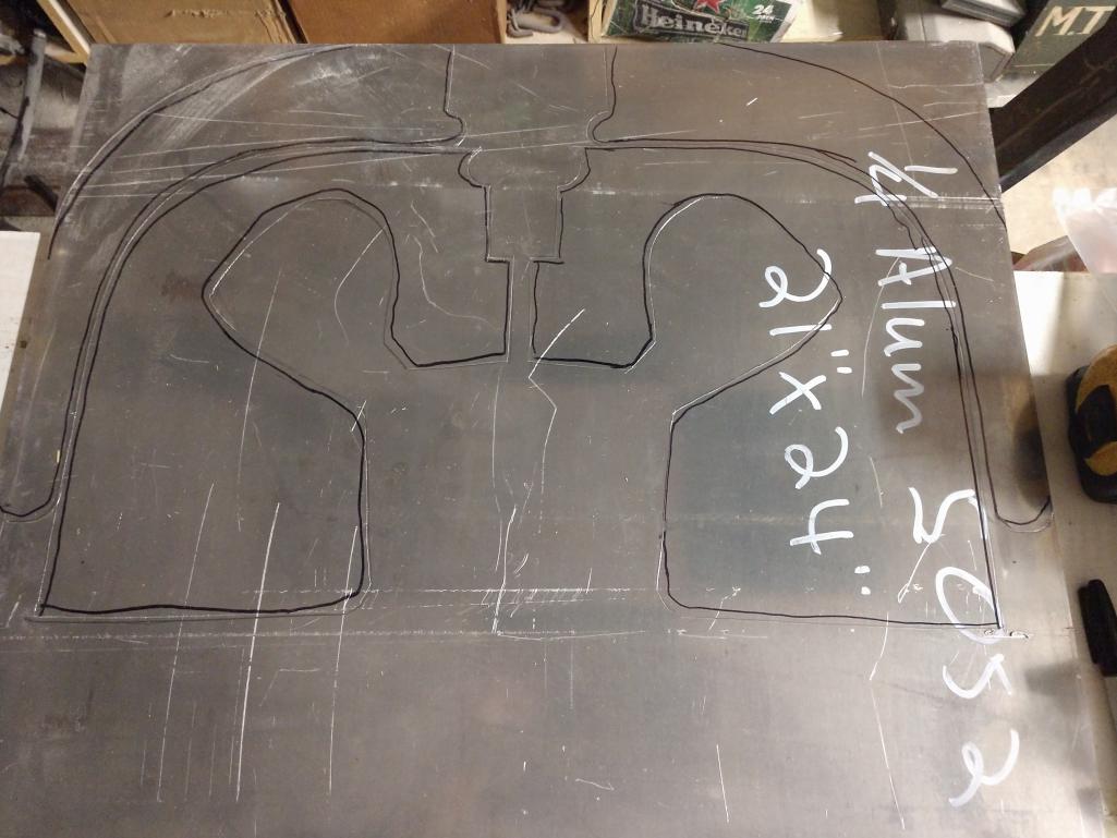

Getting ready to cut out the brackets. Let's see how the picture came out. Ordered a new camera this morning really need to make this easier.
Showed this picture to my brother and he called them, "Horse head brackets." I really like it but you just can't see it on the Carerror. So it's lost in the translation. I didn't plan any of this, it just happens.
Love the swoopiness of the Swansneck and it sounds os much better than Horse head bracket.

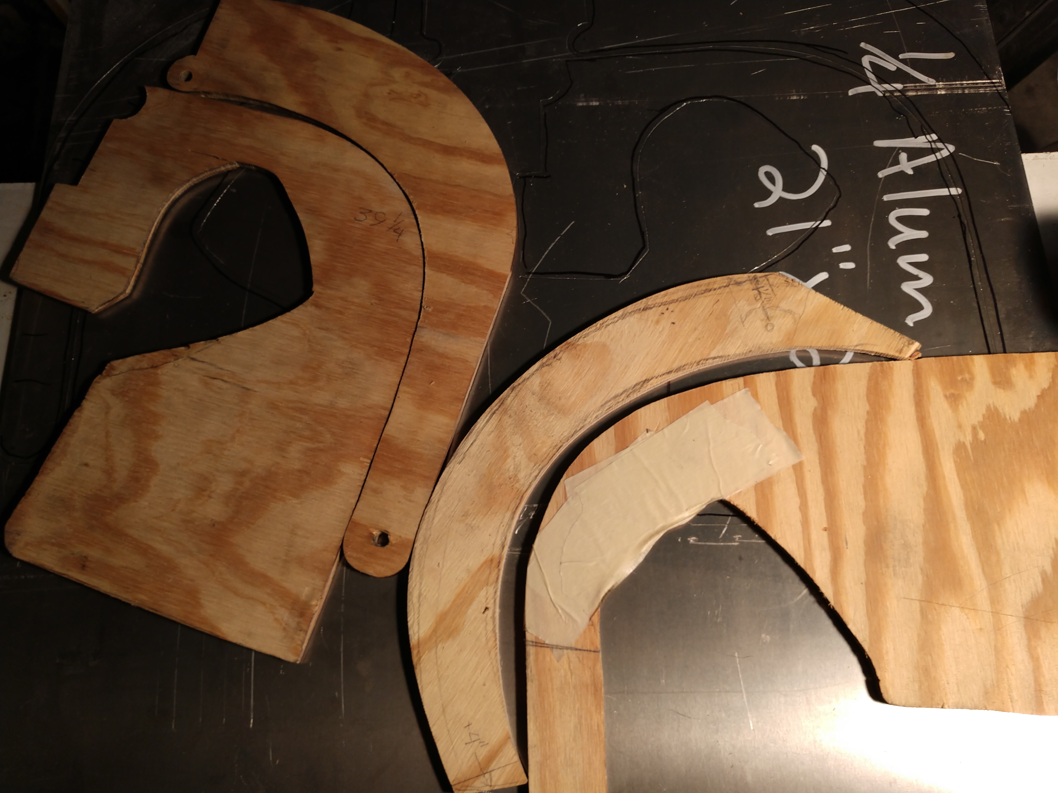

Making up the templates except for the straight lines I did it all freehand and scribing. My work has come along way. We'll see when I go to bolt them in.

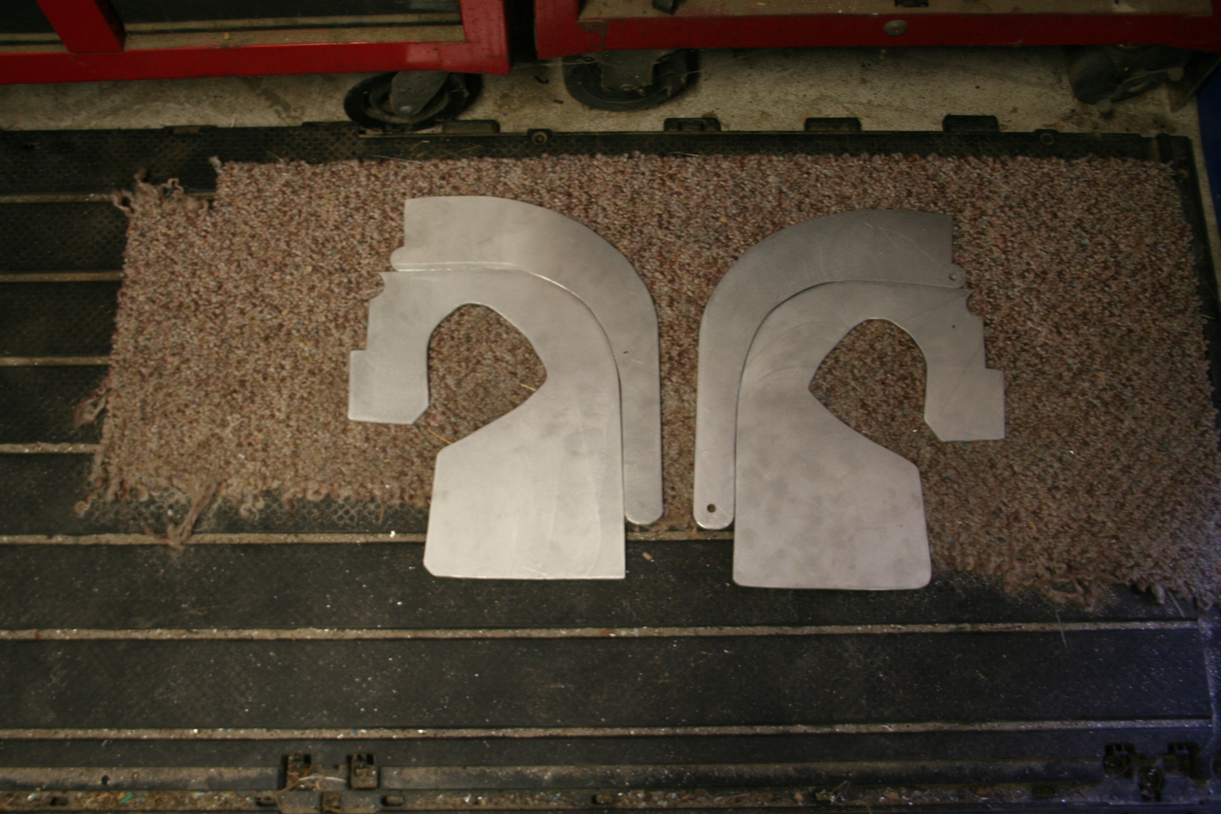

The Brackets for the Swansneck now in aluminum. A lot of detail left to do but you got the point and I got the Force. Down Force.
This has been fun and there is a lot of people watching.

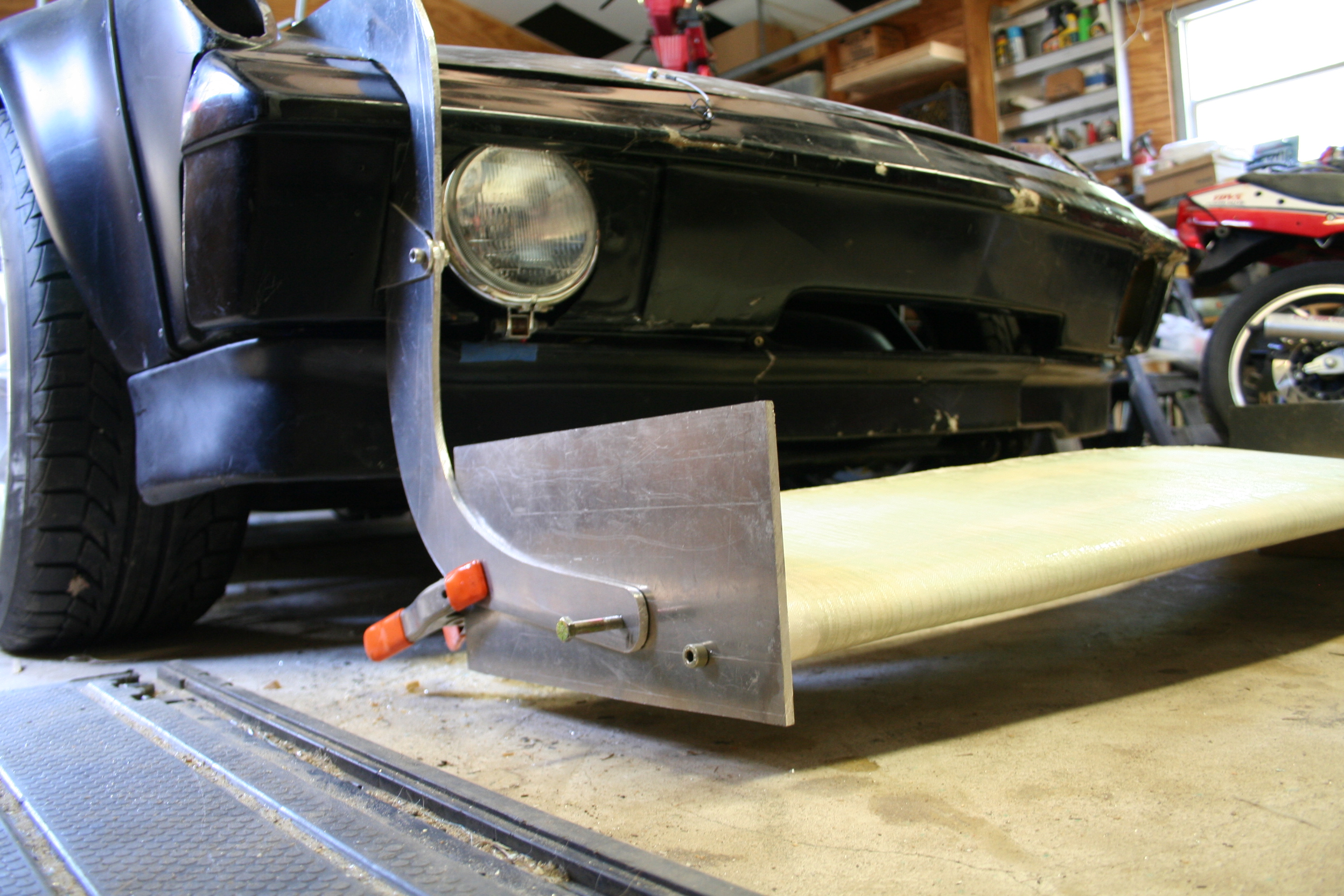

Looking very nice ... One question - will there be load on the end plates with your design that requires them to be made from the 1/4" stuff?

No, it's just what I had laying around.

No longer in mock up. I have the pieces for the other side and this is what I am going to use. Now I have to make it all fit together.
