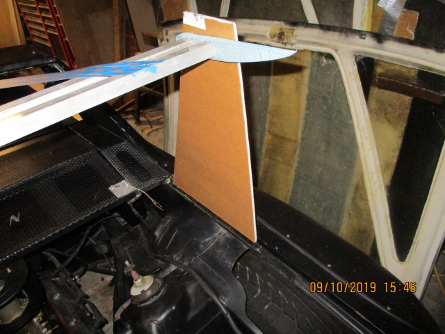

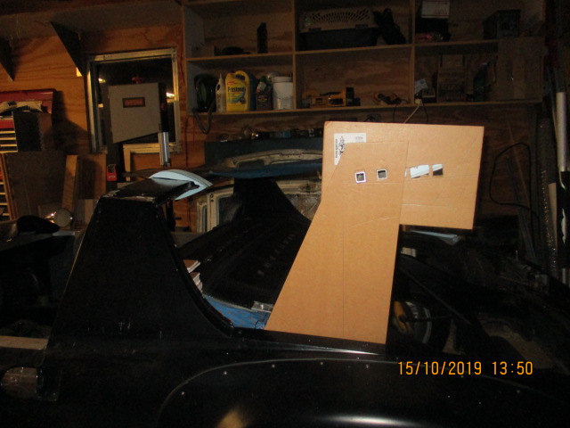

Consider putting the wing farther back. I get the logic about putting it over the axles, but especially with a front wing, the car may do better balance-wise with the wing out back.

Thanks Scott, when I started the work on Carerror I put her on a diet. I cut away everything I could to make the ends of the car as light as possible. So behind the shock tower there isn't much metal. But you made me think about a trailer hitch. The rear of the car is planted with equal scuff marks and the blue hazing inside and out with 15 psi. So anything I do to it may not be good.
need a better pic.
There isn't much metal behind the shock towers. The rain gutter needs to be braced to the inner fender well. I need to do something about a brace to the small area that was covered by the small grill piece.
Thats where the 2 projects merge. The cold air intake is going through the small grill area and the upper part of the area that gose to the window area gets cut out. The brace that supports the engine cover and the small grill piece is in the way and not beefy enough so it has to go and will be done when I do the cut outs for the cold air intake.

Gotcha, makes sense re: the lack of solid structure in the back. My car is similar in that respect. One option would be to angle the wing struts back and 45 degrees or even steeper, to place the wing farther rearward.

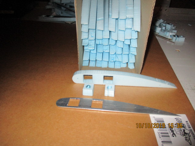

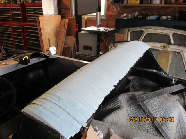

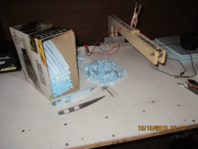

I finished the foam formers today. I have about 50 of them ready for the spars.
The little square cut outs took more time to cut than the shape of the former.

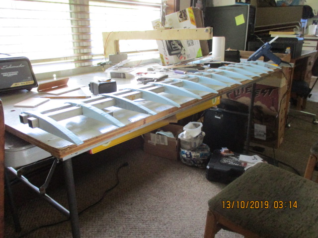

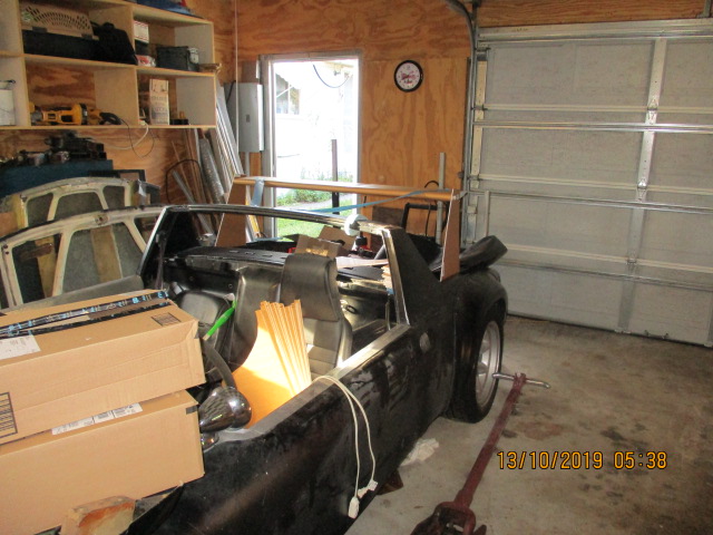

Built 9 foils for the wind mill now I think I am ready to cover the rear wing.
The spar with formers attached.
Need to make up the piece of foam bord as the sheets are 30" x 20". With my lay out there is a former 30" from each end.

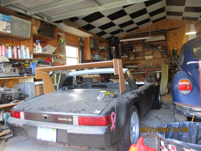

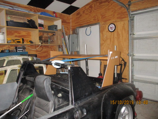

The rear wing. Mock up uprights and the wing is unfinished but there she is.
Not a very good pic and still lots of stuff to do it.

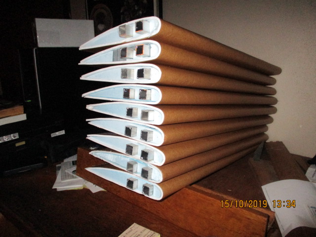

Going to add more pictures cause I know thats what your here for.
I don't usealy talk about what I'm doing because it always takes me way to much time to complete anything that I do. Just something I been thinking about, a vertical wind mill.
The Blades.
The Wing
I'm about to change over to metal work. Making patterns in foam board was really quick and easy. 10 times as fast as plywood. Foam board would not have held up the front wing.

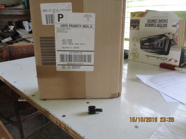

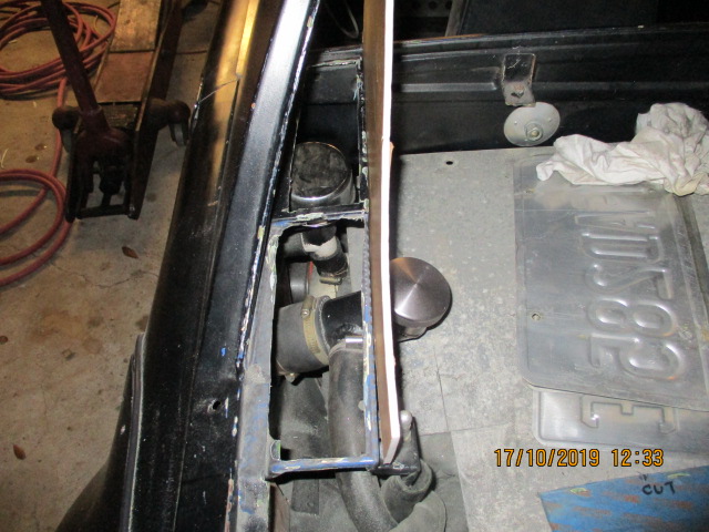

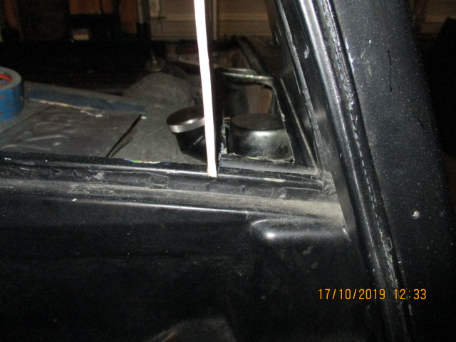

I sent to Summit for a part and recived the part shipped in a box. I sure got my $10 worth of shipping.
I cut out the holes for the Cold Air Intake on the drivers side.
Not sure how I am going to handle the back of it yet.

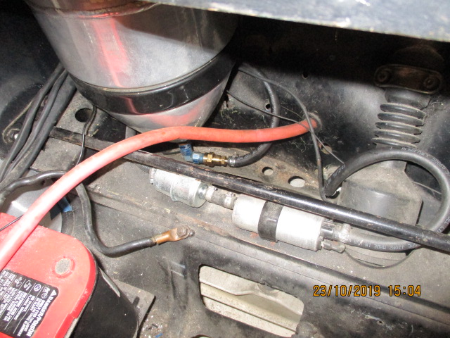

I got the correct fittings for the fuel tank and installed them on Carerror. That finishes the fuel tank installation. Not sure about the engine bay end of her yet but after I check that stuff out I can move her outside and put the bug in her space and put her in back in the shop. When she is outside I'll get some pics.
If you look closely you can see the new parts on the fuel line coming out of the bottom of the tank.

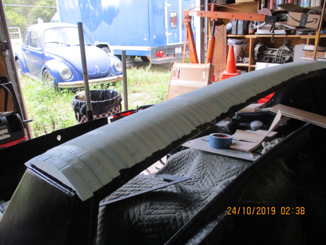

Team Sharp where the 914 grow wings
Posts: 1,506
Joined: 29-January 16
From: TheNorth Shore Retreat. Deland
Member No.: 19,611
The top of the Targa fairing is almost sanded rough. It's all glued together so when it dries I can finish the rough sanding.

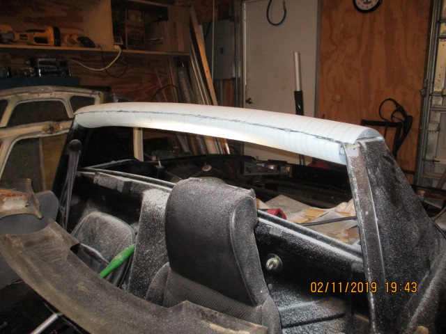

I've been sanding on the targa bar fairing and it looks much better but that brought me to a thought. With the targa bar fairing and the cold air intake the hole targa bar will be covered. The targa bar should disappear in the eye of the wind. Just a thought, hope it works.

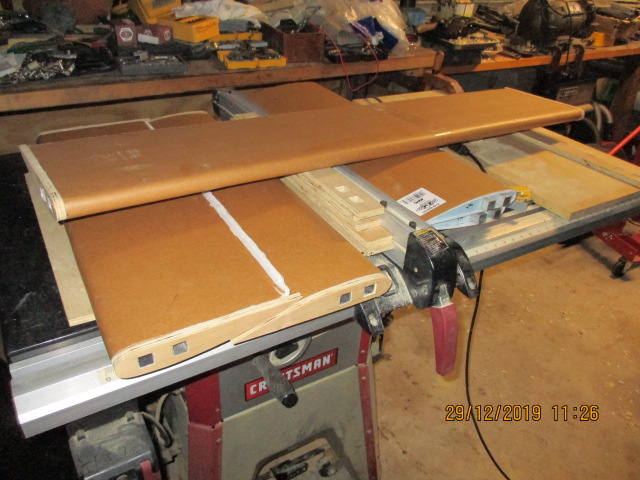

Currently working on the wings making up the end caps. I have 20 of them to do and then I can start on glassing them. That's going to take a few days. Not that it's going to change anything but it's gonna be a little boring around here until I get the foils finished. I have decided to put in a switch to turn off the fuel pump. As I would like to be able to run motor till the carbs empty.

Cutting the end caps for the wings, really sorry about using up time that I have here for work on another project but the foils are the same size. After working on them I realized that I could probably make the foils for the windmill out of just a cupped piece of sheet metal. Probably going to do that also just to see which one is faster. I won't be doing much more to the windmill till Carerror is ready for the track. Just thought I would do all of the foils at once since the are all the same foil (Clark Y 25 foil).
When I finish with the end caps I will make up the threaded inserts (40 of them) I will then go back to metal work on Carrror and mount the rear wing.

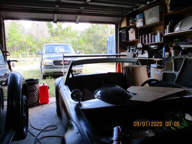

So today I mounted the mock up of the rear wing to see how high I wanted it to finish out at and I think I got it.
Making some notes on the patterns for the cutting of the parts in aluminum. I have the stock on hand so it should happen quickly.
