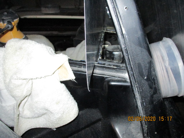

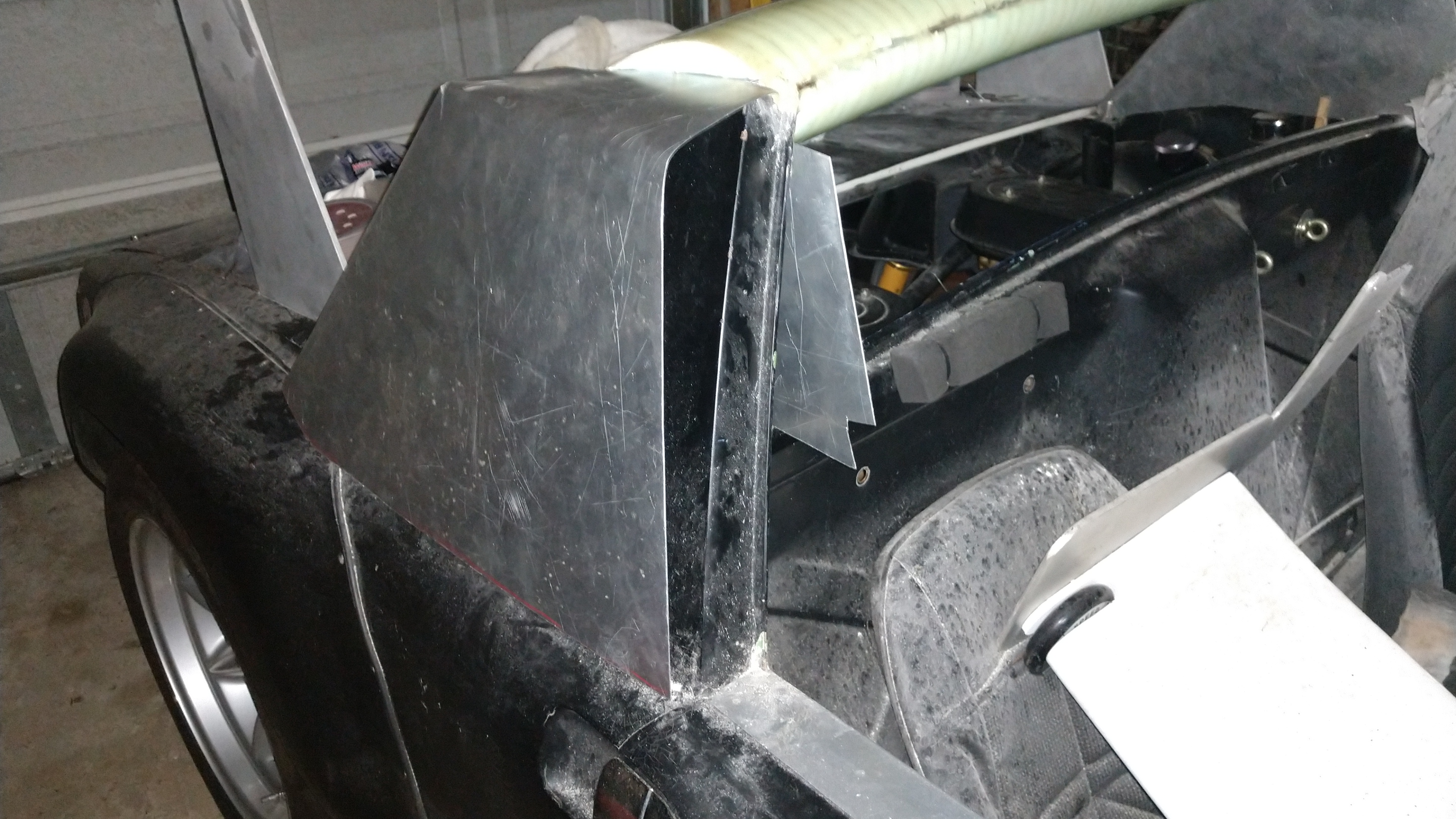

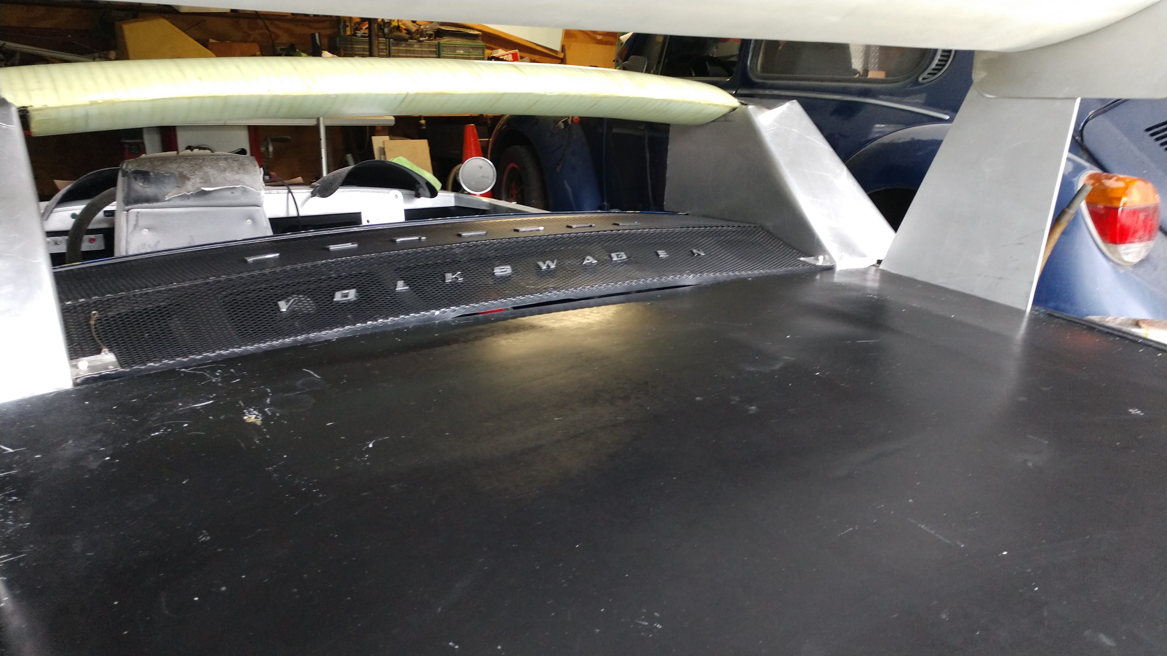

Hey Mark, I cut out the space between the engine grill cover and the targa bar. I think I have a pic.
Let's see if this works. I have a new laptop and we are fighting about posting a pic. I have to move the breather to whats left of the rear trunk. I think it is only a little plumbing.
Looking at that pic tells me that I need to make up some kind of fairing for the targa bar upright.

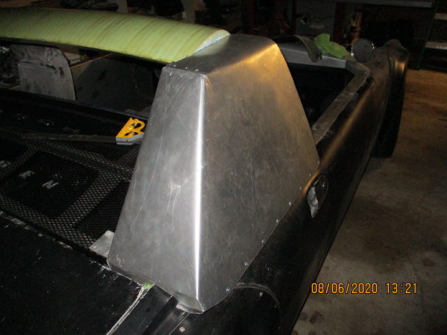

Right side.
In 2 days I got both scoops on the car and I am happy with the way they look. I would have still been sanding and glassing the plug for the left side. It would take me the till the end of summer to do this in fiberglass.

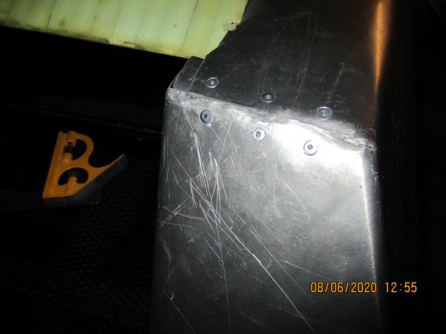

One more time, this makes about 6.
It was riveting day.

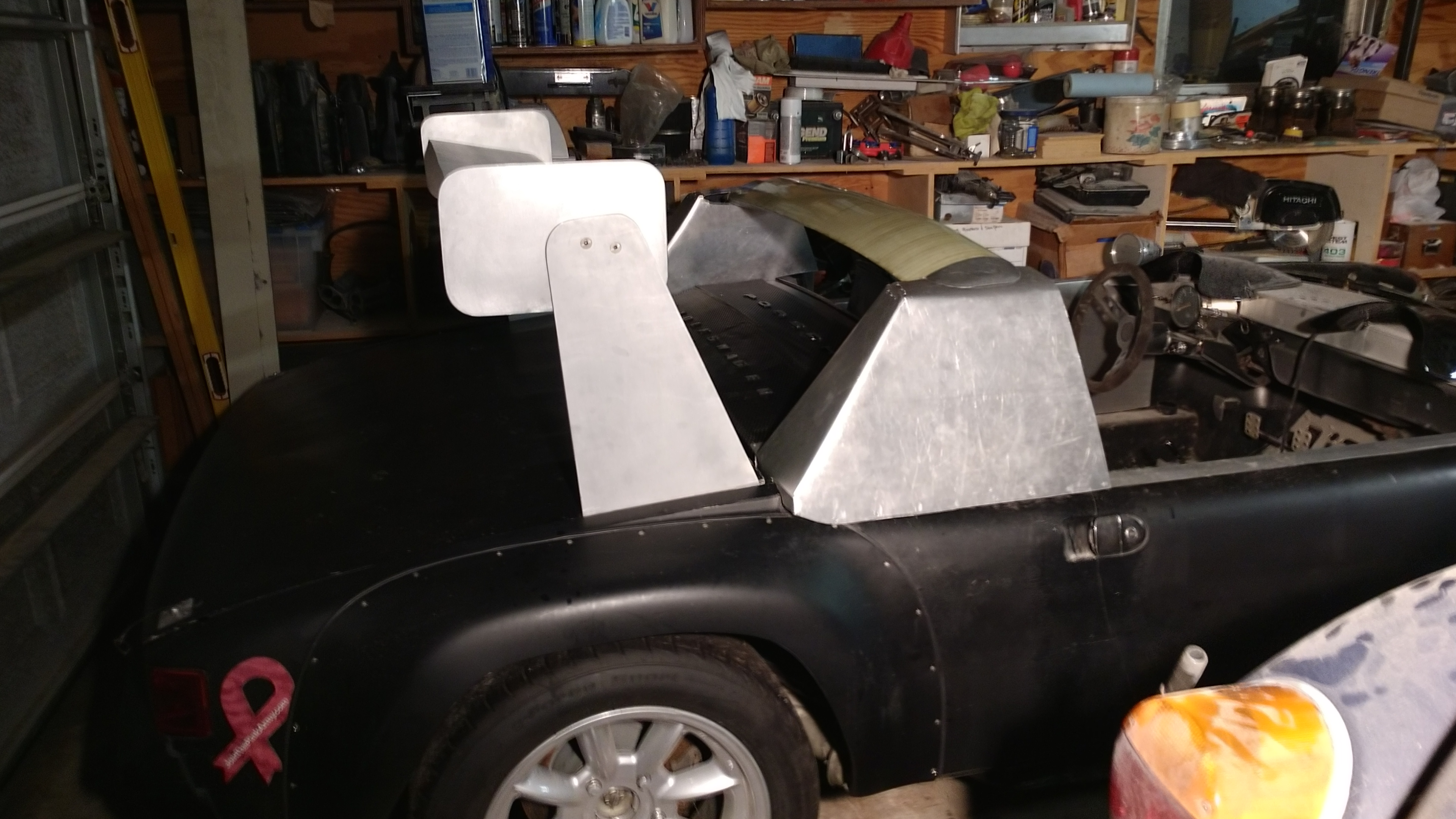

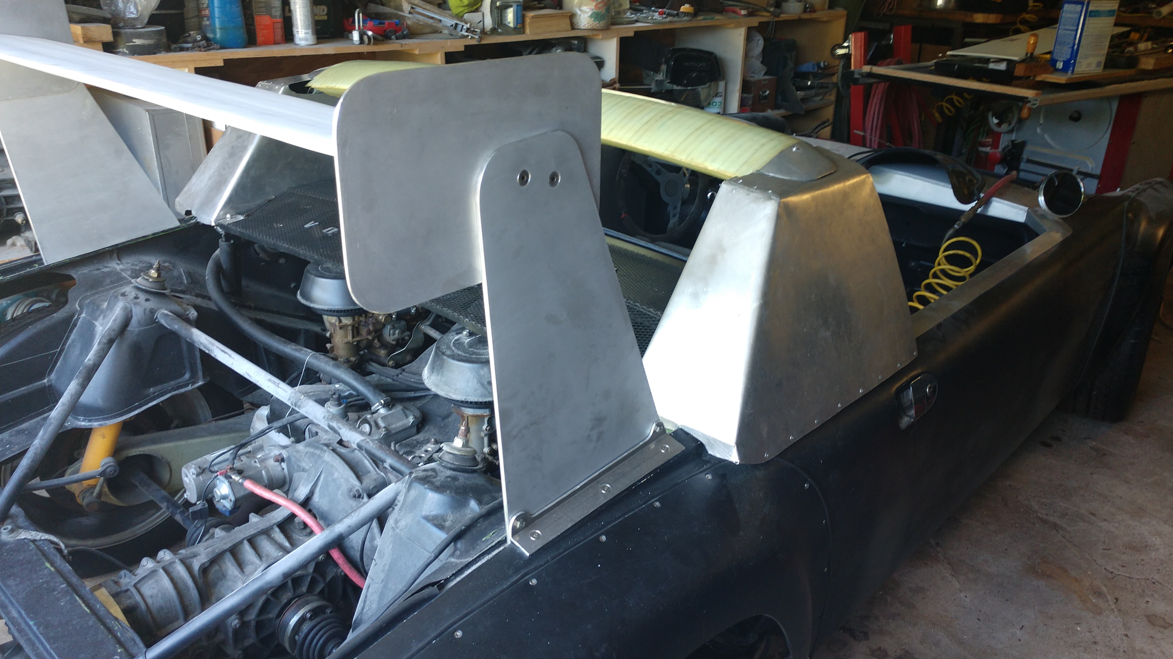

The scoops have a flange that will take the fasteners to the targa bar. The right scoops flange is setting less than an eighth from where it will be fastened.

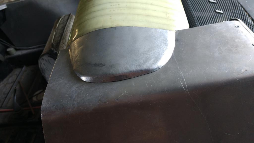

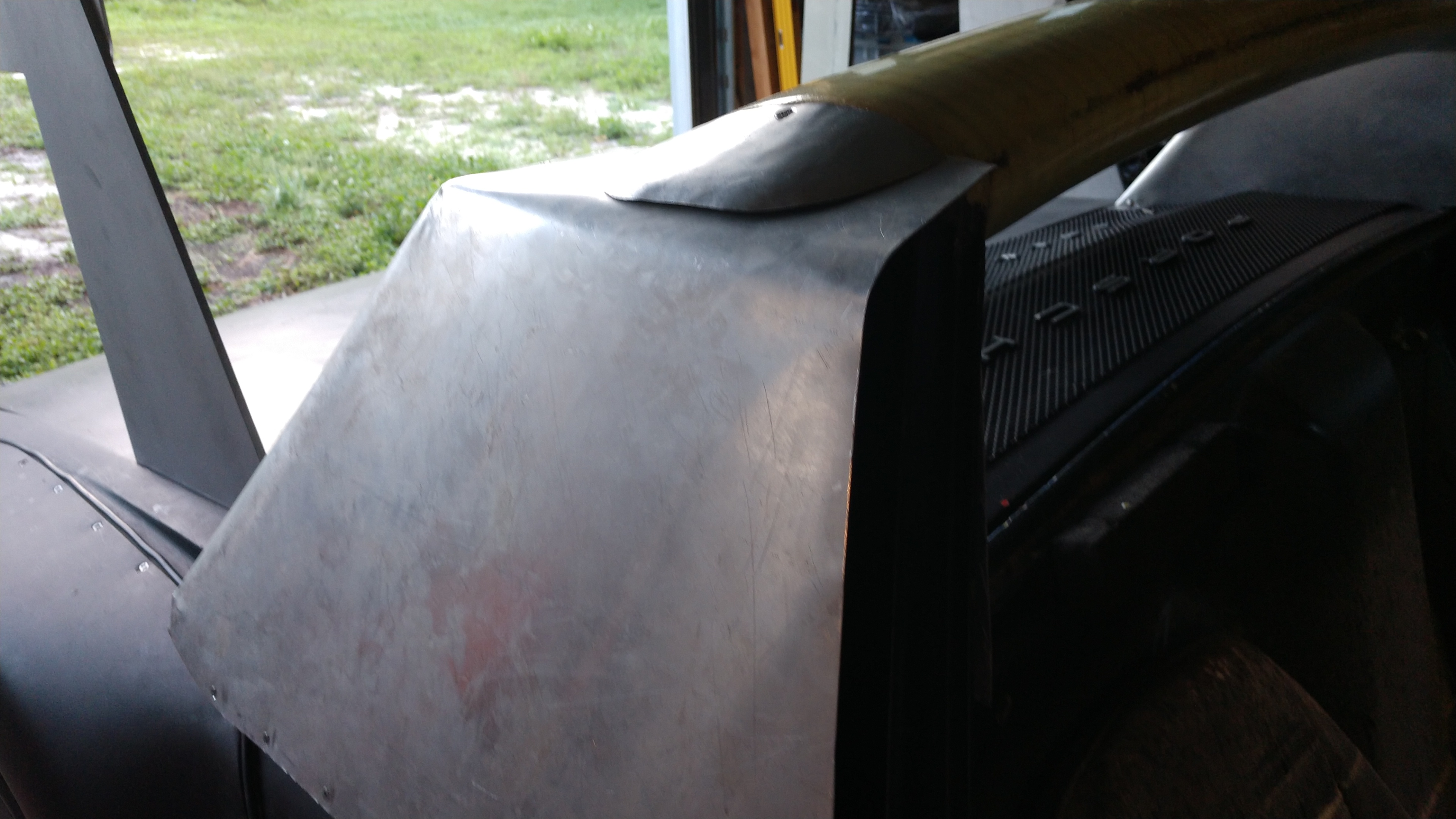

Yesterday I made up a small fairing that ties the targa fairing to the intake scoop.
I'm thinking a flat head screw from the top of the little fairing through a post and the scoop to the targa bar one counter sunk screw holding everything at the top. The bottom will have 3 fasteners from the flange on the bottom of the scoop to the targa bar.
914 Ranch
post Jun 11 2020, 04:52 AM
Post #331
Team Sharp where the 914 grow wings
Posts: 1,506
Joined: 29-January 16
From: TheNorth Shore Retreat. Deland
Member No.: 19,611
Attached
Looks so much better with something covering the end of the targa bar fairing.

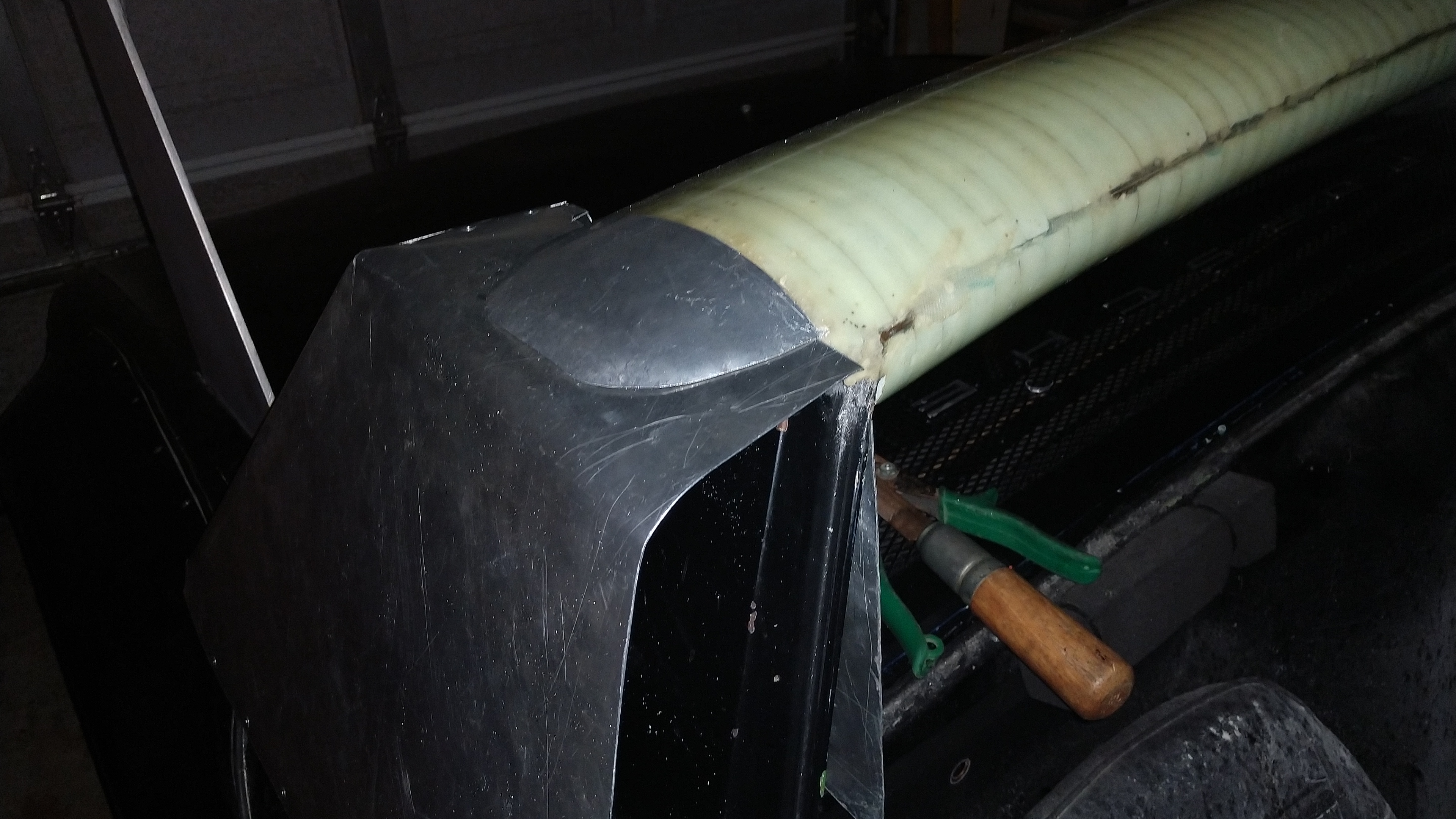

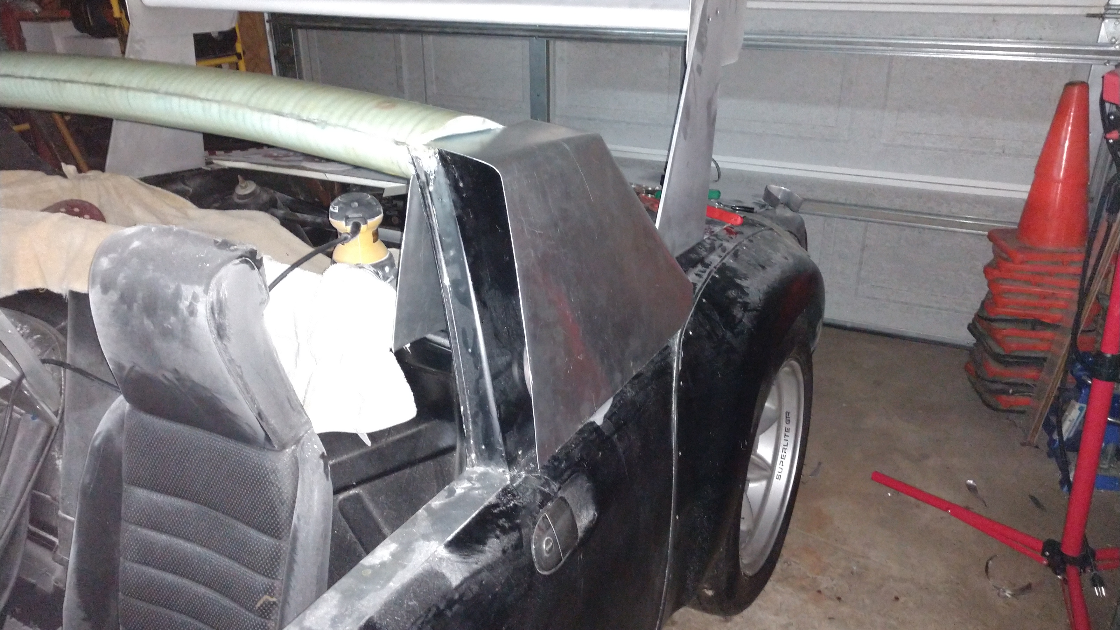

Just curious if you're gonna roll the front edges of the scoops in - like a jet engine nacelle?
914 Ranch
post Jun 12 2020, 02:25 AM
Post #333
Posts: 1,506
Member No.: 19,611
Thought about it for about 2 seconds. Too much difficulty. By this time next year I should have a bead roller but by then I should be able to make them in fiberglass and I can put the lip in the mold. I really do like the way the car looks with all the aluminum natural, there's a lot of hand crafted stuff in the car.

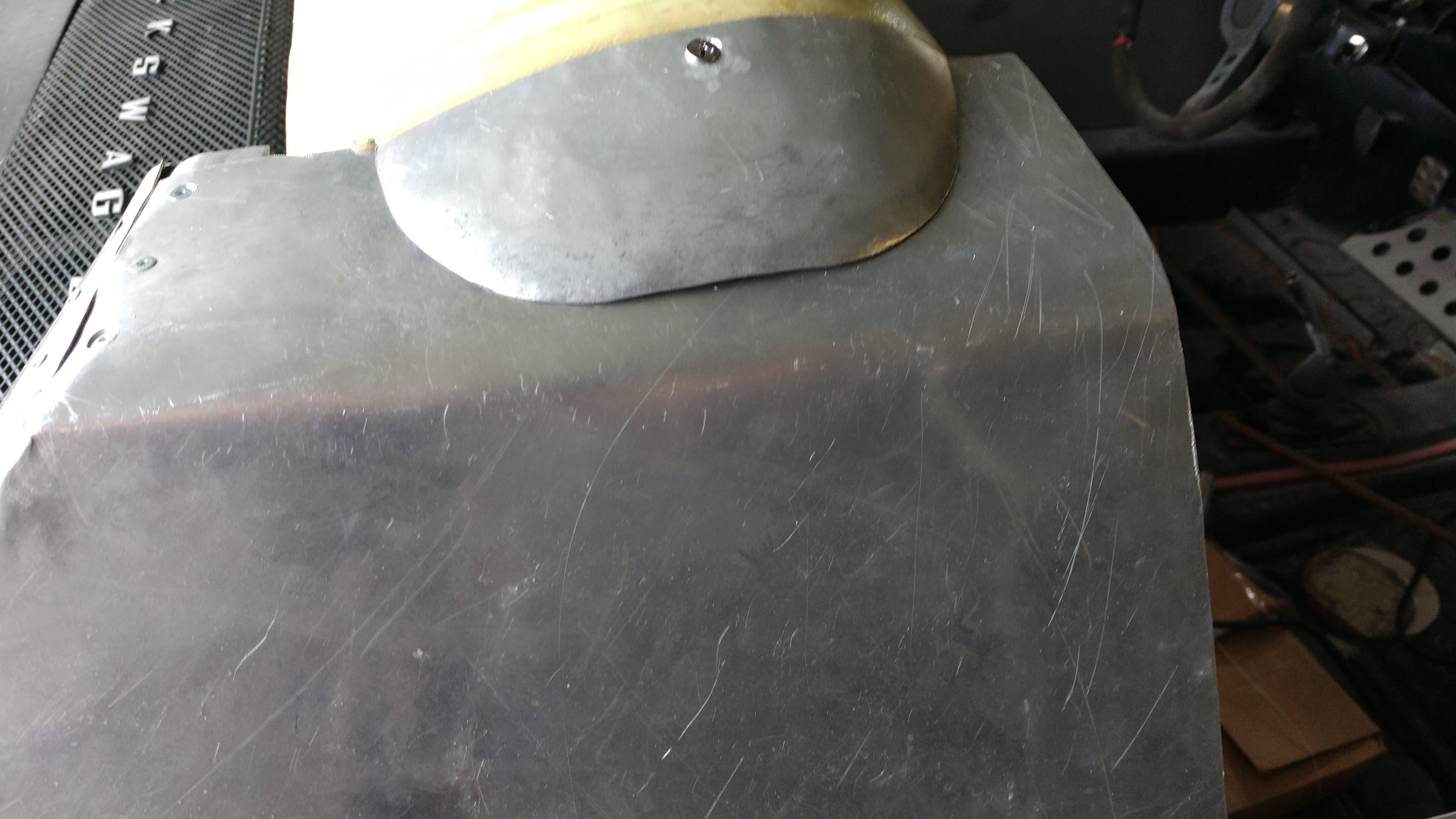

Doing some more fitting of the end cap of the targa bar fairing. It's looking really nice and cleans up the area where the targa bar fairing joined Cold Air Intake scoop. This is the right side.
914 Ranch
post Jun 13 2020, 06:42 AM
Post #335
Posts: 1,506
Member No.: 19,611
Left side ready for fitting.

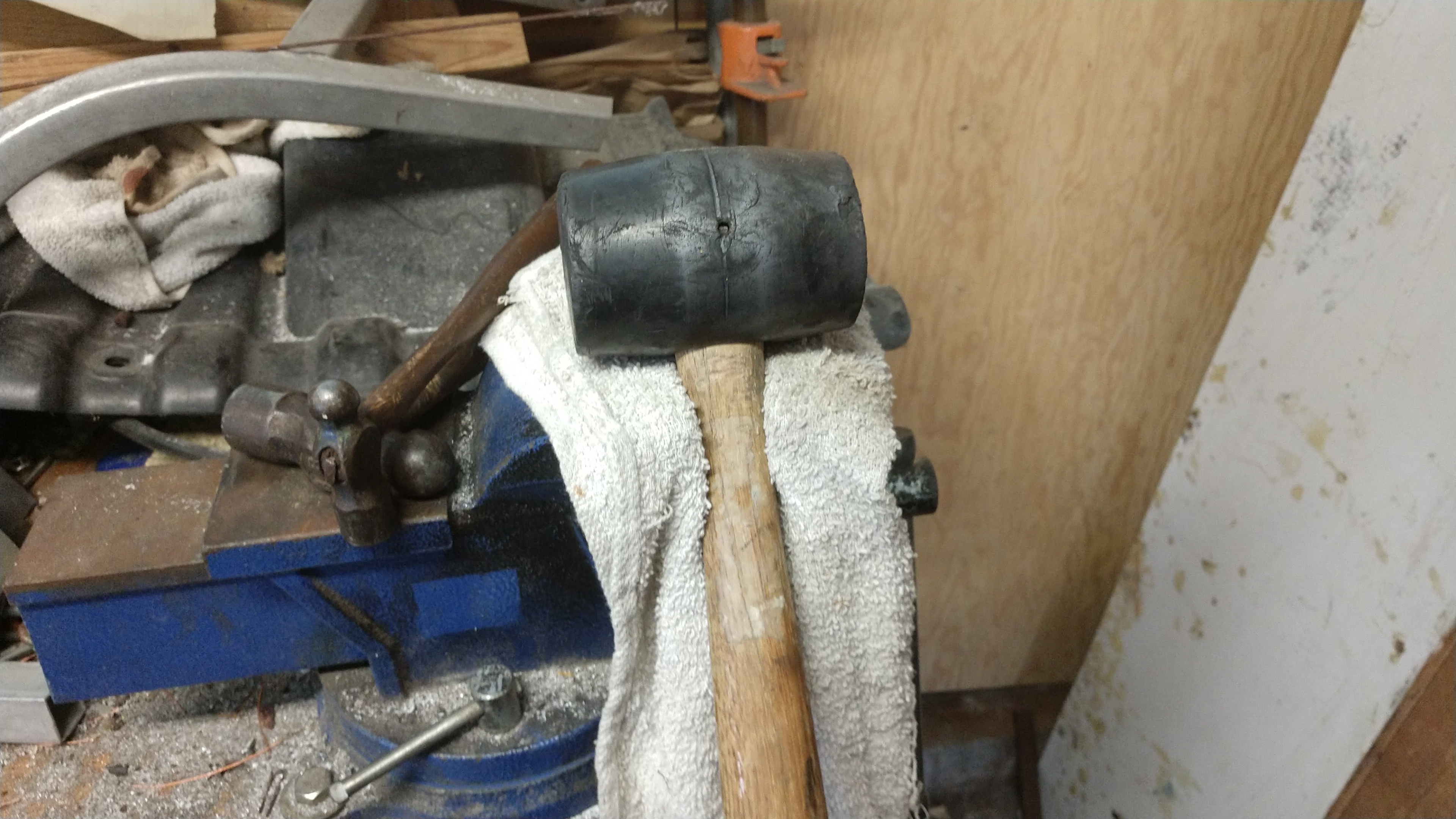

If they look a little hammered it's because they are. I used a small ball peen hammer beating the aluminum into submission over a large rubber mallet mounted in my vice.

Looking nice. What did you use to shape those end pieces?
914 Ranch
post Jun 14 2020, 08:49 AM
Post #337
Posts: 1,506
Member No.: 19,611
I don't know what alloy that aluminum is but it is soft enough to be playable and still hold a shape.
I used the 3 hammers in this picture. The body of the end cap was shaped with the larger ball peen hammer on the outside radius of the mallet and the edge was formed on the edge of the face of the mallet.
Thanks for asking Scott, that was a bitch... But it looks better in person than in the pics.
The small hammer worked best for the edges.

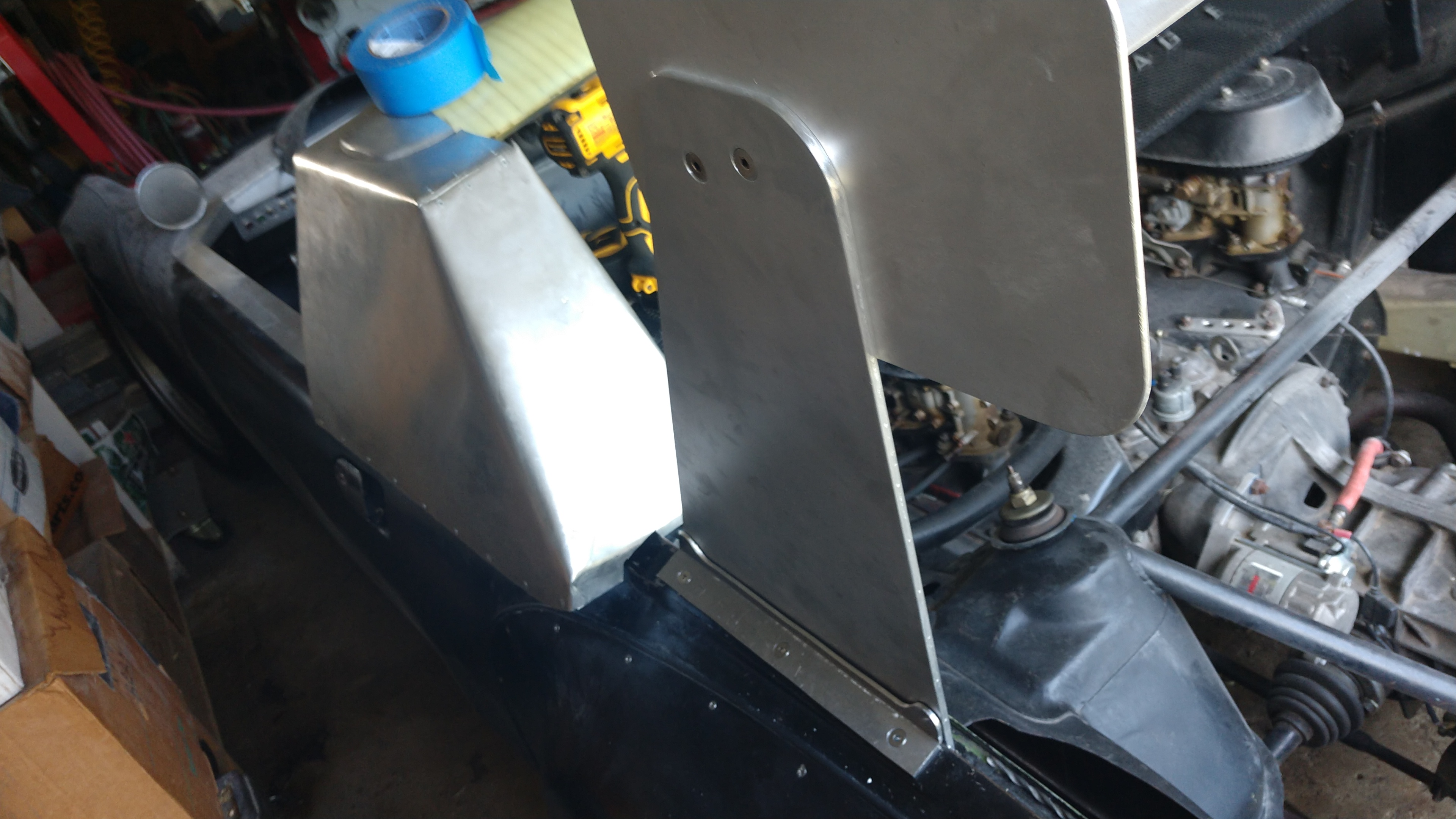

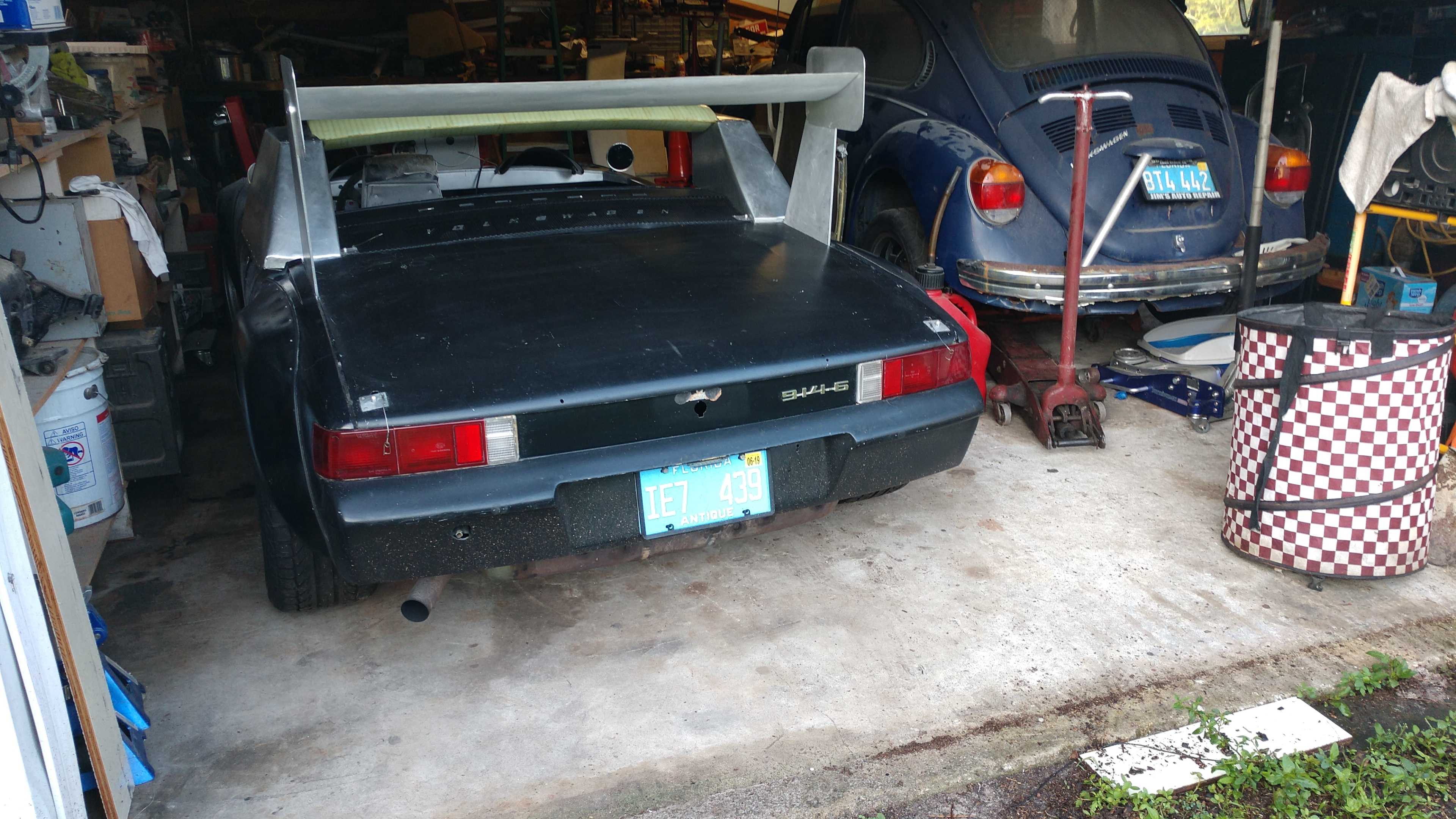

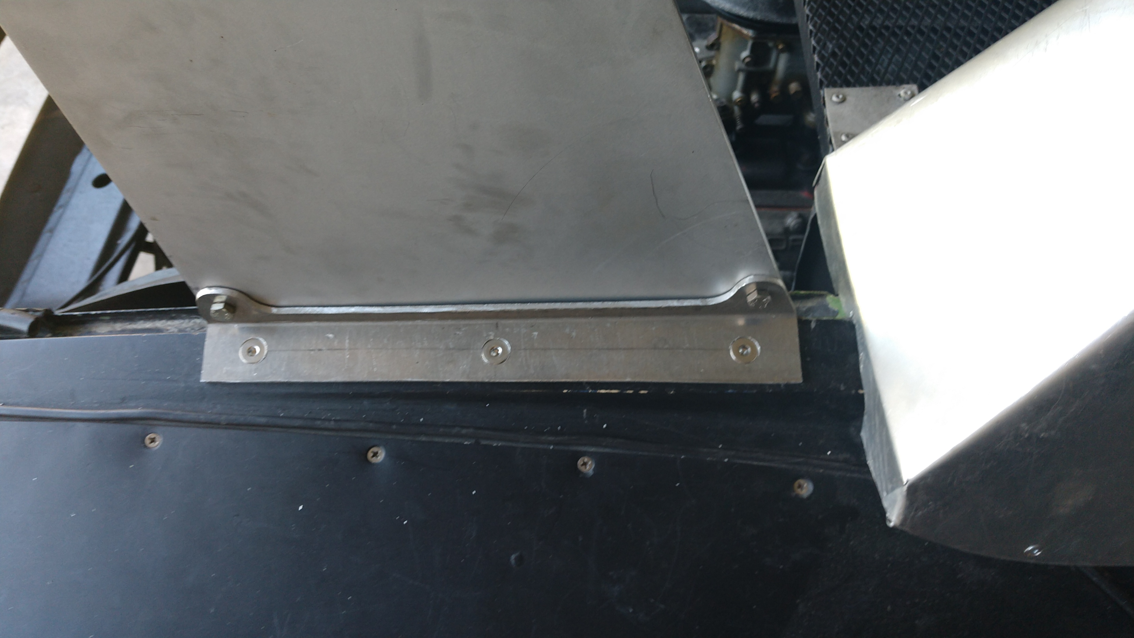

I spent the day mounting the rear wing to the rain gutter just above the rear tire.
The bracket.
914 Ranch
post Jun 15 2020, 01:18 PM
Post #339
Posts: 1,506
Member No.: 19,611
With the wing in the picture.
I put some backing on the inside of the top of the fender just in case.

Rear wing brackets for the driver side.
