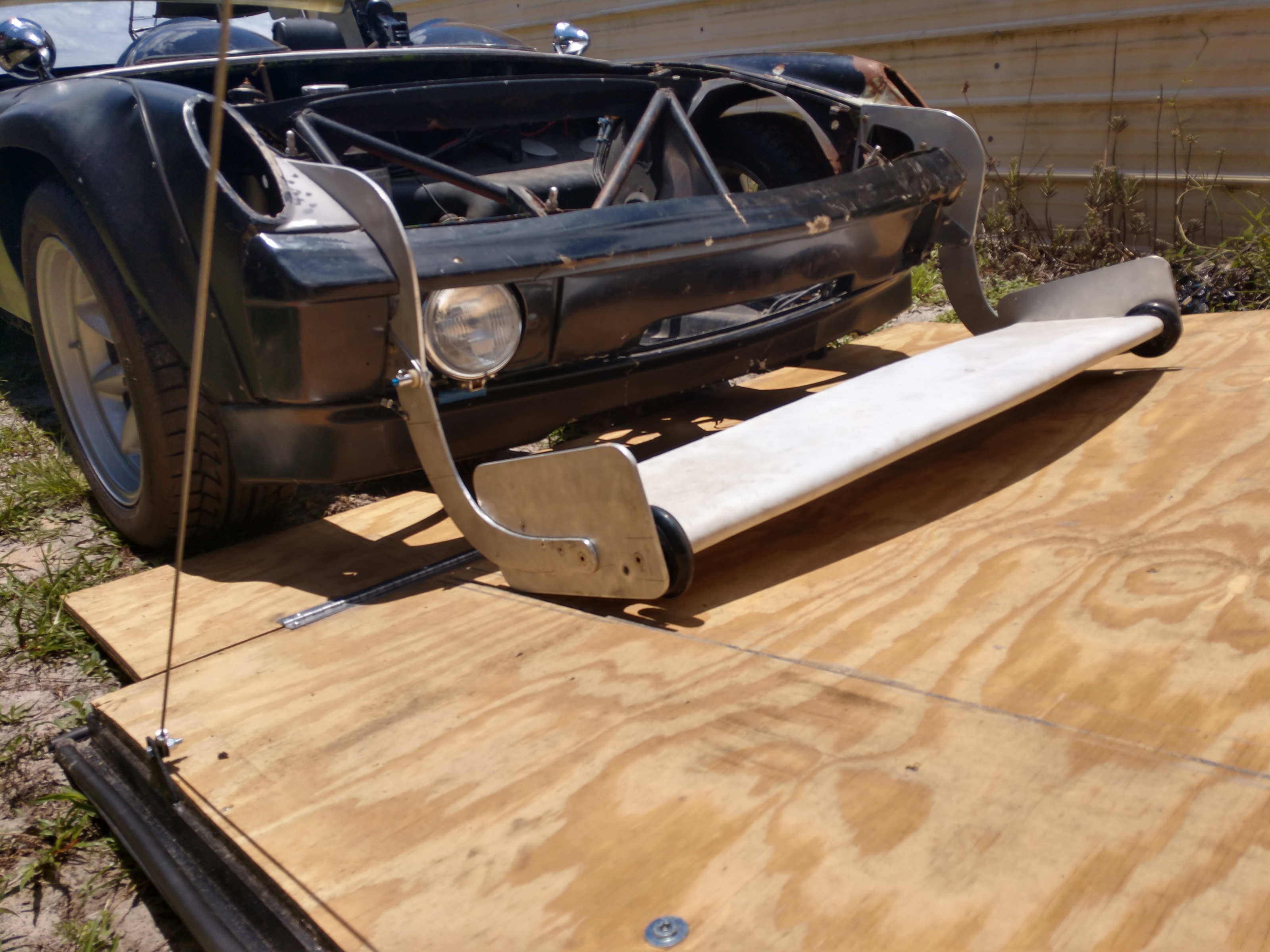

TOTAL Failure at the front wing wheels. As I was trying to put her in the trailer yesterday I heard a terrible noise and she got stopped in her tracks. So I backed up and got out to go see what damage I had done. The end plates had contacted the ramp and didn't like the hinge or the plywood on the ramp. No damages to anything just a lot of noise. Apparently the wheels need to be much ferrthur forward, a little more than an inch. Apparently the end plates don't like to be pushed around. Pics after daylight.

QUOTE(914 Ranch @ Apr 28 2021, 02:24 AM) *
I’ve wanted to say this ever since I read about your idea of the retractable wing. I was hoping I was wrong, but this incident has me concerned.
I’d look really hard at what that wing might do at speed if/when getting hung up. It’ll lift the car and fold underneath causing all sorts of havoc to the car, you, and most likely bystanders. I think the test on the plywood should be a wake up call that anything taller than the wheel clearance will be an issue. As autocross locations become more difficult to find, the quality of road decreases.
I’ve seen cracks and transitions in pavement at several local events that appear to be taller than the skid clearance you have.
Perhaps a modified bottom plate shape might help the end plates be more like a skid vs a hang up point. I also keep thinking about that plastic material they use to easily slide furniture around maybe some sort of adaptor, that can be swapped out as it grinds down... they have lip protectors for modern super cars that operate on same principle.
(IMG:style_emoticons/default/poke.gif) sorry rant over, I saw your problem before it occurred and didn’t say anything, I just want to offer my thoughts in case of building a better mousetrap.

Today I was working on the wheels on the front wing. I moved them up and forward which put them completely over the front and bottom of the end plates. The end plates have small scratches on the bottom front where they contacted the plywood and the plywood has what looks like skid marks and the hinge is only scratched. It's raining now so no pics.
I installed the wing back on AR.

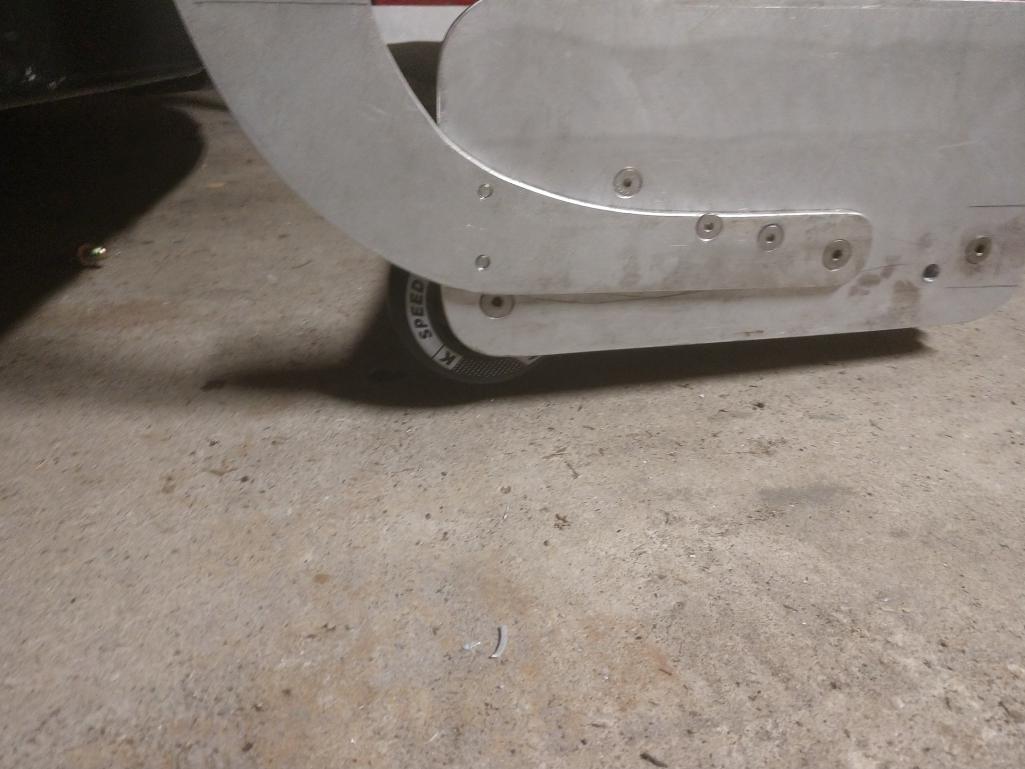

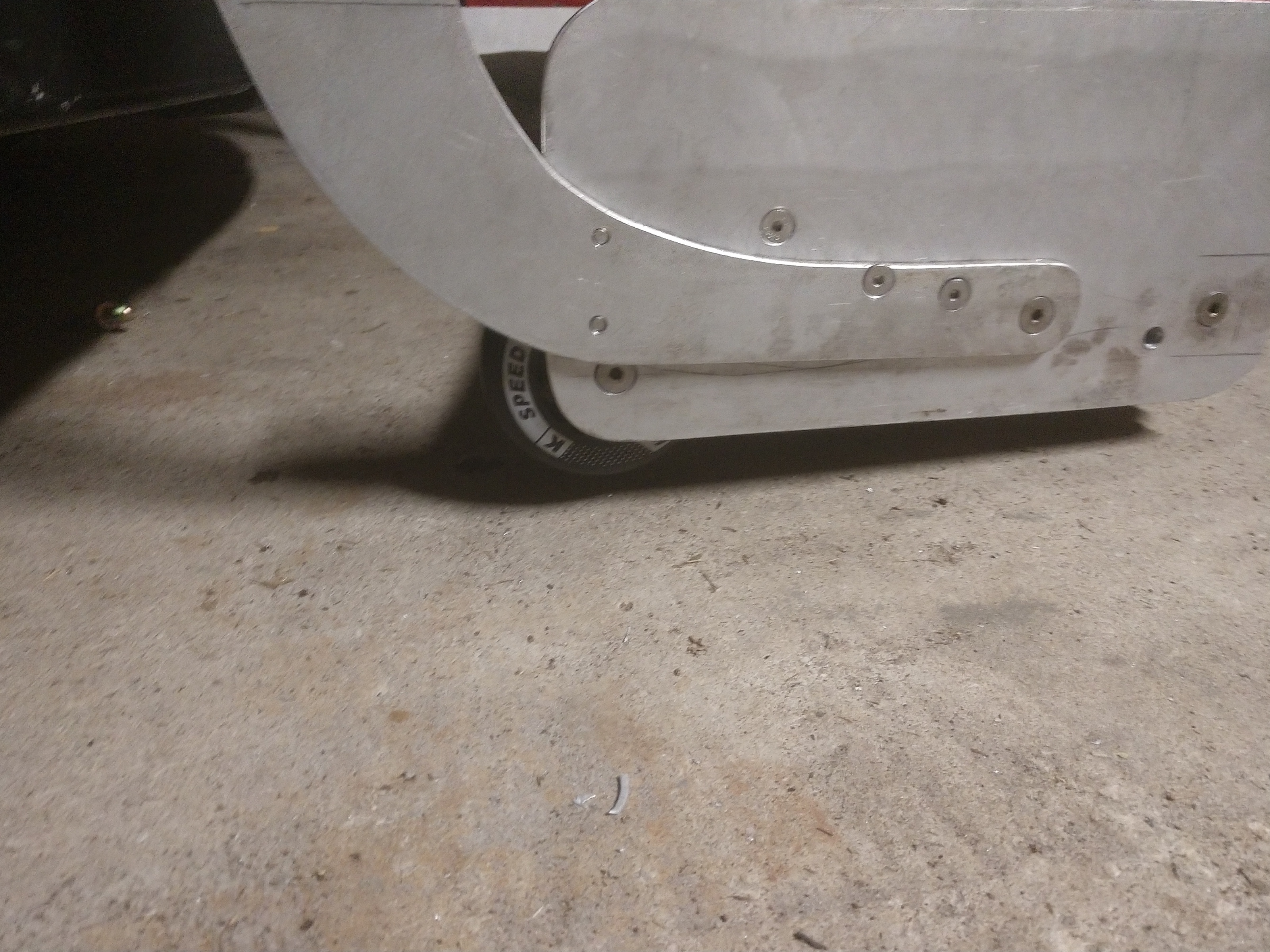

I was putting her back in the trailer and ran out of fuel. So I took this pic of where the scraping is coming from.
From the beginning of the brackets I knew that the end plates would be holding the wing up over speed bumps but this had not occurred to me. It is why I made the end plates out of 1/4 instead of something smaller. We'll see how it goes.
Without the wheels or the pivots it probably would have bent something.

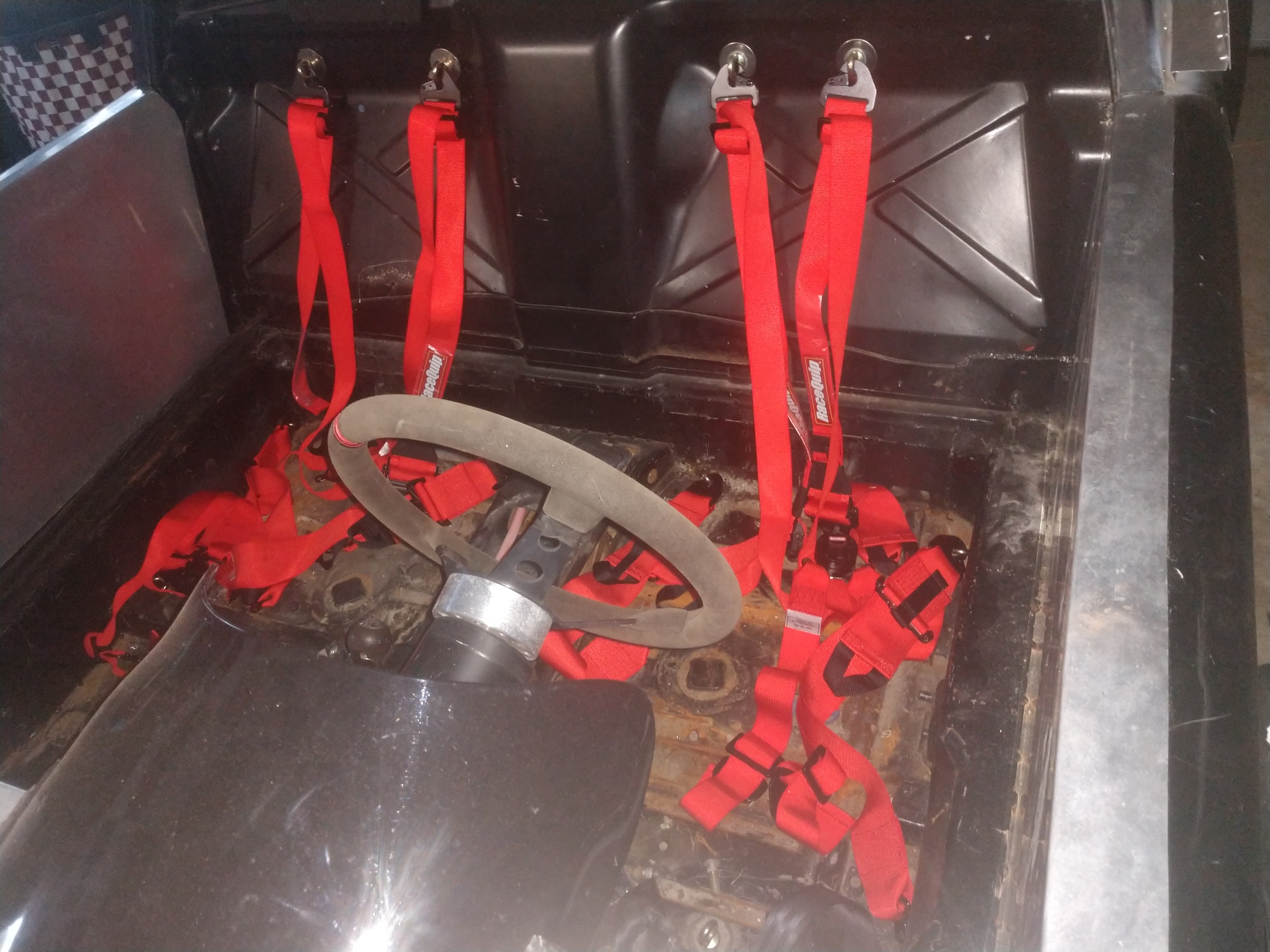

New seatbelts. Thanks Scott.
Reassembly tomorrow.

For the front wing, is there a way to put wheels on the back side of the wing? Or at least some sacrificial skid material like plastic or jabrock?

Thanks Scott @stownsen914 , already done, did it right after I took that picture. Now 4 wheels under the wing. Taking a break right now after I got the seats back in. Pictures later today.

Can you get away with just taking some material off of the rear bottom radius of the end plates? Doesn't look like you need much room.

Hey Kevin, I probably could have but I think that this would be easier as I didn't have to remove the end plates.

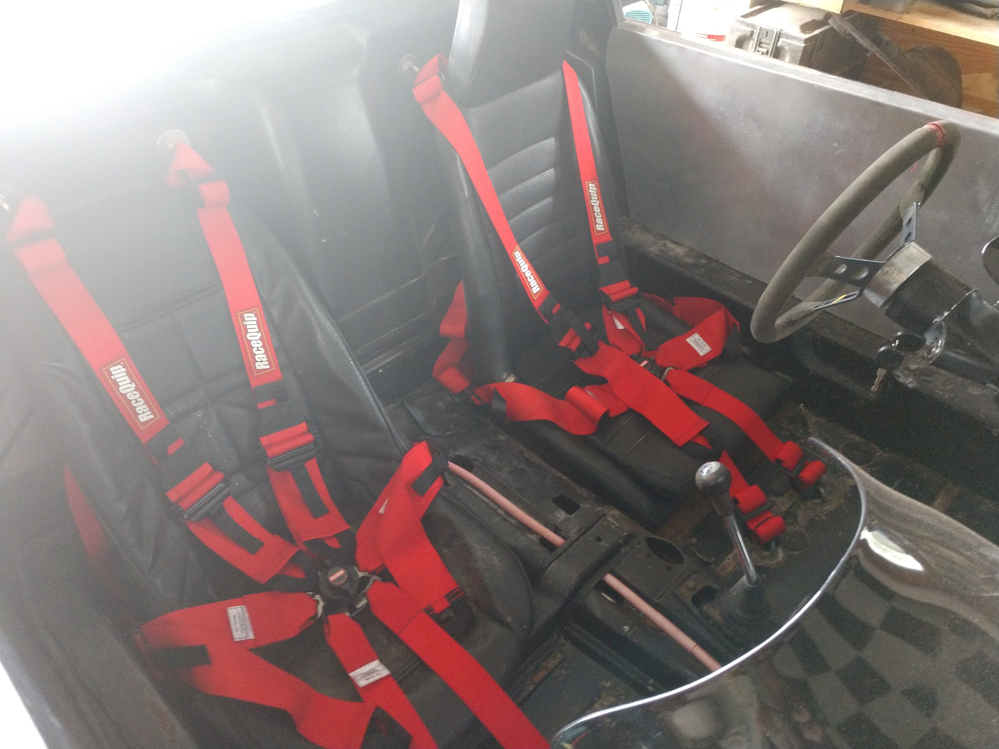

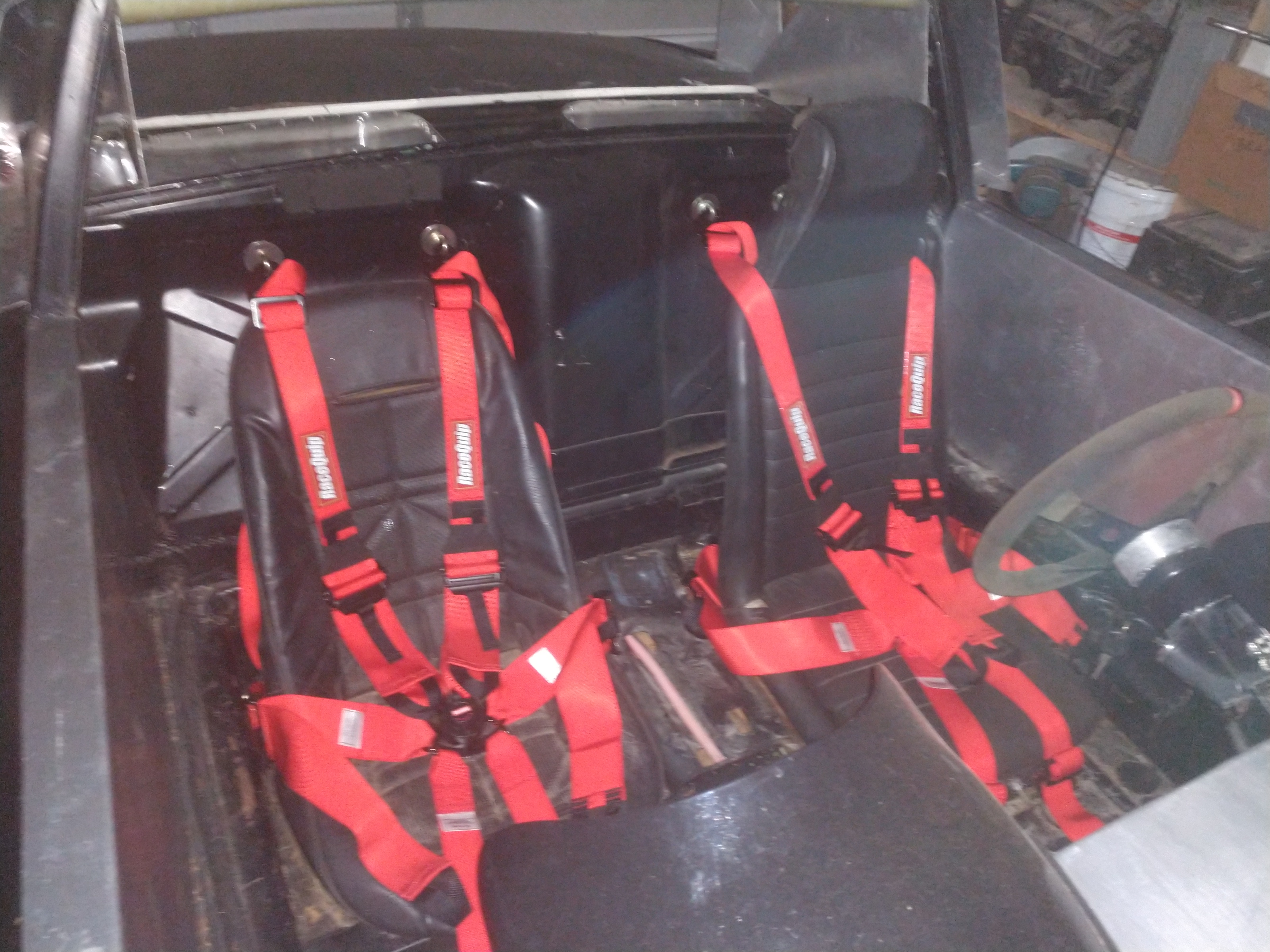

New seatbelts ready for fit testing.
Adjusting them is a pain in the ass so I hope that they fit correctly now. Then I can hot knife off the excess straps.

Well I finally got it correctly adjusted. I had to pull the driver 3 times to get it right but now it's comfy.
I know that this photo looks just like the one above but the drivers seat is about 4" closer to the firewall and the belts have been adjusted.

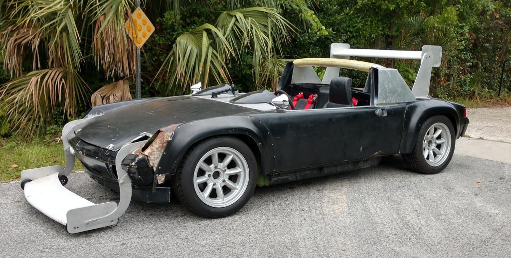

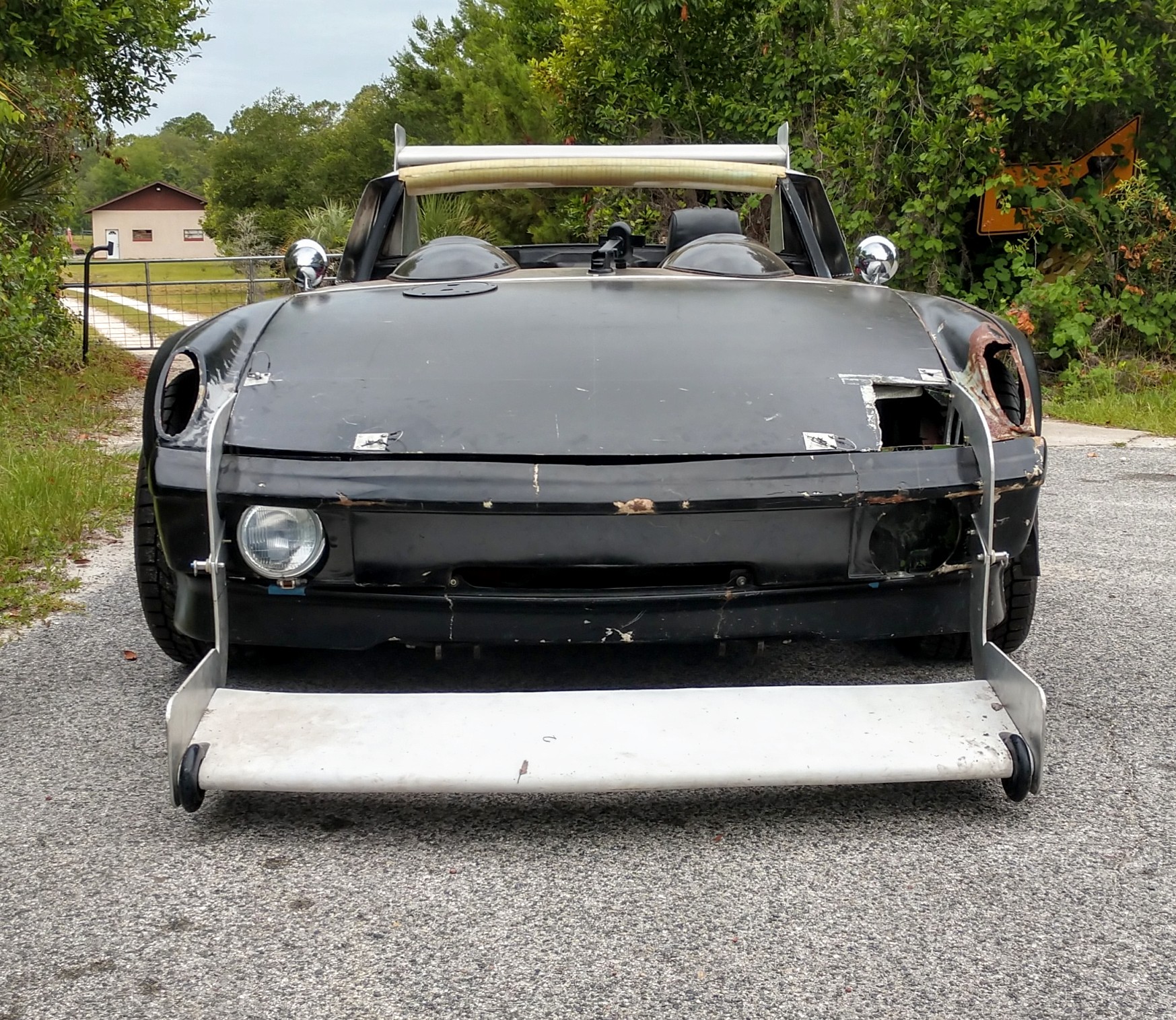

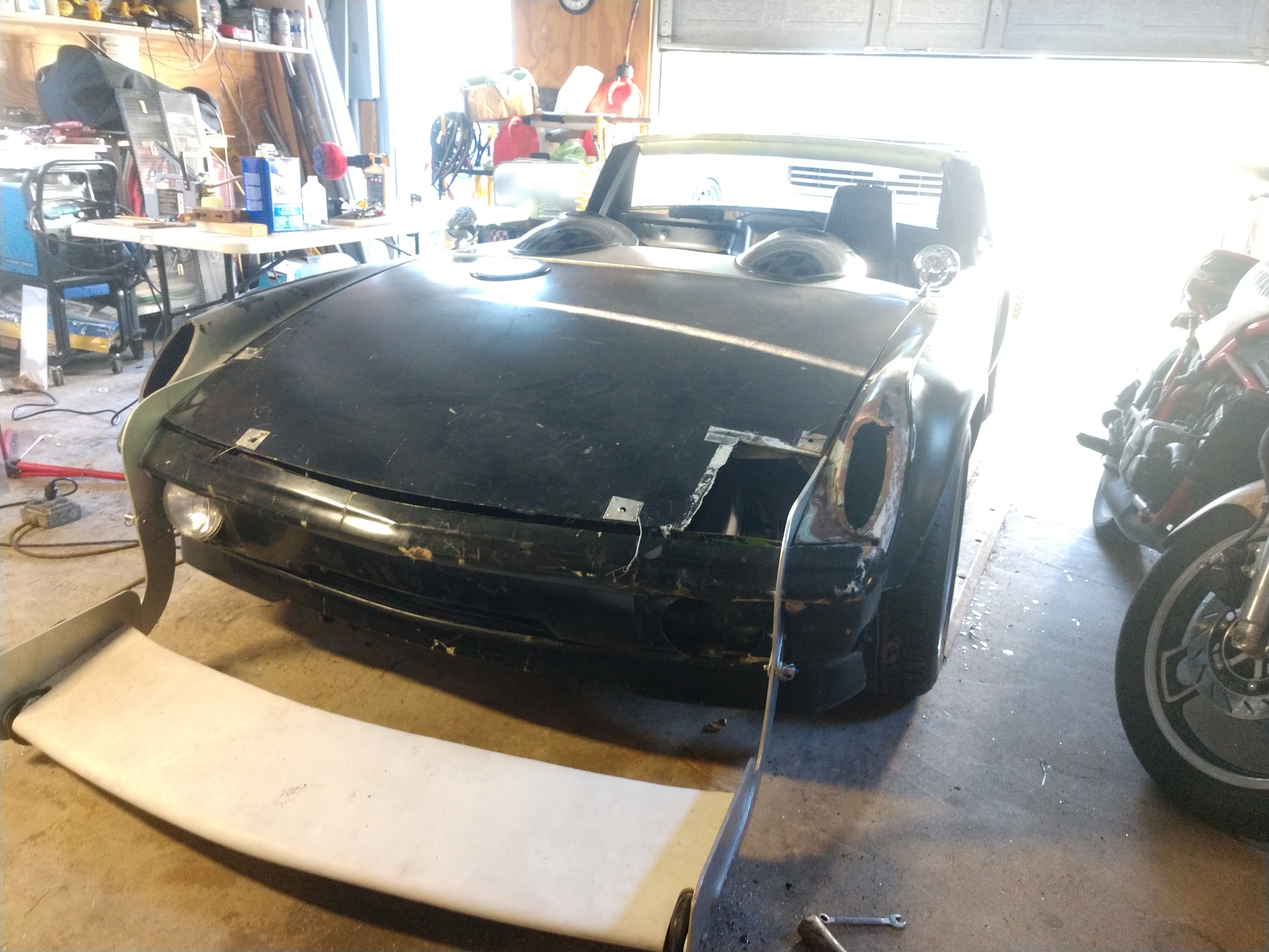

The pictures Scott @stownsen914 and a few others have been waiting so patiently for.
914 Ranch
post Jun 7 2021, 06:02 AM
Post #418
Team Sharp where the 914 grow wings
Posts: 1,506
Joined: 29-January 16
From: TheNorth Shore Retreat. Deland
Member No.: 19,611
Still needs a lot of work but I really wanted to see her on the pavement too.

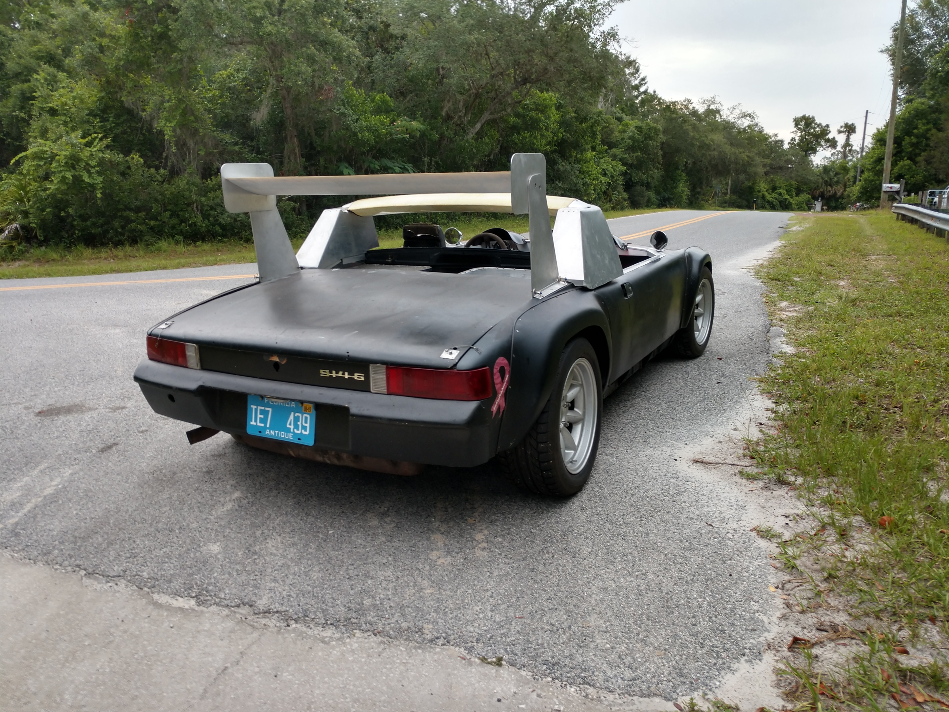

At least I got some pictures for you finally.
She is going back up on the stands for some suspension work and the rear wheel bearings and new wheel studs.
