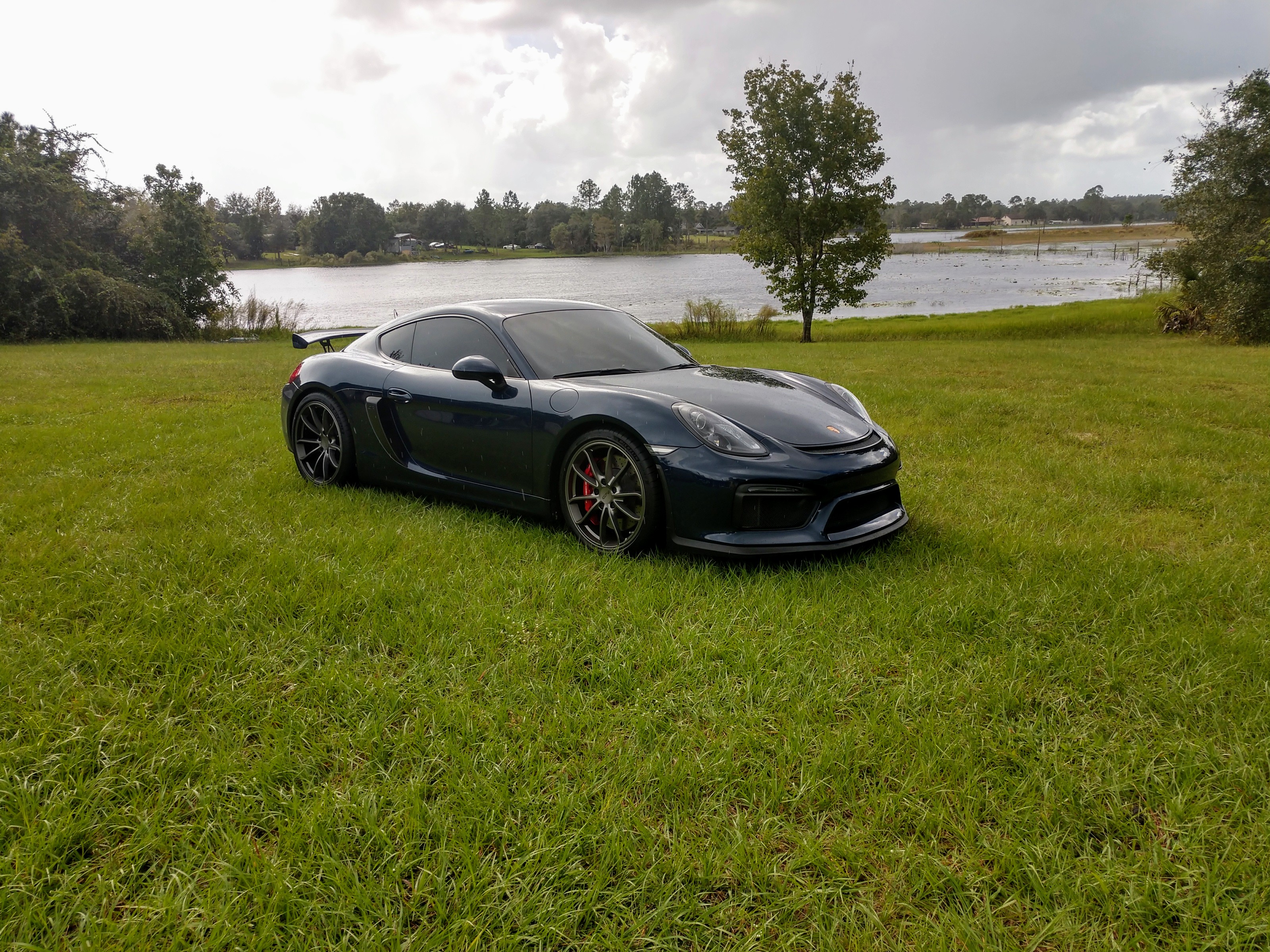

Thanks, everything is good out here. Turning 73 this week and heading out for the Route 66 next week in this.
Going to be in Ca for a few days as I need to see some relatives. I believe I will be staying in San Juan Capistrano.

Wow, 26,000 viewers. Thank all y'all so very much. I really appreciate that.

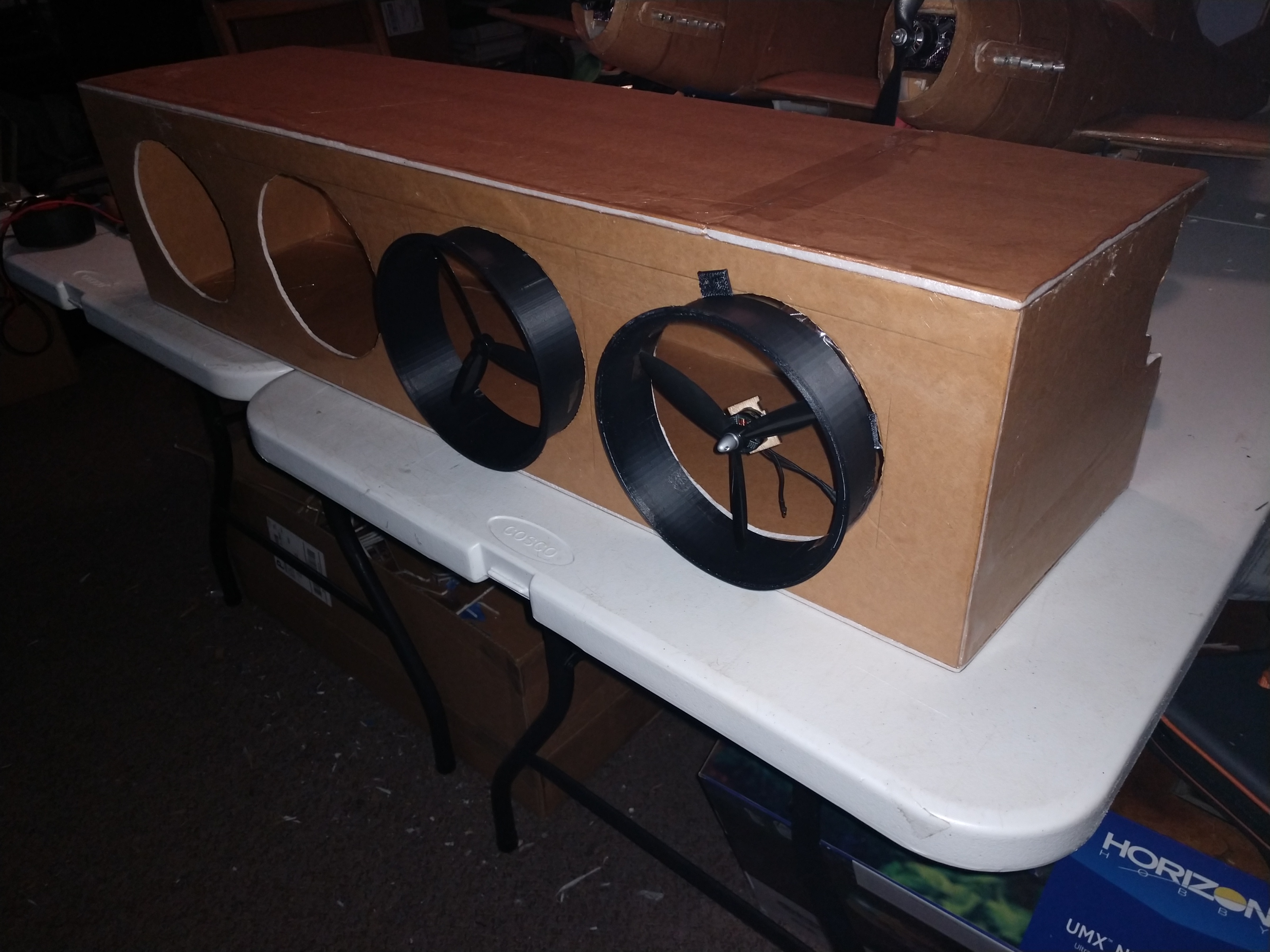

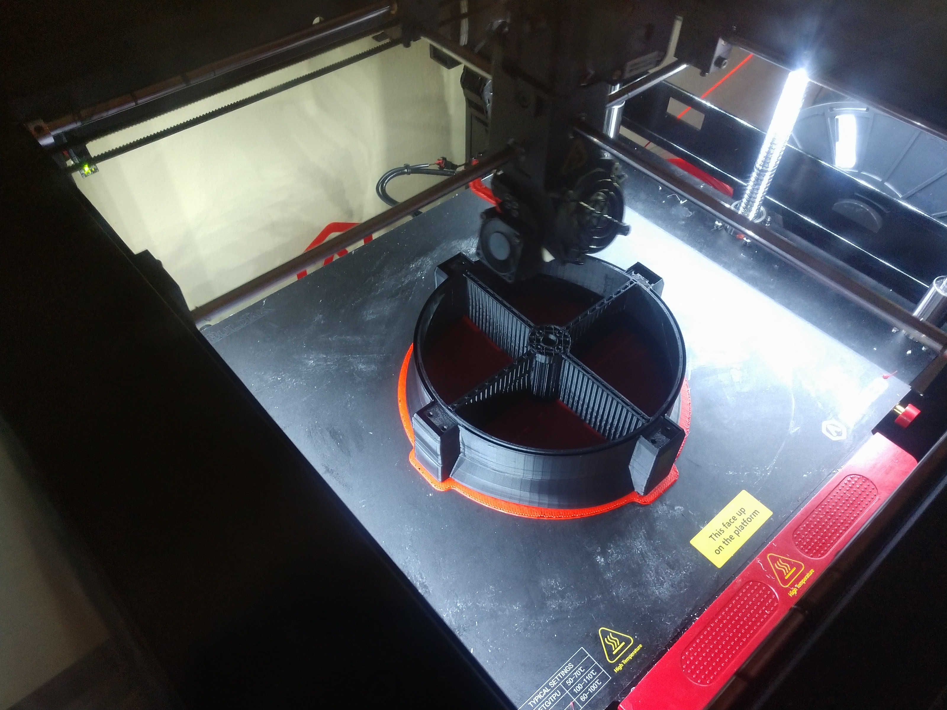

And now for something completely different. Actually working on the car at this time. There is a 3D printer in the house that is currently working on a project for the car. It's printing a fan housing for an oil cooler that will be mounted in the trunk with the exhaust out the rear panel in-between the tail lights. It will take 4 fans and some duct work but I won't have to run -10 to the front of the car.
Print in progress.
This is a prototype and needs some corrections. It will take 4 fans and they push 800 Cubic feet per minute each. But that's probably not enough thrust to make the car roll.
sixnotfour

Thanks Marty, I need to make more of an effort to get to the end of some of these little projects and that will be a lot of progress.
The printer is down for the moment but I am making progress on the fan housing.
The radiators should be here by Thursday and I am hoping that the motors arrive here by then.
Don't mind the pun.

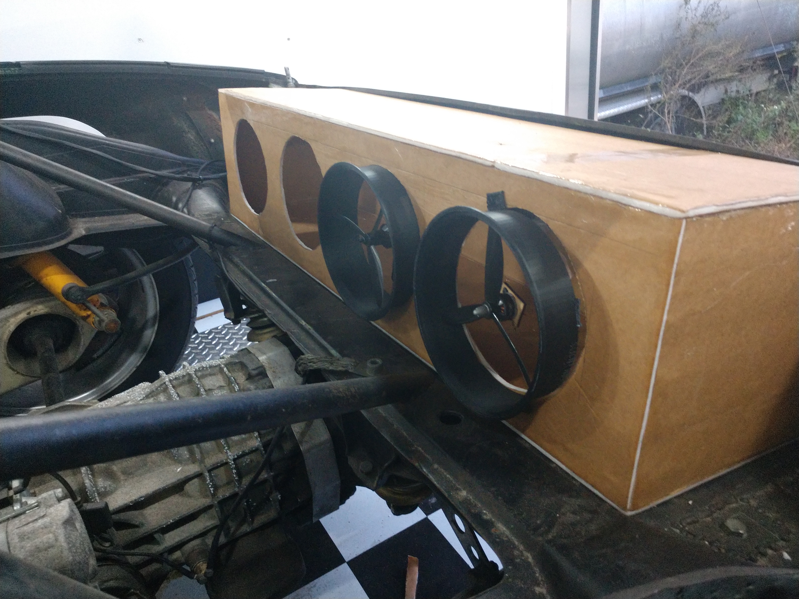

The printer is still waiting on parts but the motors are in. Now we know how long to make the tube and where we putting the propeller. We're making some corrections to the part and learning about the printer.
More pictures.

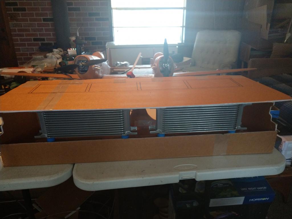

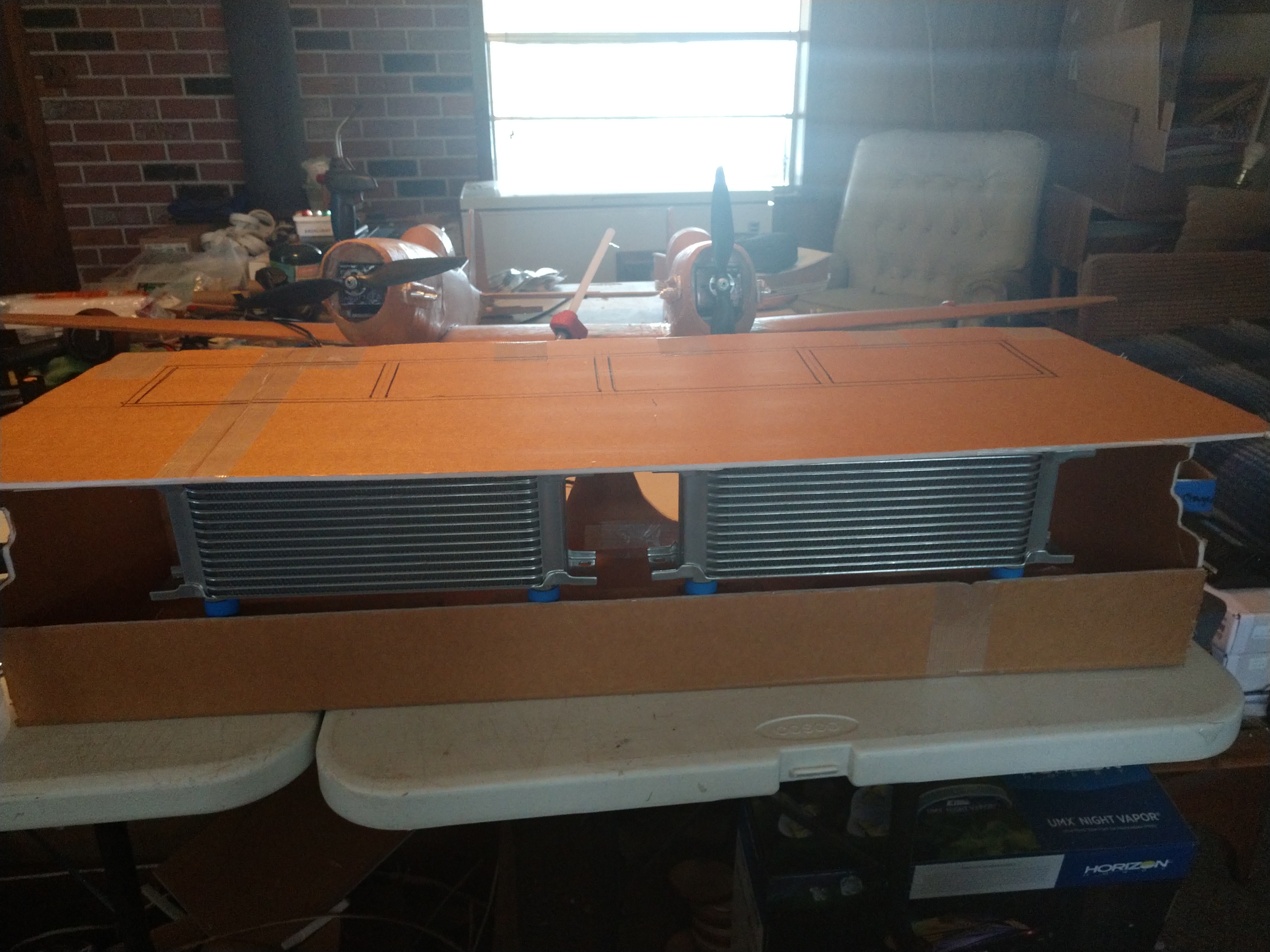

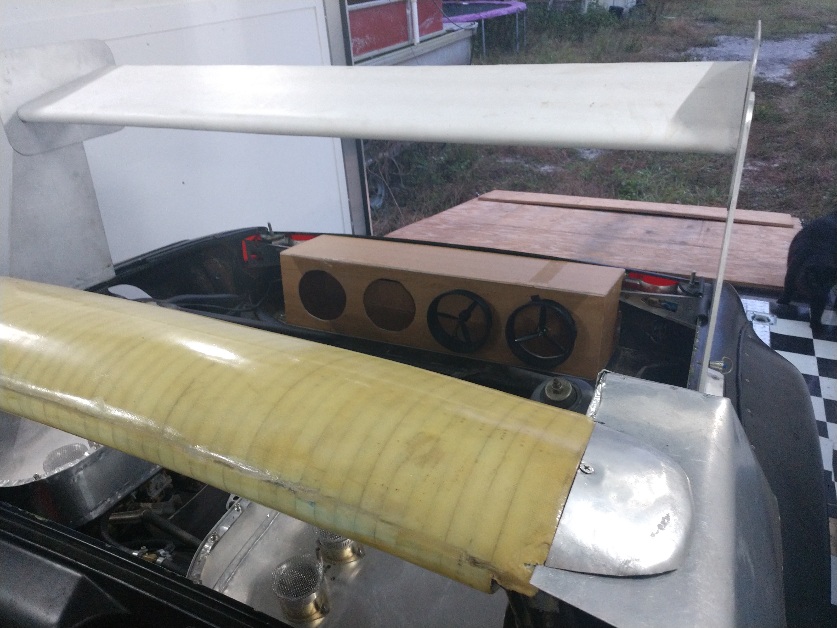

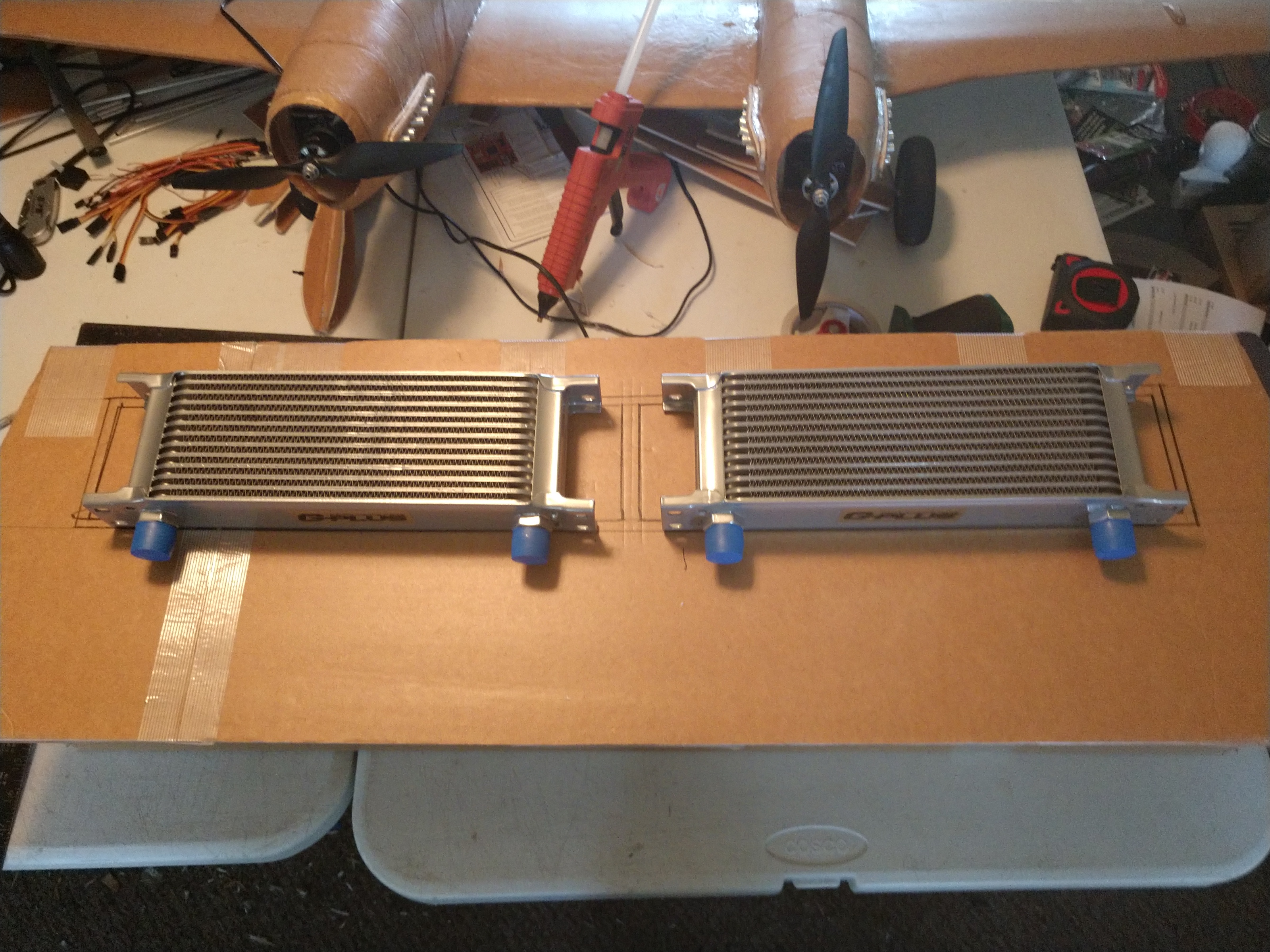

The radiators have arrived, need to start getting ready for the hoses.
Personal I believe that a serious Autocross car doesn't need much of a cooler because it is only driven in anger for a minute at a time. Front brakes probably don't need to be vented either. Which is heavier? Vented or unvented? I really think that unvented is the way to go.
Behind the radiators is the layout for the grills. Using 4 of the side grills as I don't have a full engine cover grill to spare here. It will work. Got the mounting worked out, doing it off the shelf on the rear panel in-between the tail lights.
914 Ranch
post Nov 18 2021, 01:45 PM
Post #440
Team Sharp where the 914 grow wings
Posts: 1,506
Joined: 29-January 16
From: TheNorth Shore Retreat. Deland
Member No.: 19,611
Now you can see the layout for the grills on top of the box. I think the coolers will set a little lower in the box than this. The shelf is at the same elevation as the bottom of the hole. They will only come down about an inch.
