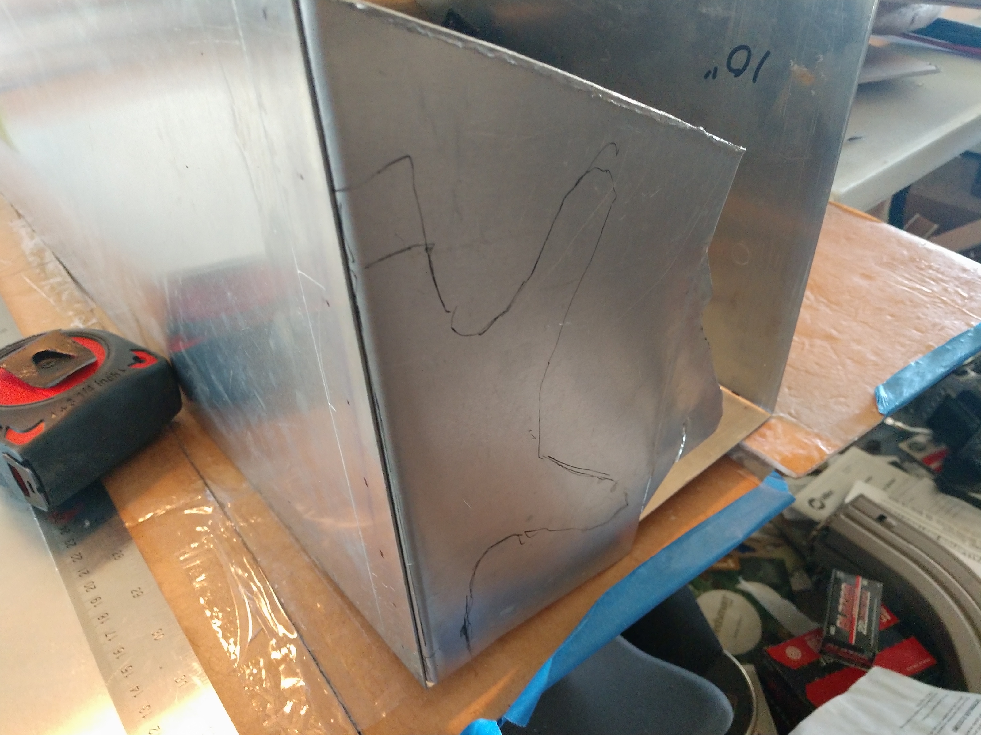

So I actually did something to the car today. I bent the cover to the air box on the oil cooler.

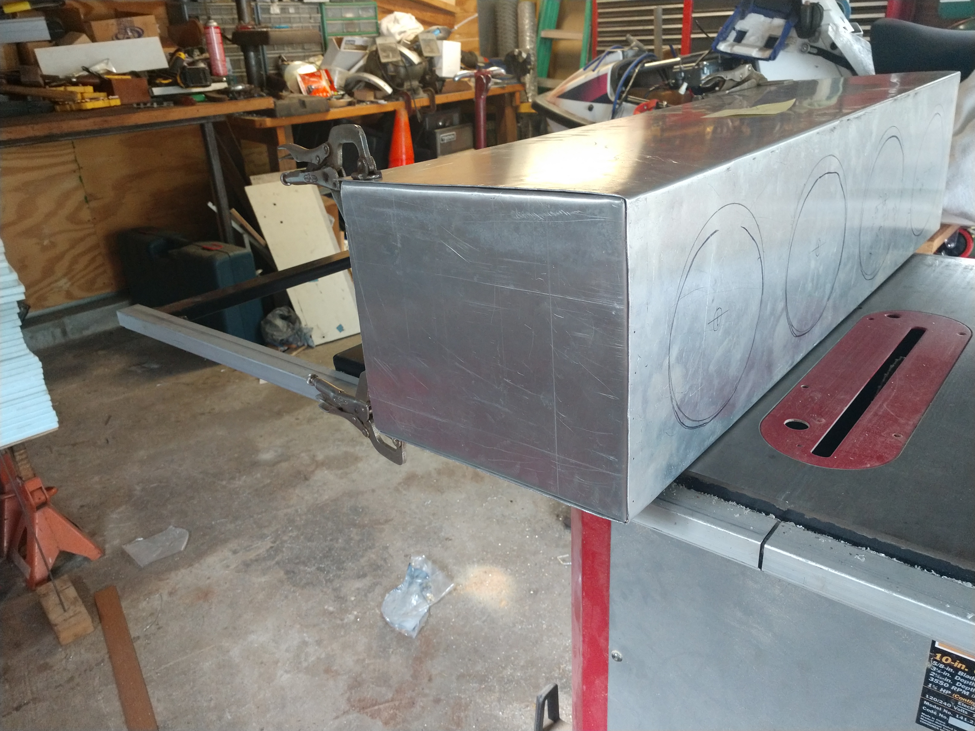

I ordered a nibbler to cut the holes with and I am planning on putting the end caps in with flathead rivets, like every 2".
As it turns out every 1.25" inches. I'm gunna need some more rivets.

Tried bending an edge flange for the side. I'm happy.

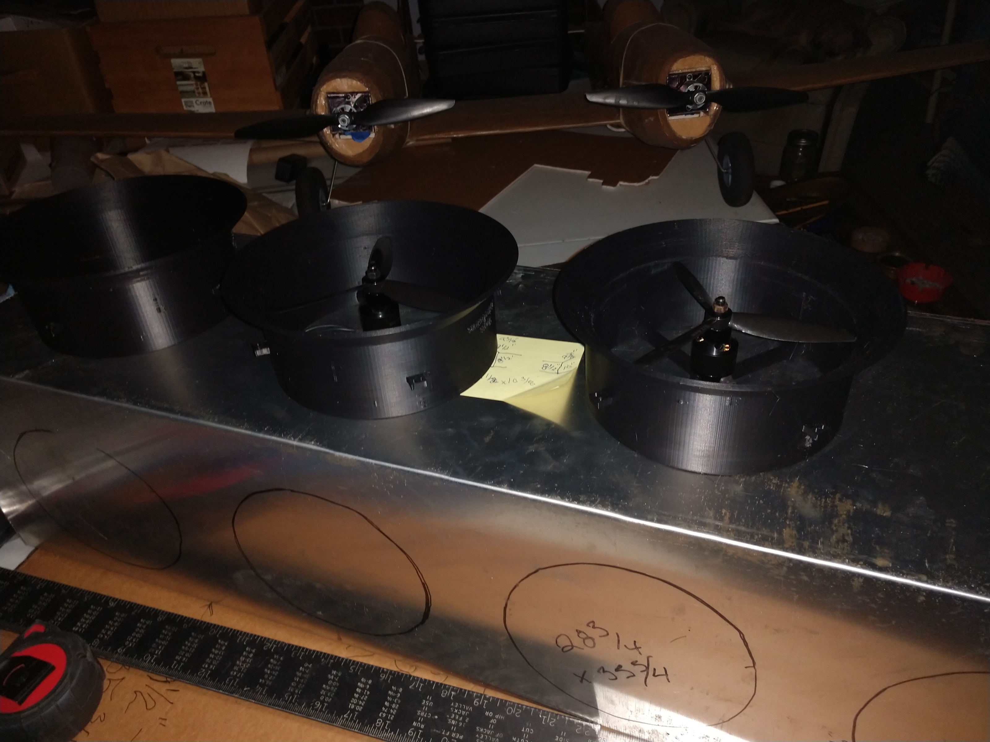

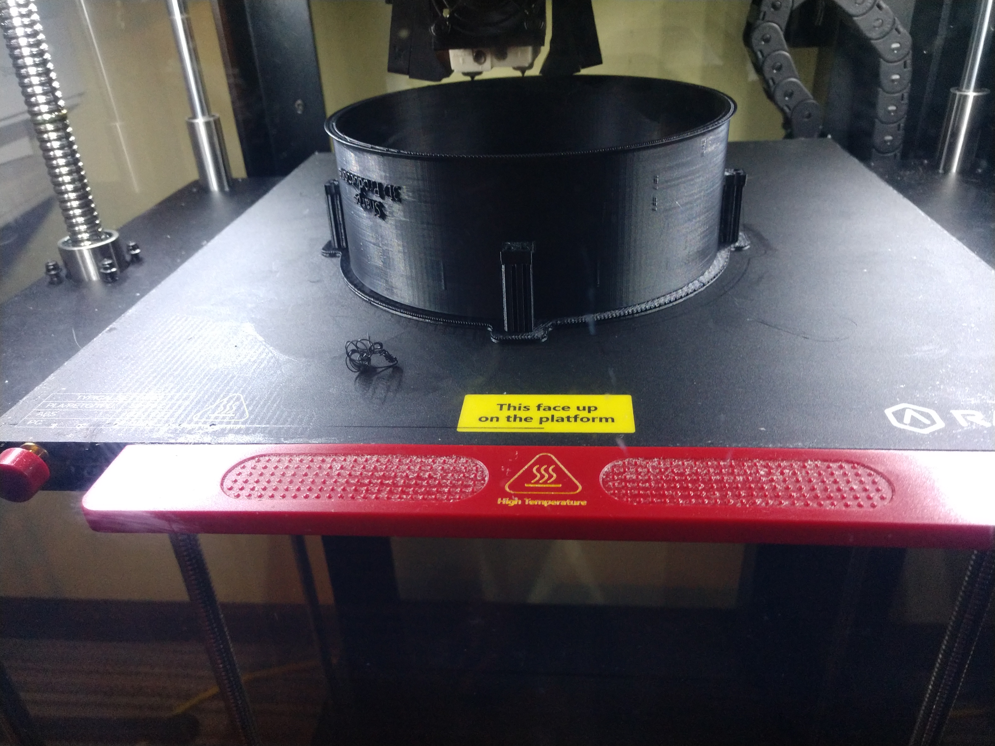

Number 3 should be done in the early AM. So l should have all 4 by 4:20 tomorrow afternoon. I ordered a circle cutter for the fans holes today and it should arrive by Tuesday. It's so nice to have progress on this.
914 Ranch
post Mar 5 2022, 05:30 AM
Post #473
Team Sharp where the 914 grow wings
Posts: 1,506
Joined: 29-January 16
From: TheNorth Shore Retreat. Deland
Member No.: 19,611

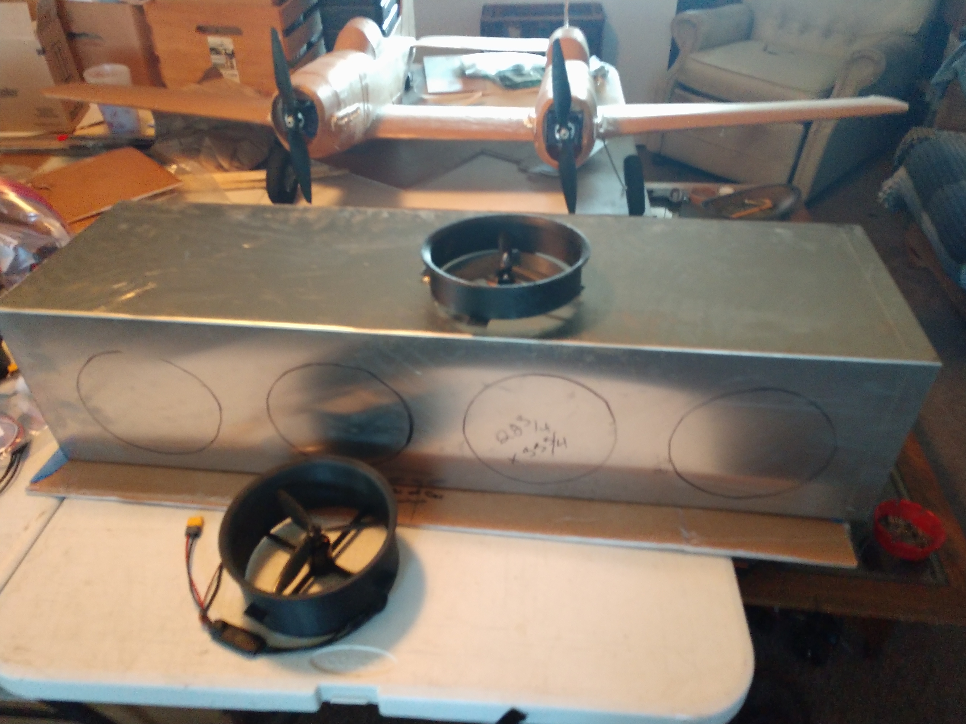

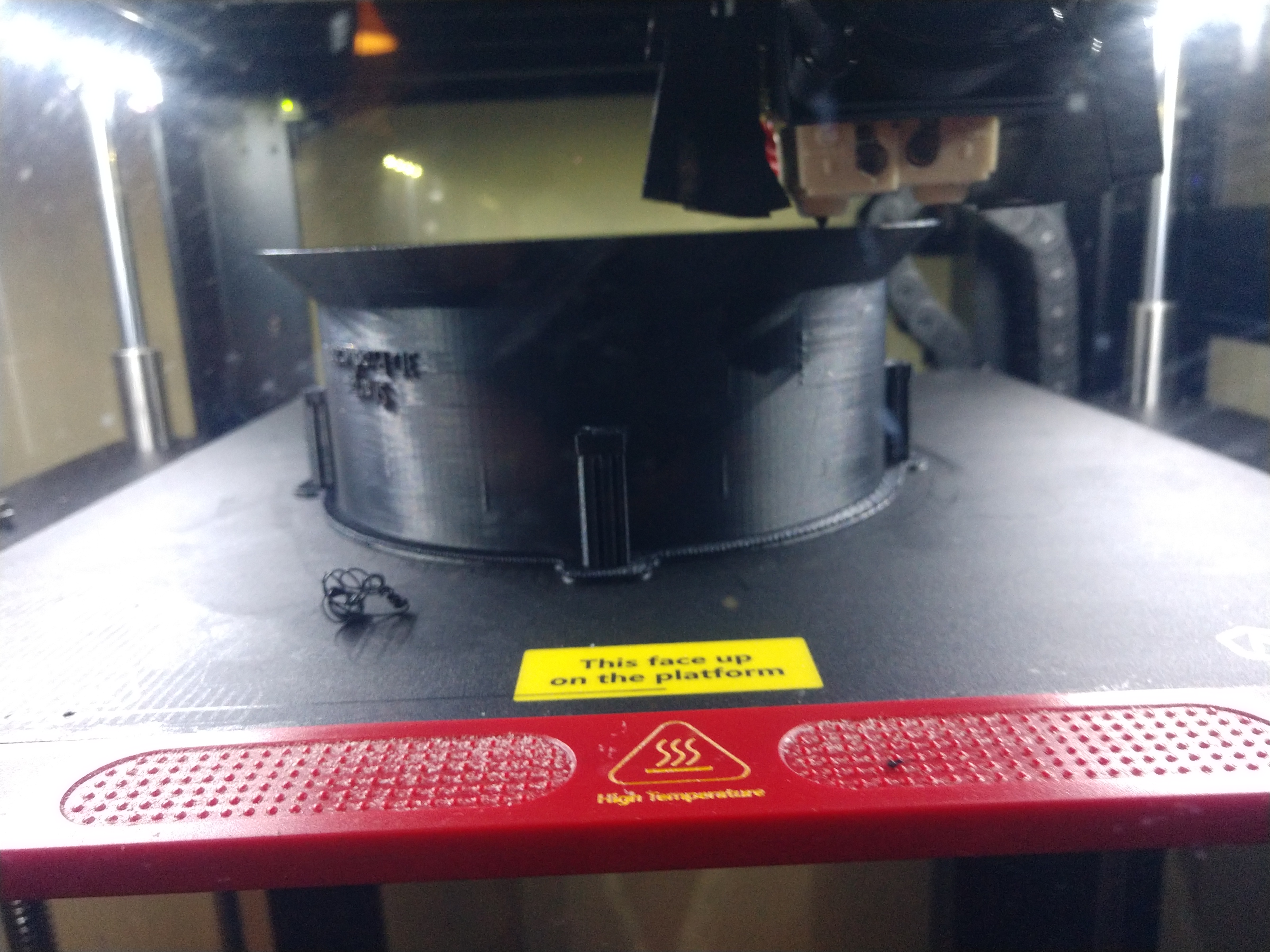

3 of the 4 bells and the last one is in the printer now. It will be done sometime around 5pm today. The propeller on the last bell on the right is installed and clearanced. I can't wait to hear all 4 of these babies pushing air.
I still need hardware to mount the motors to the bells and the bells to the plenum.

That printing is very cool. I would have been baking PVC pipe for the flare and sanding it down thin. Would have been done by August. (IMG:style_emoticons/default/wink.gif)

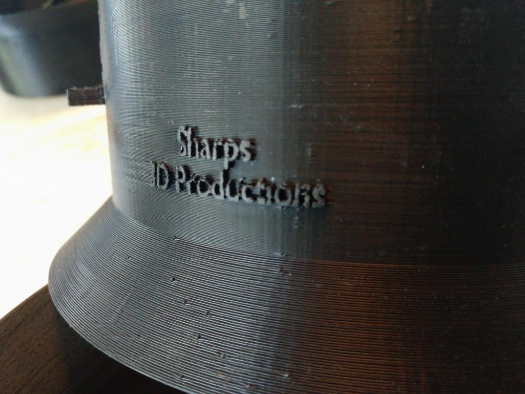

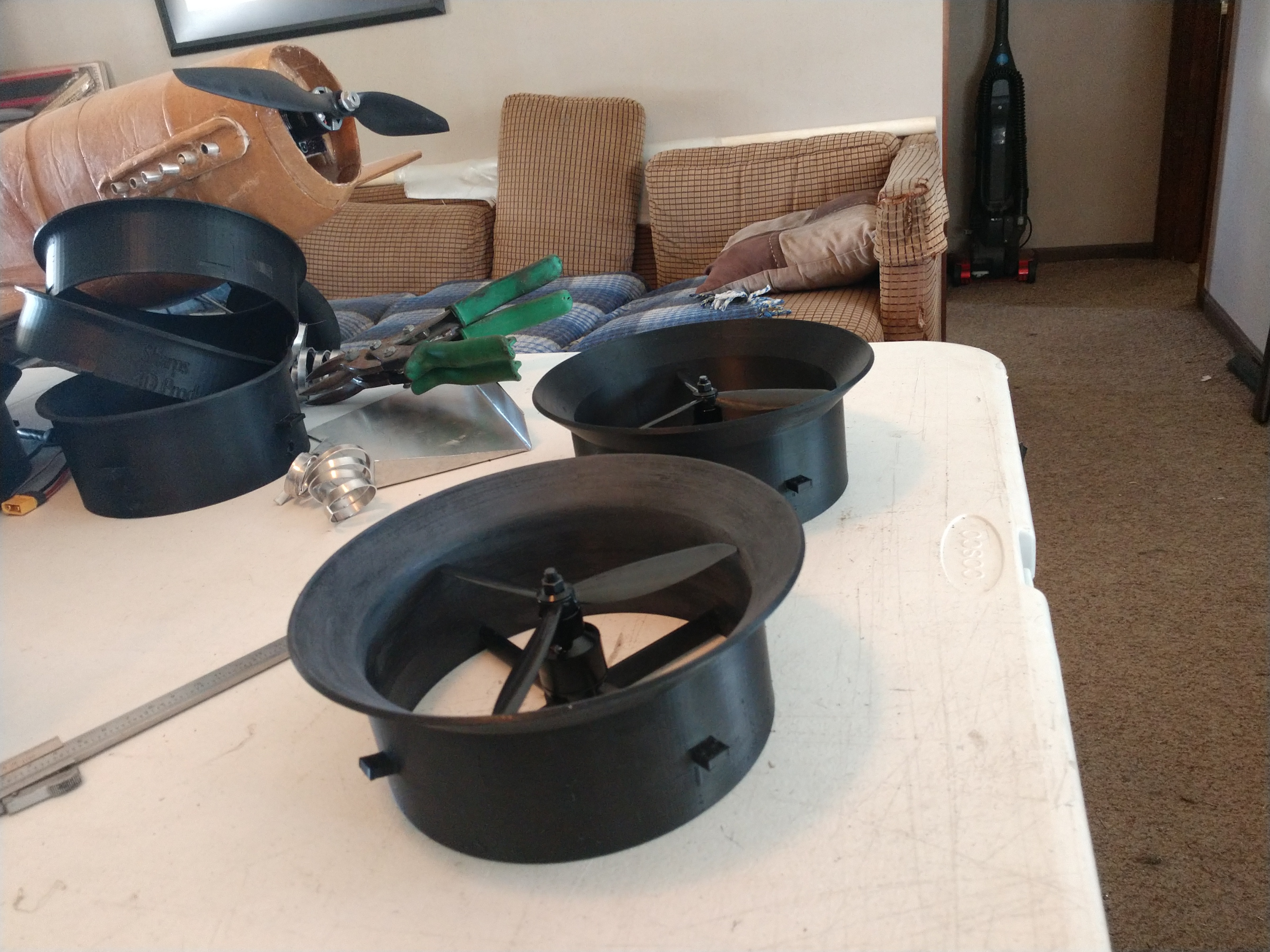

Yeah, I could never have made up the bell. I could have done the tube but after that I'm done. Sure it took some time to sort out the machine but it got done and I am happy.
The propeller touches some spots on the wall of the tube. Same place on all of them. So I'm cleaning up the surfaces with a file. Oh and breaking the lip at the bottom of the bell. Just like you were porting them.

They look awesome! I think that is probably the best thing about printing your parts. Where mine would function, yours will look factory. Next time emboss your own made up 914 part number on it. (IMG:style_emoticons/default/laugh.gif)

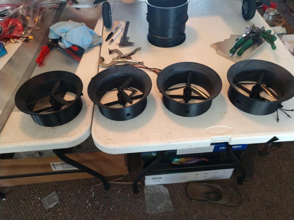

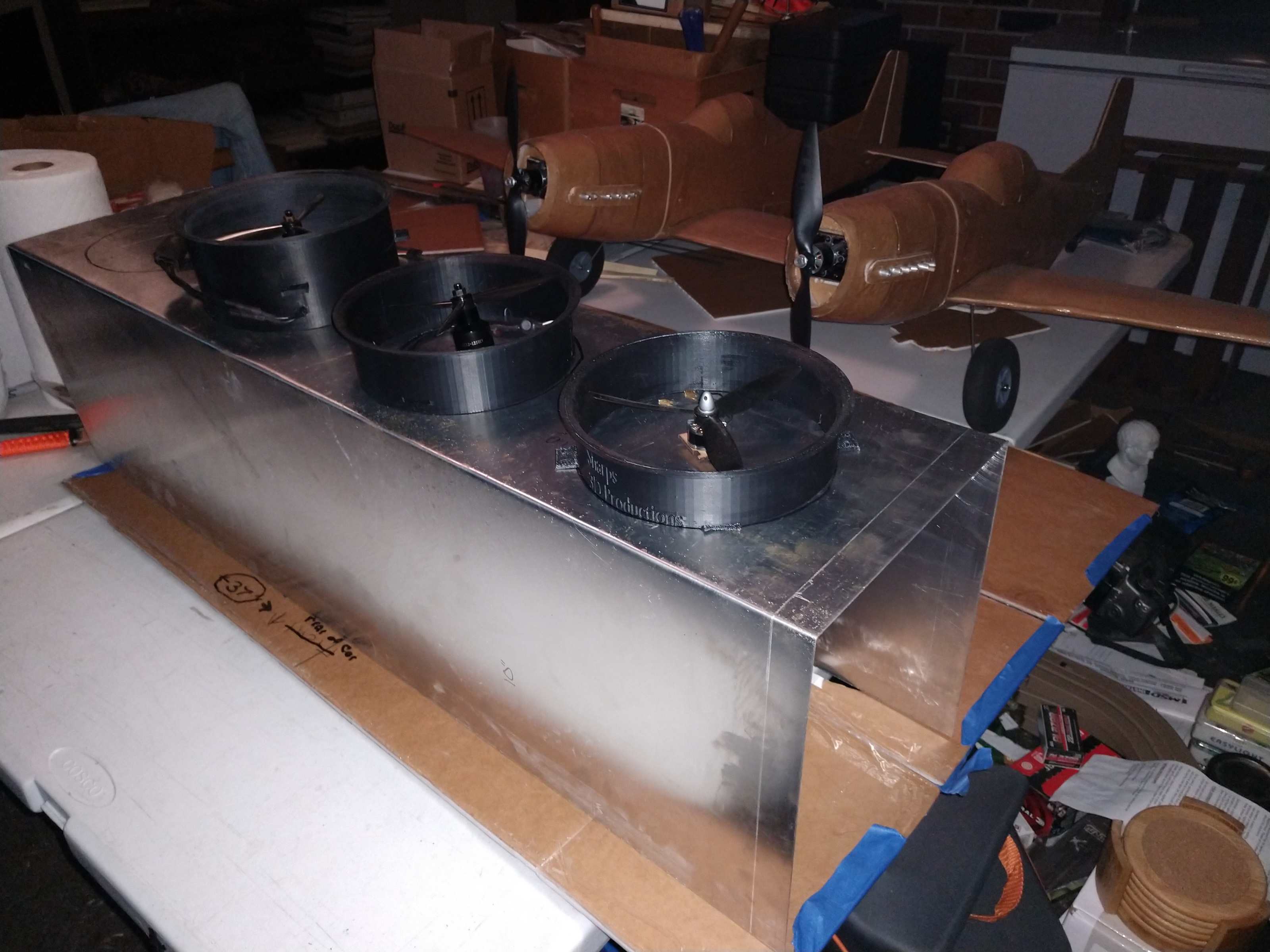

The 4 bells are complete and the propellers are clrearenced.

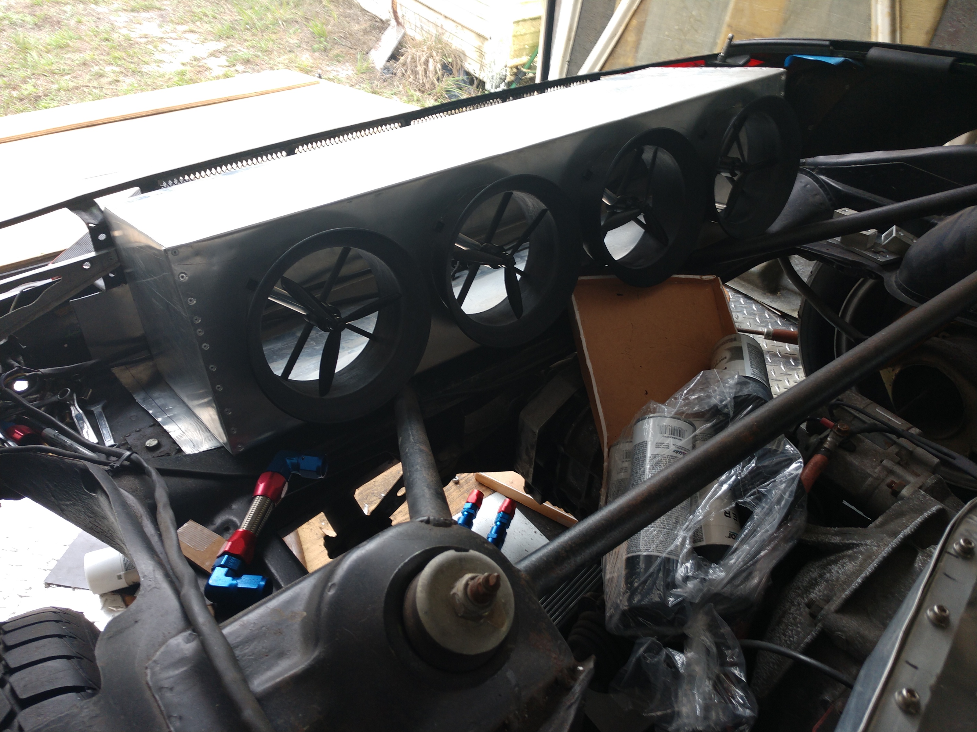

Finished up the end caps on the air box. I have all the rivets and have done lay out but I am expecting some new tools on Friday, They should make cutting the holes easy and do precise lay out for the rivets and screws.

Wow, this is a milestone for me. And I finished installing the last bell at 4. That's 4 bells for me. I still have to cope in the air box around the tail lights and clean up the box but once that's done I get to finish the hoses.
