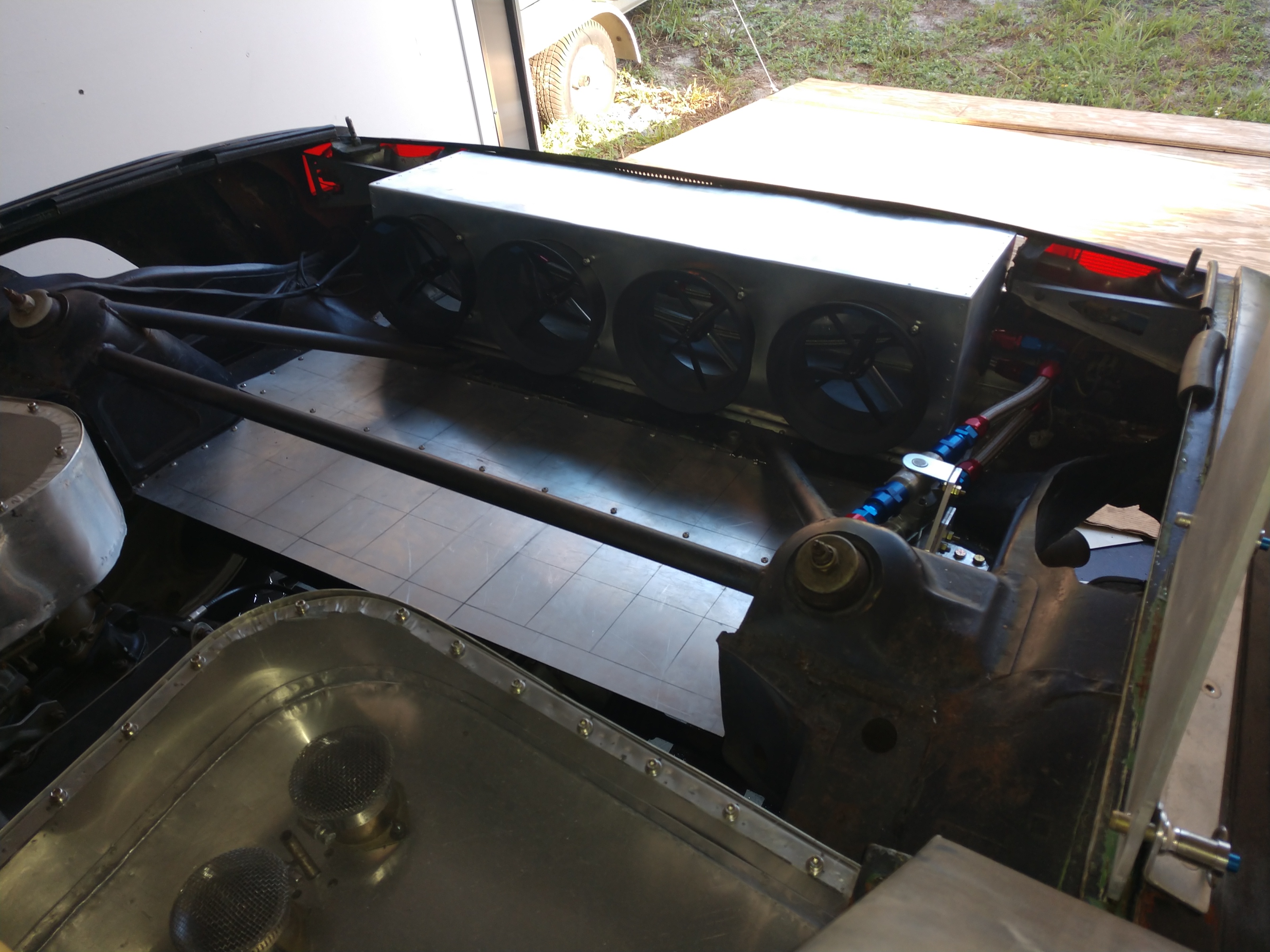

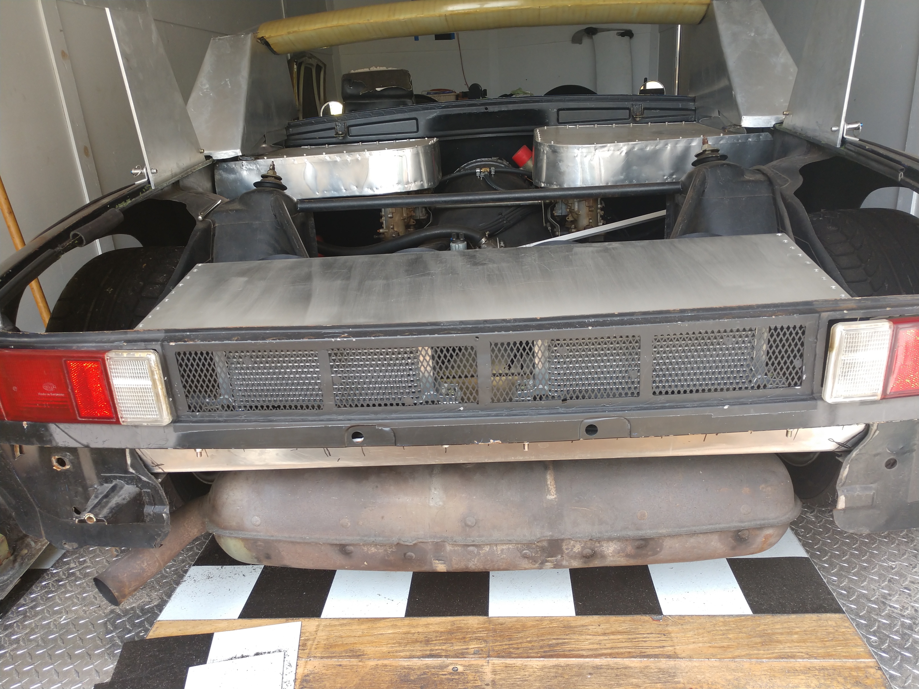

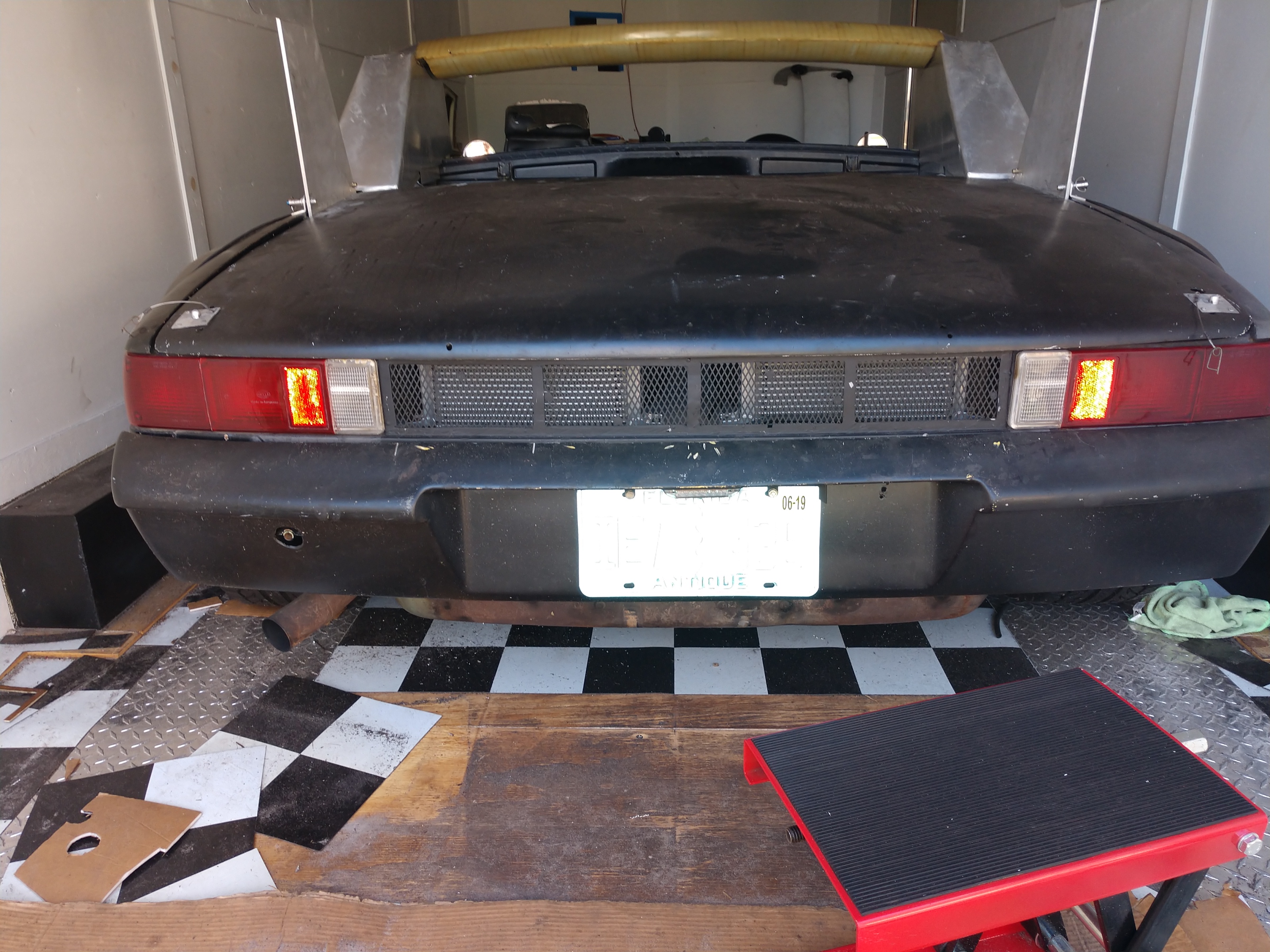

Finished up the details of the air box and set it in place in the car. It looks really good with the graining done.
914 Ranch
post Apr 21 2022, 01:23 PM
Post #502
Team Sharp where the 914 grow wings
Posts: 1,506
Joined: 29-January 16
From: TheNorth Shore Retreat. Deland
Member No.: 19,611
The other end.
914 Ranch
post Apr 21 2022, 01:26 PM
Post #503
Posts: 1,506
Member No.: 19,611
The radiators hiding in the grill work.

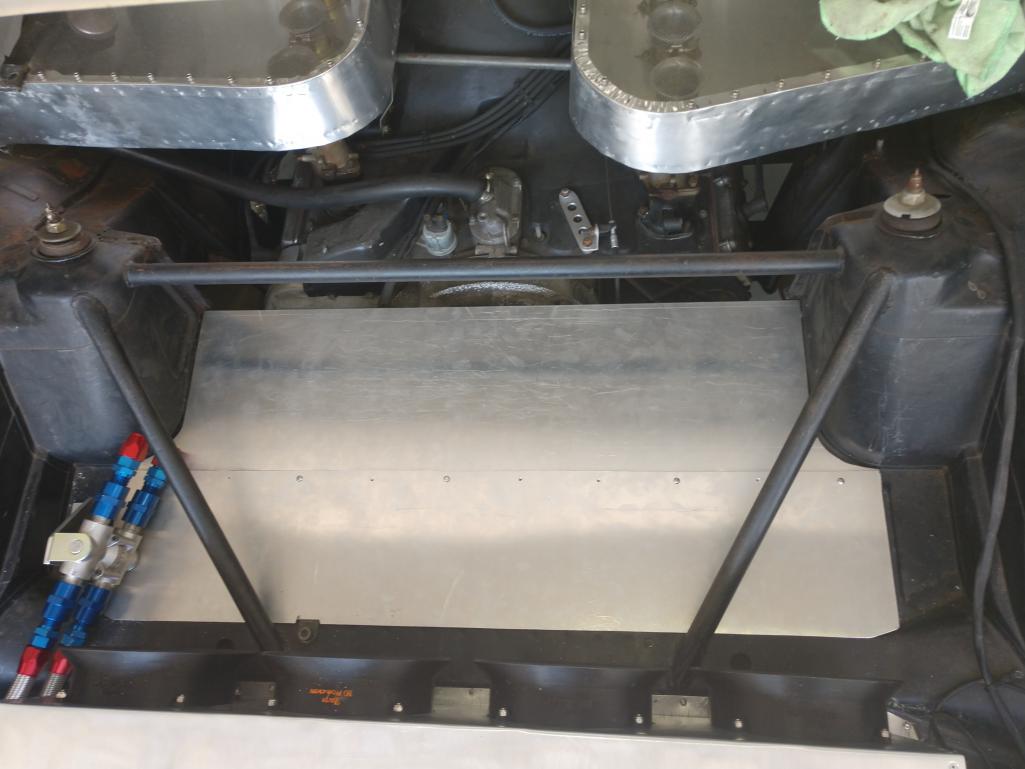

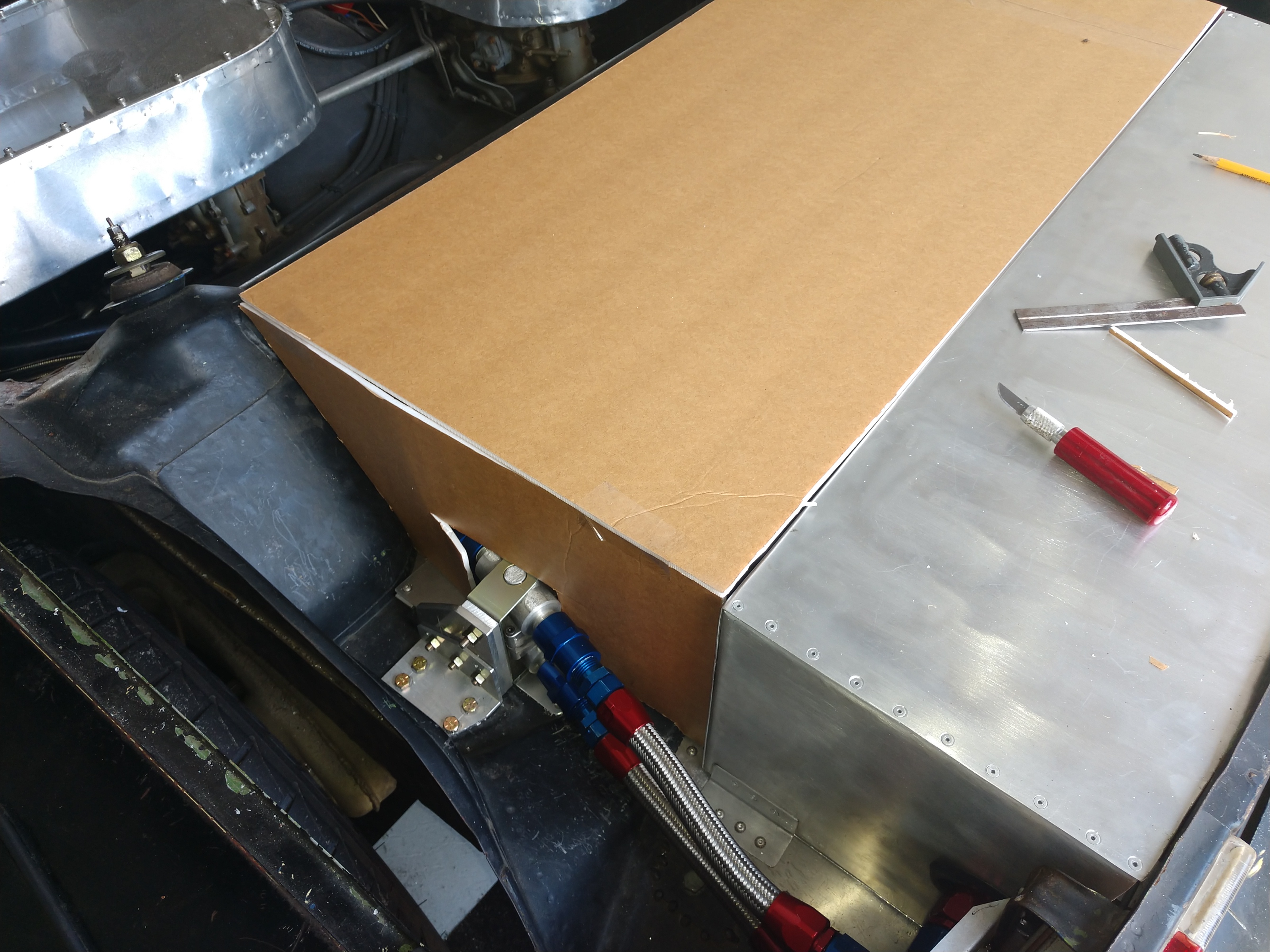

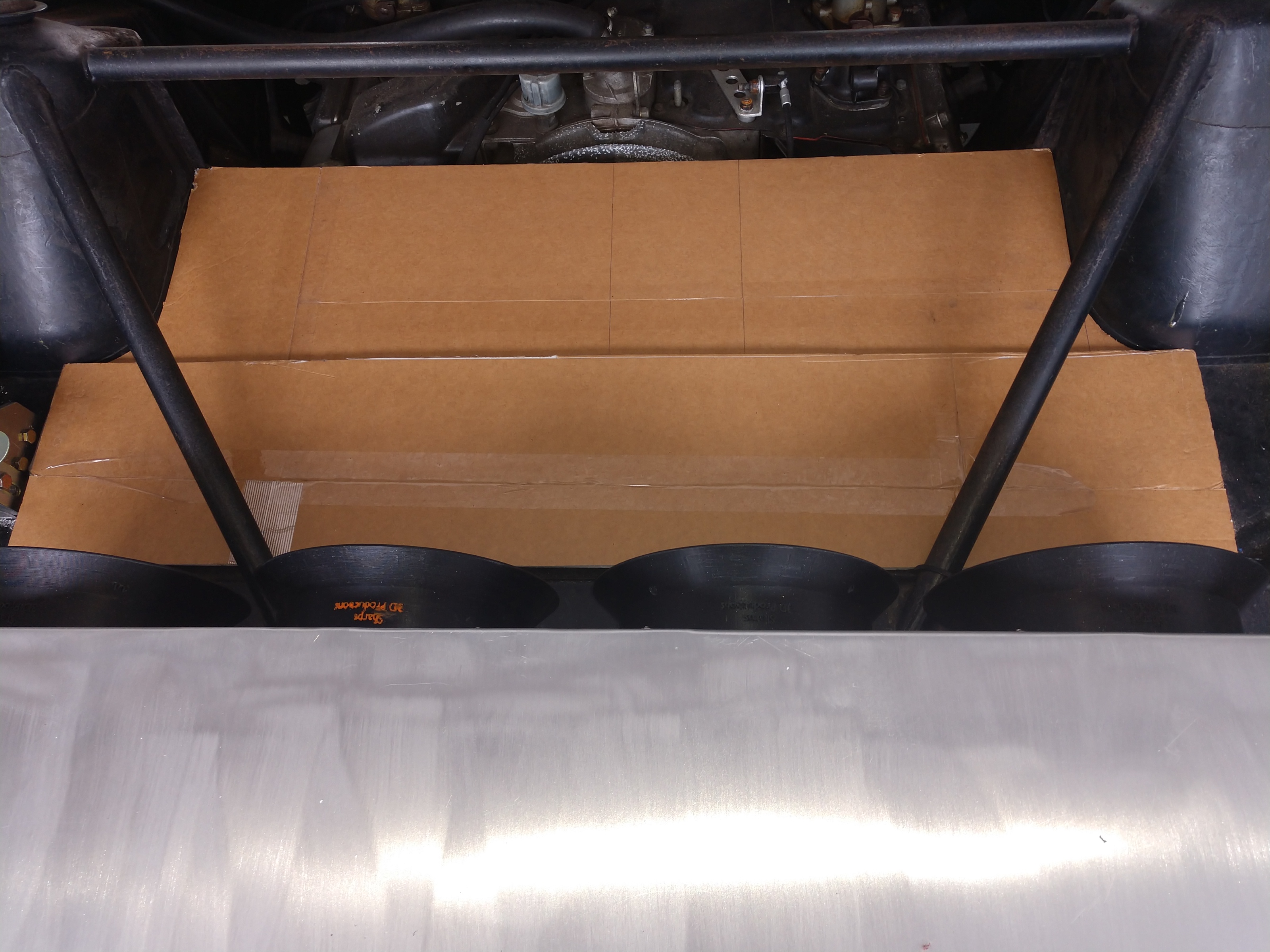

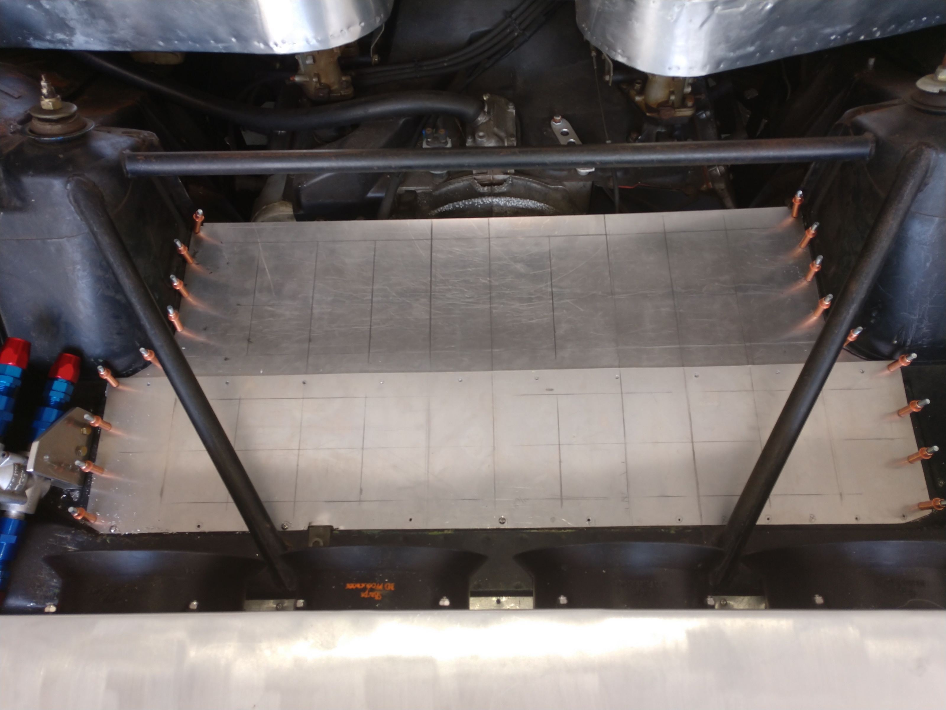

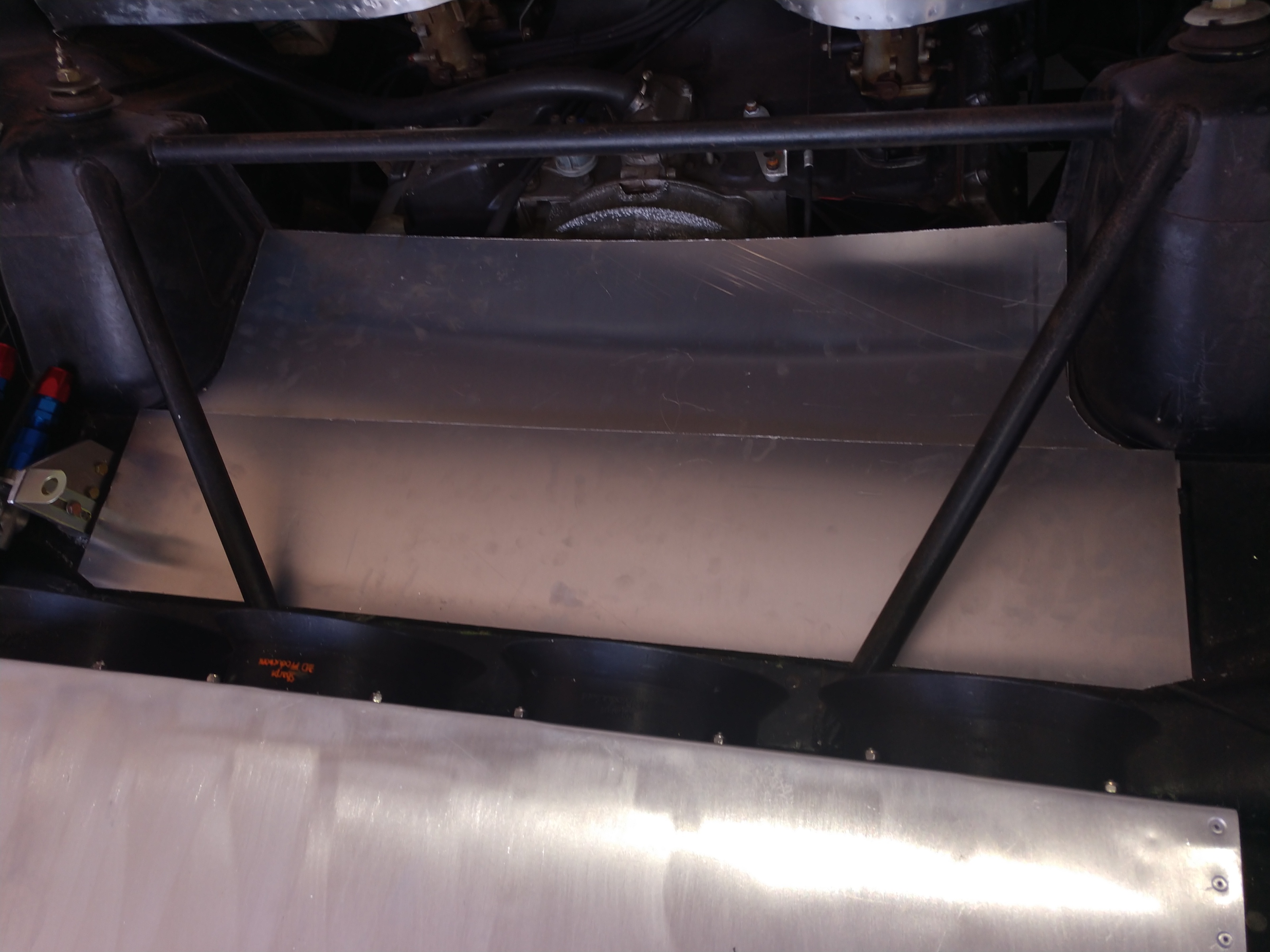

Made some more foam board patterns today. Putting in some more aluminum panels, these go just above the transmission.
The patterns.
Where I am placing them there is an elevation change and this allows me to stack the sheets and sneak in a piece of extrusion for support.
914 Ranch
post Apr 23 2022, 04:57 PM
Post #505
Posts: 1,506
Member No.: 19,611
Placing the panels. A few small details that should be quick and easy. Like moving the back up wiring and the ground strap. I can do most of fasteners tomorrow.

Getting ready to fasten down the new panels, also ready for another trip to Daytona bolt and nut. They want to see the car.
I love Calico clips
I like this material so much that I might make up a new set of plenums out of it. They are made from a roof flashing material and it's pretty thin.

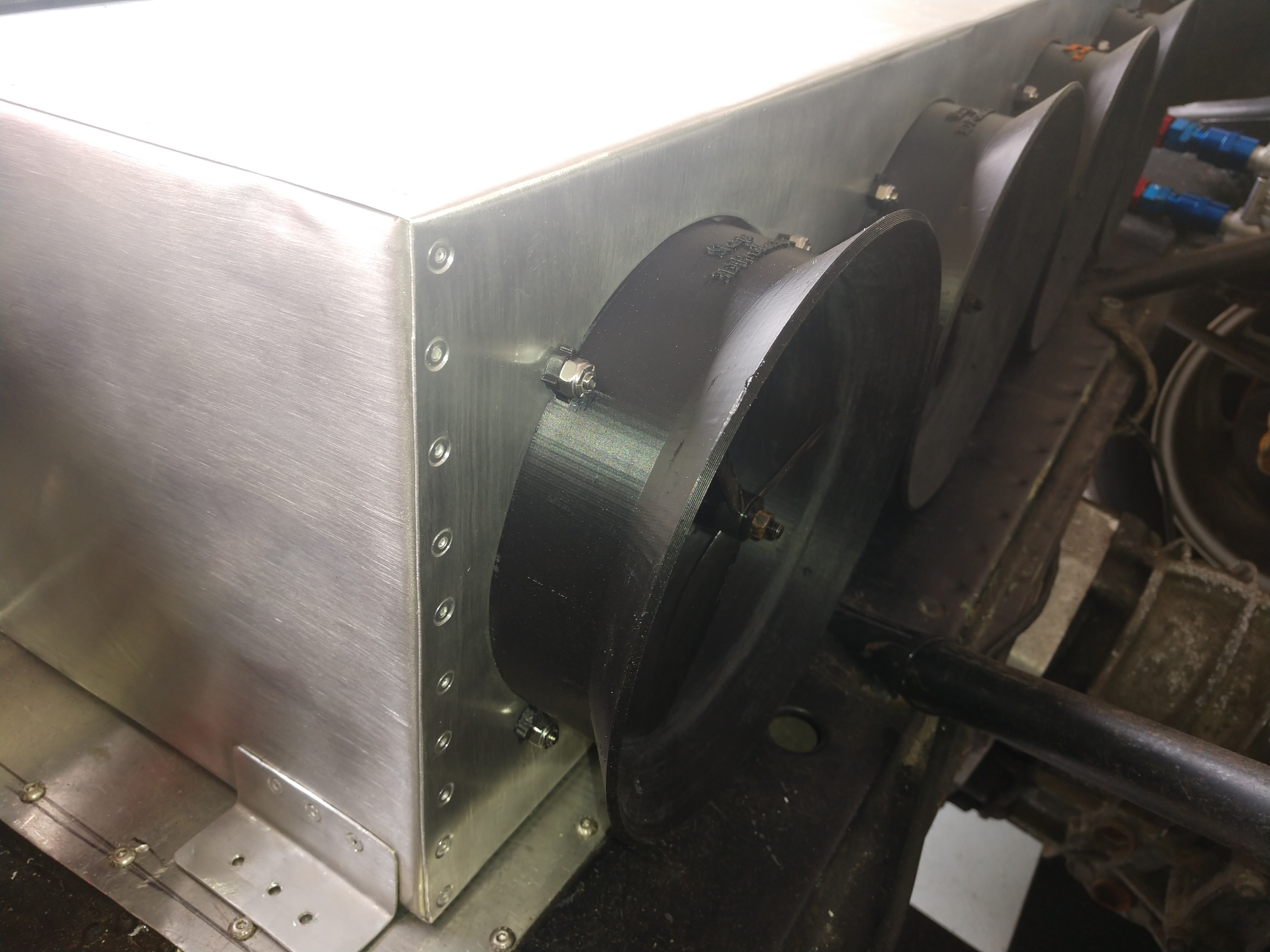

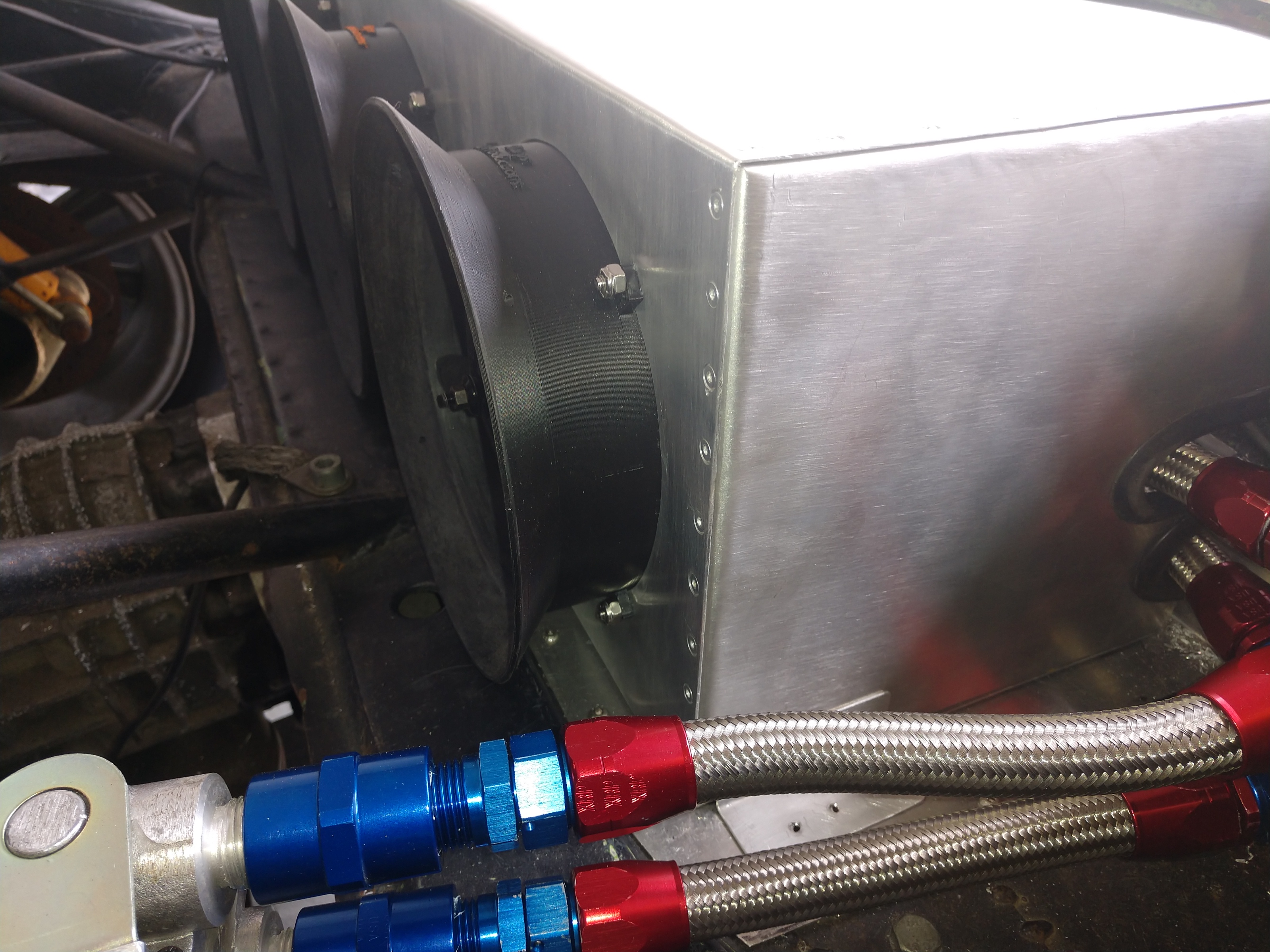

Finished the with the screws on the panels and really happy with the looks of it. It gave me a lot of pain bending over the back of the car. I had to give it a break for 3 days so I could finish it up.
Still need to make up 2 more hoses but it requires pulling the oil tank so now I get to jack up the car in the trailer. I have to pull the plenum on the driver's side to get the tank out.

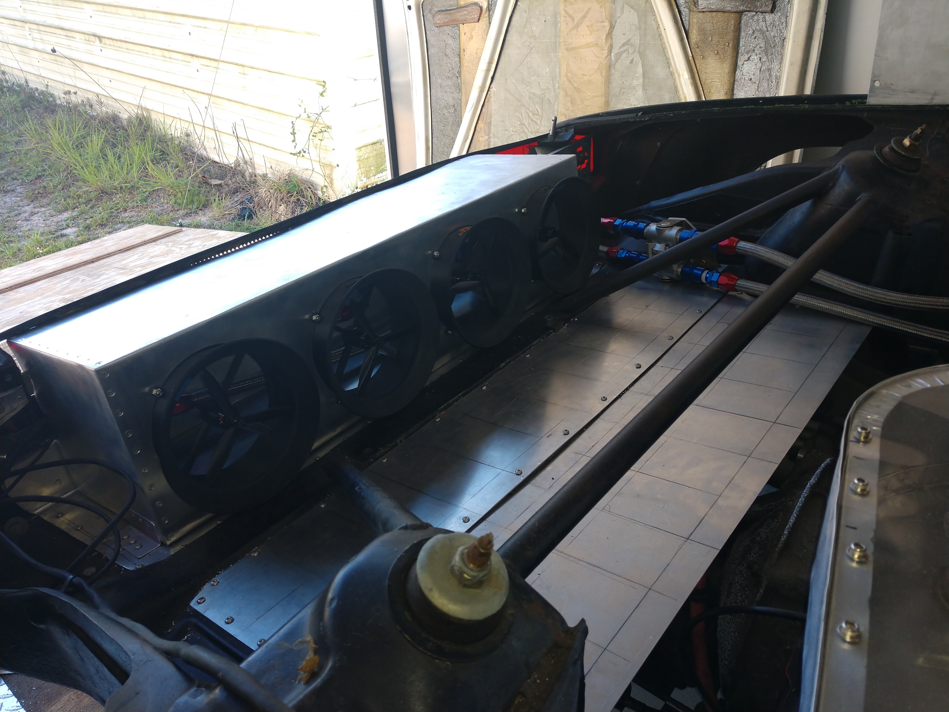

From the rear of the car.

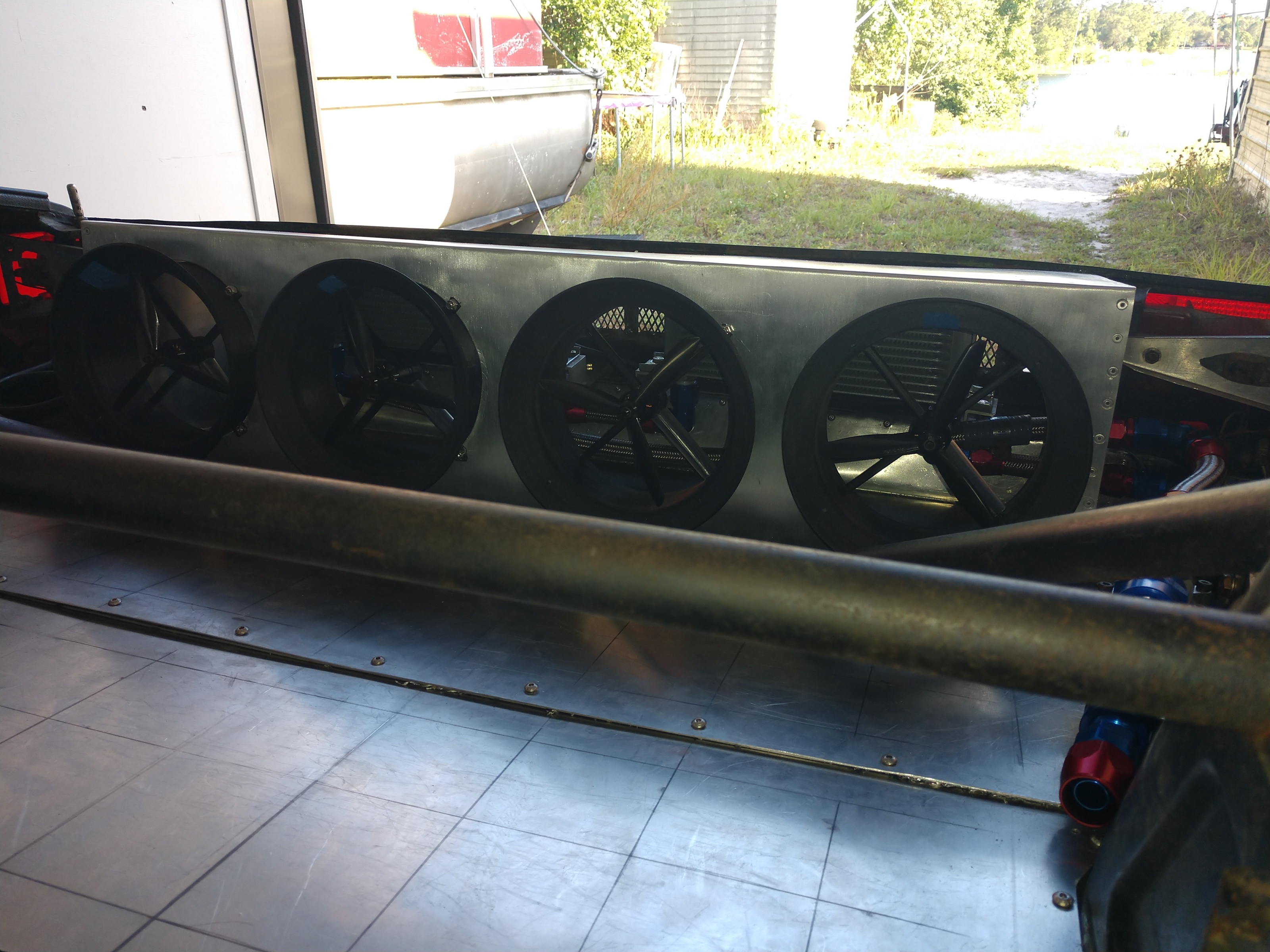

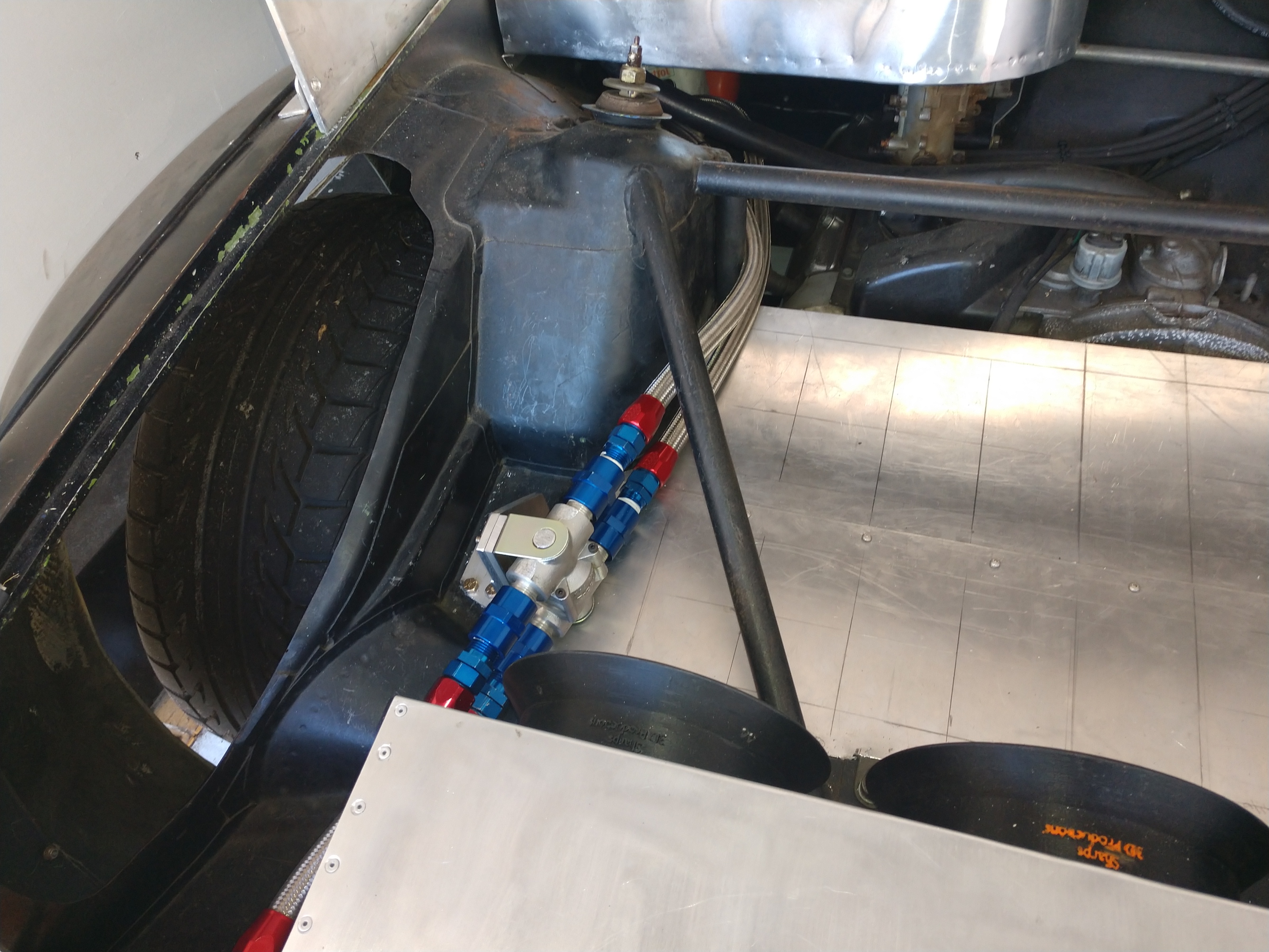

Looks good Joe. Curious to see the results in numbers. Is the air supply the two holes in the inner fenders?

There are holes everywhere, I just hope I can make the motors work. If any of the things that I have done to this car works it will be a surprise to me. All of this stuff keeps me from watching the TV. Sure helps me pass the time. So if it works as good as I think it looks it would be really cool.
The latest pictures.

@Shivers , first of all, thank you for making me think. Second I must apologize for not knowing, but in '12 I had a stroke and lost my mind. One of the things that hasn't returned to me is your first name. All these years of association and I would really like to be able to address you by your first name.
My solution to your query is to box in the intake of the air box.
I can make the top from Plexi so you can still see those horns.
