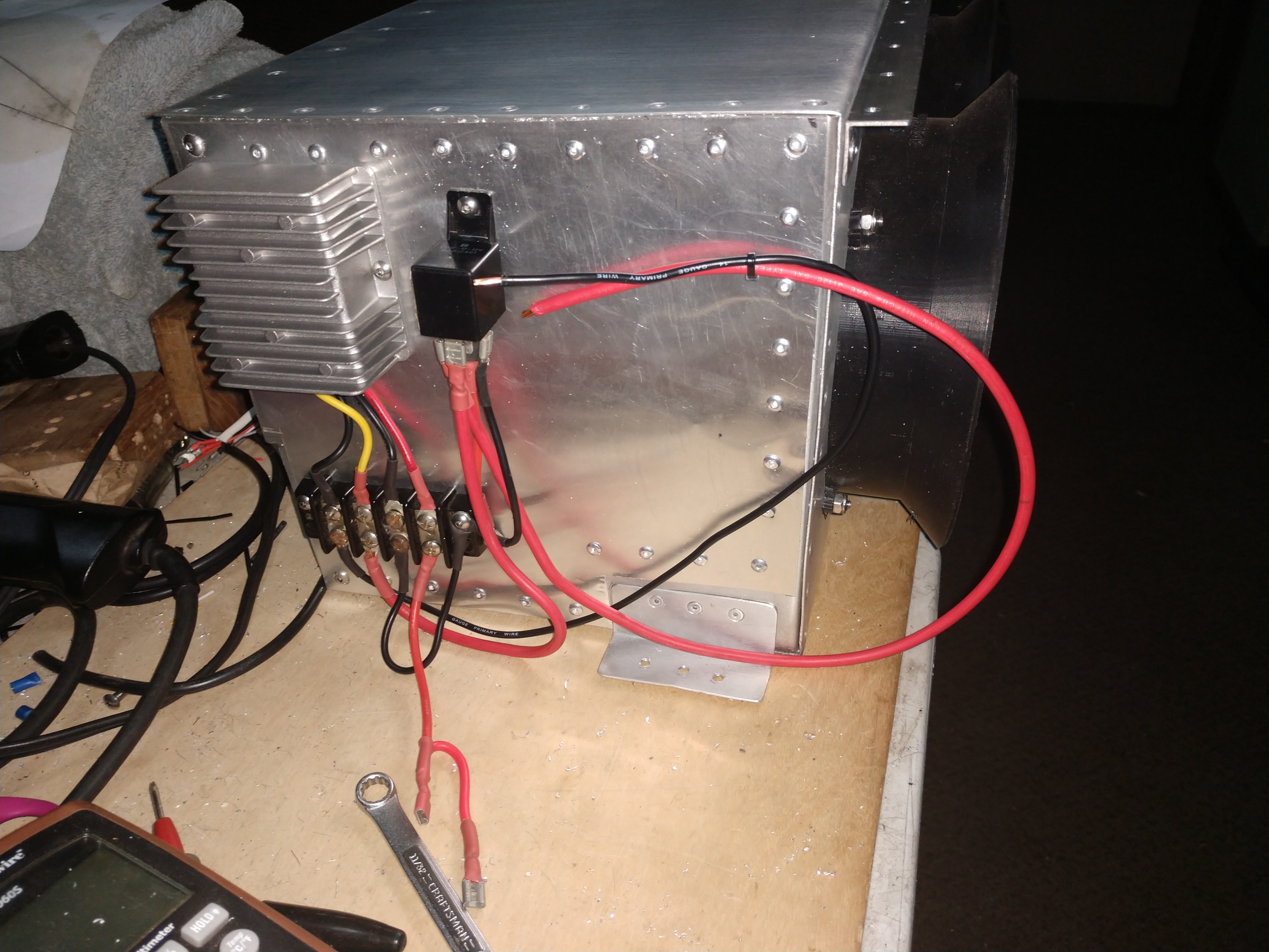

Mounting the electrics to the patched end of the air box. I need more wire, it should arrive tomorrow.
Works just like the first one, ignition switch powers up the relay, it turns on the regulator which gives regulated power to the ESC's. The regulator is there to protect the delicate little ESC'S. That way they will never see a spike.

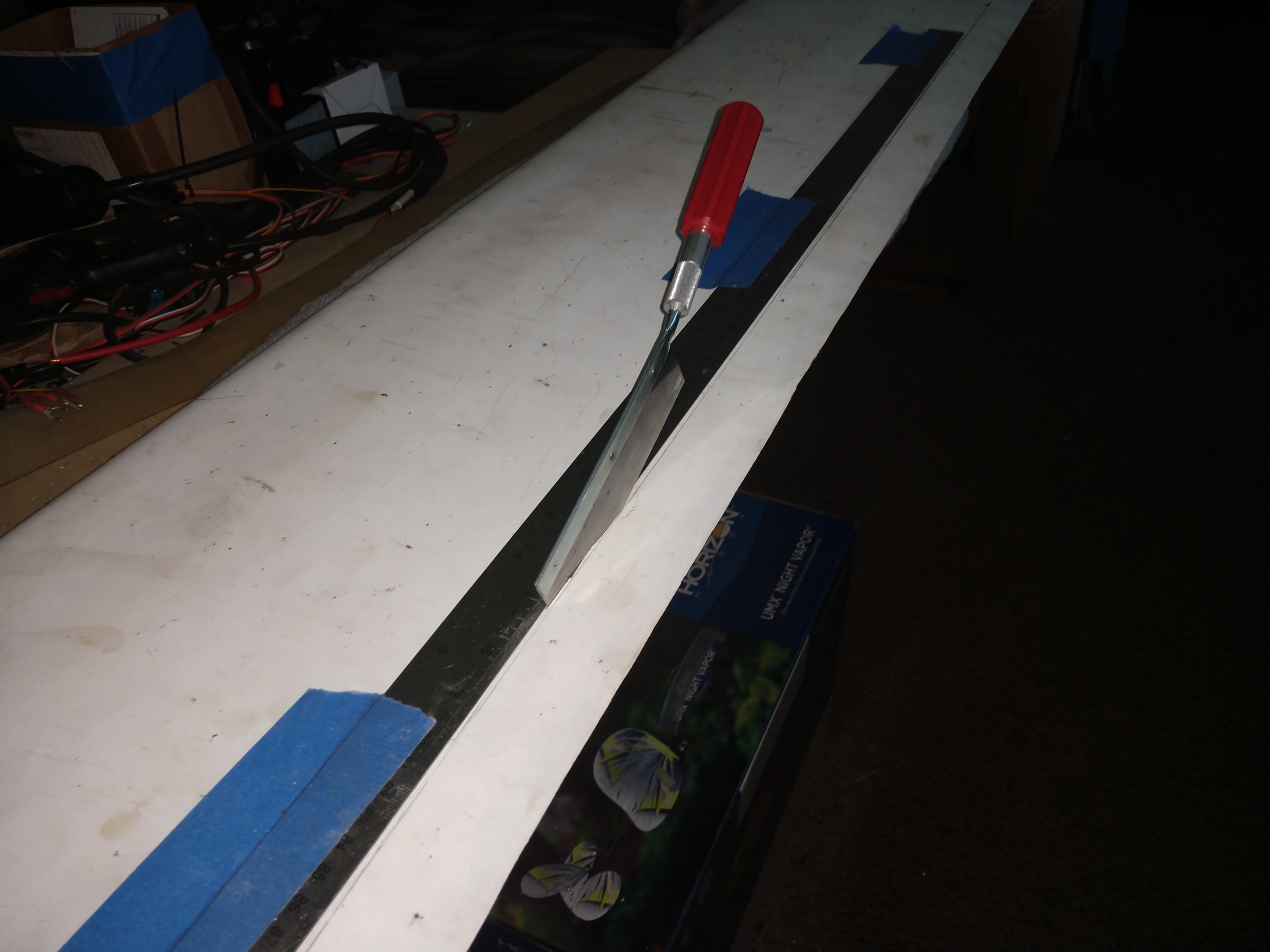

I've been having a dilemma about how to hinge the flap on the rear wing. I've made it way more complicated than it needs to be. First of all it's 50" and me thinking that it needs to pivot freely. So I was trying to think of fabricating up some sort of wire hinge with 5 or 6 pivots. And do that without it being difficult to install and move freely. Right. So today I had a thought about the hole thing and this is where I went. It doesn't need to be perfectly centered on the wing or have perfect fairing when up, it just needs to pivot.
I have on hand some really light fiberglass cloth to make a 2" wide tape from and glue it on with Flex Seal. I just ordered some 1/16" pinstripe tape and I would like to use it to put a center line on the fiberglass tape on both sides so I can pull it after the installation.
It seems to me that I always try to make things more difficult than they need to be.
Cutting the Flap out.

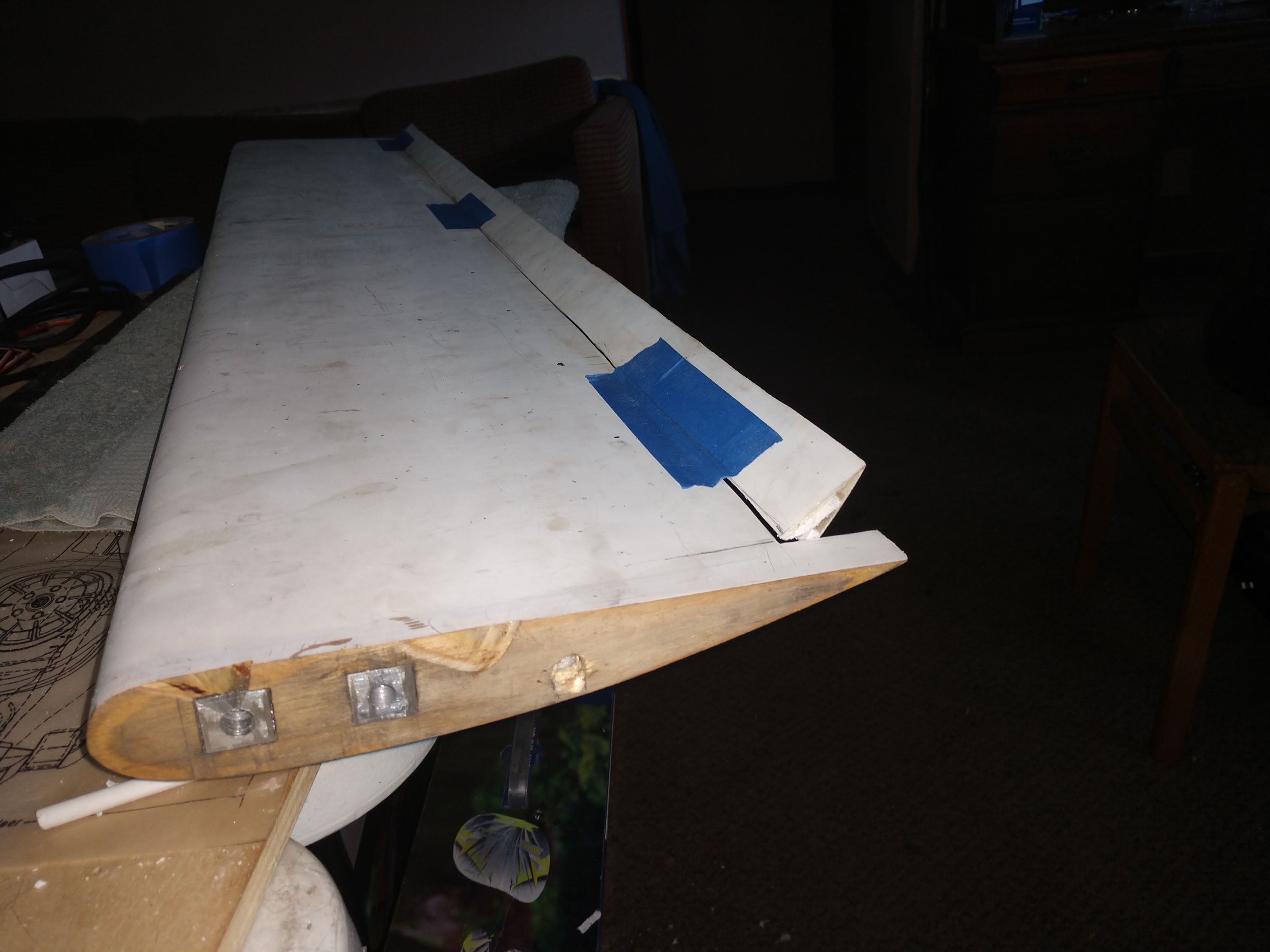

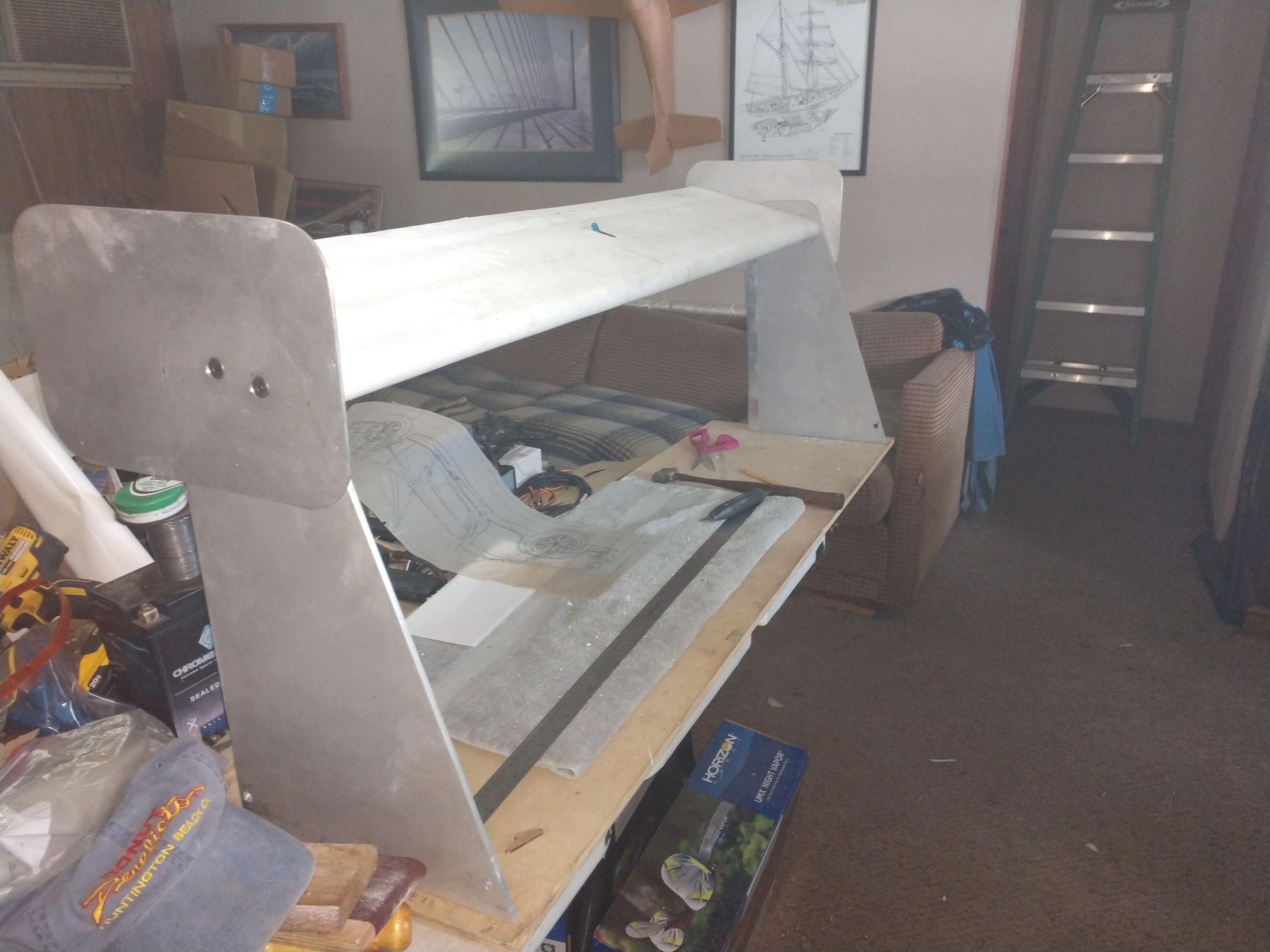

So I pulled the flap and fitted it with the wing and taped it in place. The fit is perfect and it is much freer than I expected. Lifting it from laying on the top flat it falls down into its neutral position with a clunk. Much better than what I expected. Completely free from any drag.
Sorry you don't get to see the action, I need to learn how to post a video.

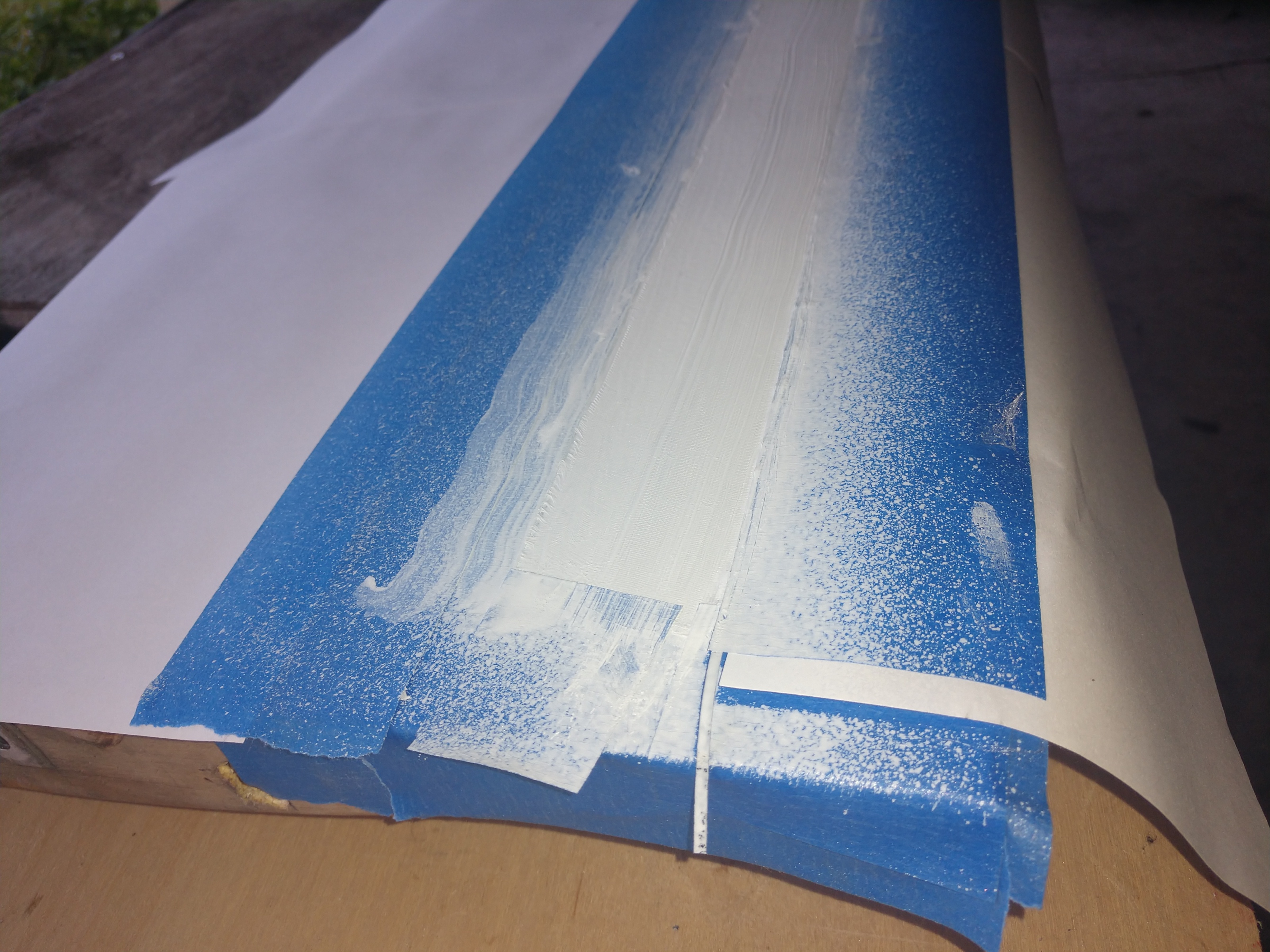

Well it's not very pretty but should be functional. Really not dry enough to do anything with. I hate waiting.

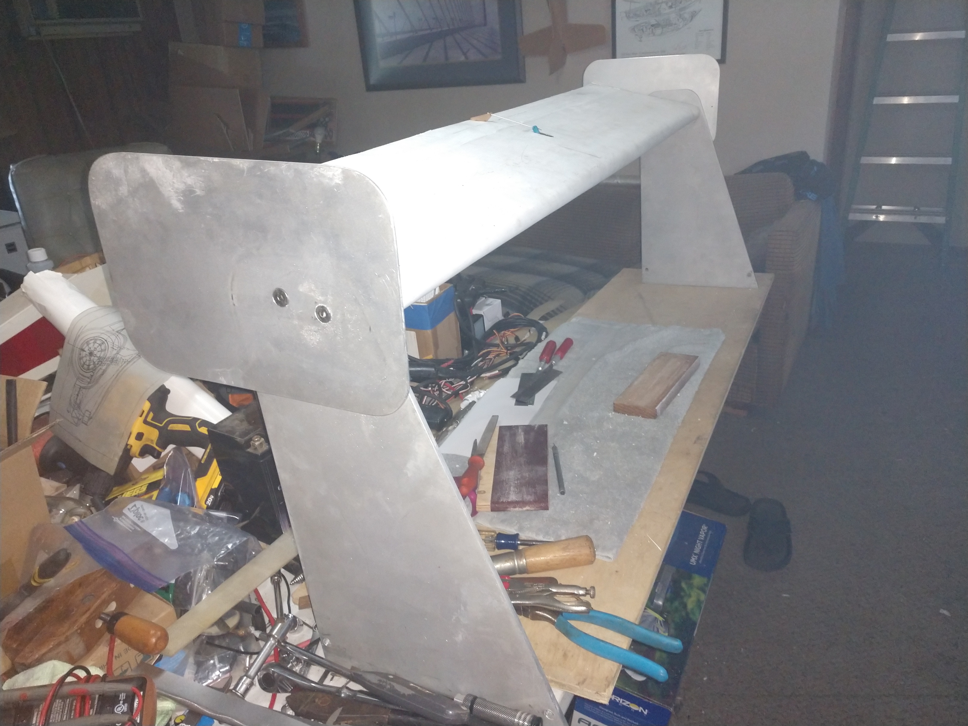

Got the wing ready to go back on the car. Made up the channel to cover the wires going up the mounting bracket and it looks OK but if I don't like it later I can change it easily.
When I started this post I looked to see how many views this thread has had and it said 39,995. I'm going to look right now and see if I'm any closer to the big 40,000 number yet...

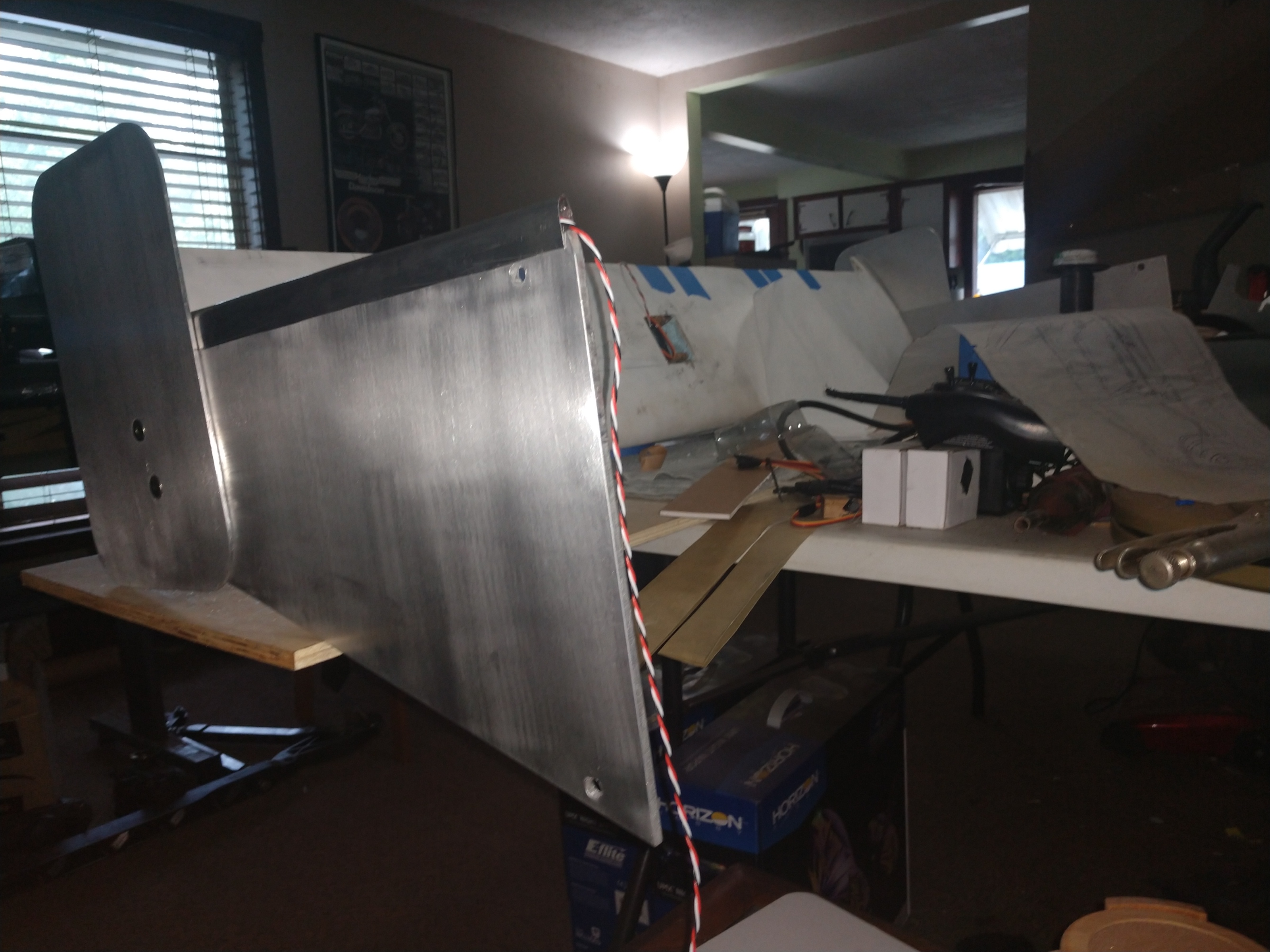

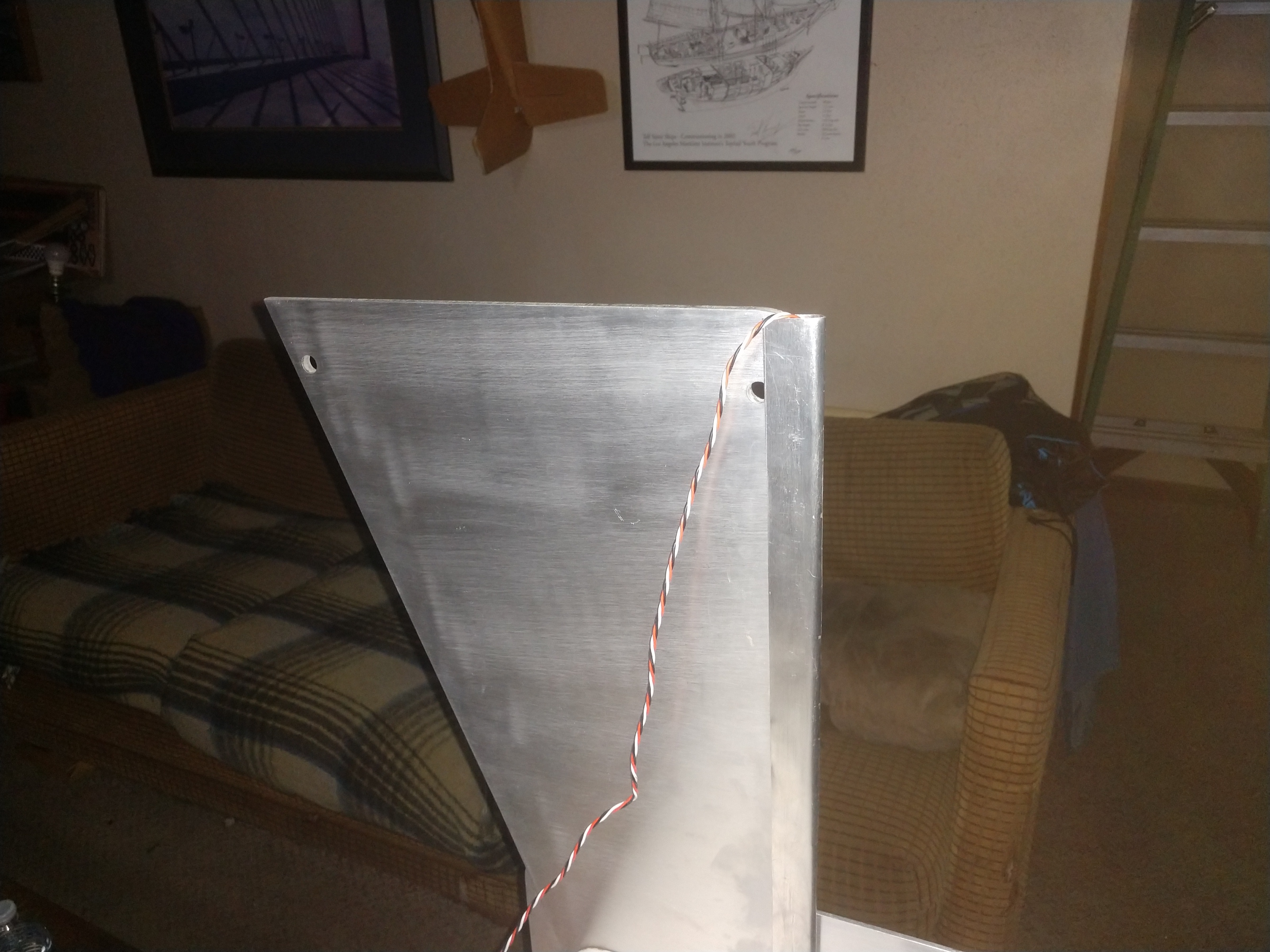

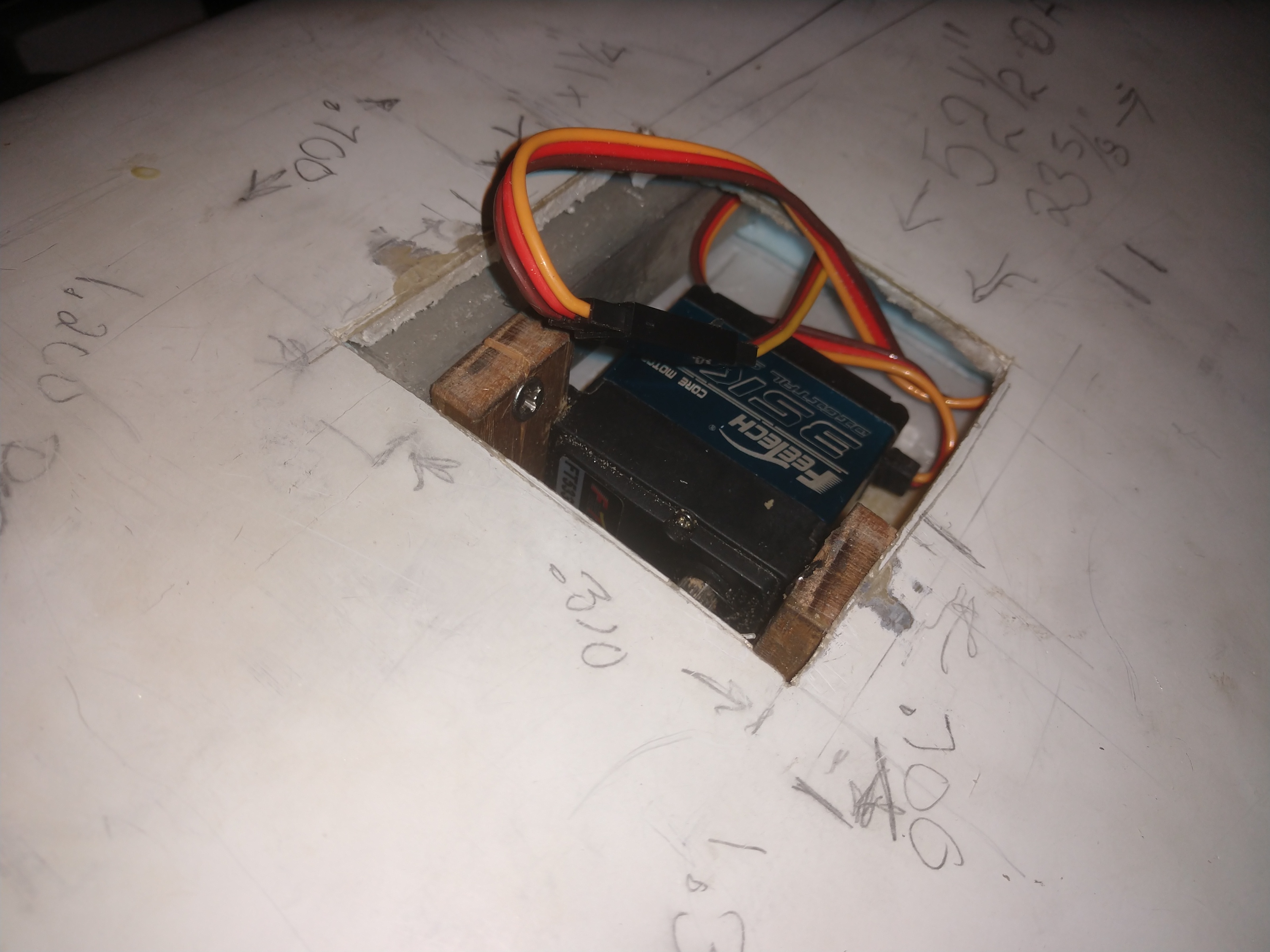

Well I managed to get some time for the car today. I cleaned up the finish on the strut and the end plate and ran the wires to the servo.
The wires are coming out of the hole in the bottom of the wing.and I left enough wire to make it back to the air box.
The grain on the aluminum looks good on the strut and end plate .

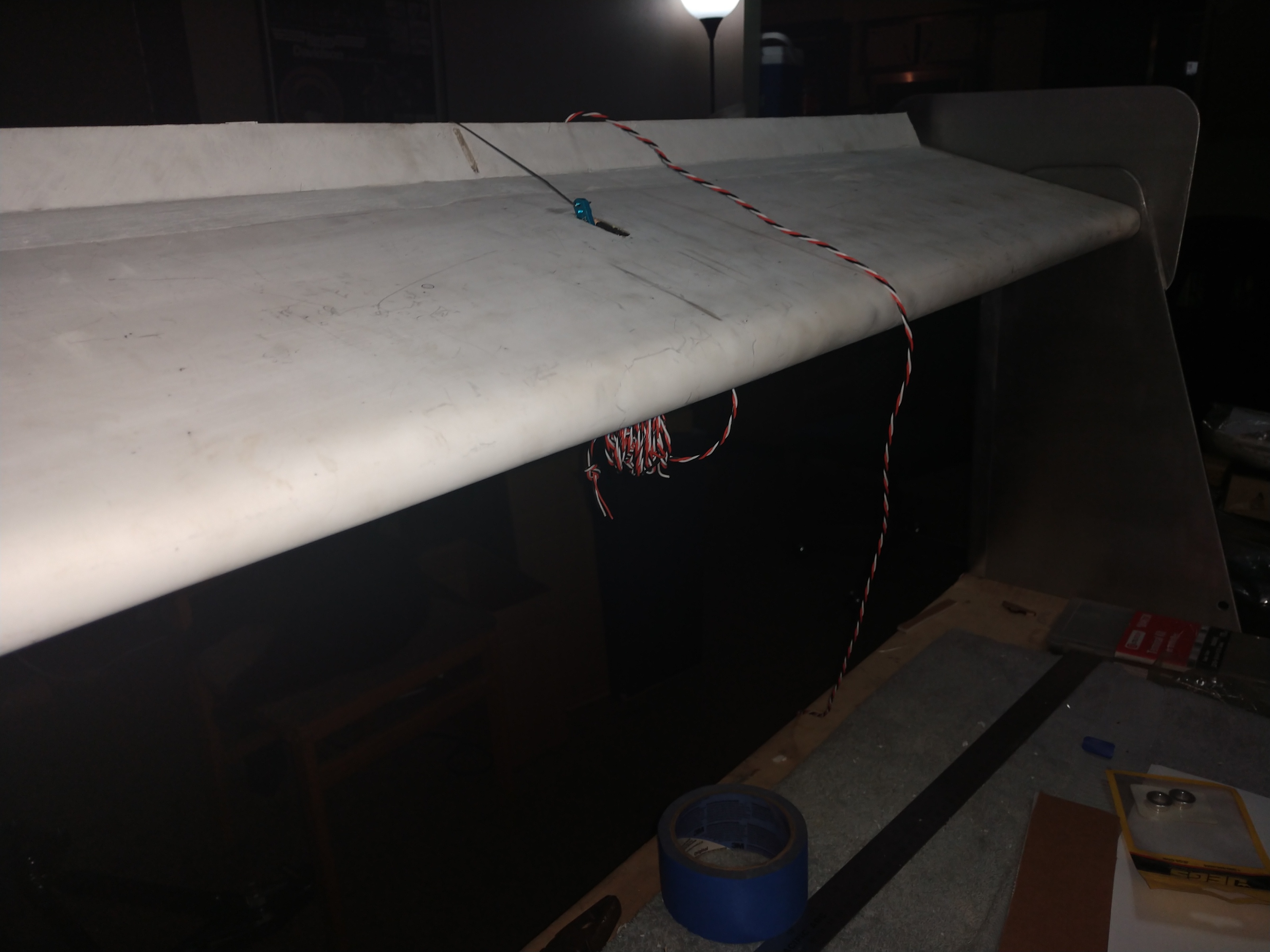

Purely for your entertainment, I am getting closer all the time.
Let's see how bad the picture is.
I might have to change it as it's not very good. We'll what tomorrow brings.

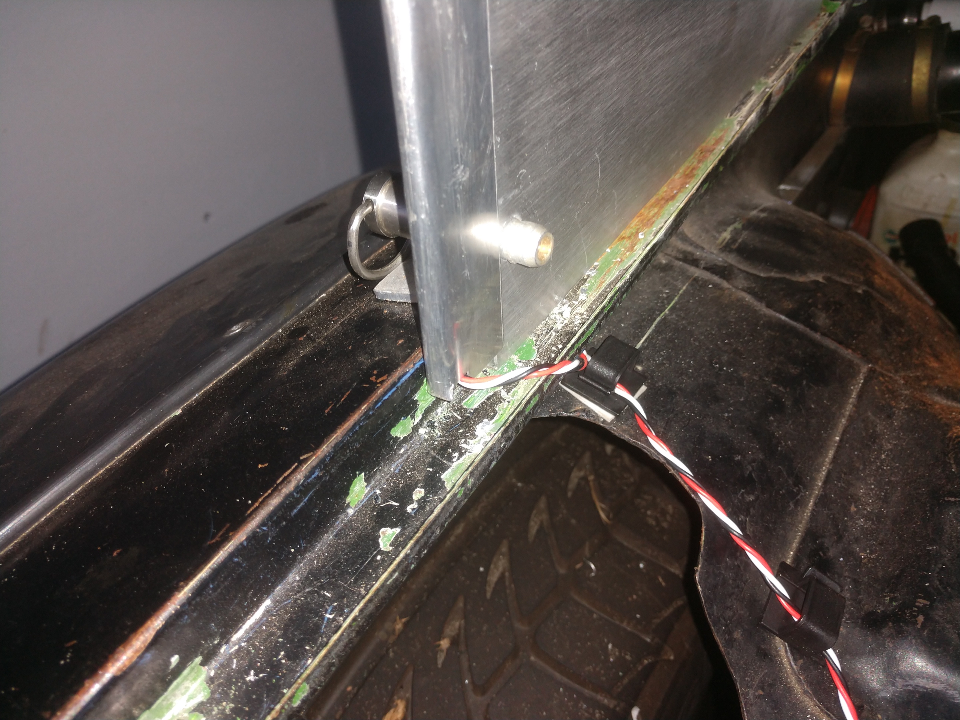

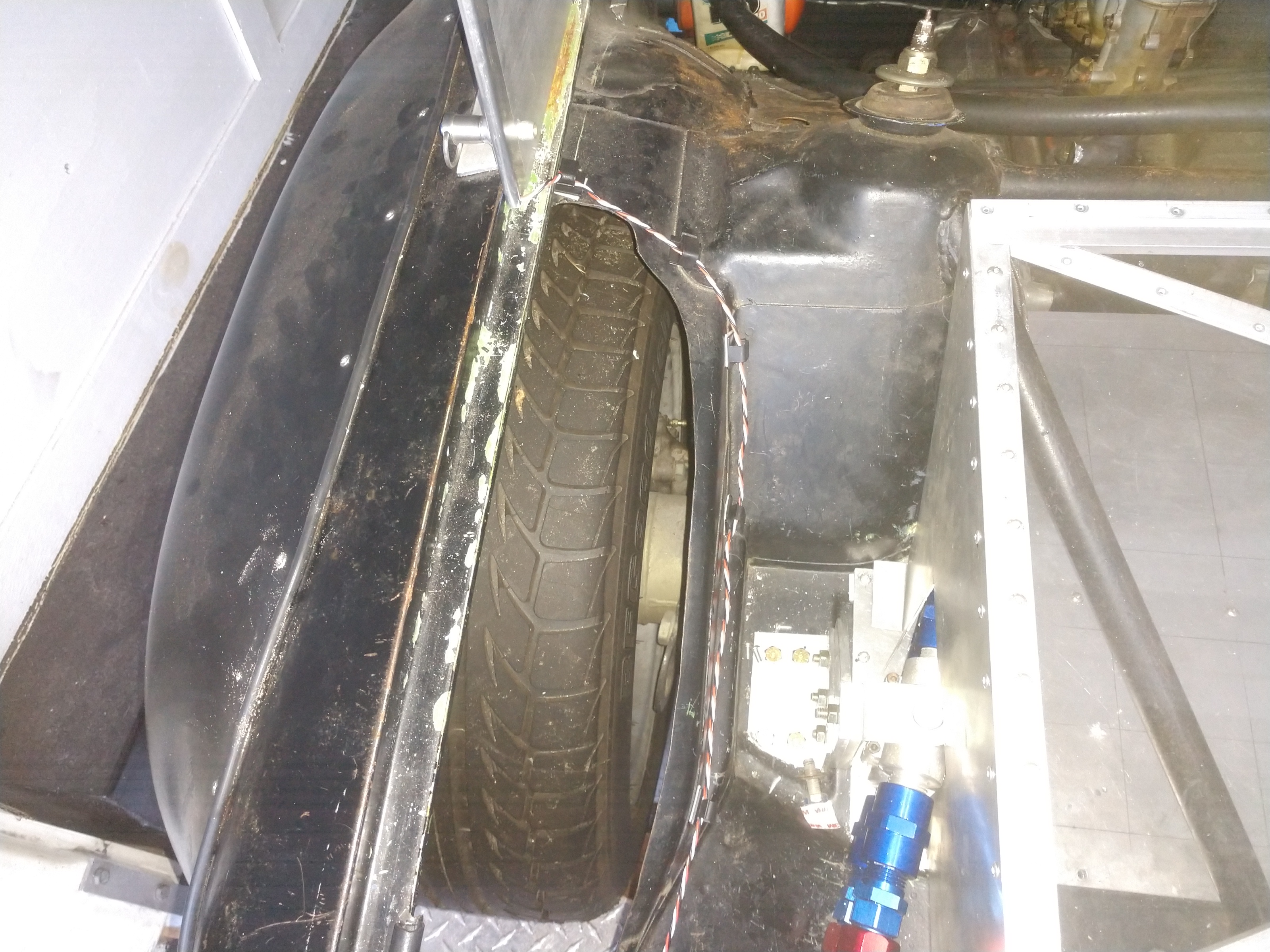

The wires to the servo connector are done and tucked away at the correct length. Coming out of the bottom of the strut bracket at the drip rail so I can tuck them into rear of the car. I still need to make a connection to the wires coming out of the air box. Oh I'm forgetting the linkage from the servo to the Gurney flap

Servo wires coming out of the bottom of the strut bracket.
The strut bracket mounts into the drip rail on the rear trunk. I can make the connection to the air box there.

Placed the wing and located the wires by clipping them in place with a plastic clip on double sticky tape. Next step is to heat shrink it into shape. It only has 2 connectors in the circuit one at the servo and one at the air box. The wing comes off the car with 4 quick release pins and 1 connector.

The way I ran the wires.
