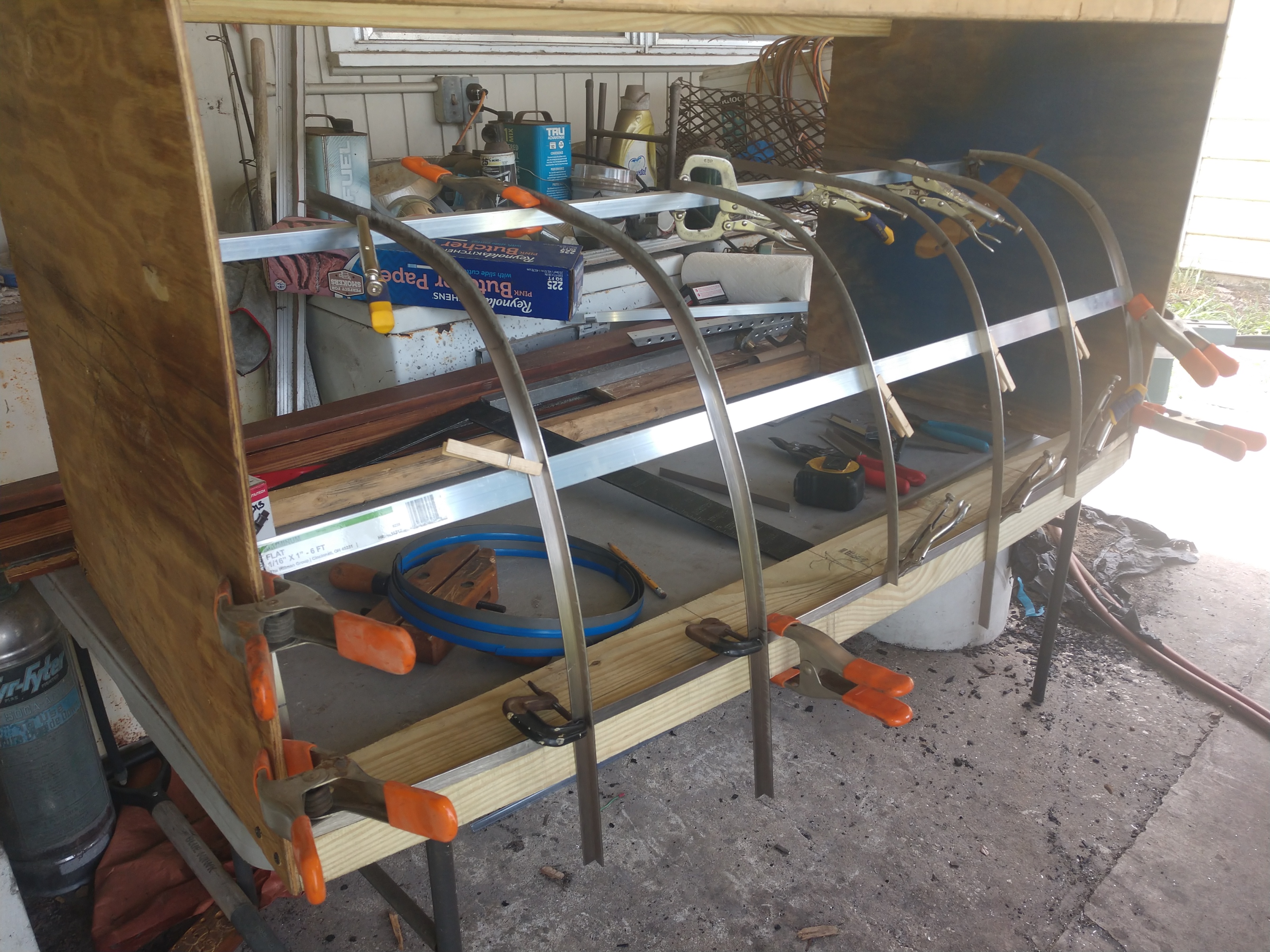

Hey Paul, yes but it takes a hole package. I've got a lot of work to do under the car. And it starts with skinning the bottom of the aluminum angles in the picture.

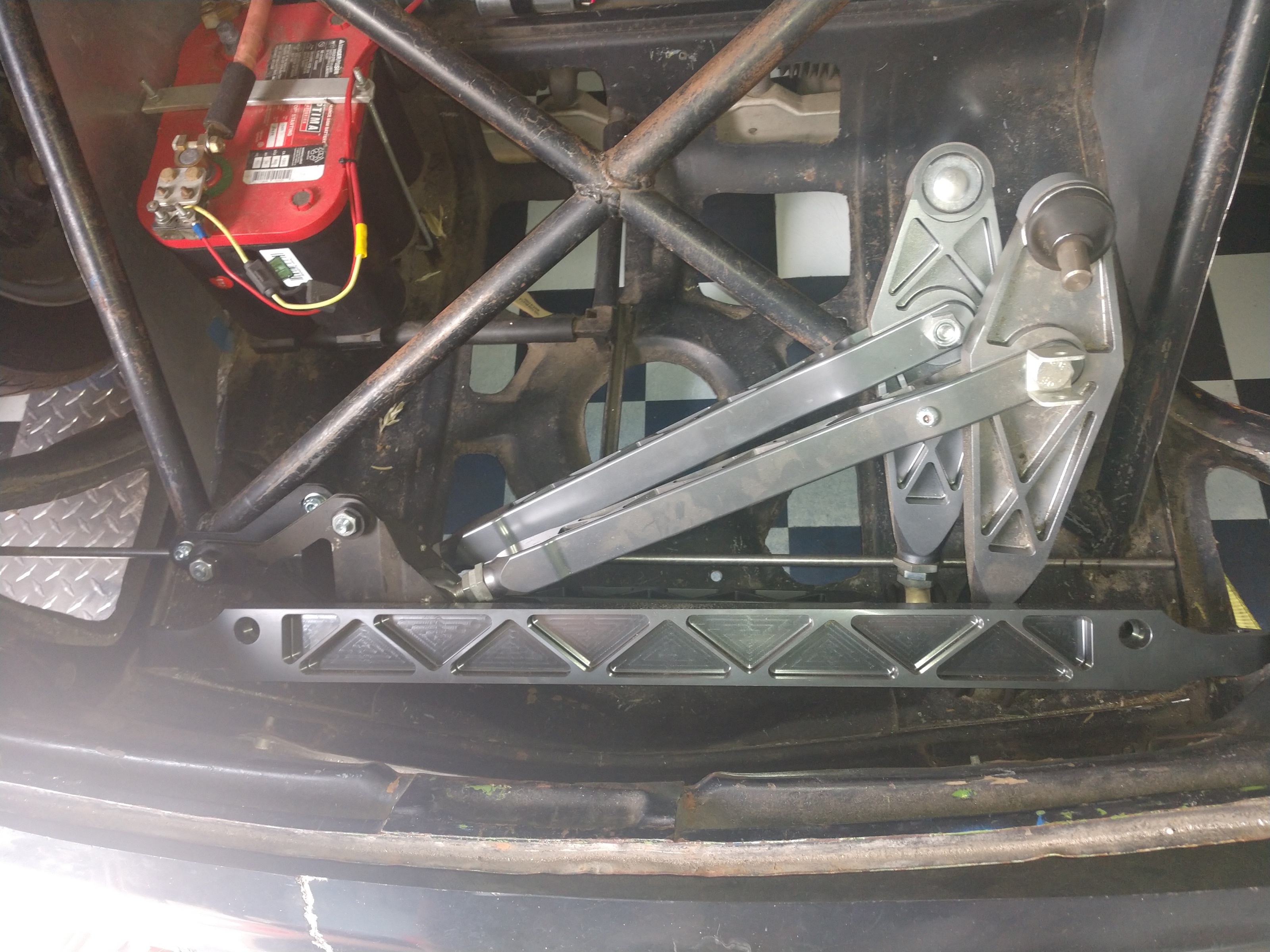

The front mounting bracket fits but needs a little messaging. Now I can start on the top mount, that's fuching trick. Doing all of this with the frame open really helps see the space available. I was thinking about some more grill work in the panel about 5" down from the top of the panel.

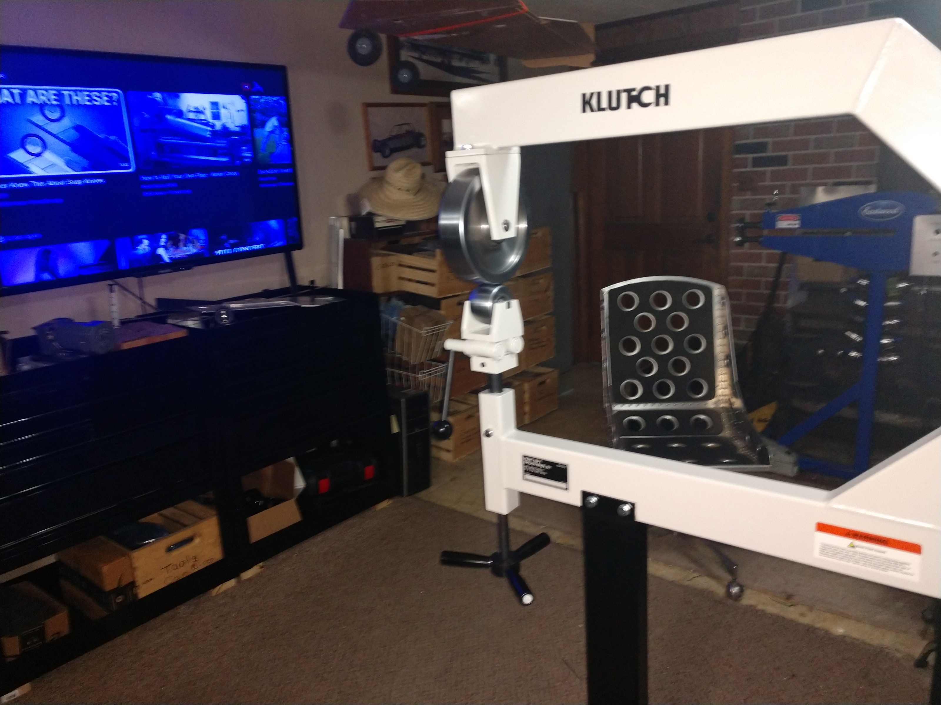

Thanks Paul, well ya know I been wrong before. Mean while I have made some nice additions to the shop. I've always had a problem with tool storage so I bought some. And of course the Bead Roller but now I have an English wheel. Just to see how it works on the diffuser.
I am a UTube junkie and I will figure it out. The curvature of the tail of the trunk lid seems a constant radius so that's how I am treating it. I need to get nearly 90° s of a bend the length of the diffuser on about 22". With the new tool storage the hand tools disappear. I feel better already and I still have a bunch of work in here too finish the clean up.

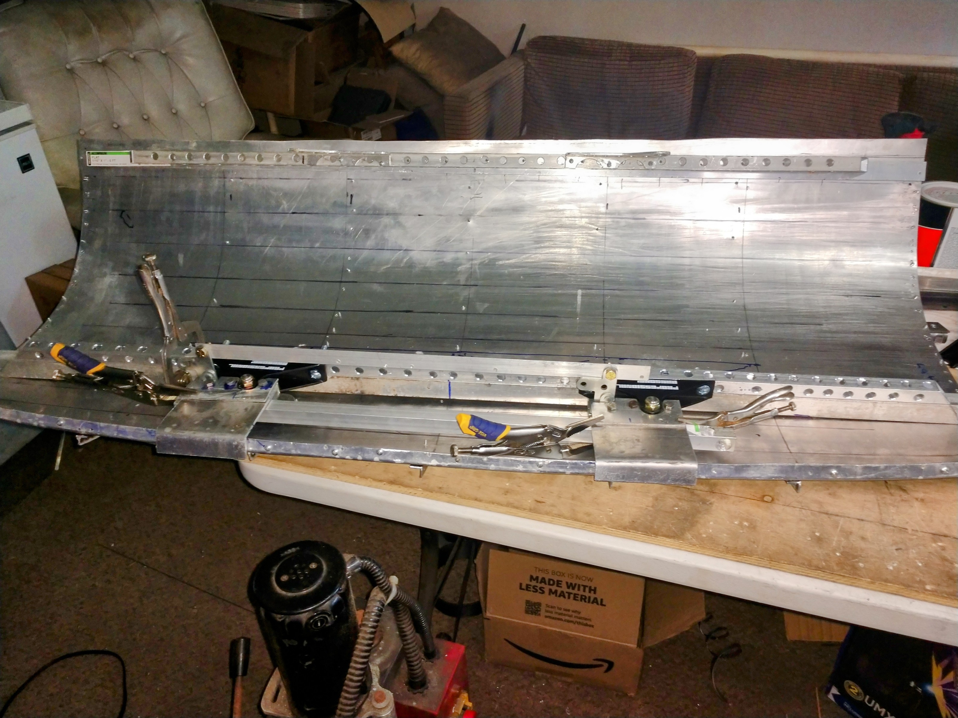

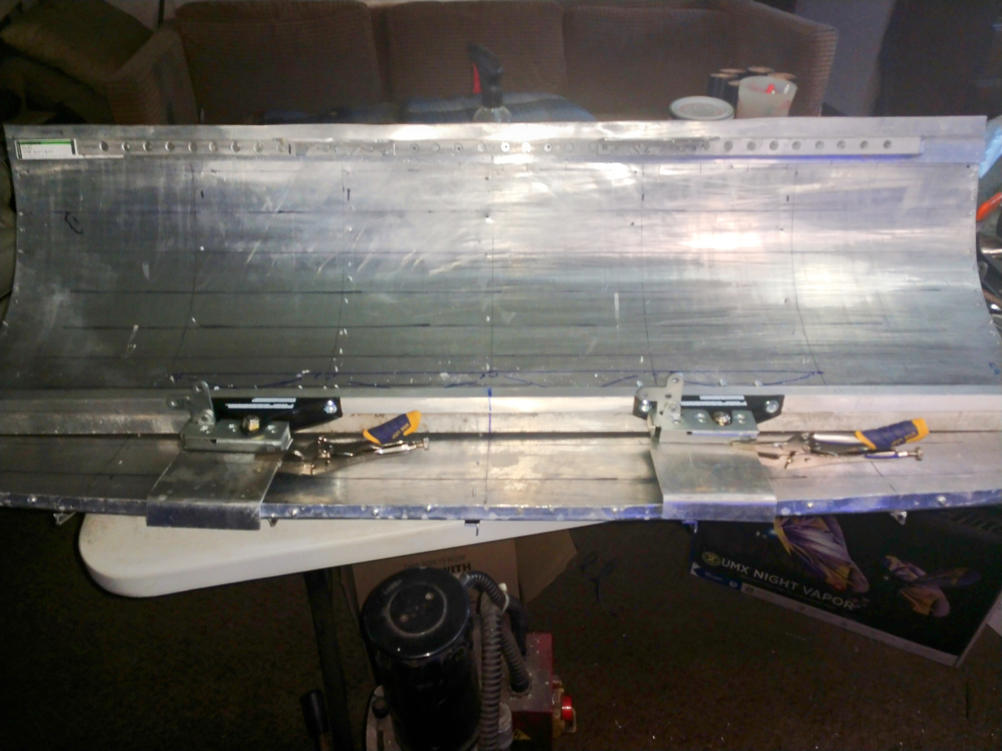

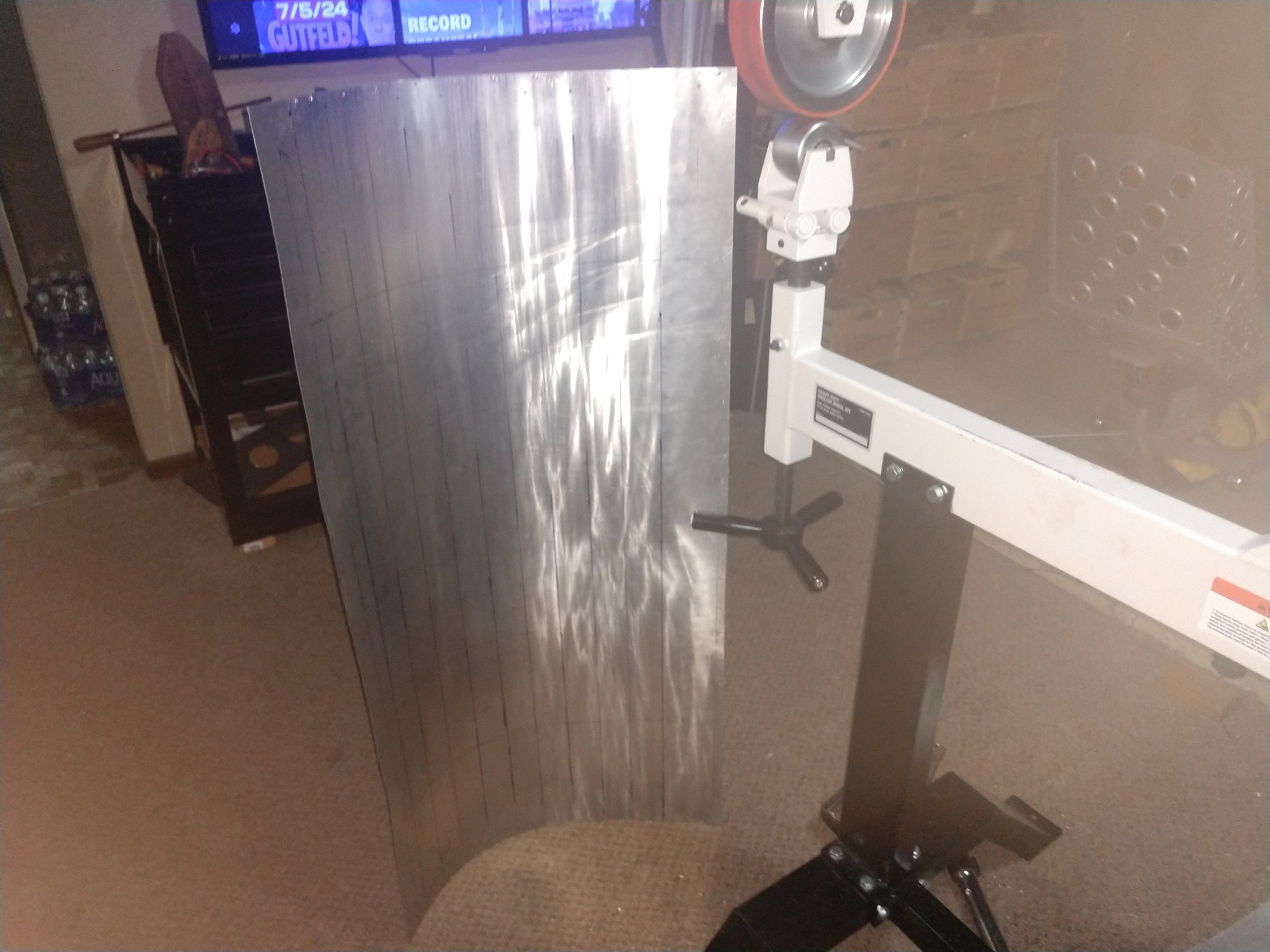

Getting to some wheeling. I cut a piece of aluminum to practice wheeling, learn tracking and figure out something about pressure. I have about a half hour in this and it has the correct shape.
This piece is only 14" long but the one for the car is 48". It's going to be a learning experience...

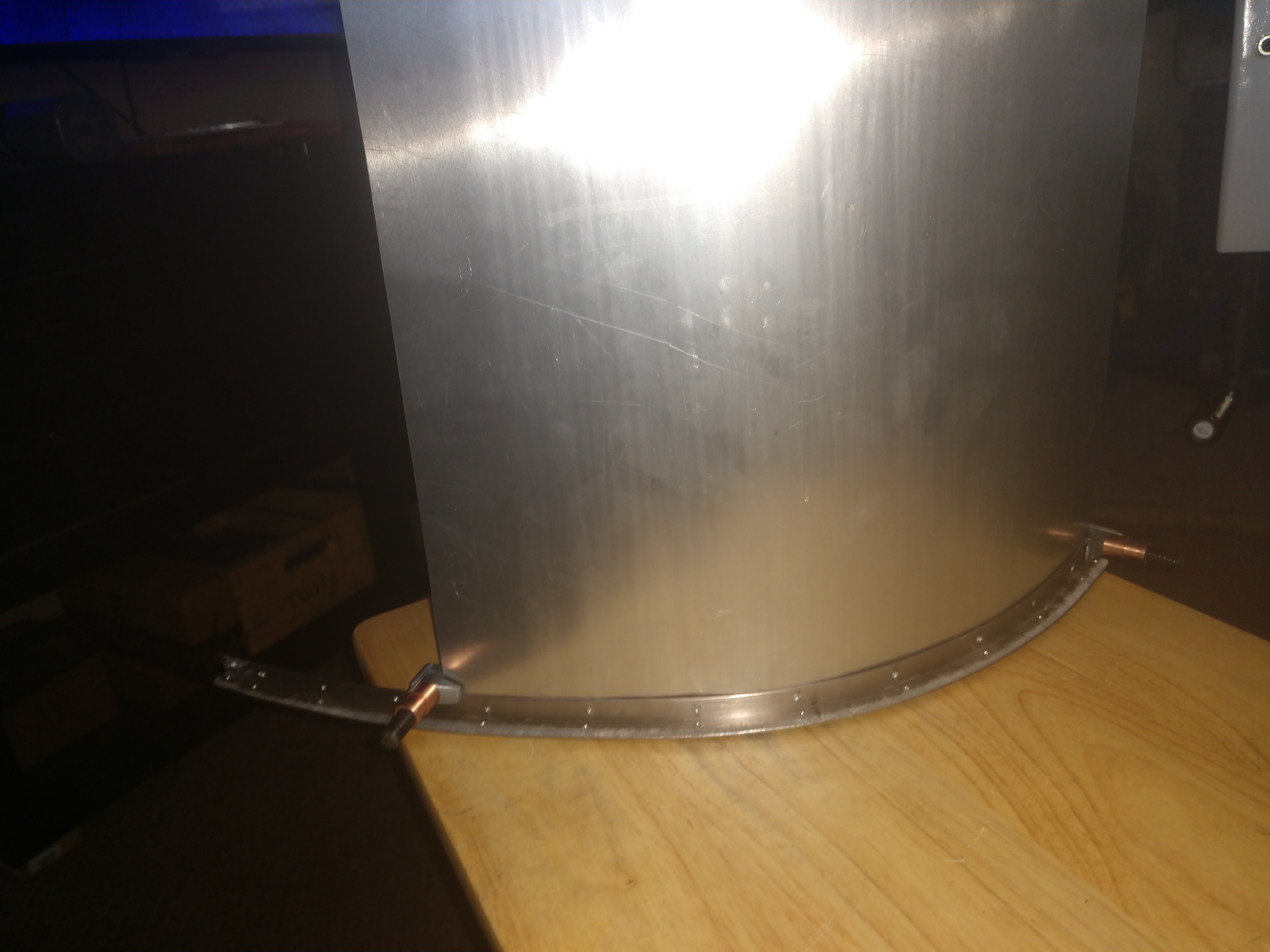

Today is my 10th anniversary here in my house. Closed escrow on 7-3-2014. The shape of the panel I just produced is perfect and will help me with a decision on the exhaust system. What I'm thinking about is dial megaphones with supertraps. But they interfere with the diffuser. I'm trying to fit them in-between the stakes and I thinking about it all the time. I have a slip roller. But just like anything else I have no idea yet.

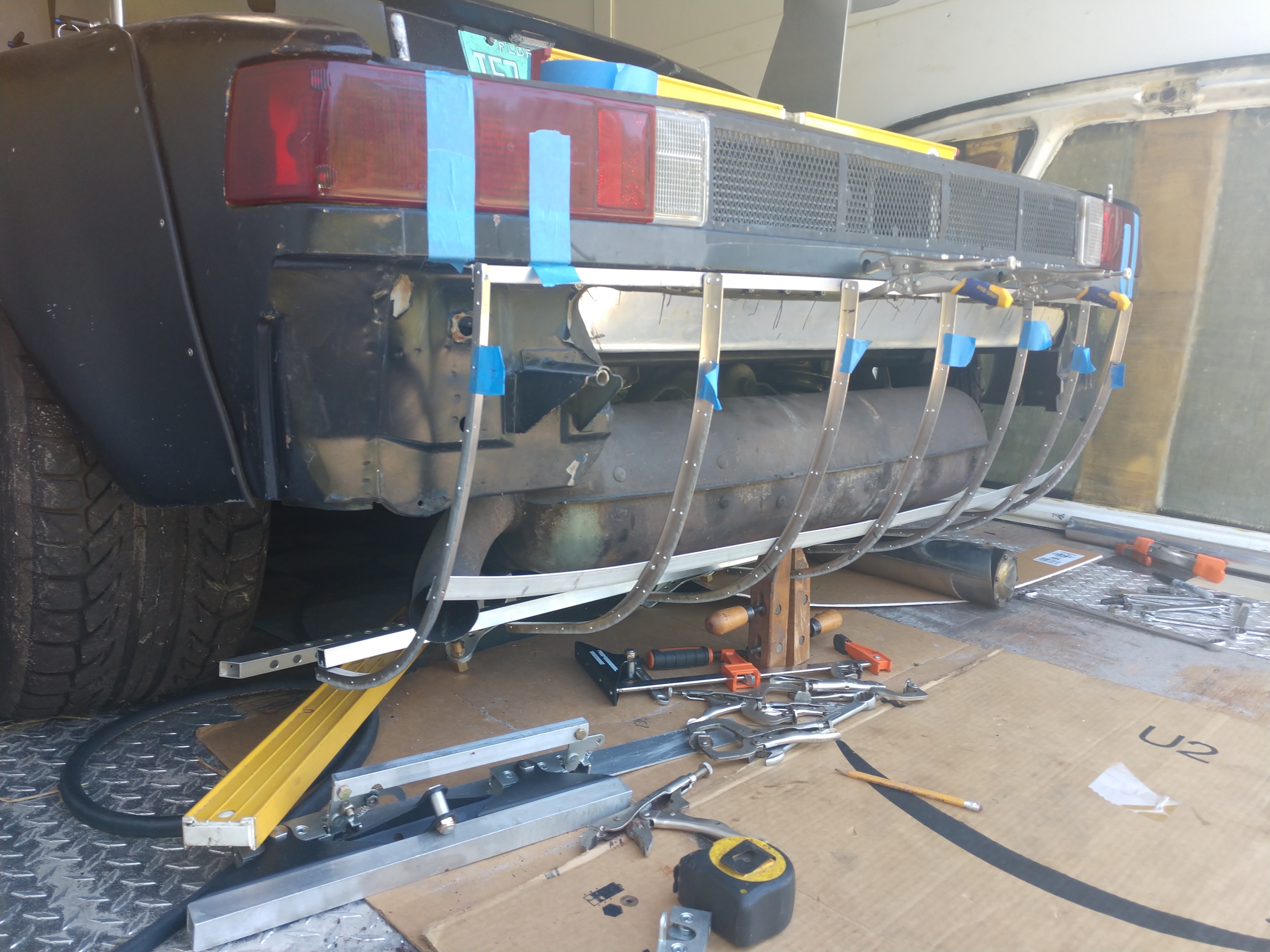

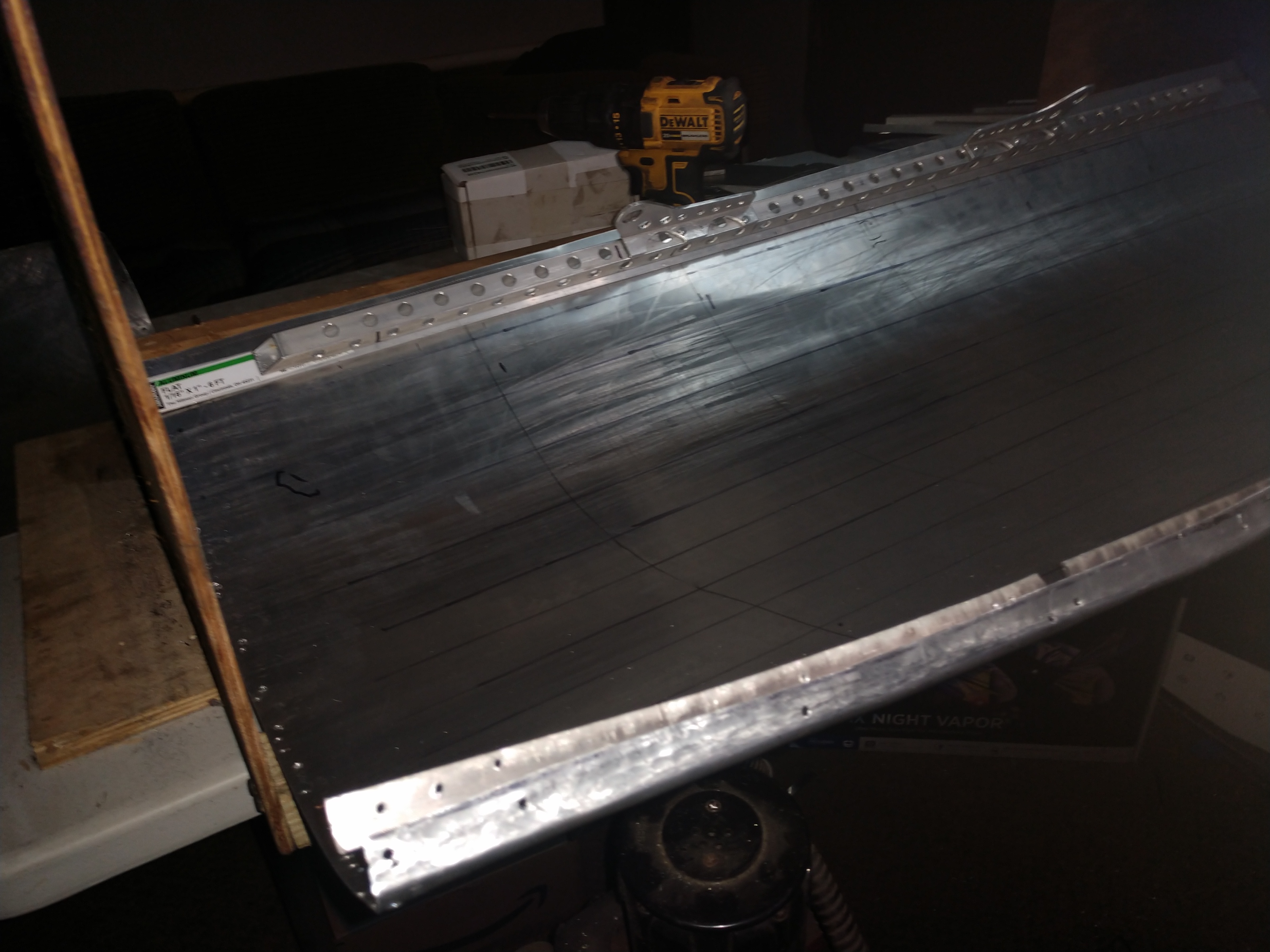

So close, in the picture looking closely you can see that the diffuser skin needs some shrinkng on both ends to make it match the aluminum angle backing who's shape matches the rear of the car. The strakes supports also need shrinking, that and the brace across the back and I can try a fitting. Just dreaming but it would be nice if it can be propped up in place.

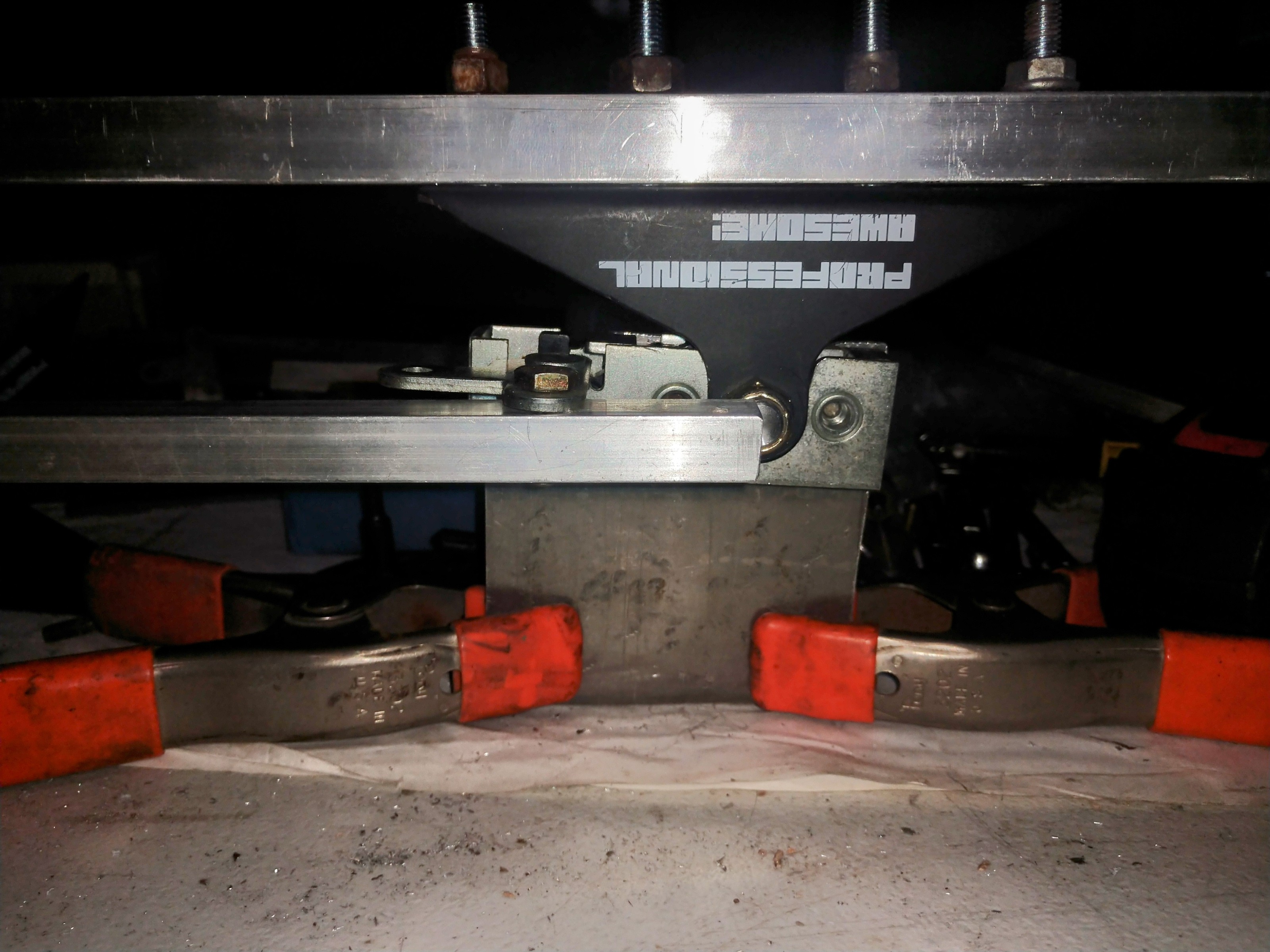

Just got the latches bolted together working twords getting the dimension for the elevation of the flange to support the brackets to mount all of this.

The latches upside down, the square tubing gets bolted to the brackets attached to the flange on the inside of diffuser.

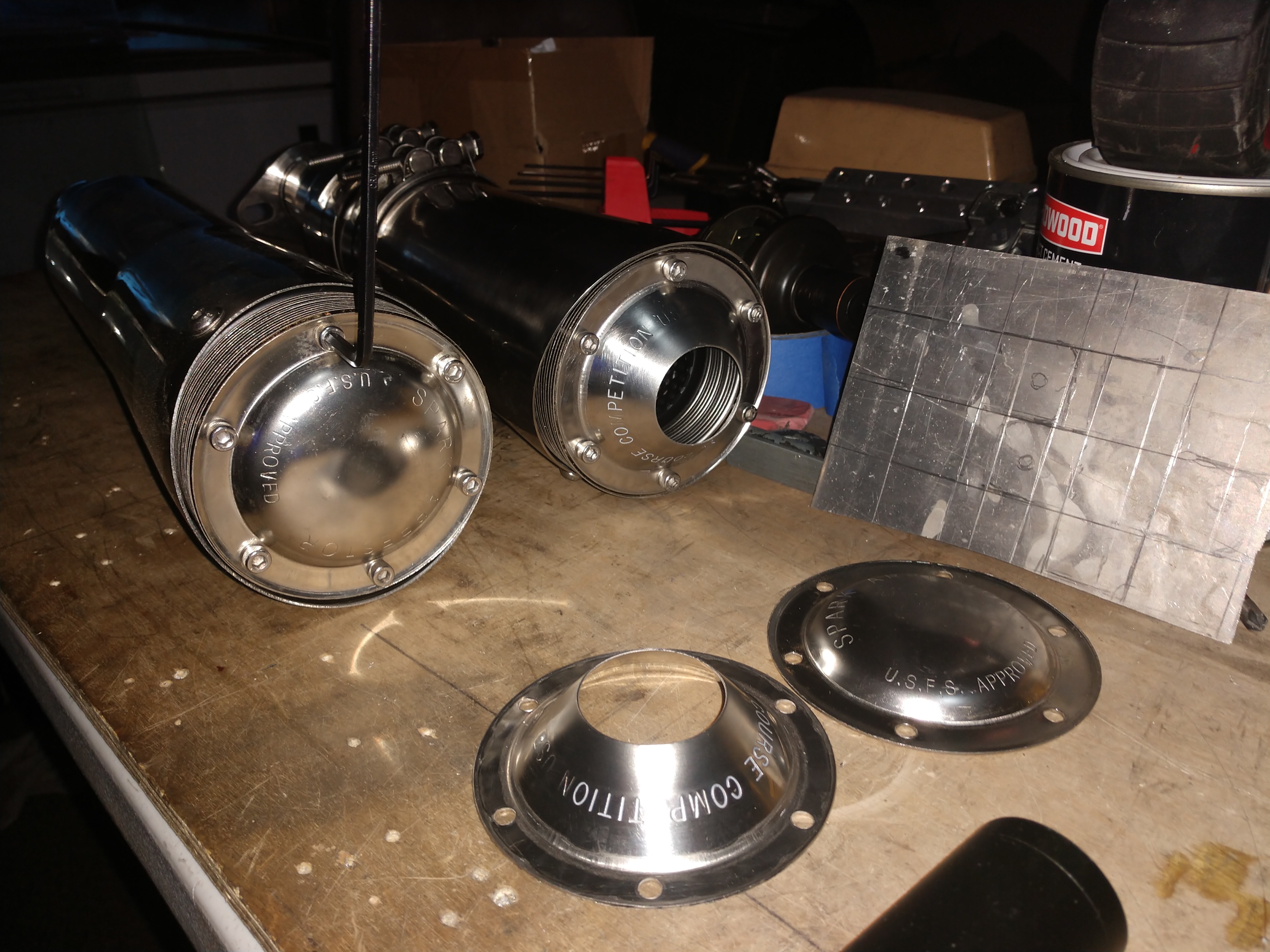

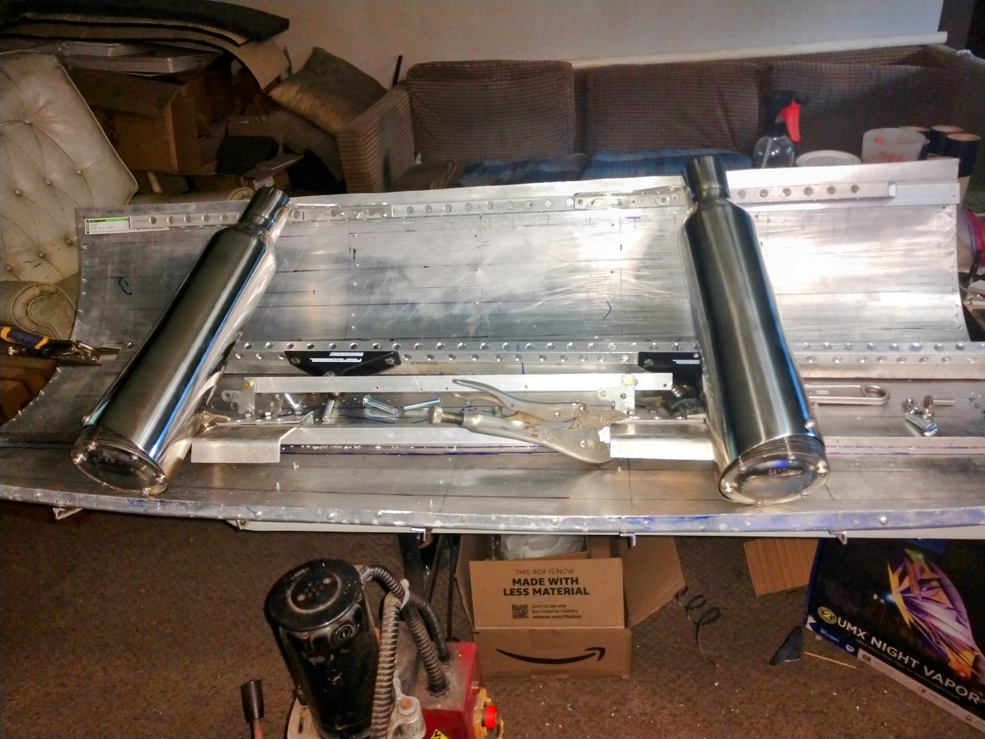

Yesterday the new mufflers arrived and they need to penetrate the skin on the diffuser. I need to make up flanges with a 2" nipple. That gives me the option for the exit location.
Supertraps 2" x 4" megaphones 18" long. Straight out the back, sorta.

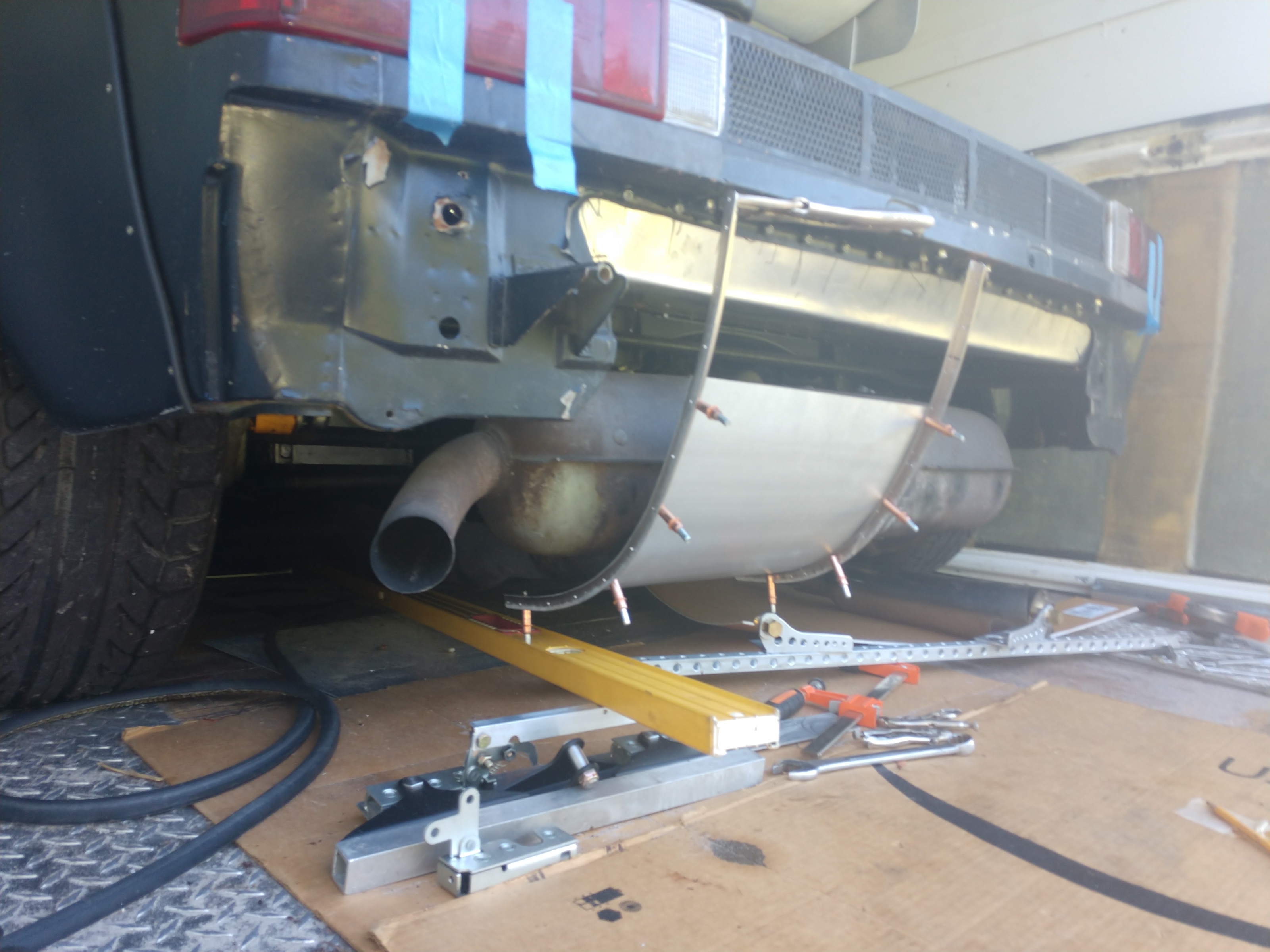

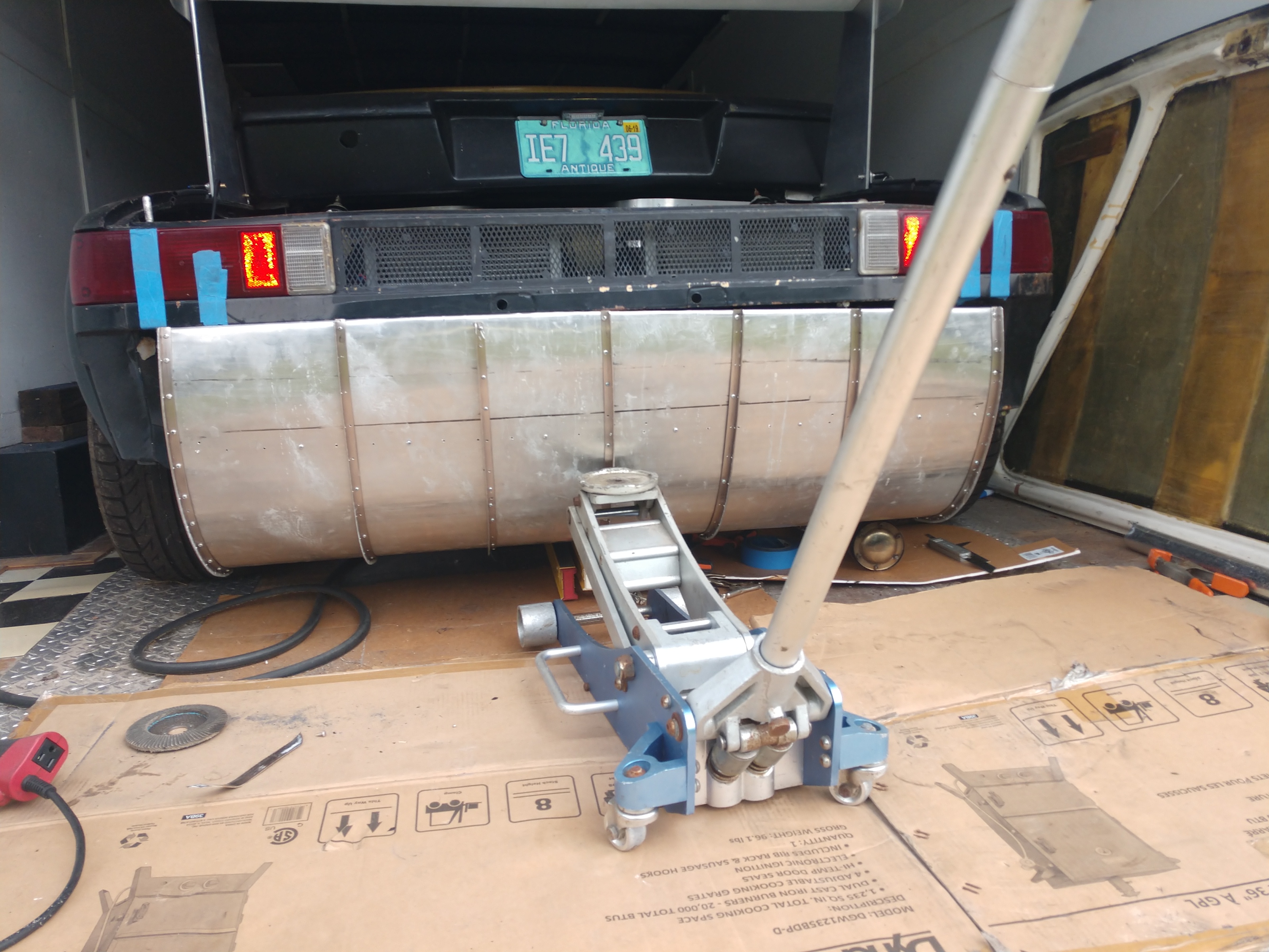

Now with 75,000 viewers I am aghast. So many people looking to see what the fuck I'm doing. Well here's another picture of something only I would be foolish enough to think it could be done. The diffuser placed in about the position it would belong in.
It appears low but it's still above the exhaust collector which it needs to go under as it is the low place on the car. Gunna have to put some tits on her bottom to clear the collectors

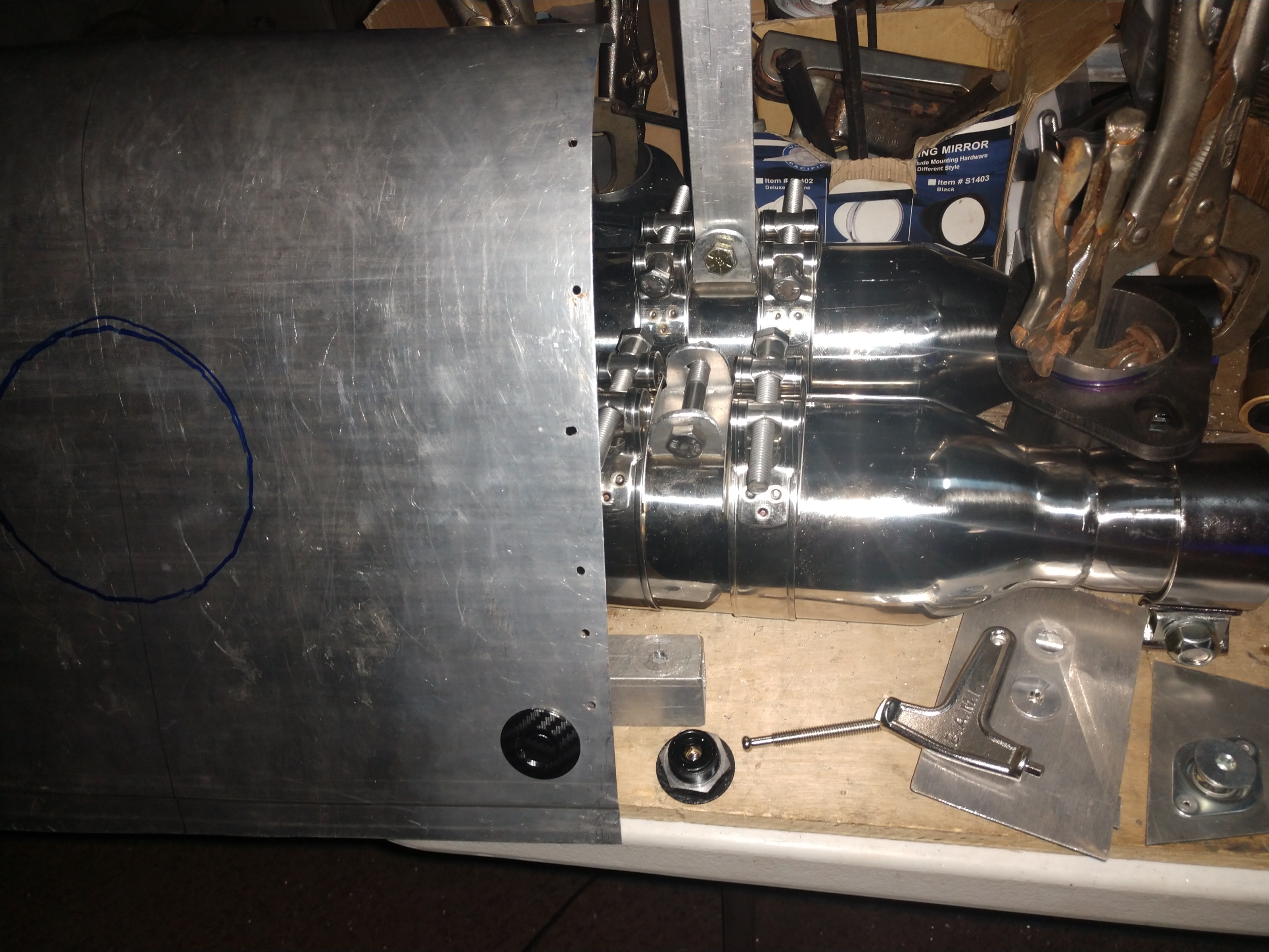

I've been getting the mufflers ready for bracketing. You know, I like lightening holes so I am really enjoying the loud option on the Super traps. Just bring a hole it puts a smile on my face. Visually it appears attractive to me. We'll see later if I still like them after listening to them.
I am waiting for prime to deliver a new blade for my band saw, then I get to attack the brackets and the flanges. Oh, still waiting on the flanges too.
These mufflers are so Kool man.
