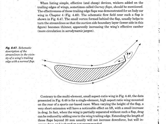

heheh some wicker data

Can't quite read it...can you blow it up a bit?

Please try to repost info.

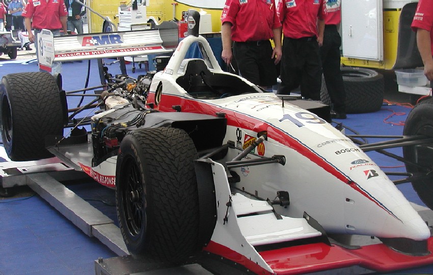

(IMG:http://www.914world.com/bbs2/html/emoticons/cool.gif) Here is a picture of a spoiler and wicker bill strip on a CHAMP car from the Long Beach grand prix.

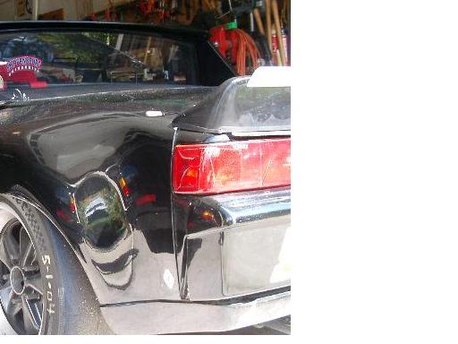

I put one one my spoiler. Not sure if it works but I won my class at Las Vegas. Sorry that I don't have a better picture. The car is not at home right now.

I resized the scan I posted, didnt realize it was so hugantic
