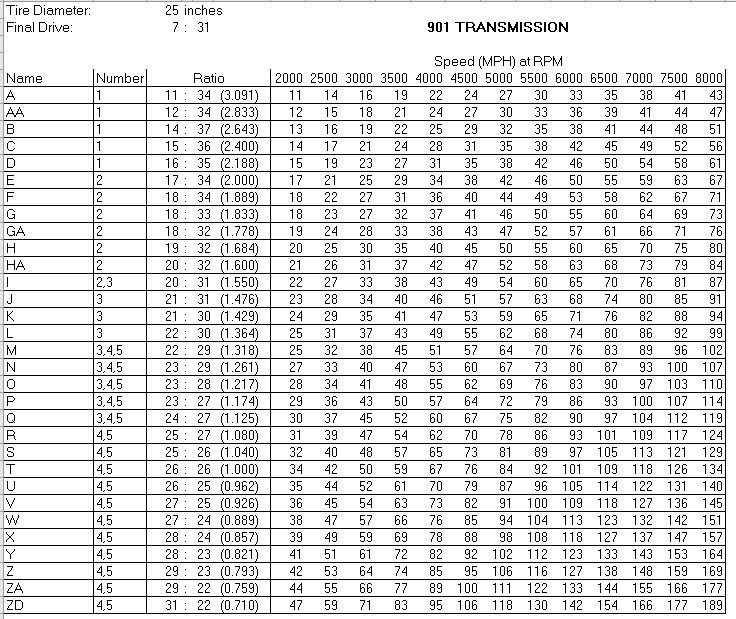

Here's a gear chart
Steve
post Sep 27 2017, 10:31 AM
Posts: 5,889
Joined: 14-June 03
From: Laguna Niguel, CA
Member No.: 822
ZD is the stock 5th gear.

Most reliable way is to use a GPS speedometer app on your cellphone to see what rpm equates to 80 mph. The VDO speedometers are sometimes rather optimistic in my experience and tire diameters also affect the actual speed you're traveling.

You could have a non-standard 5th gear, but its doubtful. More than likely you have tires that are less than 25" in diameter. (note that piece of info at the top of the gear chart posted by Steve.) Speed at rpm can be calculated by referencing the gear chart and multiplying by the ratio of (your tire diameter)/25". You can find your tire diameter, or a very close approximation, by looking up your tire size on TireRack and looking at the spec sheet.
