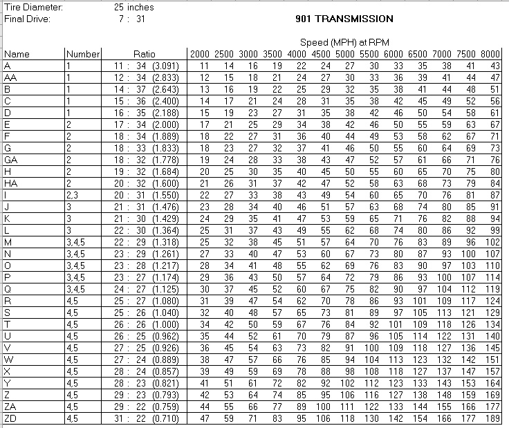

Sep 27 2017, 10:30 AM
Steve
Sep 27 2017, 10:31 AM
ZD is the stock 5th gear.
Here is a page with more info.
http://www.914world.com/specs/regearing_901.php

Most reliable way is to use a GPS speedometer app on your cellphone to see what rpm equates to 80 mph. The VDO speedometers are sometimes rather optimistic in my experience and tire diameters also affect the actual speed you're traveling.

thelogo
Sep 27 2017, 01:55 PM
I'll attempt to confirm 83mph at 3500 rpm with gps
But something tells me that a bit on the high side .
I think its more like 75 mph

You could have a non-standard 5th gear, but its doubtful. More than likely you have tires that are less than 25" in diameter. (note that piece of info at the top of the gear chart posted by Steve.) Speed at rpm can be calculated by referencing the gear chart and multiplying by the ratio of (your tire diameter)/25". You can find your tire diameter, or a very close approximation, by looking up your tire size on TireRack and looking at the spec sheet.
