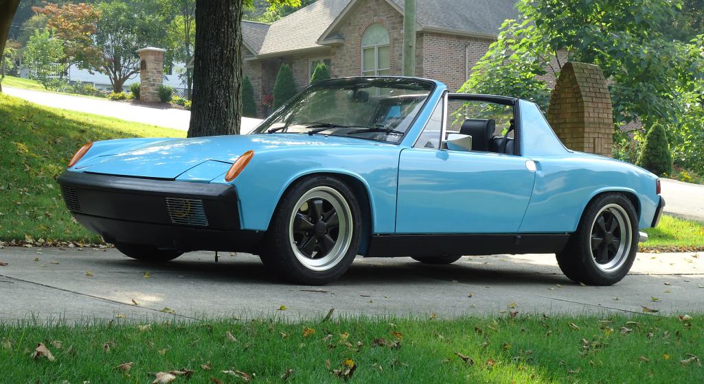

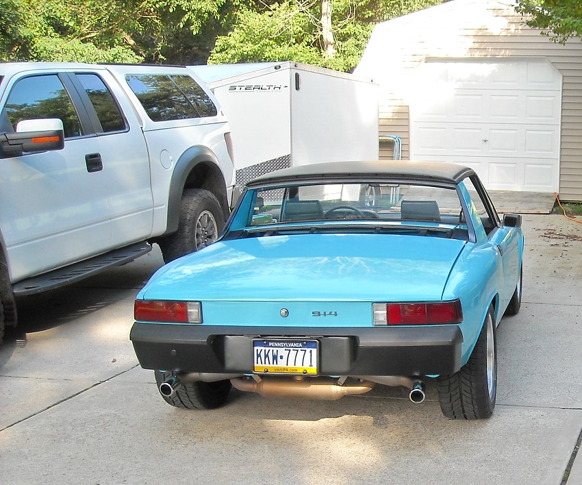

Another 7x16 Front, 8x16 Rears. 951 wheels 23.3 offset. both ends.
Tires are 205/50-16 front and 225/50-16 rear.
Tangerine flares on both ends, need the 23 offset wheels on the rear to clear these tires.
it does sit a little high in the rear. I will drop it down someday....

^^^ Fantastic semi-narrow bodies with 951 7s and 8s above!!! ^^^ (IMG:style_emoticons/default/smilie_pokal.gif)

Please be sure to post both the wheel size and tire size that are used on the 914 in your pictures (If known).
Like Olympic 914 did in his great looking 914.
It really helps to know both when selecting the right fit.
