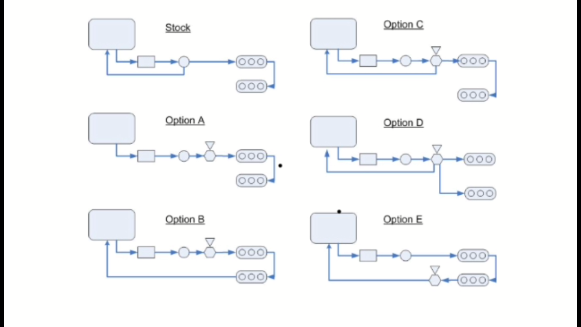

Krieger
post Feb 4 2018, 10:59 PM
Posts: 4,822
Joined: 24-May 04
From: Santa Rosa CA
Member No.: 2,104
To be clear the rectangle is the filter. Circle is the pump. Triangle/ hex is the regulator. Right Brant?

I like option E with double barb banjos on the carbs (IMG:style_emoticons/default/smile.gif)
But it would depend on the type and range of regulator. Second choice would be option D with a Y feeding carbs.

I have Dellorto carbs so one has the menu intake line & a double banjo that then feeds the second carb. I was thing if both carbs had double banjo’s that the second outlet on the the slave carb could run as a return line. Do you guys think that would work ok? I do not believe my fuel pressure regulator has an option for a return line.

QUOTE(gothspeed @ Feb 4 2018, 11:21 PM) *
But it would depend on the type and range of regulator. Send choice would be optio D with a Y feeding carbs.
To make sure I understand correctly, C and D would require a bypass style regulator while B and E would use blocking type. Do I have that right?

QUOTE(bbrock @ Feb 5 2018, 06:27 AM) *
Yes, there are regulators that 'send out' a regulated target pressure (inline) and some that 'bleed out' anything over your target pressure (return). (IMG:style_emoticons/default/smile.gif)

QUOTE(bbrock @ Feb 5 2018, 10:27 AM) *
Yes, except that in option B the upstream regulator is useless. A blocking regulator is needed downstream.
We had a 914 here recently which came with a single carb that had an internal regulator. It needed the return line to work.
Otherwise I don't think I've ever seen a 914 with a carb setup in my shop (other than stock 914-6) that used a return line.

I've been running dual dell's with an "option C" return line since the early 1980s . . . works well. (IMG:style_emoticons/default/smile.gif)

QUOTE(Racer Chris @ Feb 5 2018, 07:46 AM) *
And that answers my next question about option B (IMG:style_emoticons/default/biggrin.gif) I'm planning to run a return line on my carbed /4. I might want to switch back to FI in the future so it seems like a good way to future-proof the setup. Plus, I like the idea of a return line anyway.

QUOTE(Krieger @ Feb 4 2018, 09:59 PM) *
correct

What's up guys! I just purchased a pair of Dell 40's which I'm currently rebuilding at the moment. I like the idea of running a fuel return for 1.7 as some have discussed but my question has to do with the fuel pump and regulator set up. Can you run a low pressure (rotary style) fuel pump i.e. (CB Performance / Carter) with Option E and delete the regulator from the drawing? Or would I need to keep a high pressure set up with a good aftermarket regulator like Mallory ect. to make up for the amount of flow for the return and not flood the carbs?
