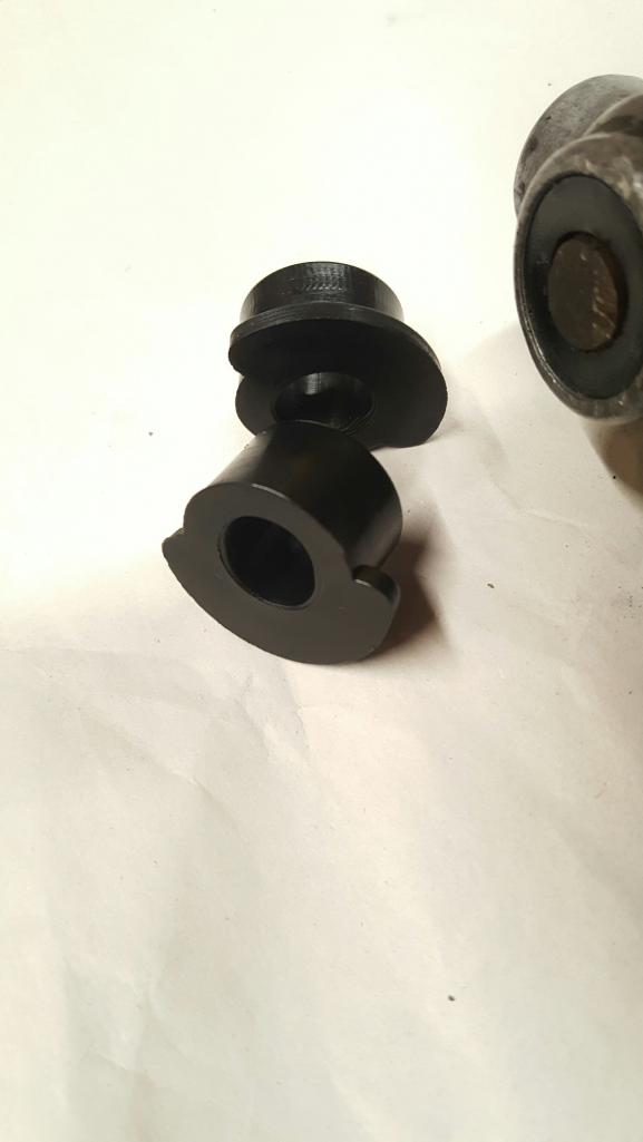

we have made the delrin shift coupler bushings for years with the perfectly round hole ever since Porsche modified the original part number to resemble the oval hole of the 356 911 cars and if installed in a 914 caused shifter slop.

I have tried several bushing out there and most are not good. Got a set from Sierra Madre and they were over size on the pin hole and under size on the OD. Got some through Pelican and they were too tight on the OD and had to be drawn in with a bolt and nut. Porsche elongated to hole but no one likes them. Anxious to try Marks bushings. Have not tried AA or Uro. Seen enough problem with their other parts.

Mark, I love ya son but................those bronze bushings from pelican are soooooo nice. However at $50 bucks a pop + their usual shipping (HiJack) charge, yours are about %1000 cheaper. (IMG:style_emoticons/default/beerchug.gif)
