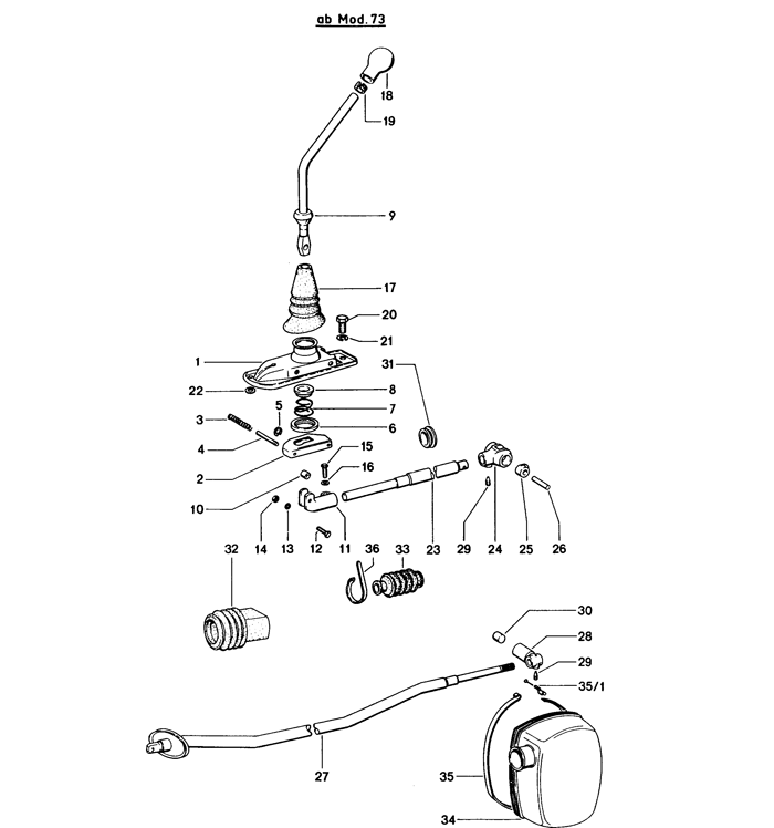

How do you replace the bushings (#25 in the illustration) in the shift rod coupling (#24)? This is a side shift trans.

You need to drive the pin out (#26 in the picture). That can be a real bear depending on the level of crud on it. A lot of PB Blaster and heat and either a press or a vice, drift, and large cheater bar.

I was having some trouble with the pin. I ended up cutting up a soda bottle and filling it with PB blaster. Soaked for 72(!) hours straight. I tried hammering it out once each evening until I finally got it on the third night of soaking. Maybe I was being a little too careful about cracking the weld on the fork of the shift rod, but I really didn’t want to find out.
