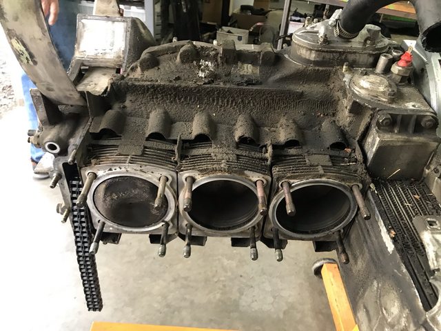

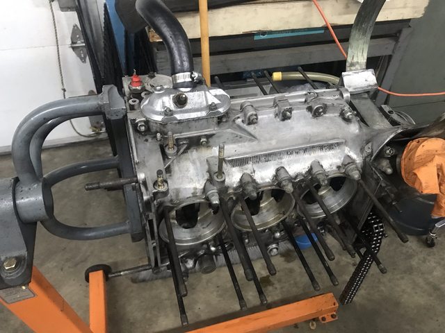

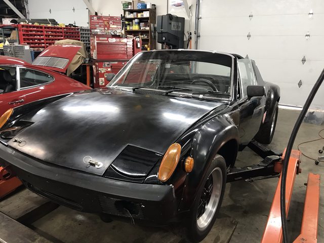

It's been a while since I posted on the black car after this trip. About six months ago, the transmission started getting really difficult to shift, and I decided the black car was due for its engine rebuild at the same time, as it was smoking at idle.
Out came the engine and transmission. It was filthy.\
(IMG:http://www.914world.com/bbs2/uploads_offsite/i.imgur.com-21443-1580698606.1.jpg)
(IMG:http://www.914world.com/bbs2/uploads_offsite/i.imgur.com-21443-1580698606.2.jpg)

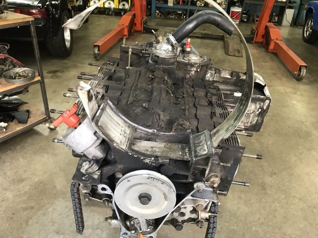

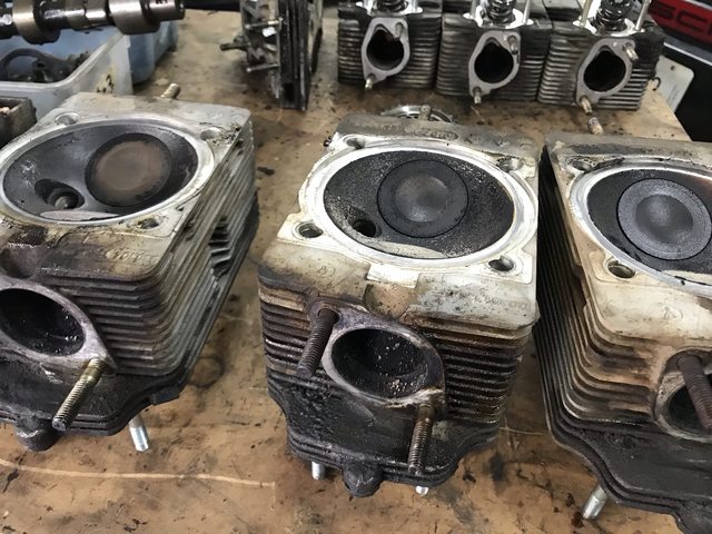

Heads were filthy and valves nicely carbonized.
(IMG:http://www.914world.com/bbs2/uploads_offsite/i.imgur.com-21443-1580698606.3.jpg)

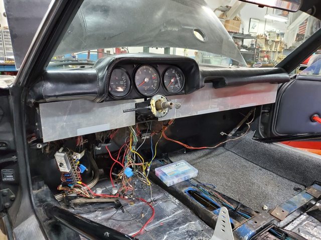

The harness to the ECU was a spaghetti nest of wires and various parts butt crimped.
(IMG:http://www.914world.com/bbs2/uploads_offsite/i.imgur.com-21443-1580698606.4.jpg)

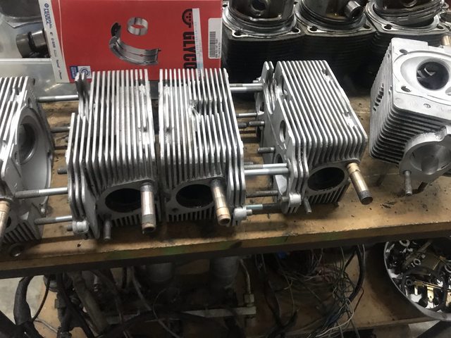

What a difference a bath makes!
(IMG:http://www.914world.com/bbs2/uploads_offsite/i.imgur.com-21443-1580699075.1.jpg)

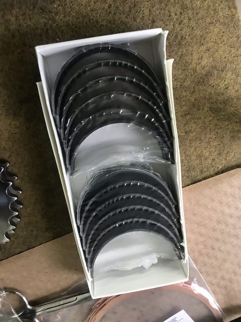

First up was the rod bearings, which were slightly scored. New racing ones which were nicely coated.
(IMG:http://www.914world.com/bbs2/uploads_offsite/i.imgur.com-21443-1580699076.2.jpg)

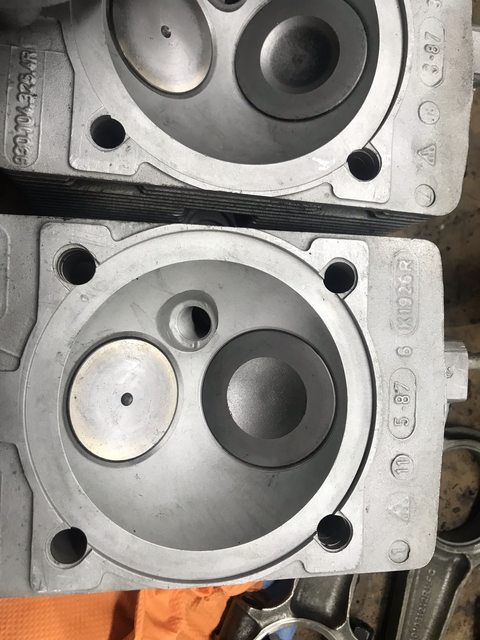

Heads were redone, new valve stems and seals, and cleaned and ground the valves:
(IMG:http://www.914world.com/bbs2/uploads_offsite/i.imgur.com-21443-1580699076.3.jpg)
(IMG:http://www.914world.com/bbs2/uploads_offsite/i.imgur.com-21443-1580699076.4.jpg)

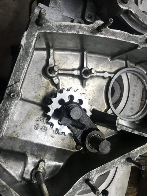

Checked and changed the tensioner
(IMG:http://www.914world.com/bbs2/uploads_offsite/i.imgur.com-21443-1580699076.5.jpg)

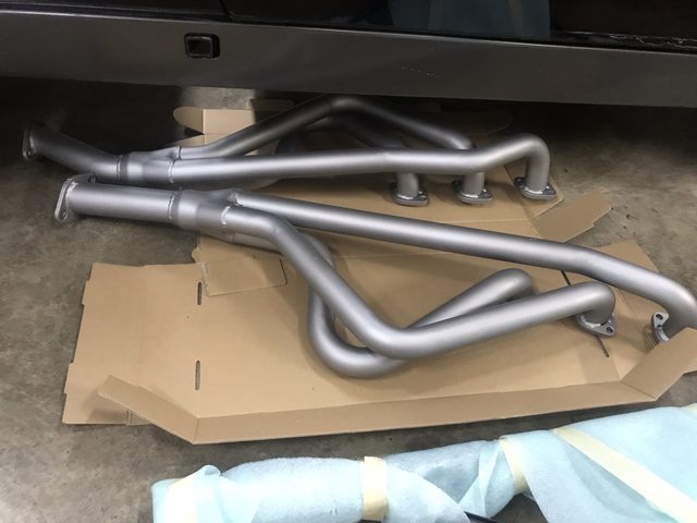

Cera coated the headers
(IMG:http://www.914world.com/bbs2/uploads_offsite/i.imgur.com-21443-1580699076.6.jpg)

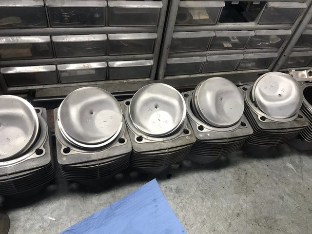

Cleaned and ringed the pistons
(IMG:http://www.914world.com/bbs2/uploads_offsite/i.imgur.com-21443-1580699076.7.jpg)

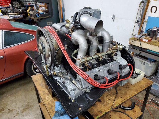

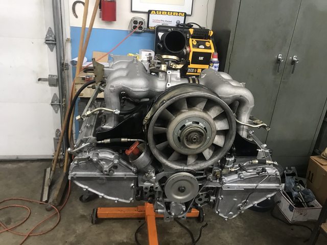

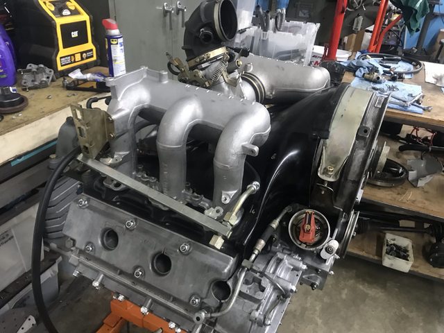

Engine went back together, replaced fuel lines and injector o-rings:
(IMG:http://www.914world.com/bbs2/uploads_offsite/i.imgur.com-21443-1580699076.8.jpg)
(IMG:http://www.914world.com/bbs2/uploads_offsite/i.imgur.com-21443-1580699077.9.jpg)
(IMG:http://www.914world.com/bbs2/uploads_offsite/i.imgur.com-21443-1580699077.10.jpg)

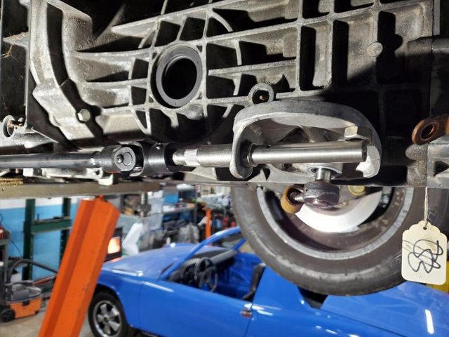

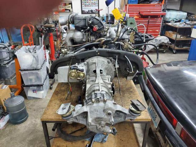

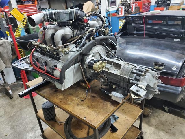

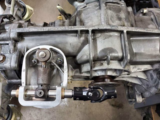

The transmission was cracked open. The gears and synchros were almost new, but the bushings were shot, and the shift rod was a home brew from the prior owner, who also put in a super short 5th gear. We put a tall 5th gear in, and added the Tangerine Racing shift kit. No slop!
(IMG:http://www.914world.com/bbs2/uploads_offsite/i.imgur.com-21443-1580699562.1.jpg)
(IMG:http://www.914world.com/bbs2/uploads_offsite/i.imgur.com-21443-1580699562.2.jpg)
(IMG:http://www.914world.com/bbs2/uploads_offsite/i.imgur.com-21443-1580699562.3.jpg)
Axles were cleaned and bearings repacked
(IMG:http://www.914world.com/bbs2/uploads_offsite/i.imgur.com-21443-1580699563.4.jpg)

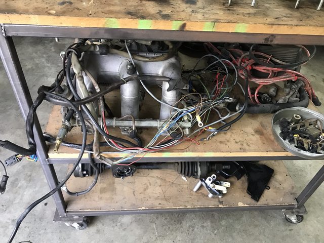

Soldered back the ends on the rats nest of wires to the ECU, so now everything is stock. Put back together and it's ready to bolt in next week...after we replace the ugly autometer tach with a 914-6 NOS one.
(IMG:http://www.914world.com/bbs2/uploads_offsite/i.imgur.com-21443-1580699563.6.jpg)
(IMG:http://www.914world.com/bbs2/uploads_offsite/i.imgur.com-21443-1580699563.7.jpg)

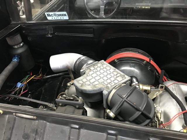

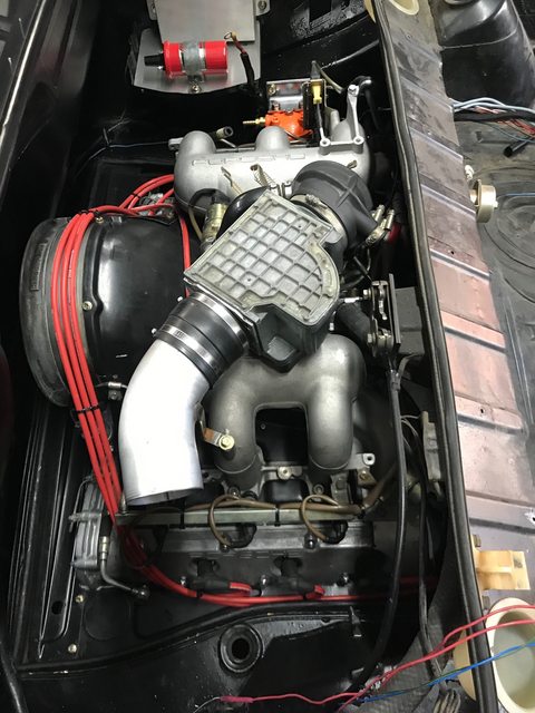

Woohoo! Engine and transmission are back in the car!
(IMG:http://www.914world.com/bbs2/uploads_offsite/i.imgur.com-21443-1583465289.1.jpg)
(IMG:http://www.914world.com/bbs2/uploads_offsite/i.imgur.com-21443-1583465289.2.jpg)

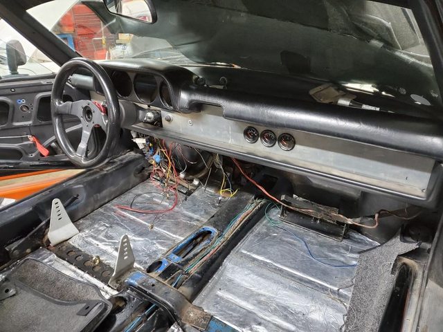

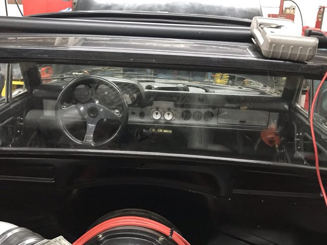

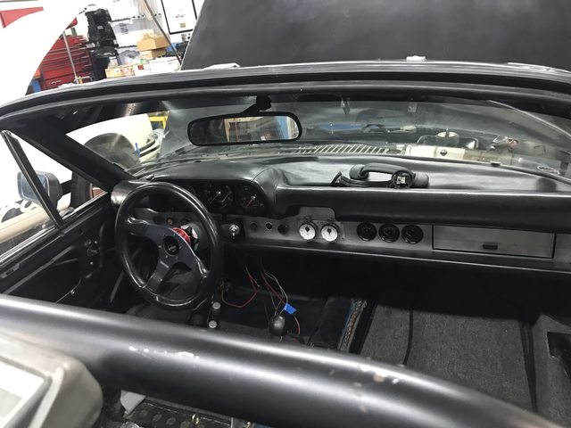

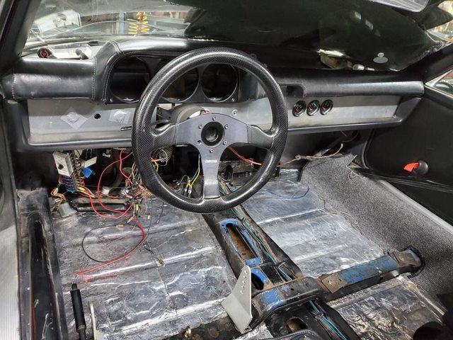

Wiring still needs some clean up - so many odd things were found and corrected.

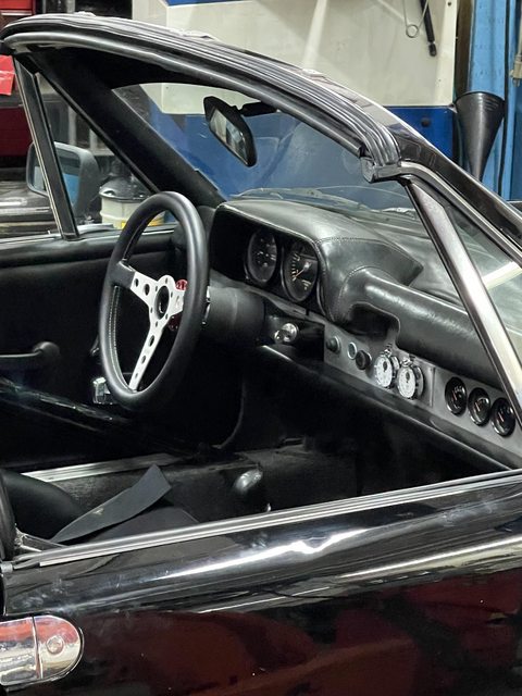

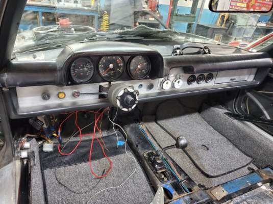

Now to tackle the dash. I didn't want to pretty this up too much - that's for my 2.7 conversion, and anything I do to "pretty up" this outlaw makes other parts look worse.
So I decided what was needed was to convert the ugly dash, first by swapping the oversize autometer tach with a stock 914-6 tack, then remove the racer boy push starter in favor of a proper keyed ignition, and replace the tacked on metal faceplates with a full aluminum dash face, which will be brushed once the gauges and switches are finished.
Started with this:
(IMG:http://www.914world.com/bbs2/uploads_offsite/i.imgur.com-21443-1583465589.1.jpg)
Made into this:
(IMG:http://www.914world.com/bbs2/uploads_offsite/i.imgur.com-21443-1583465289.3.jpg)
Installed gauges:
(IMG:http://www.914world.com/bbs2/uploads_offsite/i.imgur.com-21443-1583465289.5.jpg)
(IMG:http://www.914world.com/bbs2/uploads_offsite/i.imgur.com-21443-1583465289.6.jpg)
I'm on the fence about doing the glove box or leaving it out, but I think I will have it cut in. Switches come in next, then stock gauges go back in, then finish off carpet kit.
I decided to keep the "pony keg" which is not really needed here in the PNW, but it was in the car and I can't see spending another $1k for a tank and fittings when what I already have works great.

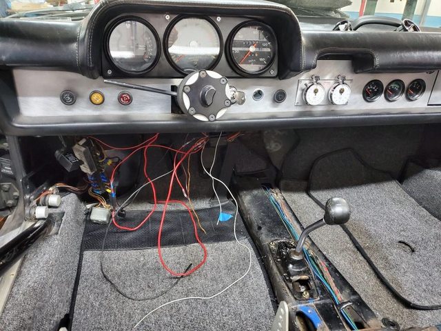

Finished up the dash. I had a large blank spot where the heater controls and ashtray once were, and it looked pretty bland. Watched some older videos of 914 rally cars and decided a set of vintage Heuer track stop watches would be a fun touch, so on they went. Note the glove box - decided it would be helpful to have.
(IMG:http://www.914world.com/bbs2/uploads_offsite/i.imgur.com-21443-1585770620.1.jpg)
(IMG:http://www.914world.com/bbs2/uploads_offsite/i.imgur.com-21443-1585770620.2.jpg)
(IMG:http://www.914world.com/bbs2/uploads_offsite/i.imgur.com-21443-1585770620.3.jpg)
(IMG:http://www.914world.com/bbs2/uploads_offsite/i.imgur.com-21443-1585770620.4.jpg)
And now I have functioning turn signals, high and low beams, and wiring for the fog lights, plus all the switches were upgraded and all the lights for them and the gauges work!

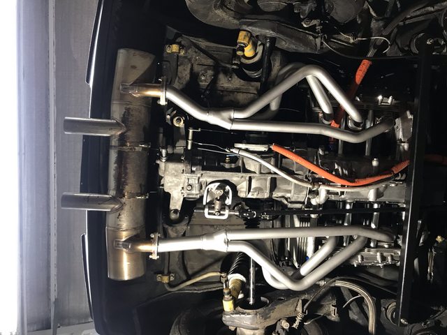

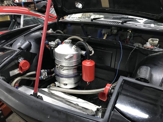

Oil tank and lines were finished.
(IMG:http://www.914world.com/bbs2/uploads_offsite/i.imgur.com-21443-1585770621.6.jpg)
Engine fired up and it was awesome to hear it come to life again! Ben's GT muffler didn't seem as loud (didn't get a chance to drive it, only fire it up). I wonder if the cerra coat made things quieter. Will be interesting to see when I drive it, but damn his GT muffler looks great.
(IMG:http://www.914world.com/bbs2/uploads_offsite/i.imgur.com-21443-1585770621.7.jpg)

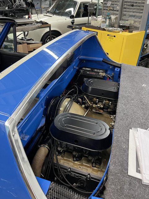

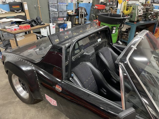

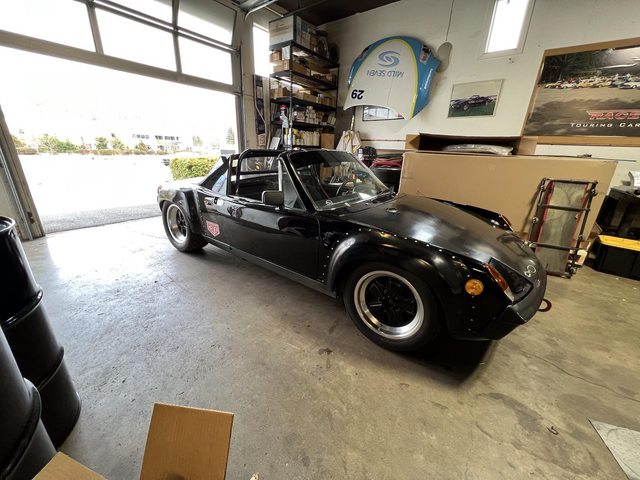

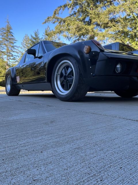

Lots of goodness with the Outlaw. I’m having the roll cage altered for better ingress, and finally upgraded the seats to something more period correct. Will also have an access panel cut for the firewall.
(IMG:http://www.914world.com/bbs2/uploads_offsite/i.imgur.com-21443-1642315226.1.jpg)
(IMG:http://www.914world.com/bbs2/uploads_offsite/i.imgur.com-21443-1642315226.2.jpg)
(IMG:http://www.914world.com/bbs2/uploads_offsite/i.imgur.com-21443-1642315226.3.jpg)
He’s looking pretty good
(IMG:http://www.914world.com/bbs2/uploads_offsite/i.imgur.com-21443-1642315287.1.jpg)

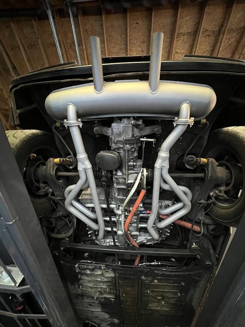

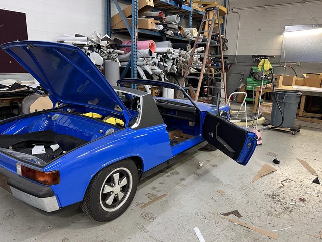

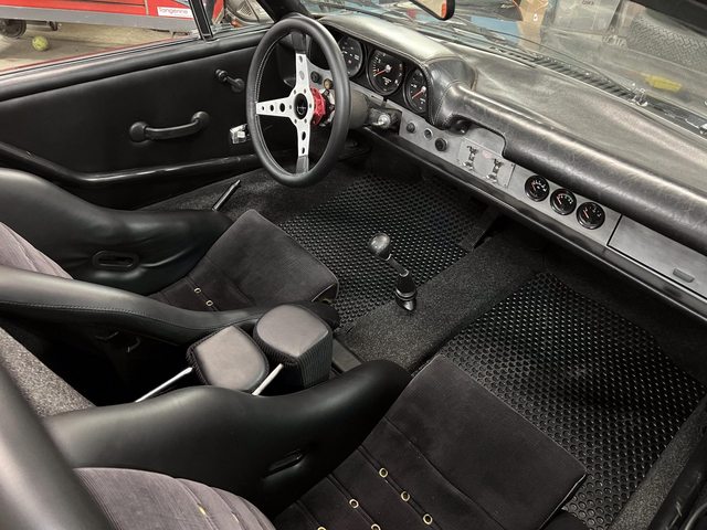

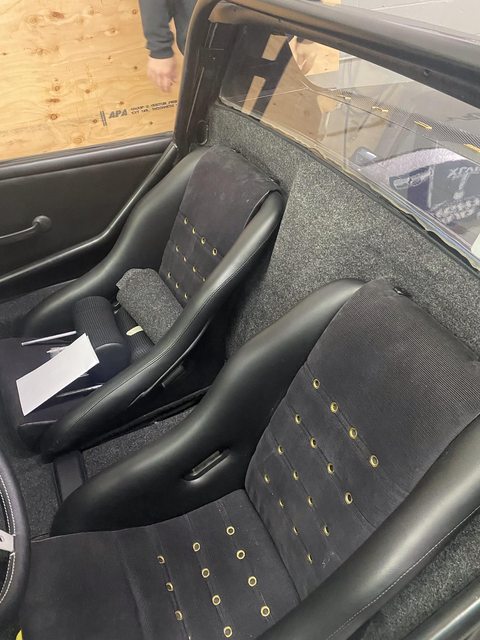

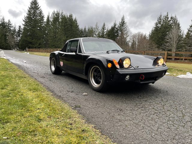

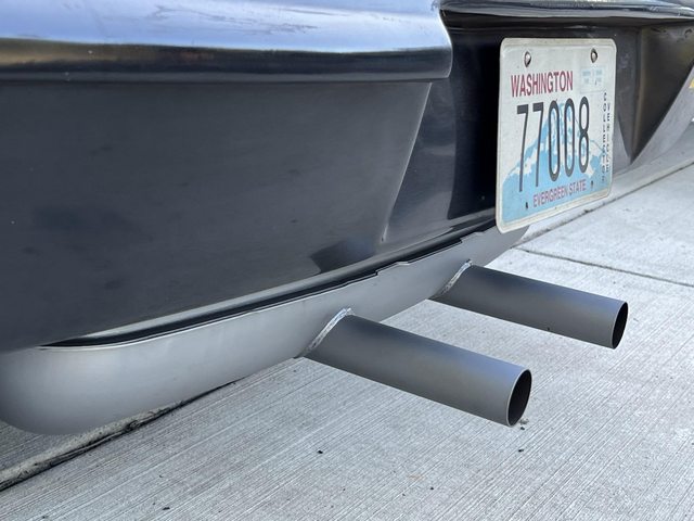

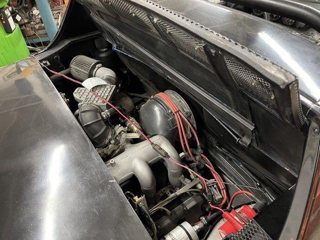

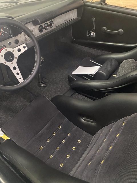

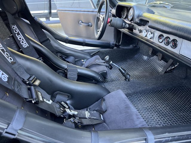

It’s been a while since the last update. I decided to clean up the interior and found some grey perlon carpet. Also tired of the yoga poses I needed to strike just to enter and exit. So I had the roll bars reshaped on the sides and installed a rear harness bar, and had an access bay installed to the engine to make belt changes a bit easier. I scored a set of GTS seats that looked much better and were way more comfy than the aging Momo shells.
(IMG:http://www.914world.com/bbs2/uploads_offsite/i.imgur.com-21443-1676820069.1.jpg)
(IMG:http://www.914world.com/bbs2/uploads_offsite/i.imgur.com-21443-1676820070.2.jpg)
The carpet kit turned out great, and I sourced some coin rubber mats to keep the floor from getting tatty and also give some grip. Since this is a street focused car, I also decided to wrap the roll bar surfaces with two piece safety pads to protect my head and arms.
(IMG:http://www.914world.com/bbs2/uploads_offsite/i.imgur.com-21443-1676820228.1.jpg)
(IMG:http://www.914world.com/bbs2/uploads_offsite/i.imgur.com-21443-1676820070.3.jpg)
(IMG:http://www.914world.com/bbs2/uploads_offsite/i.imgur.com-21443-1676820070.4.jpg)

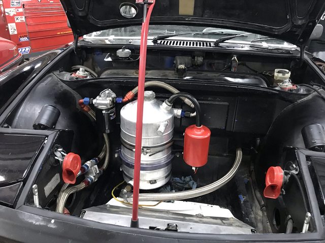

The oil keg also spring a pinhole leak, and I had challenges getting the engine oil up to temp, so I had the thermostat replaced with an adjustable trout an unit and the tank welded tight. Works great and I’m seeing about 180-195 on average days.
What’s left? The car looks great, and I’ve waffled on whether to paint or wrap. I chanced upon a set of OEM Porsche GT flares, but I love the look of the riveted flares, so I’m keeping them in case I damage the composite flares and then I’ll go whole hog on the full flare package. Until then, I’m likely to swap to a quieter GT muffler, but calling the car officially done for now.
(IMG:http://www.914world.com/bbs2/uploads_offsite/i.imgur.com-21443-1676820070.5.jpg)
(IMG:http://www.914world.com/bbs2/uploads_offsite/i.imgur.com-21443-1676820070.6.jpg)
(IMG:http://www.914world.com/bbs2/uploads_offsite/i.imgur.com-21443-1676820070.7.jpg)
Next up? Finishing the 2.7 twin plug conversion, which is in the home stretch.

I finally got around to swapping the muffler for a Dansk Sport Muffler. Ben's GT muffler looked the business, but I couldn't shake a persistent 2-3k rpm drone, and it was more aggressive tone than I wanted.
My son (and my fellow RGruppe pals) thought it sounded awesome, but missus didn't want to accompany me. OK then.
Dansk makes two types of sport 2 in/2out mufflers and this one is the basic one. The higher end one costs quite a bit more and is also louder (and has wider diameter exit pipes. I love the look of the higher end one, but the goal here was to make it less loud.
I had the Dansk cera-coated to match the headers and manage the heat. I also added a rear valence, makes it look more balanced.
(IMG:http://www.914world.com/bbs2/uploads_offsite/i.imgur.com-21443-1699744530.1.jpg)
(IMG:http://www.914world.com/bbs2/uploads_offsite/i.imgur.com-21443-1699744531.2.jpg)
(IMG:http://www.914world.com/bbs2/uploads_offsite/i.imgur.com-21443-1699744531.3.jpg)
(IMG:http://www.914world.com/bbs2/uploads_offsite/i.imgur.com-21443-1699744531.4.jpg)
