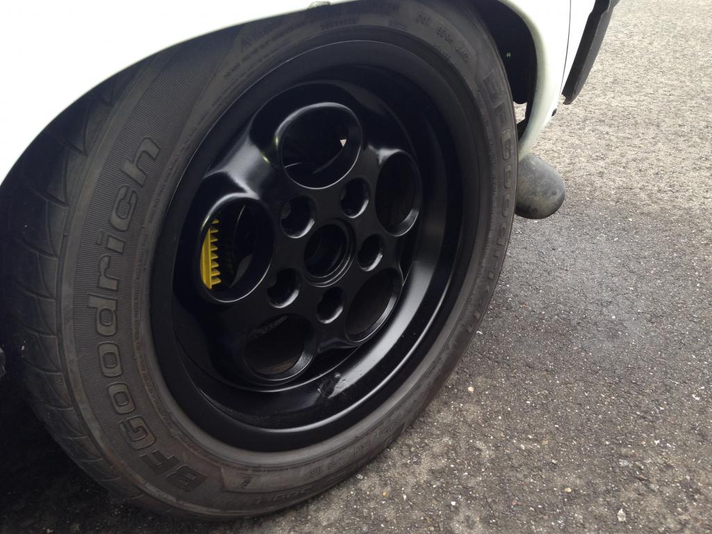

Here is a picture for you. James has newer pictures.

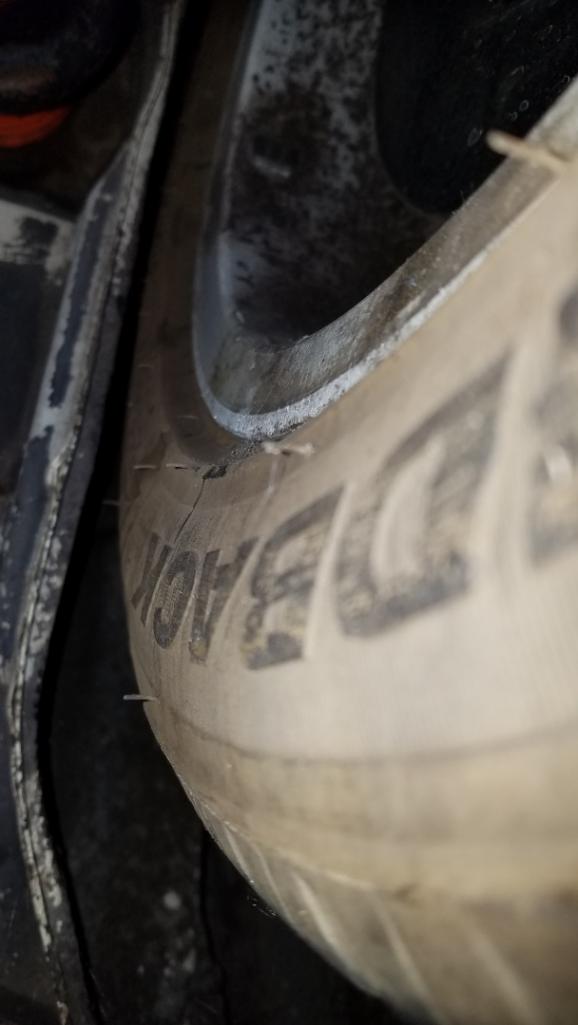

Mueller
post Jul 12 2018, 12:18 AM
914 Freak!
Posts: 17,155
Joined: 4-January 03
From: Antioch, CA
Member No.: 87
Inside clearance....this is car sitting at normal ride height.
