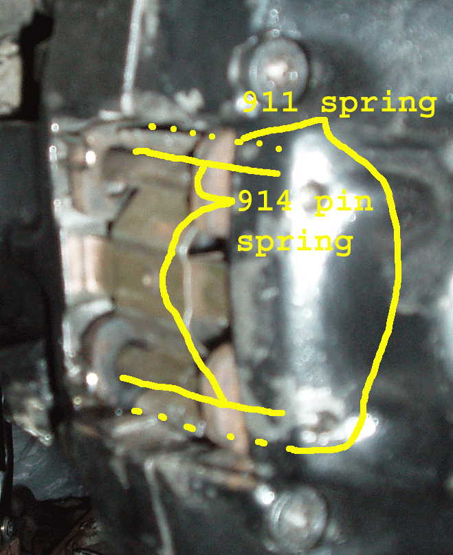

actually the pins and springs are straight 911. not custom. unless you think custom means having to bend the 2 springs (too wide and long) to make then fit correctly within the caliper. one pair of needlenose pliers and 5 minutes later. done. custom. (IMG:http://www.914world.com/bbs2/html/emoticons/cool.gif)
(IMG:http://www.914world.com/bbs2/html/emoticons/laugh.gif)
Actually... I think 'custom' means quite the opposite. More like it actually fits w/o bending anything (IMG:http://www.914world.com/bbs2/html/emoticons/lol3.gif)
Regarding the pins, straight 911 wouldn't have the one pin larger than the other and wouldn't fit tightly in the hole. Expect your pads to move around back there and some bizaarr wear patterns if not broken stuff.
well i know i'm very far away from being a real 914 pro however... (IMG:http://www.914world.com/bbs2/html/emoticons/wink.gif)
the pin spacing is smaller on a 914 than the 911. Hence having to "adjust" the spring inwards to support the pins in their closer position while maintaining the proper anti-rattle characteristics.
the PIN retainer clips ARE interchangeable.
I checked the fit of the pins through the pads and there is very little play. i don't know, perhaps we have different pins? mine fit perfectly through the calipers with zero play. if there's any measurable play it's pin to pad play... but is acceptable in my book. i'll look at that again and measure the play and get your opinion if there's too much play.

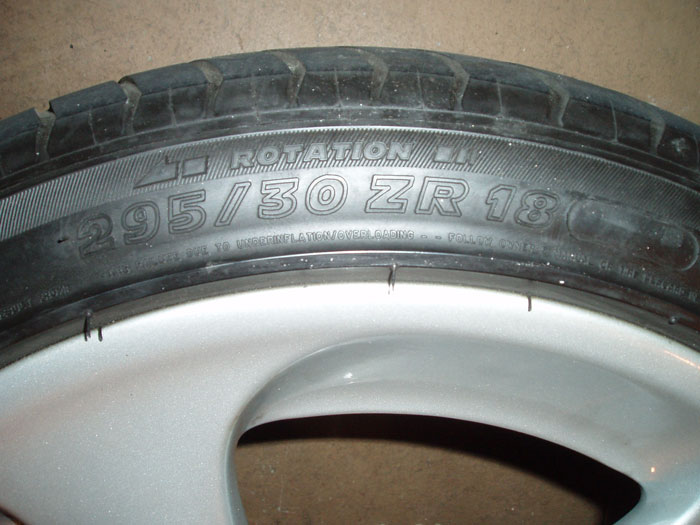

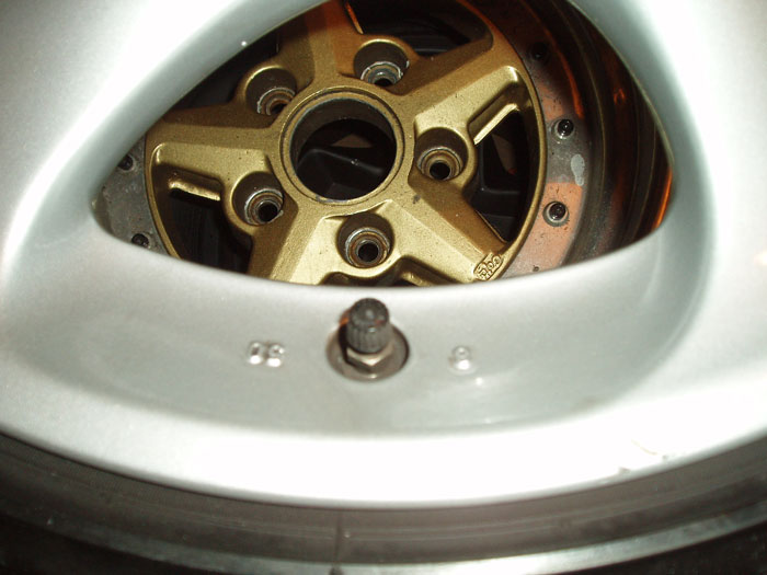

Mar7ck.
Here's the offsets.

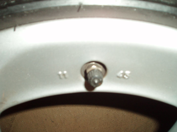

Dr. Roger
post Feb 24 2006, 06:00 PM
Post #329
A bat out of hell.
Posts: 3,944
Joined: 31-January 05
From: Hercules, California
Member No.: 3,533
and the rear size and offset.

11" 45mm offset.

pic of of the 911 pins using 911 spring with 914 caliper. 911 spring is "adjusted" to shorter distance between pins.

Yeah, I figured that out after studying the pic and comparing your casting numbers to ones I have. What really threw me off was that you have the older style rear calipers (with the ribe heads). Most of mine are later model. mine are not through bolted, but the outer half is threaded and the bolt simply screws into the outer half.
I also figured out about the bent 911 pad springs (bent for the closer spacing between pins).
