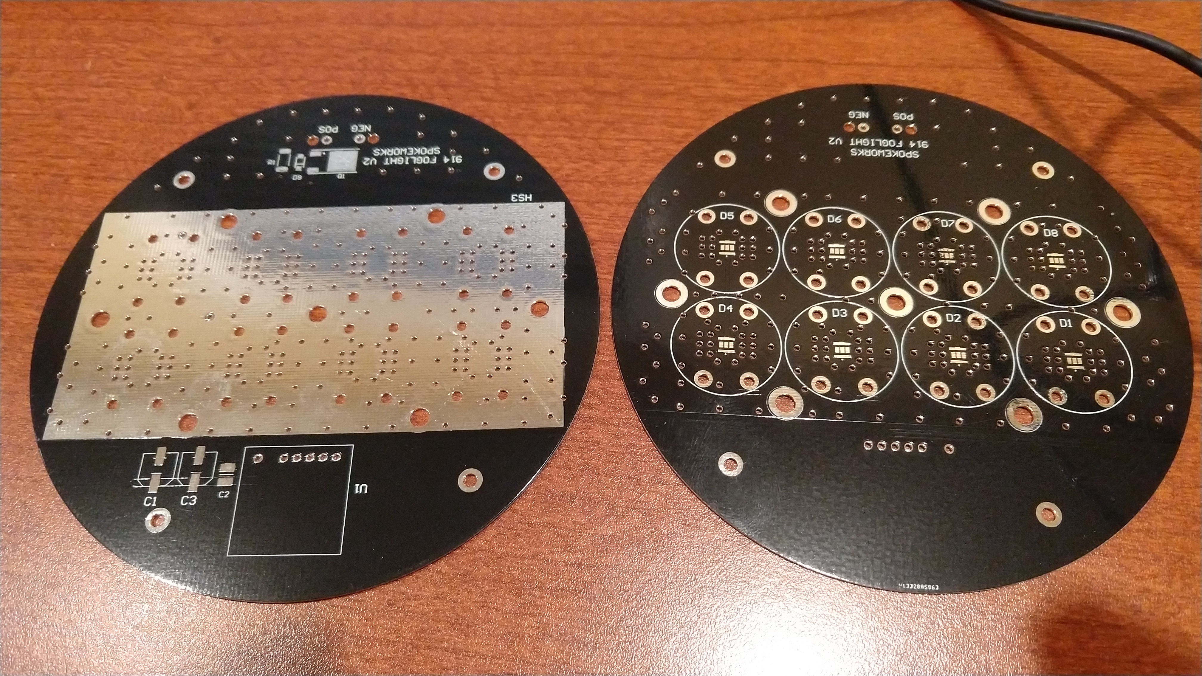

I'm getting ready to order some boards with updated dc/dc converter modules and was wondering if I should get the boards in white or black. One guy trying out my 911 fog lights thought they would look better with a black board.
Anyone have a preference?

Here's a crude attempt to photoshop a black PCB on the driver side.

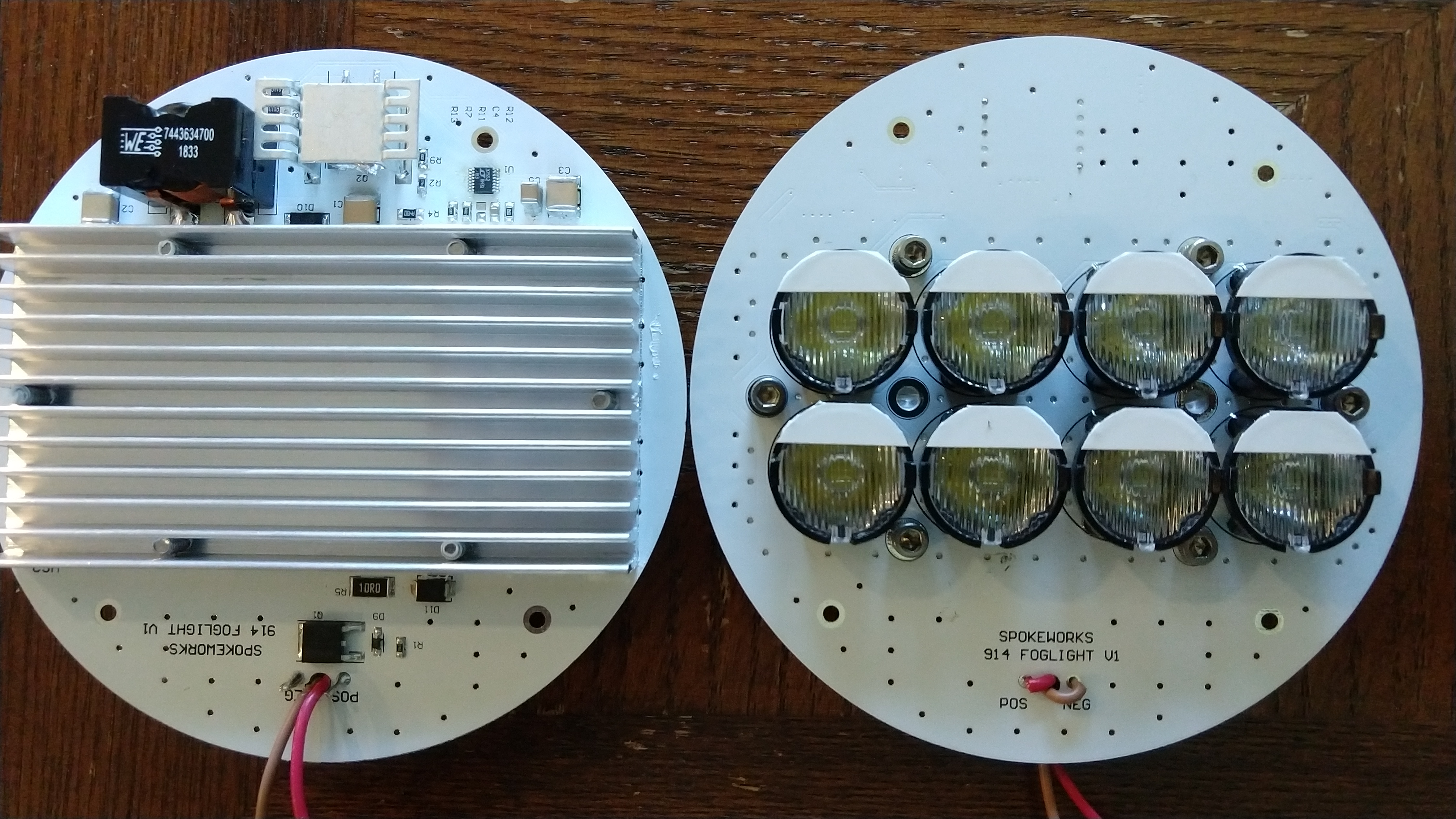

This set is for @mepstein . This set and mine will be the only ones with the discrete dc/dc converter running 500ma. All further foglights will use a dc/dc converter module running about 425ma.
Mark, do you want me to paint one of the bezel rings or are you going to send another set already painted/powder coated? I'll only need the bezel ring as the back side of the enclosure is not necessary to install the led boards.

I did a lot of experimenting with the light pattern from the LEDs and the results were less than I hoped. Actually none worked. Trying to shade the LEDs from the upward light output only managed to reduce the LED output.
I have a set of LED fogs on my 914 and my 911. They are 2x brighter than the standard bulbs and 1/3 the power. They don't seem to blind anyone as they're not that bright.
At this point I think I'd like to get a few of these in some other cars to get some other opinions. What I'd like to do is sell up to 5 sets at a reduced price ($100/pair). The regular price will be $165/pair.
I've only worked out the clips and fixturing for early fogs so only looking for those with early fogs. The boards will be black.

I'm not in the market for these right now but I love this stuff and the work behind it. My $.02 - on this car shown, white boards. The lights just sort of disappear that way.
That said, I have black bumpers and black grills so if I would get them I'd probably go black boards......

Printed a spacer for the later foglights and they fit nicely using the original clips.
Have all the components soldered on the first of 3 black board sets. I'm offering the first 3 sets for $100/pair but no takers yet. Normal price will be $165/pair. There's lots of expensive components on these boards.
There are 5 911 owners with the 911 version of these foglights now. Once I get past this initial startup, I plan to make these generally available.
This set has been cleaned. Now will glue on the LED lens holders and screw on the heatsinks.
Printed a jig for drilling the holes for the heatsinks. This set is done and ready for assembly.
