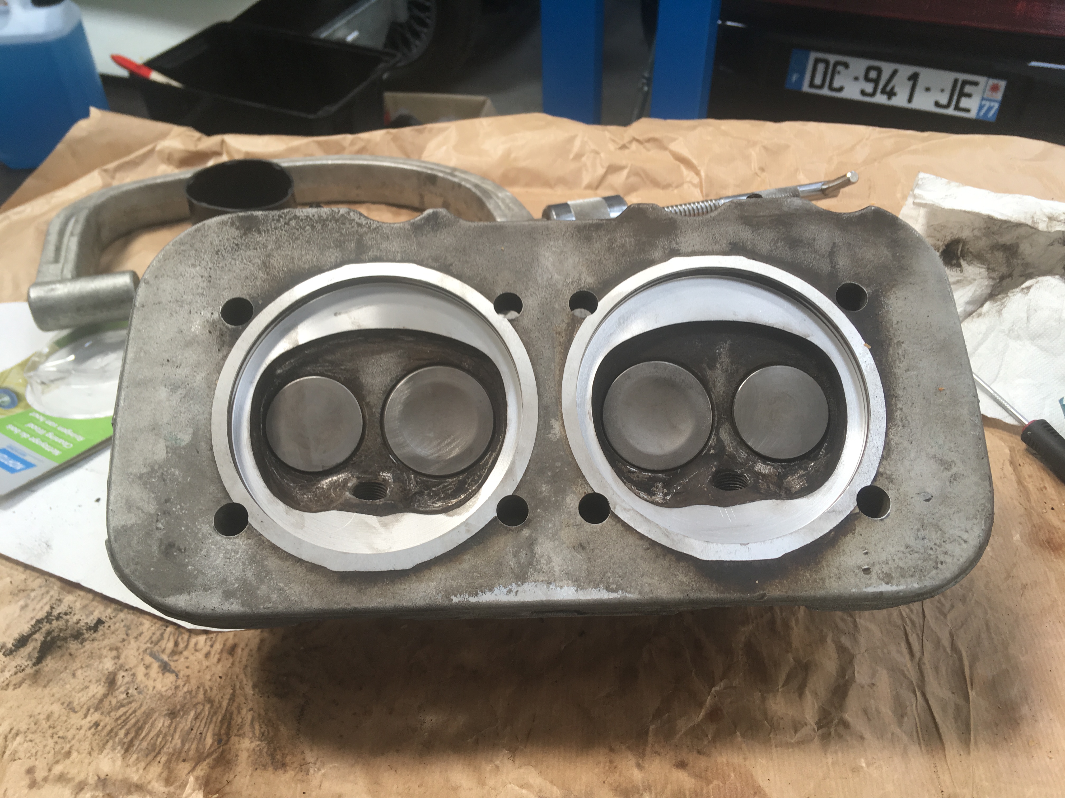

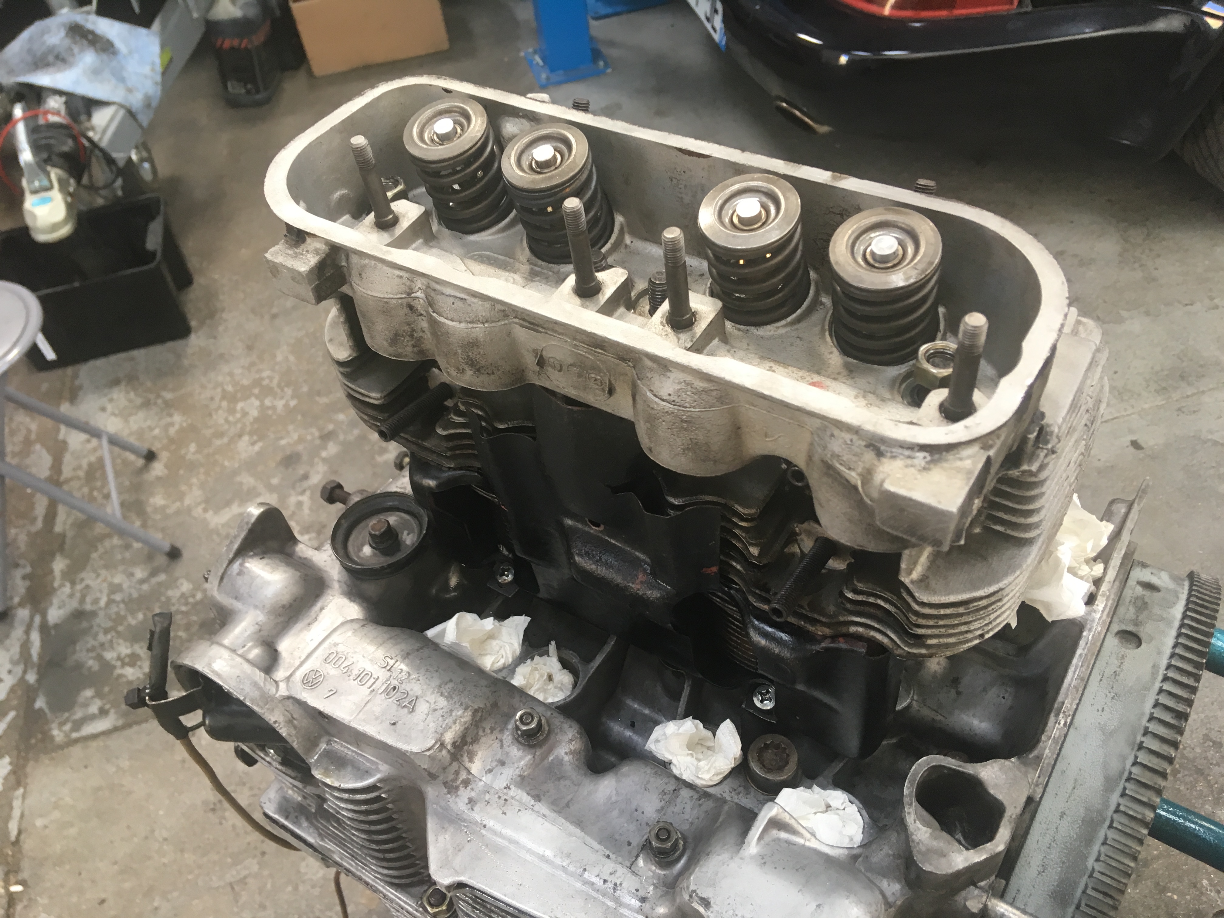

hello, heads came back from the shop, new seat, heads were machined, needed 0,15mm rectification.
I would like to know how to check that the two cylinders are exactly at the same height in order to avoid head and cylinder leaks.
CheeRS
post Jul 5 2019, 03:21 PM
Post #63
Posts: 93
Joined: 5-May 19
From: Paris France
Member No.: 23,093
Region Association: France
in the moment I started to go up but without doing a cylinder height check

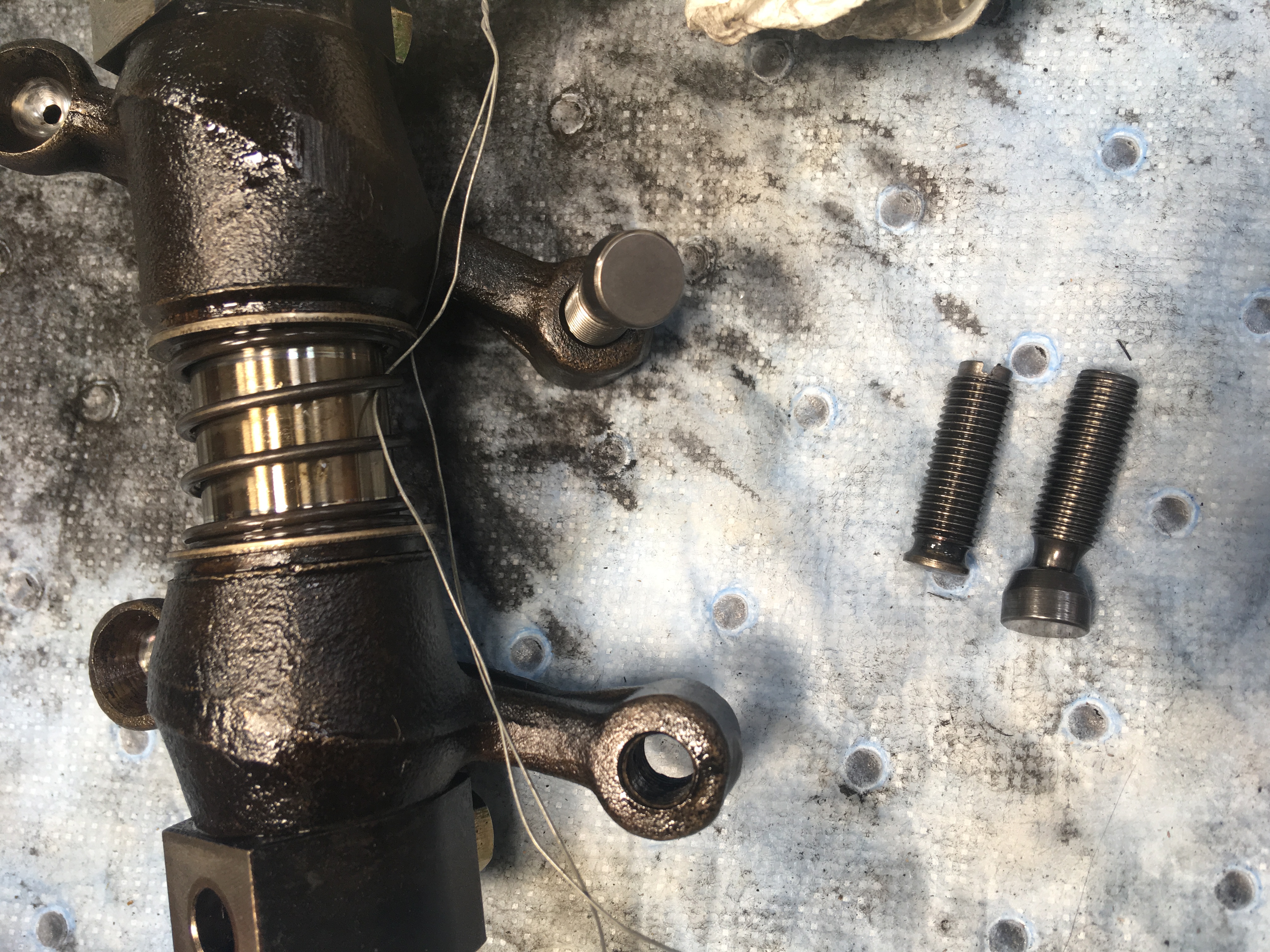

Lastly, I wanted to install 911 elephant feet but the valves go too far and the engine blocks.
What more must be changed, the length of the rocker rods?Attached Image
Bleyseng
post Jul 5 2019, 05:40 PM
Post #65
Aircooled Baby!
Posts: 13,036
Joined: 27-December 02
Member No.: 24
You must grind off some of the rocker arm (while not letting it get hot). I can't remember exactly how much off the top of my head so do a search for it. Also order the solid spacers from the hydraulic lifters Buses/vanagons to replace the springs on the rocker arm shafts so the rocker arm can't move around.

Thanks,
and what about cylinders 1 & 2 and 3 & 4 alignement to match perfectly with the heads?
Bleyseng
post Jul 6 2019, 09:42 AM
Post #68
Aircooled Baby!
Posts: 13,036
Member No.: 24
You can take a cylinder and using valve lapping compound, lap the cylinder to the head sealing surface as no one uses those head gaskets. As for alignment the heads should have been flycut using a jig to ensure they are the same.

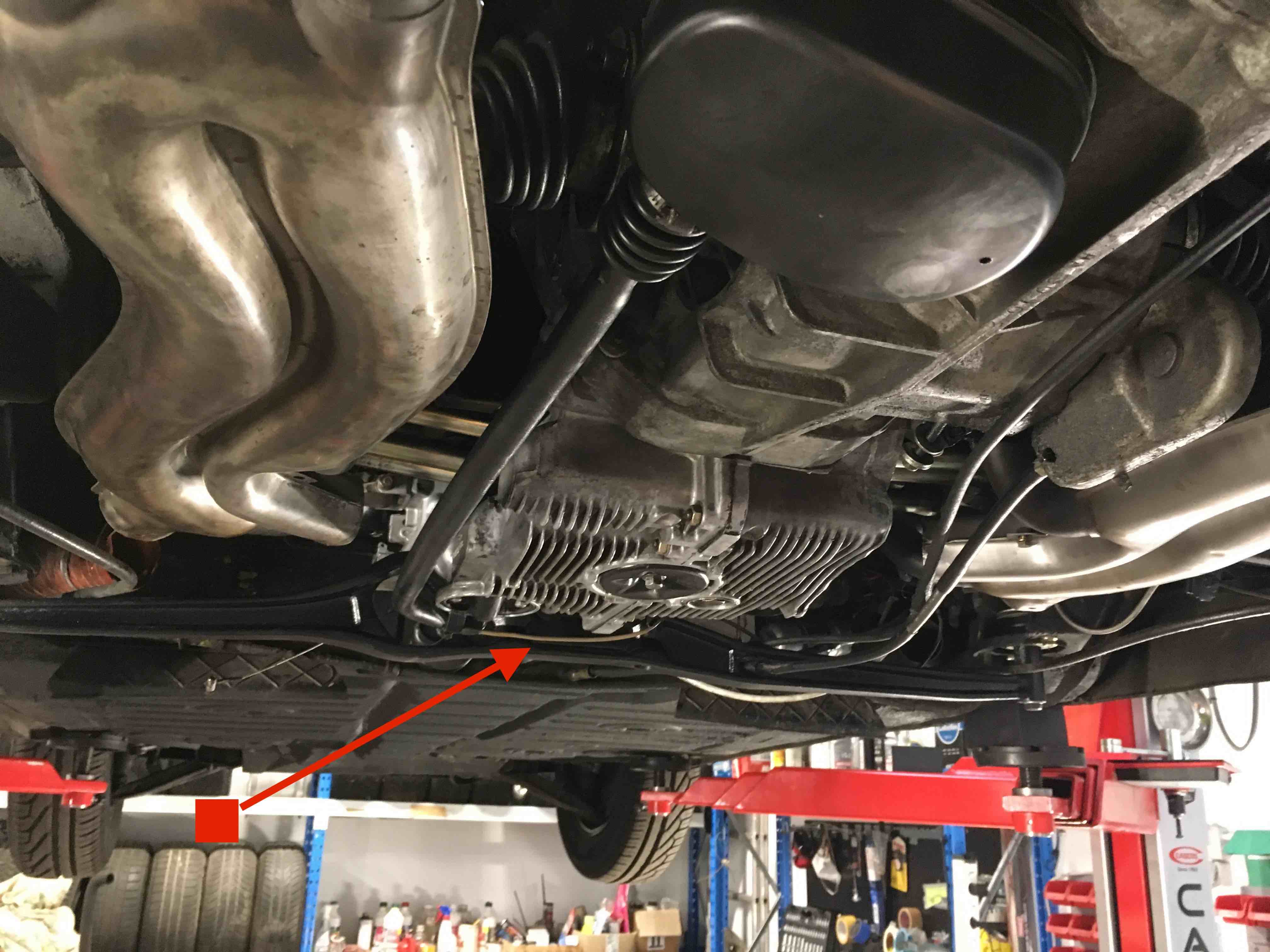

Engine returned today in the car.
A lot of parts checked and changed, engine mount, all the seals...
I'm looking for the way where go the oil temp sended wire.
From the bottom of the engine to....?
CheeRS
post Sep 9 2019, 02:07 PM
Post #75
Posts: 93
Joined: 5-May 19
From: Paris France
Member No.: 23,093
you can see it on this photo
rhodyguy
post Sep 10 2019, 07:50 AM
Post #76
Posts: 22,252
Joined: 2-March 03
From: Orion's Bell. The BELL!
Member No.: 378
That oil temp wire should be mounted on a stud behind the fan shroud on the right side. The wire should have a small metal tab that goes on the stud.
sportlicherFahrer
post Sep 10 2019, 09:14 AM
Post #77
Nothing to see here.
Posts: 1,124
Joined: 18-April 05
From: Tacoma, WA
Member No.: 3,945
The oil temp wire plugs in to the main harness near the battery area through a small hole in the engine tin. There should be another single wire protruding from the main wire harness with a plastic connector piece.
