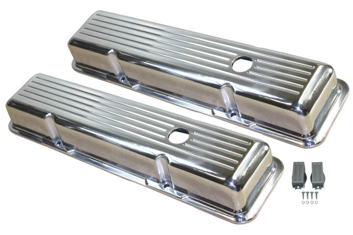

To tell what you have, look at the valve covers. If they have 4 hold down bolts around the perimeter, it is a pre 85 motor...

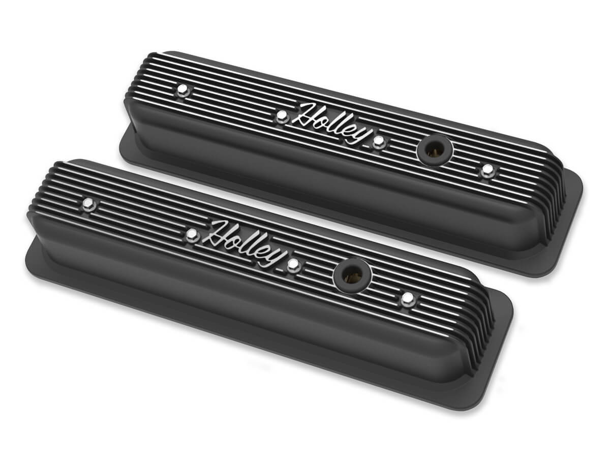

If they have 4 bolts down the middle of the valve cover it is an 86 or newer...
