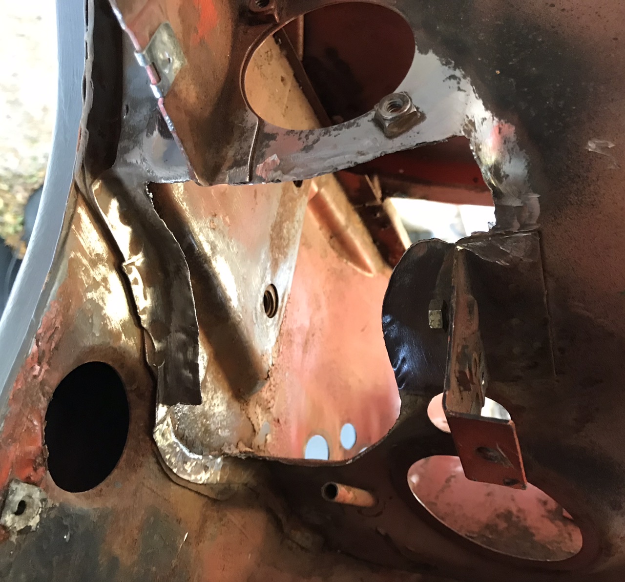

The rusted area cut away:

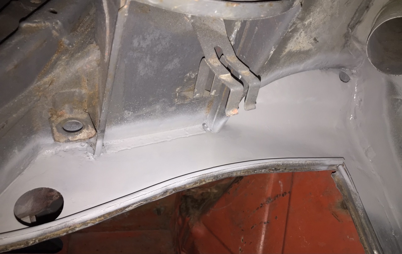

Member No.: 7,222

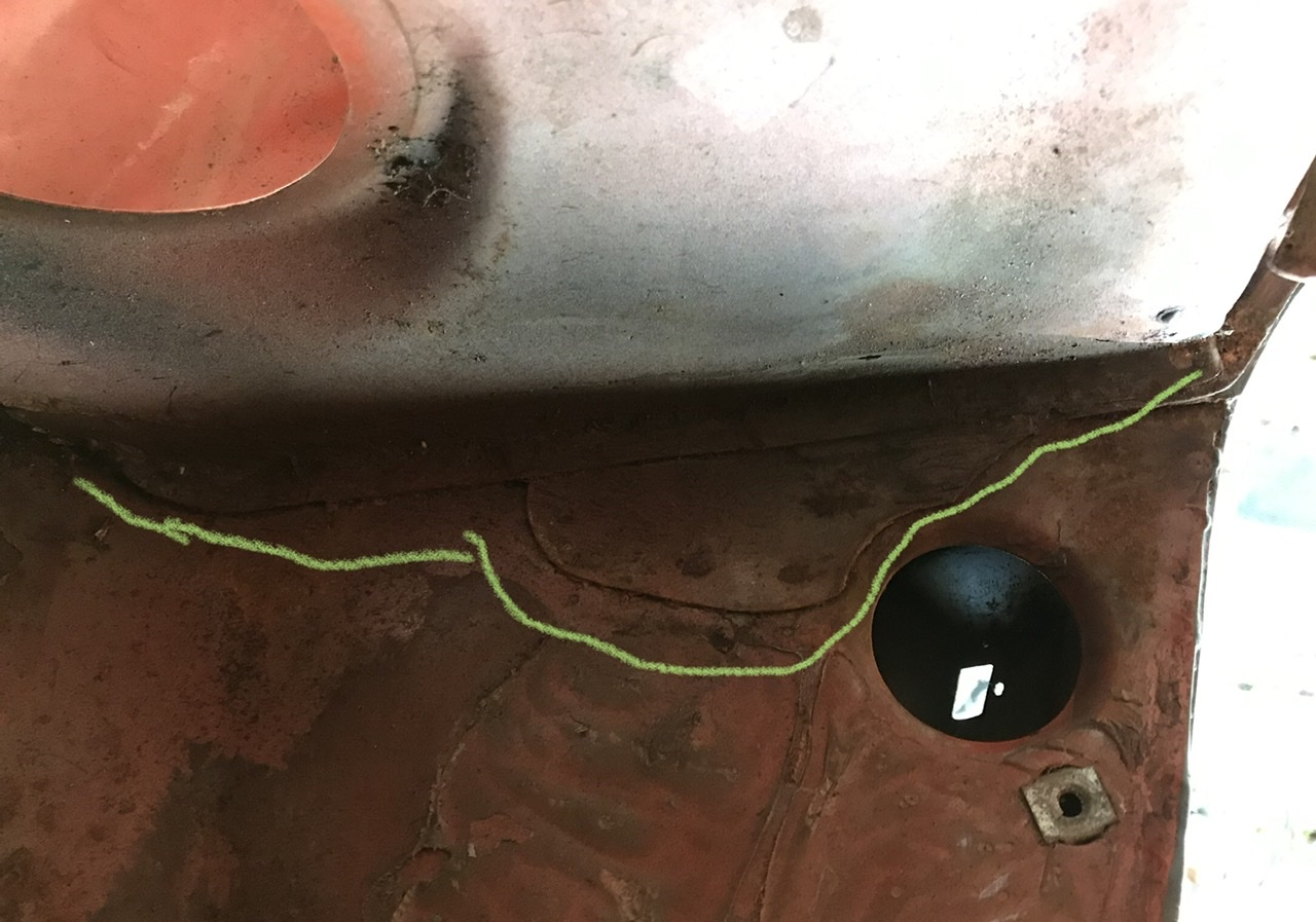

Here’s an interesting detail I noticed while working under the dash… there is a curved reinforcement (highlighted in green) area on the passengers side where this piece would be welded for right-hand drive cars. You can see from the picture that the sheet metal is a flatter piece here instead of dropping down to hold the handle.

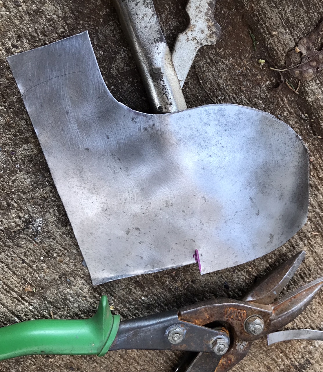

Member No.: 7,222

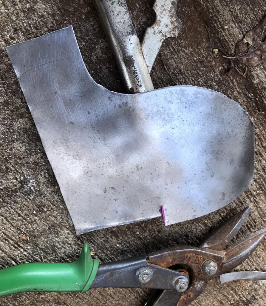

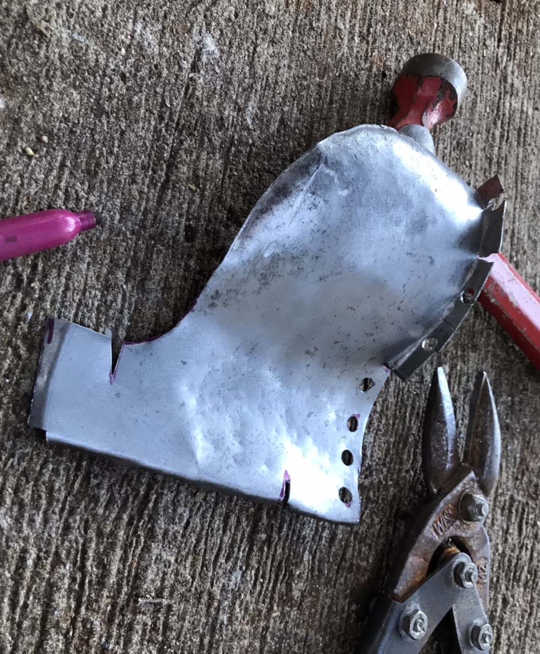

Started making a repair panel:

Ended up looking like this:

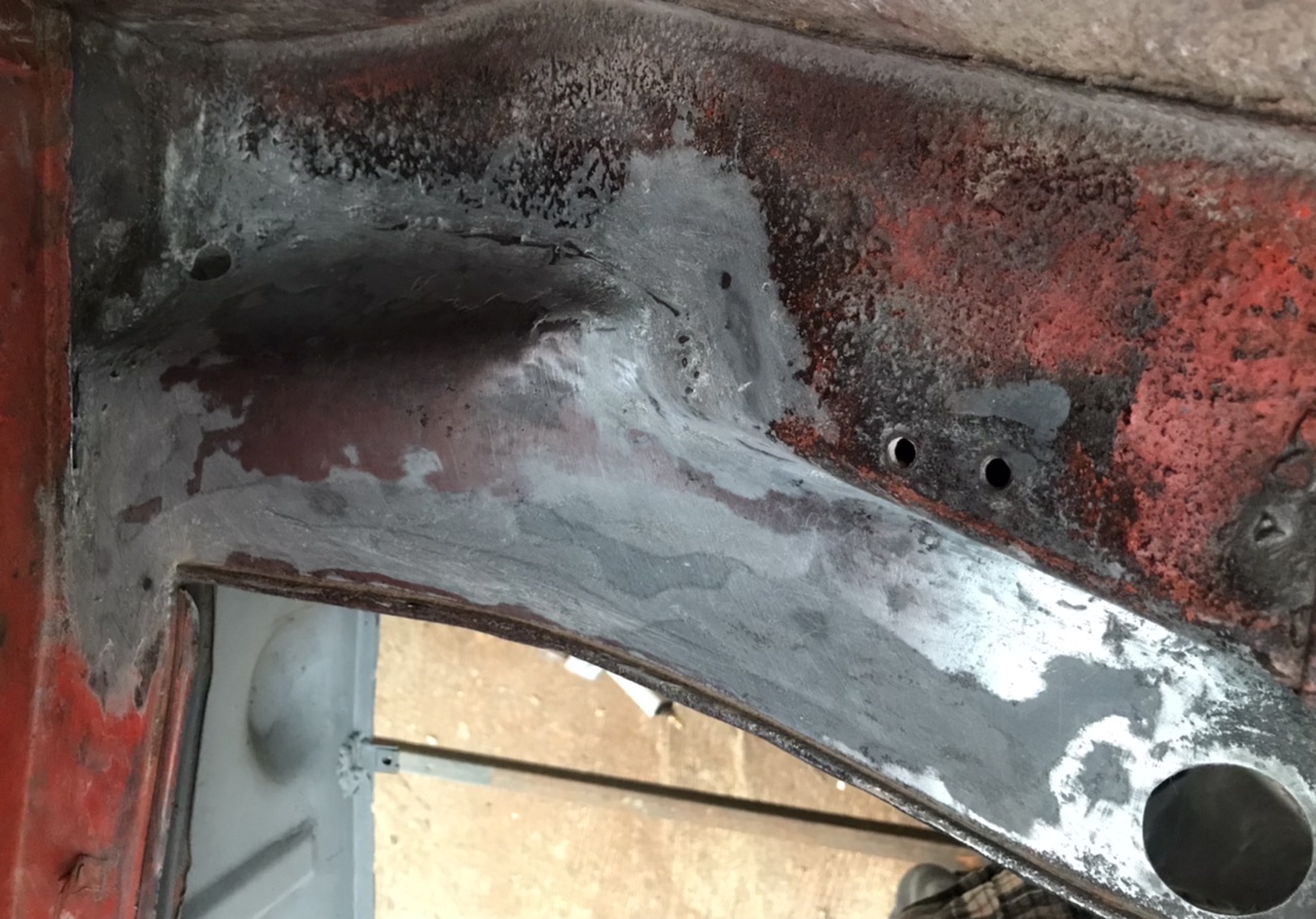

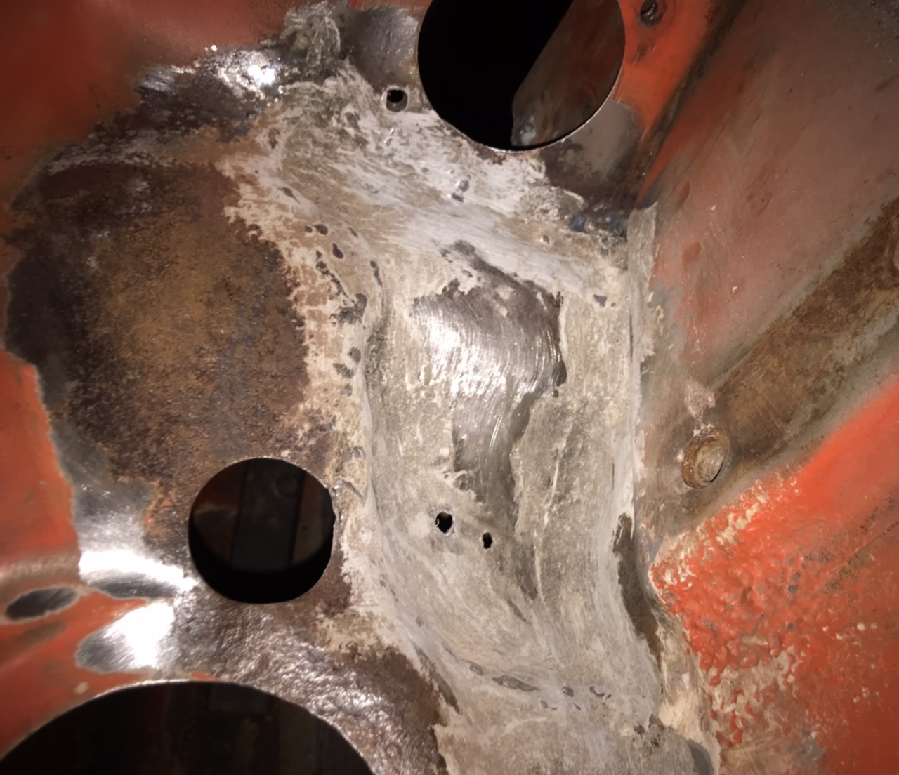

Welded in, ground down highs and filled with a fiberglass fill to seal the seams. You can see the two small holes I added for fastening the cable handle to the underside. Topside view:

Here’s the top-side of the HH repair showing FG-filler for any pin-holes, etc:

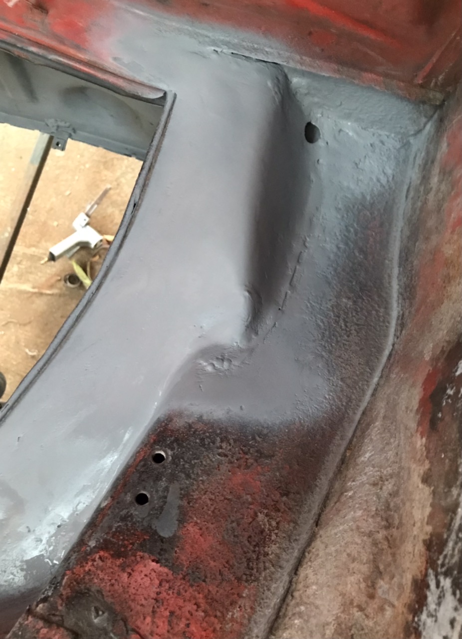

Smoothed and primed:

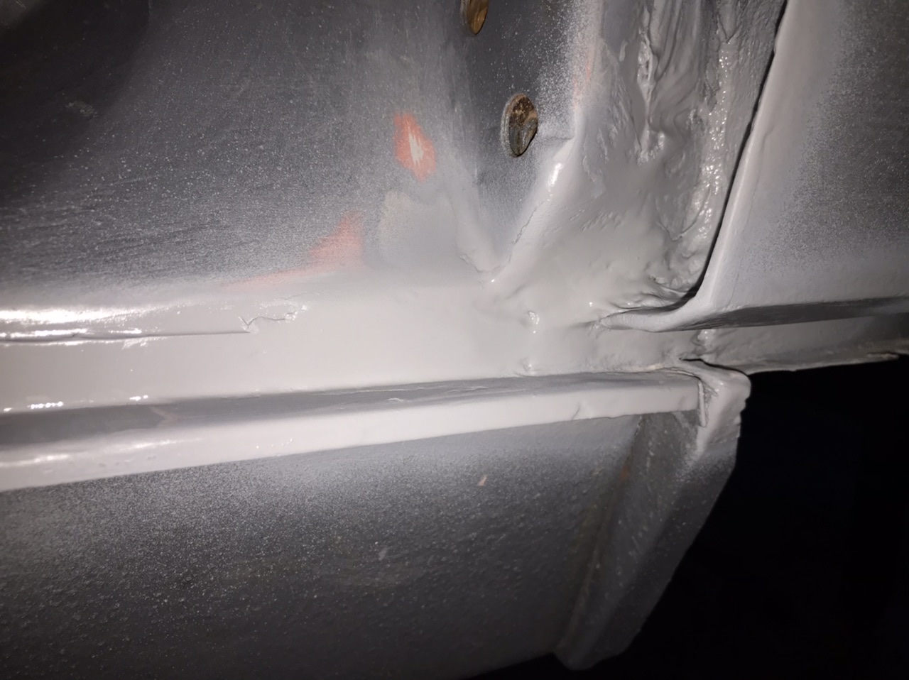

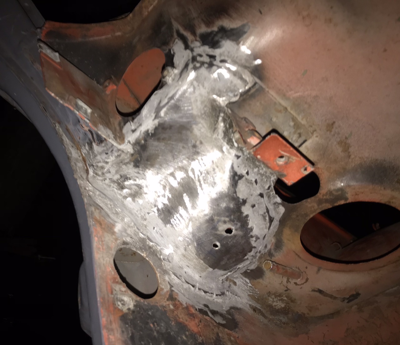

And the underside done the same way:

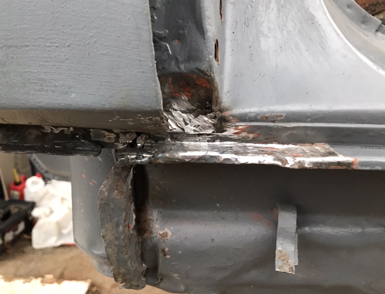

Member No.: 7,222

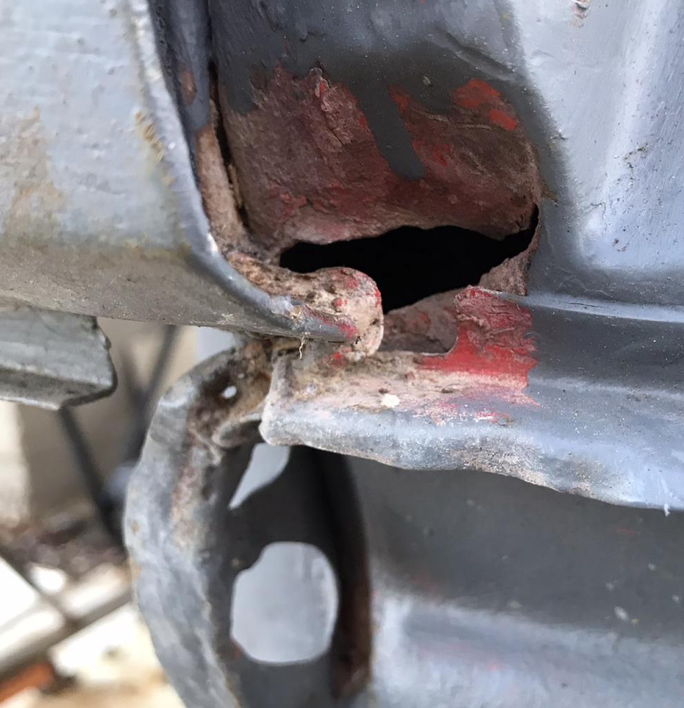

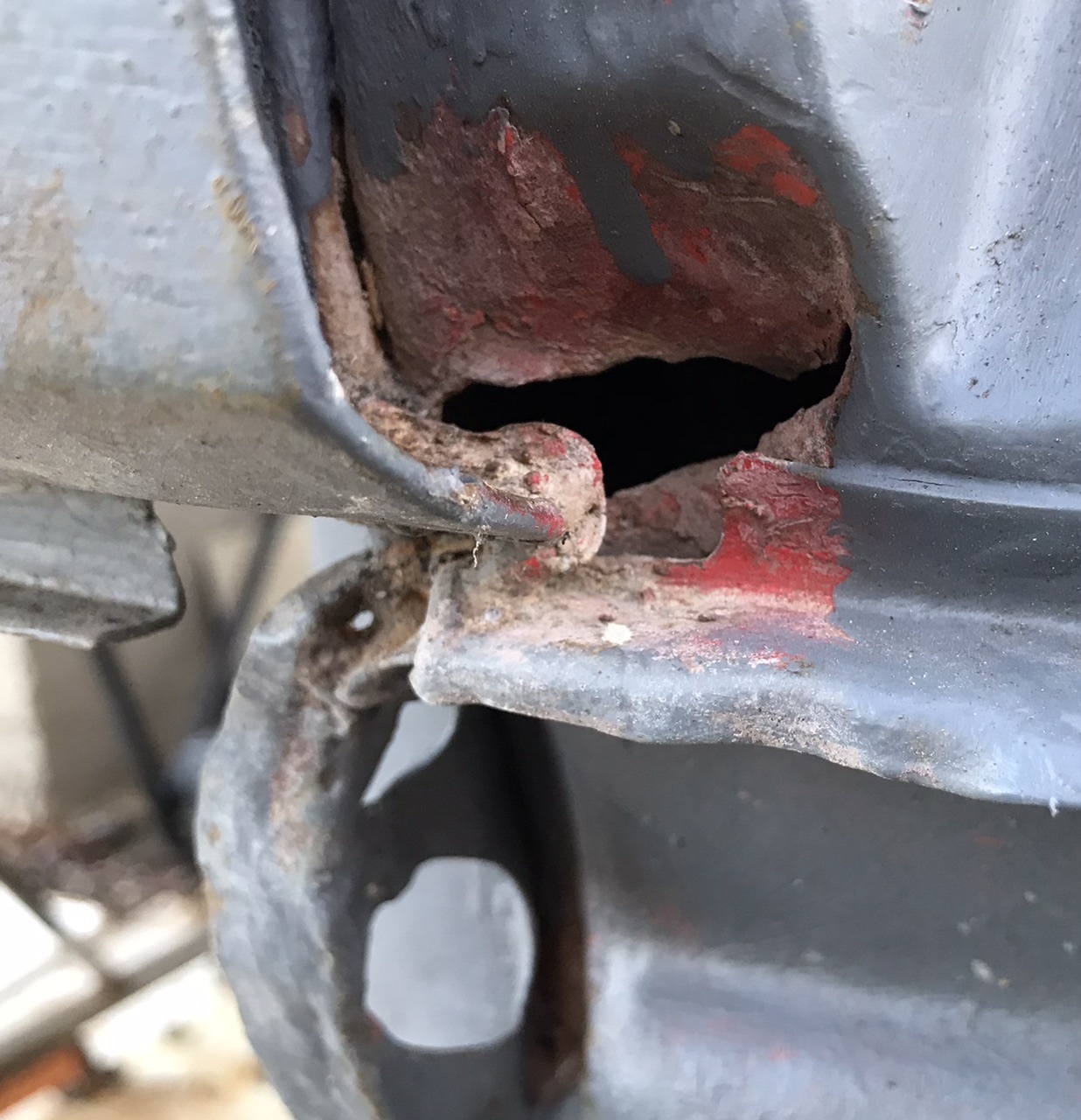

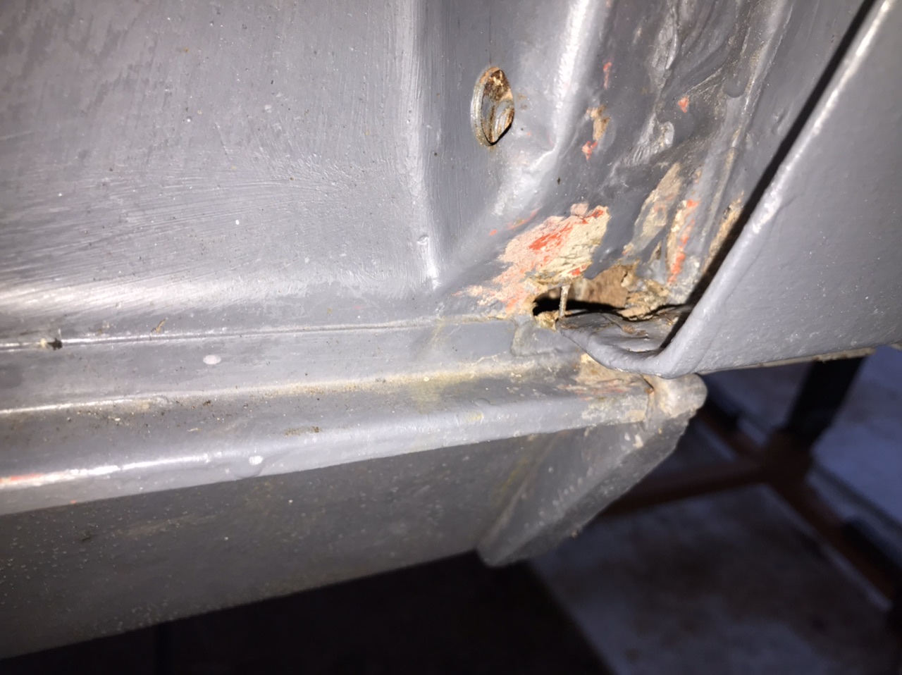

Got back to it, been working on this issue for a few days on and off. When my car had its front end collision (w/ previous owner), it knocked a small gap at the bottom of each door where the seal meets the threshold, under the lower door hinge on each side (must have been a hell of a pop!). Here some pics showing what I was repairing on the driver’s side:

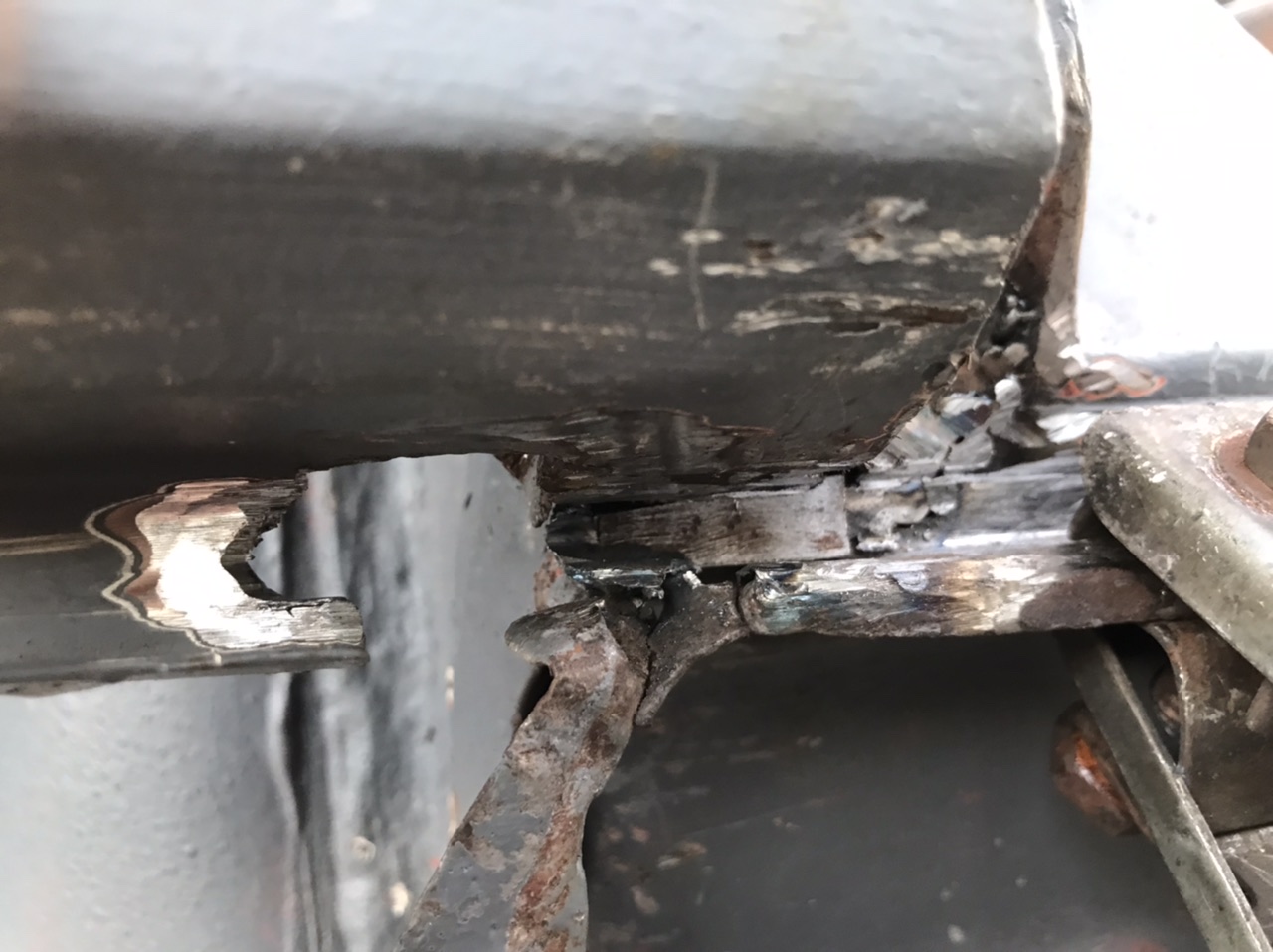

Member No.: 7,222
Under the attachment rail for the rocker cover too:

Member No.: 7,222

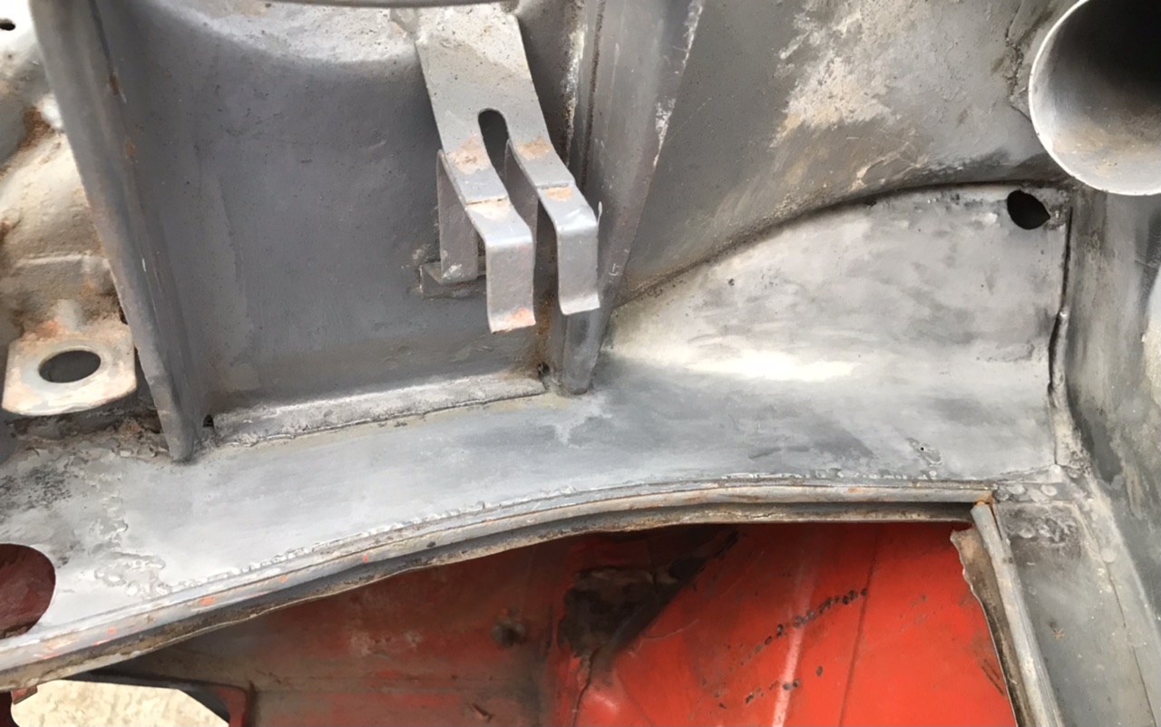

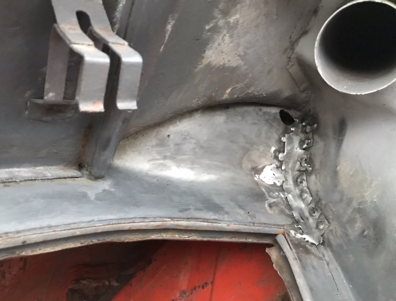

Welded all this up, ground down the highs:

finished up the driver’s side:

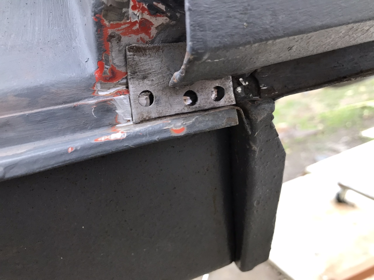

Then it was over to the passenger side:

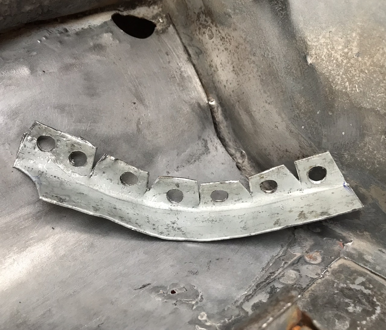

Member No.: 7,222
the patch:

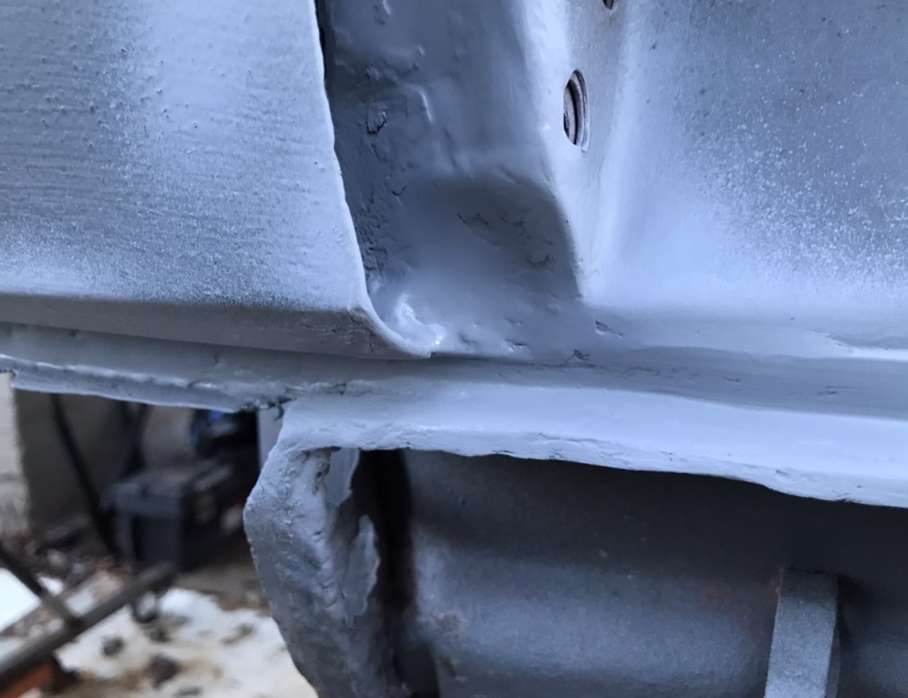

Member No.: 7,222
… welded in, filled and lightly primed:
