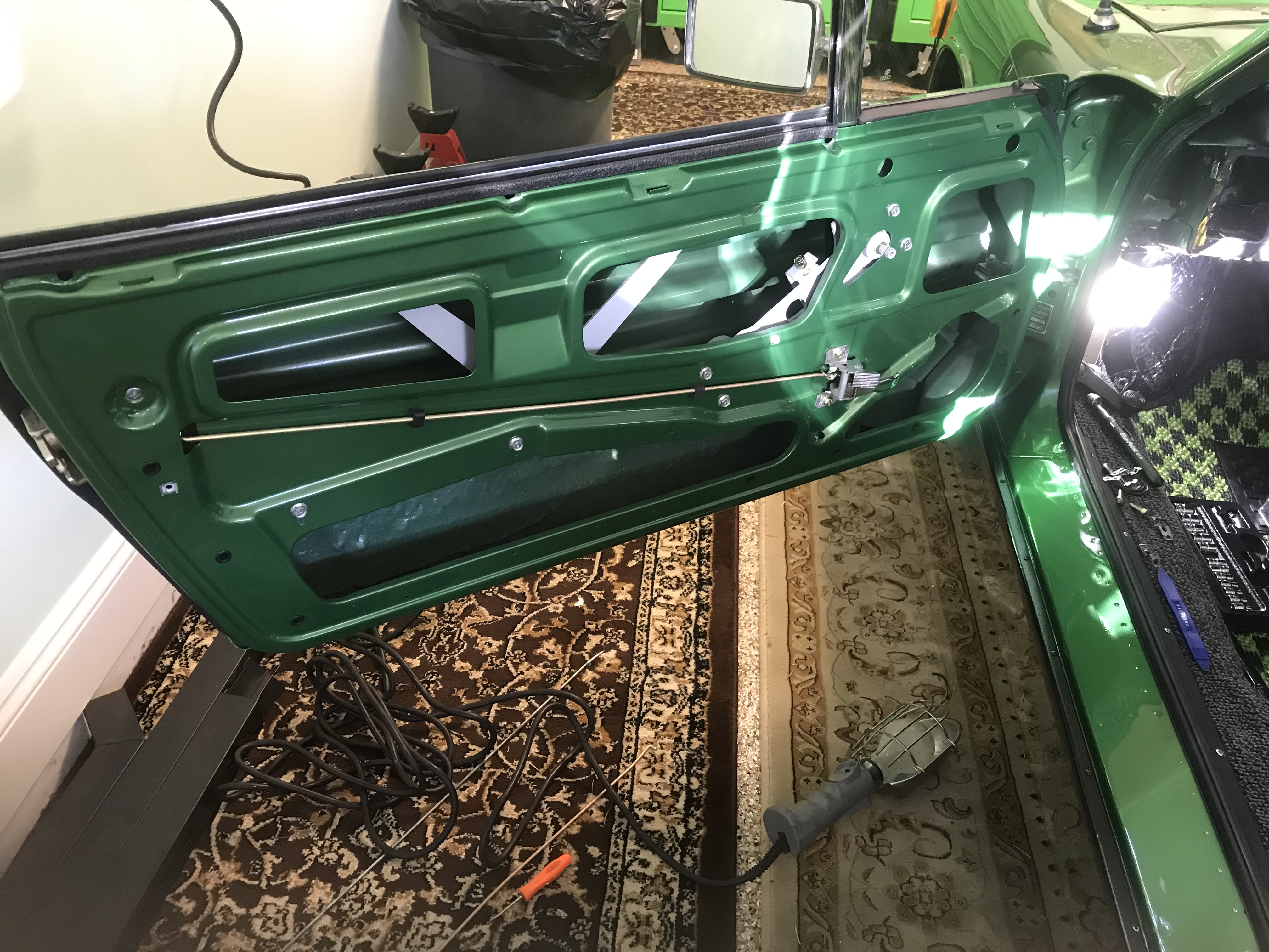

Door panels are all one piece with screws holding the arm rest(sj and drivers door compartment. Once the arm rests are removed, there are plastic clips every few inches that need to be gently popped out without bending the door card too much. The top bolster portion of the door card has three metal tabs that attach at the top of the door and once you have the plastic tabs free you simply slide the door card up and out.
Added picture to help see what is inside
