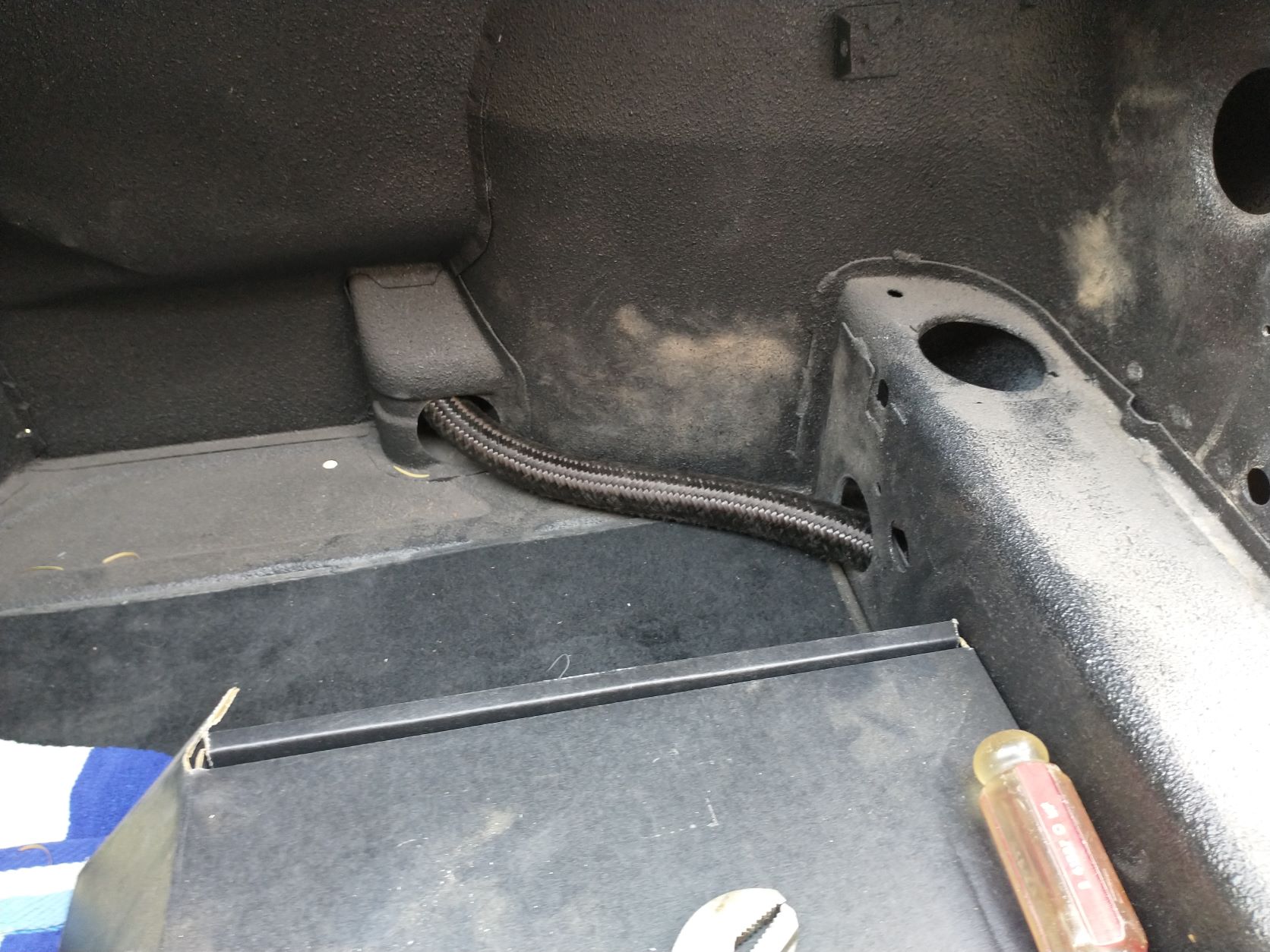

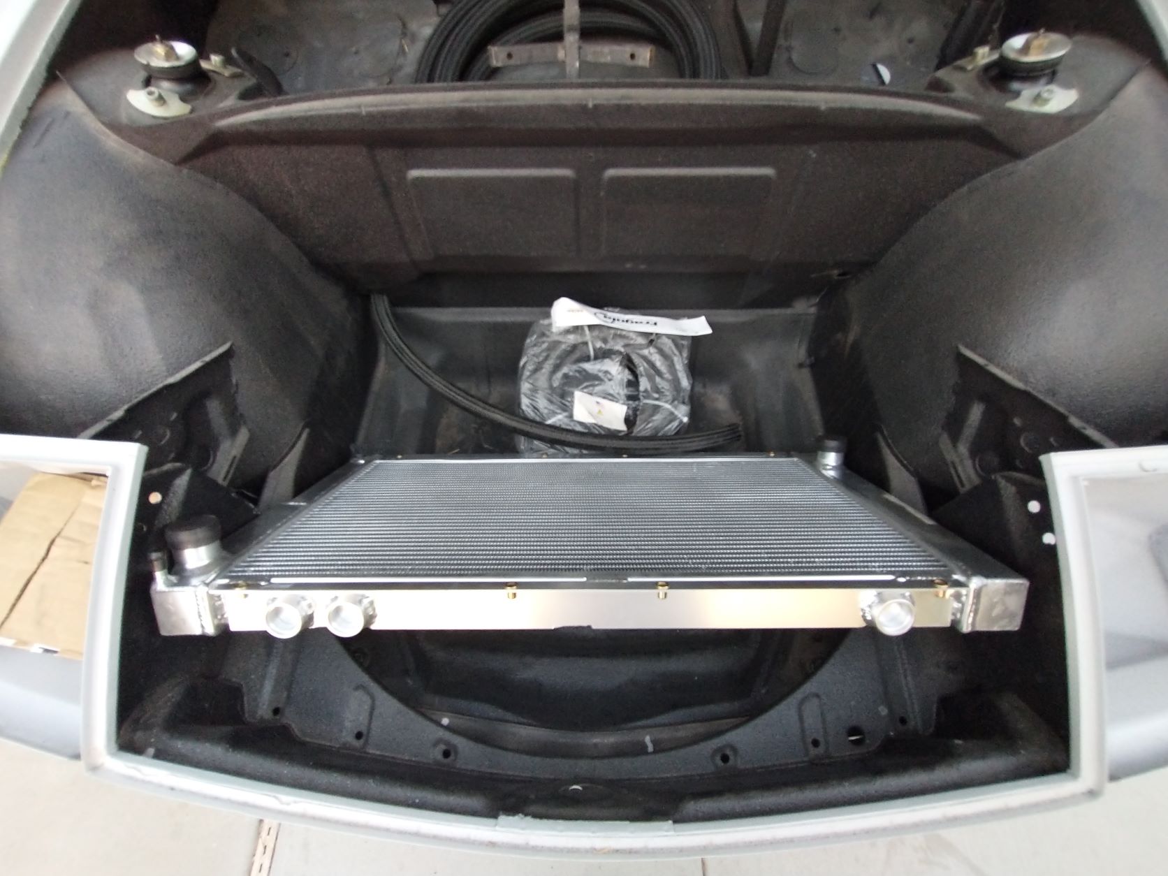

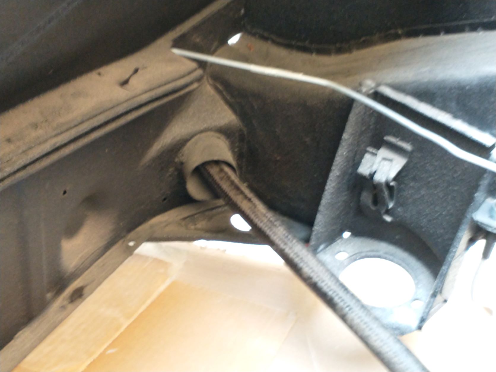

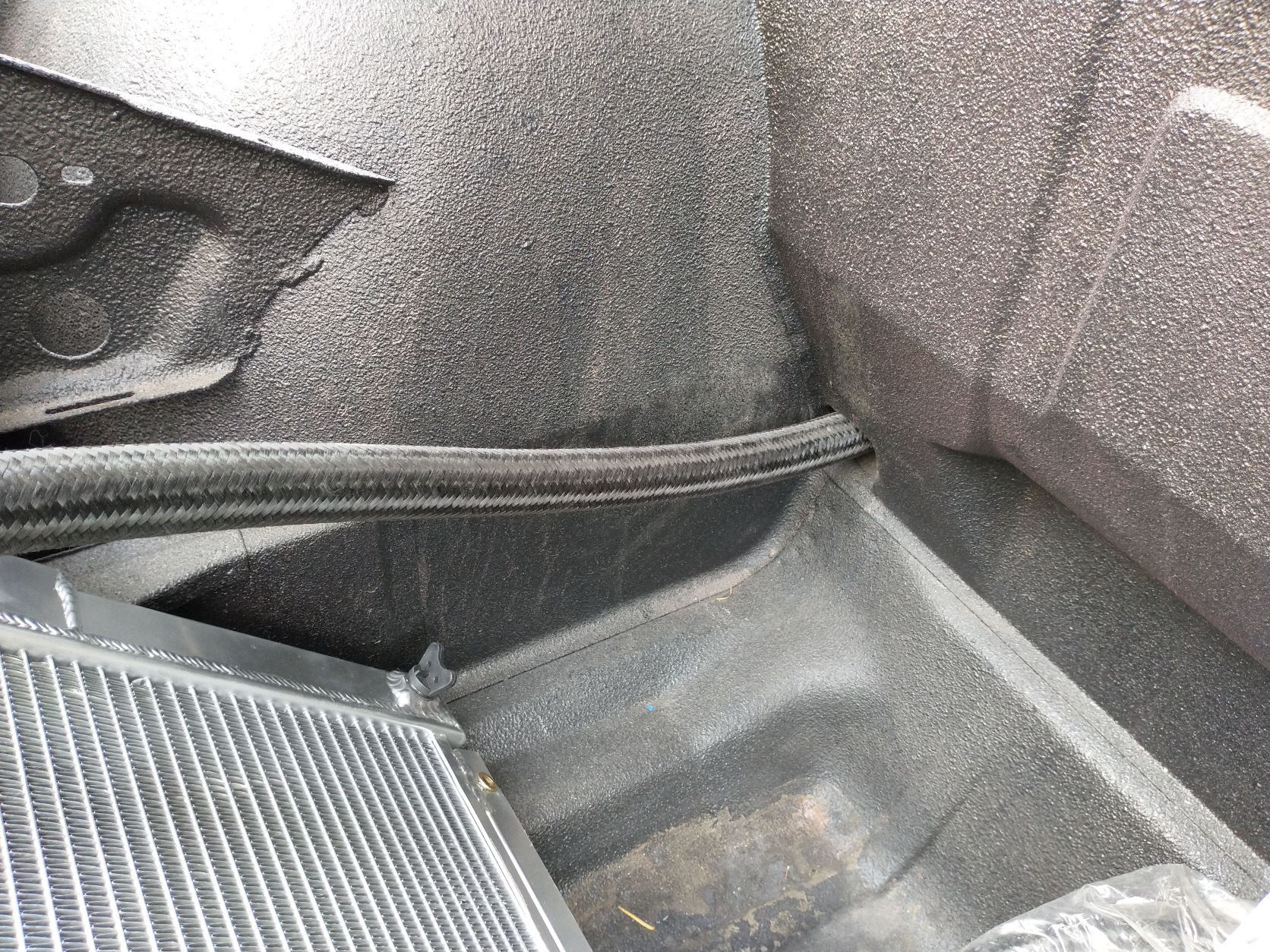

mgarrison   I want to run my radiator hoses through the longs ...   Apr 2 2020, 04:05 PM

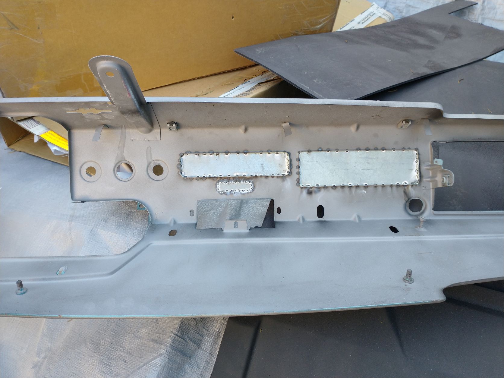

mgarrison   I got the panels all stitched in. Things were goin...   Feb 18 2021, 07:39 PM

mgarrison   Still just trying to keep moving forward. Inch by ...   Feb 26 2021, 09:02 PM
mgarrison   I wire brushed the vent holes as best I could and ...   Feb 27 2021, 08:12 PM

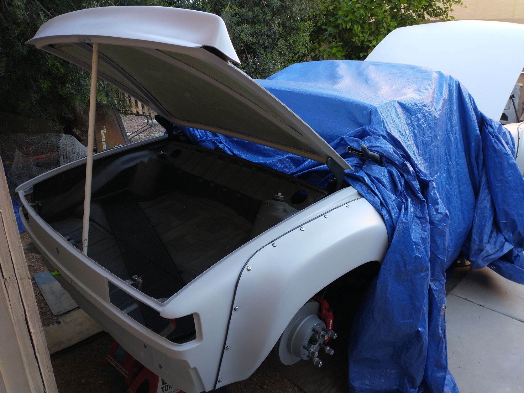

mgarrison   Been plugging along slowly. Finished up the frunk,...   Apr 11 2021, 02:41 PM

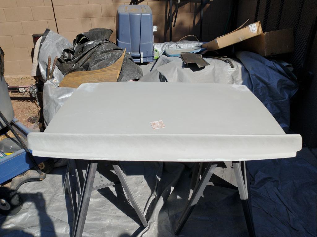

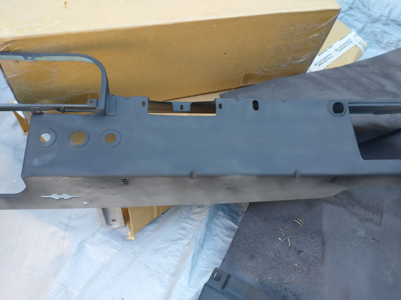

mgarrison   Started before 6am to try and spray at least one q...   Jun 15 2021, 09:32 AM

mgarrison   I've been spraying one quart each morning befo...   Jun 17 2021, 10:16 AM

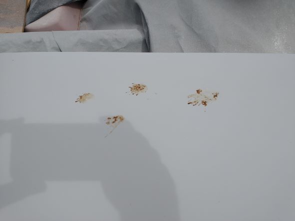

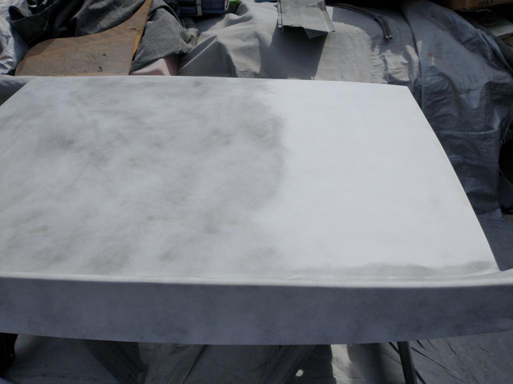

mgarrison   So, the Raptor coating did not hide my patches/rep...   Jun 28 2021, 09:54 AM

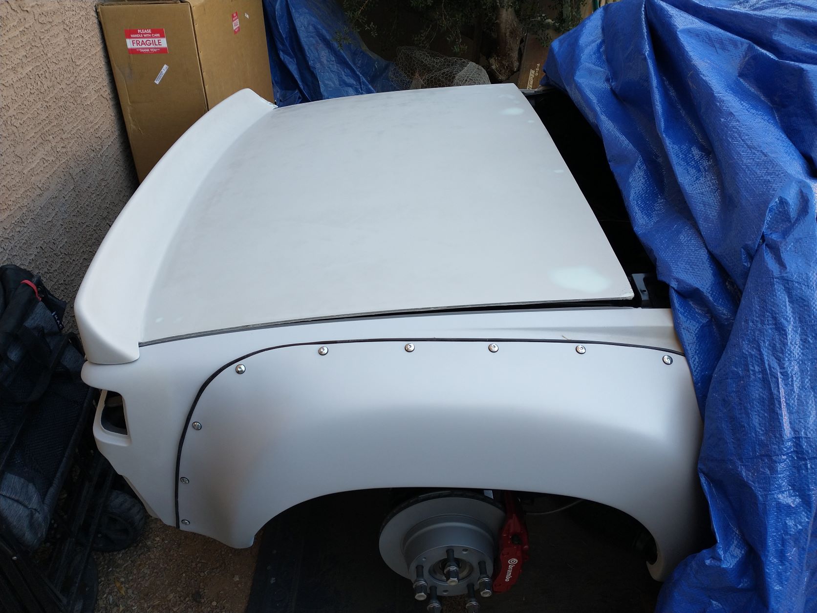

mgarrison   Finally had a morning with little wind, so I gave ...   Jul 4 2021, 06:02 PM
Mayne   Impressive work! Are you going to spray the ar...   Jul 5 2021, 06:17 AM
mgarrison   Most likely will leave them black. But, if after I...   Jul 5 2021, 12:01 PM
