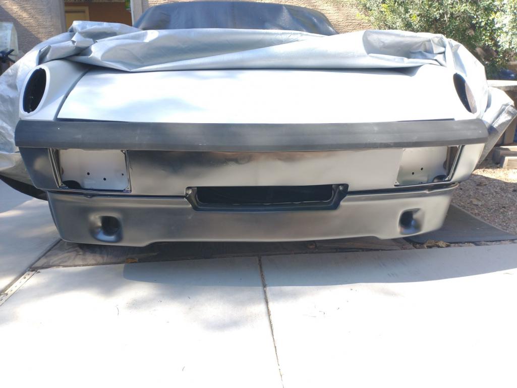

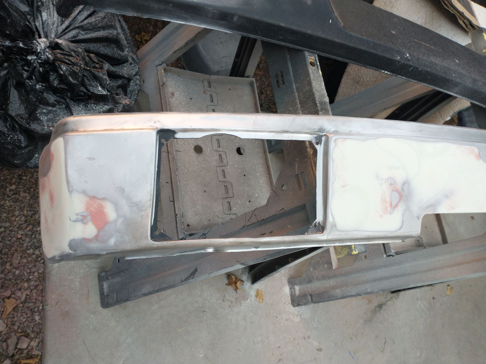

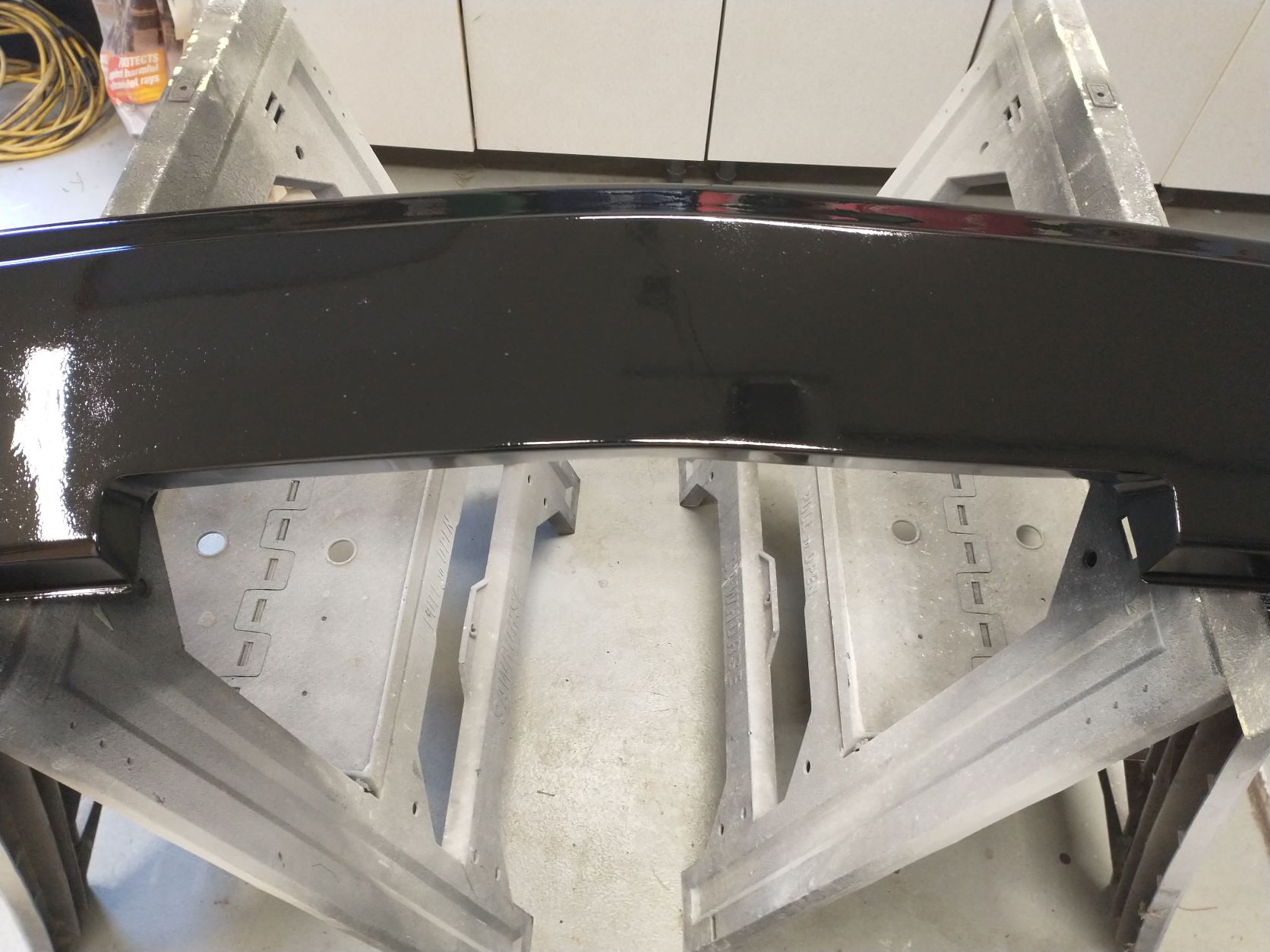

Did some more work on the front bumper opening this afternoon. Cleaned up the edge with the angle grinder and did a test fit to double check the opening I had drawn out.
I cut out the inlet to match the opening on the bumper. (IMG:style_emoticons/default/sawzall-smiley.gif)
May not really be needed, but more air flow in PHX is always a good idea! I hit the edges with some leftover back spray paint, and mounted it up again.
Looks like it will work well enough...

Kevin, mine's a '74 so it has the curved brace on the inside of the frunk. I cut just below where the brace is spot welded to the front of the chassis. I can't recall what year your 914 is, so whether you have that bracing or not kind of dictates where you can cut...

mgarrison
post Oct 21 2022, 07:15 PM
Post #209
Posts: 422
Joined: 14-February 20
From: Chandler, AZ
Member No.: 23,922

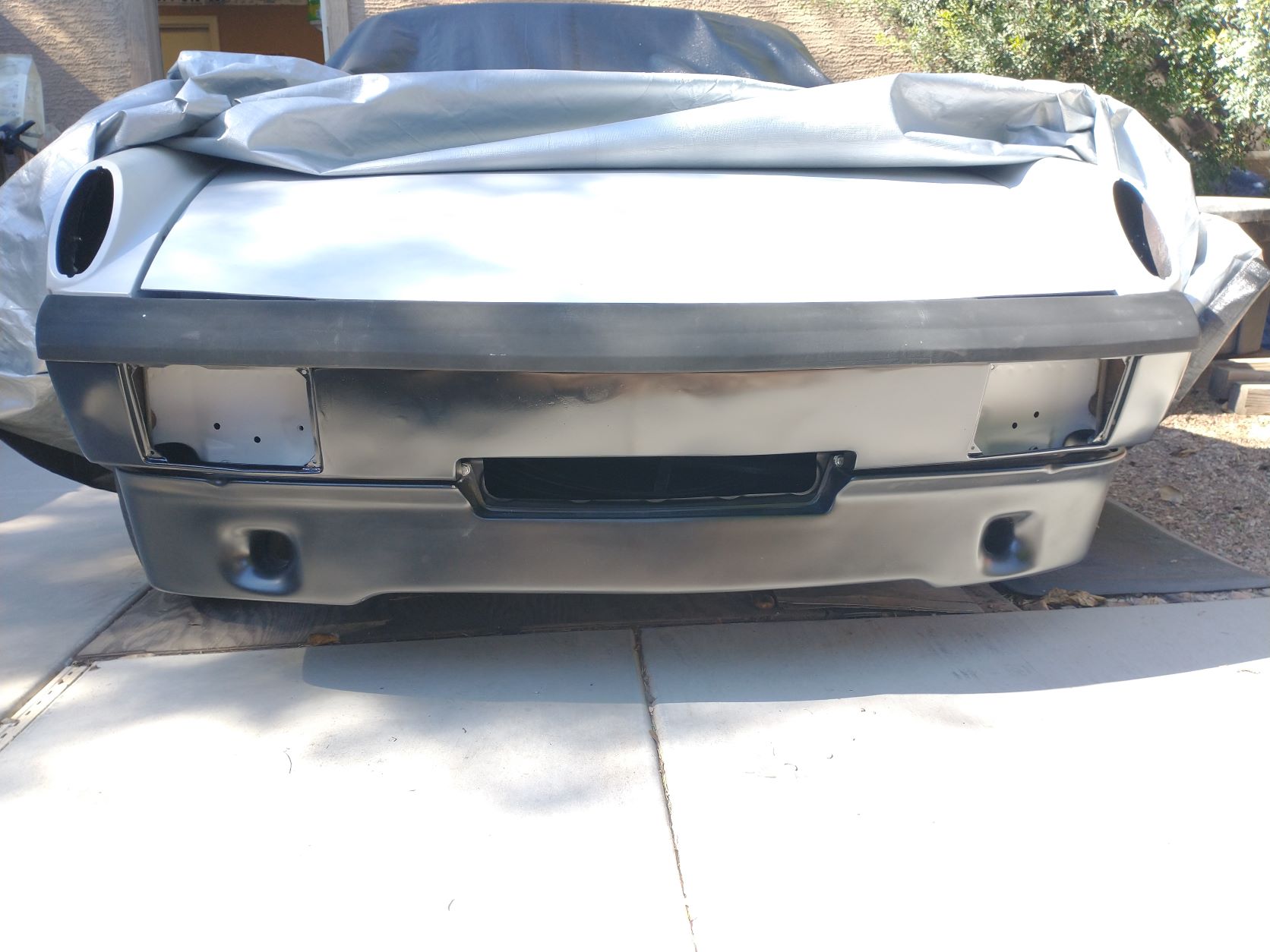

Still a bit of work needed, but I'm making progress...I think! (IMG:style_emoticons/default/smash.gif)

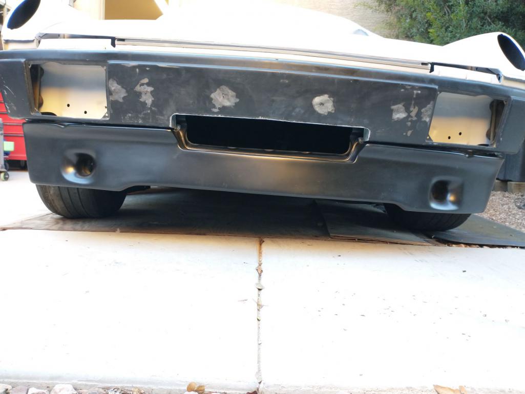

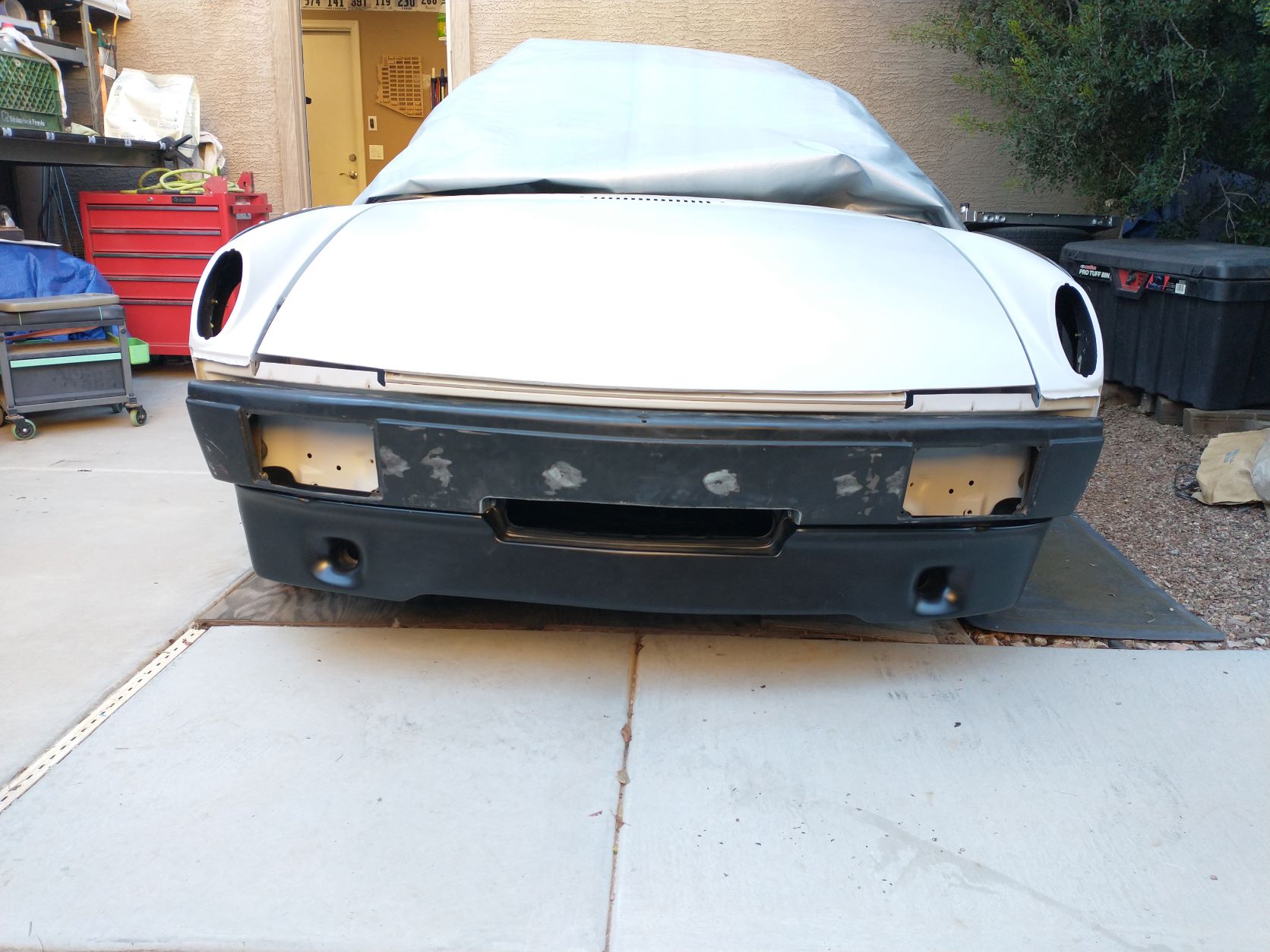

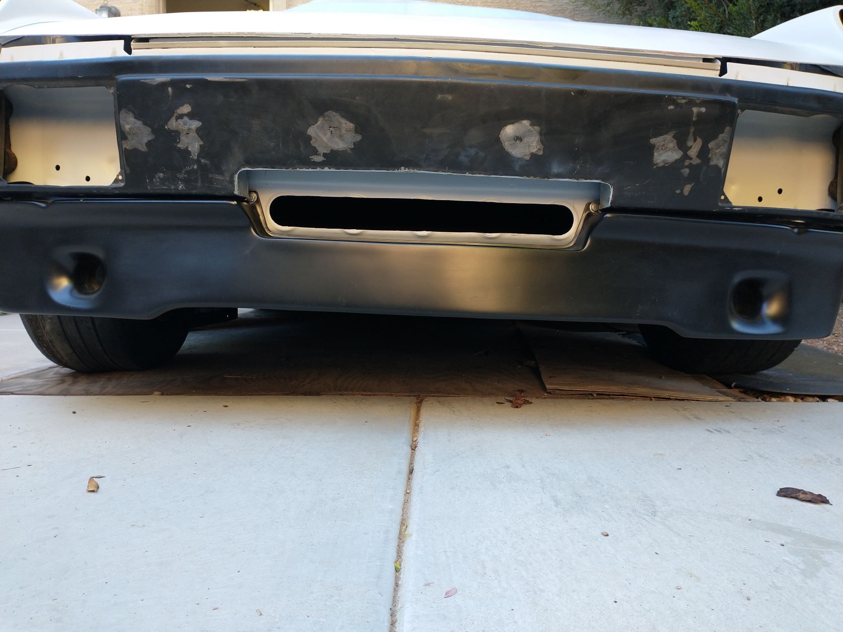

Getting there...
Far from perfect, but good enough...at least for now!
Inlet/opening came out ok.
Thinking I may eventually spray the bumpers with the Raptor liner to match the rockers. Would also hide more of my imperfect repairs! (IMG:style_emoticons/default/idea.gif)

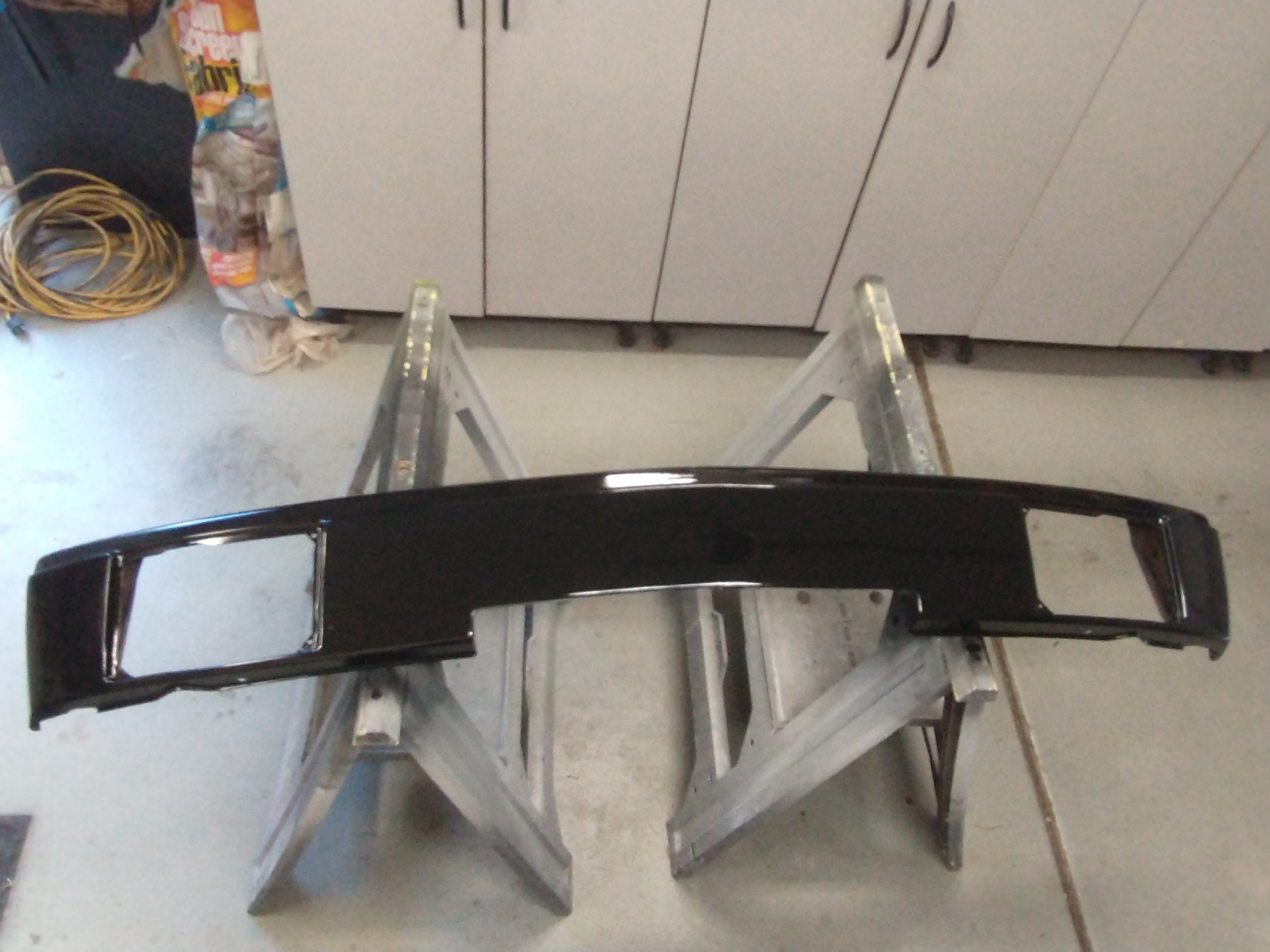

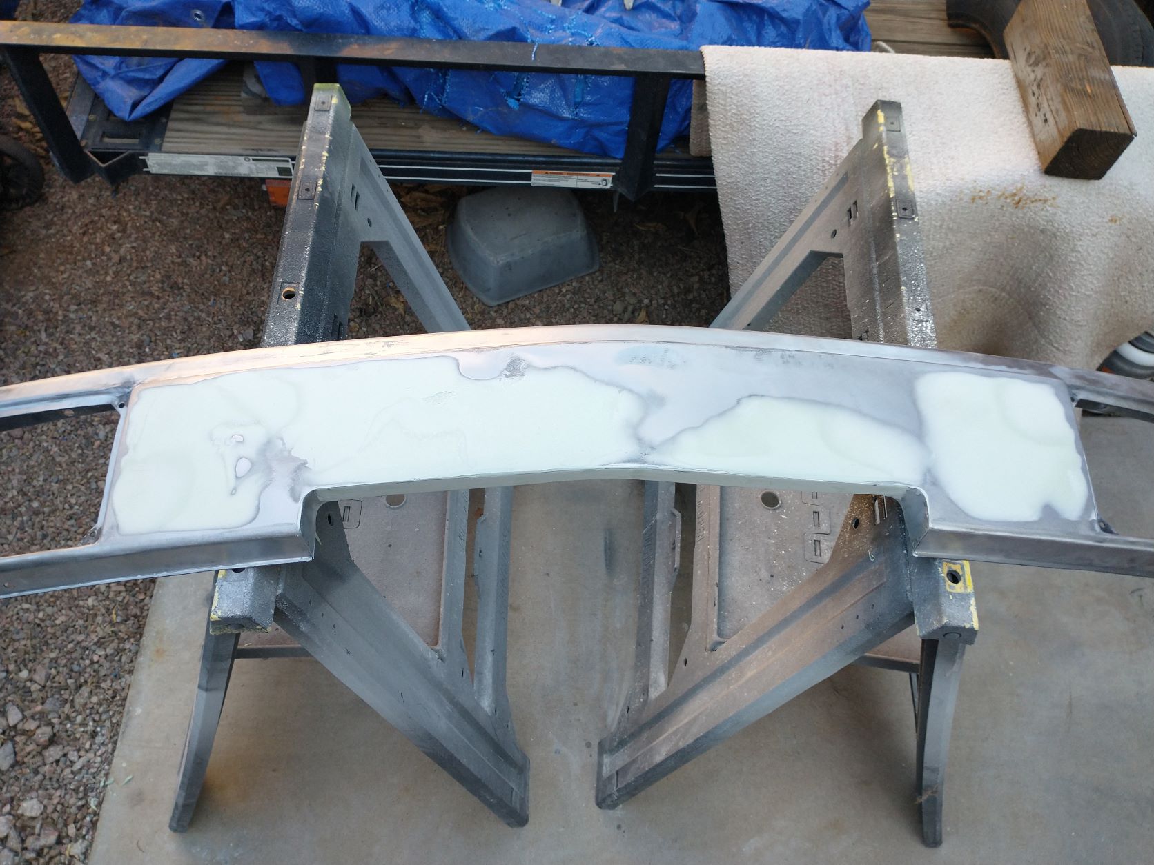

Got it sprayed with rattle can satin black. Decent, but needs more work with some high-build and the sanding block to better hide the imperfections.
Now on to the rear bumper (IMG:style_emoticons/default/smash.gif) But it will have to wait; most of my weekend has been spent with this guy up at WestWorld playing photographer, groom, water boy, etc. but he's so worth it!

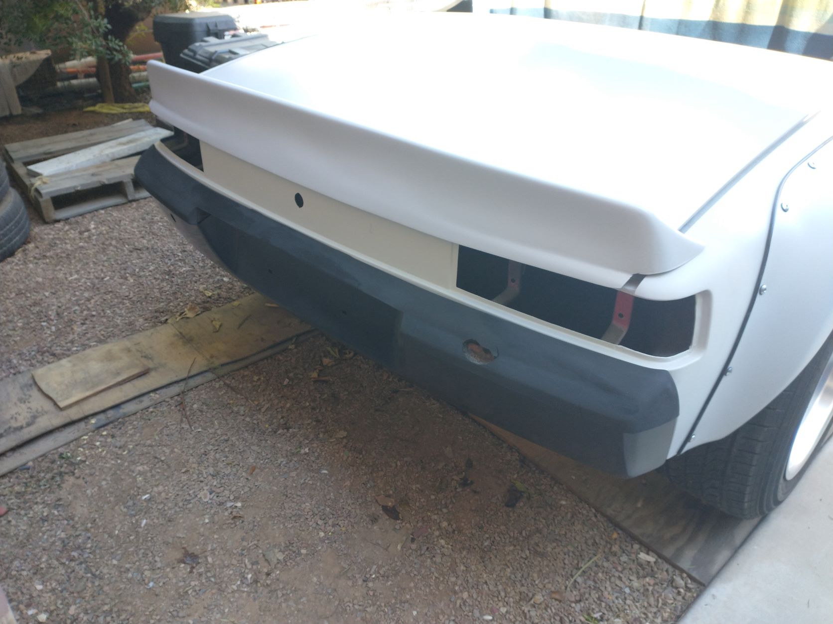

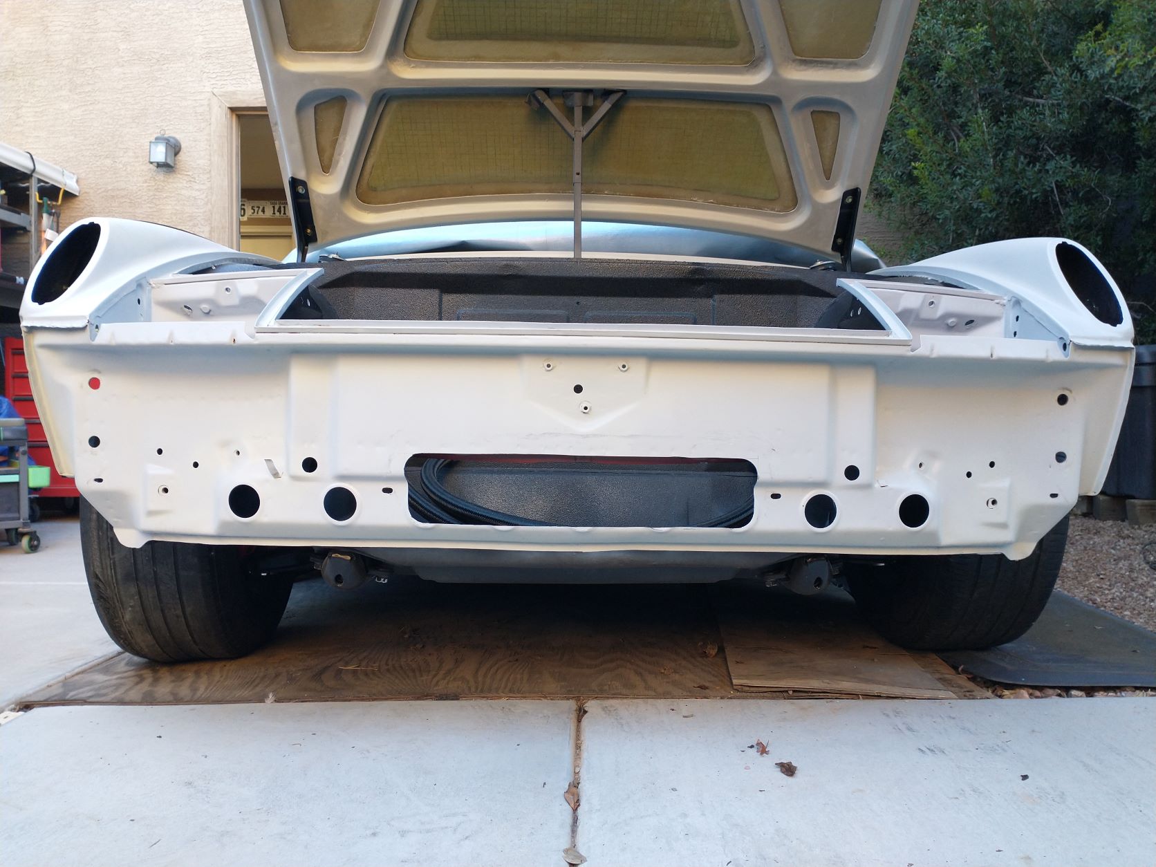

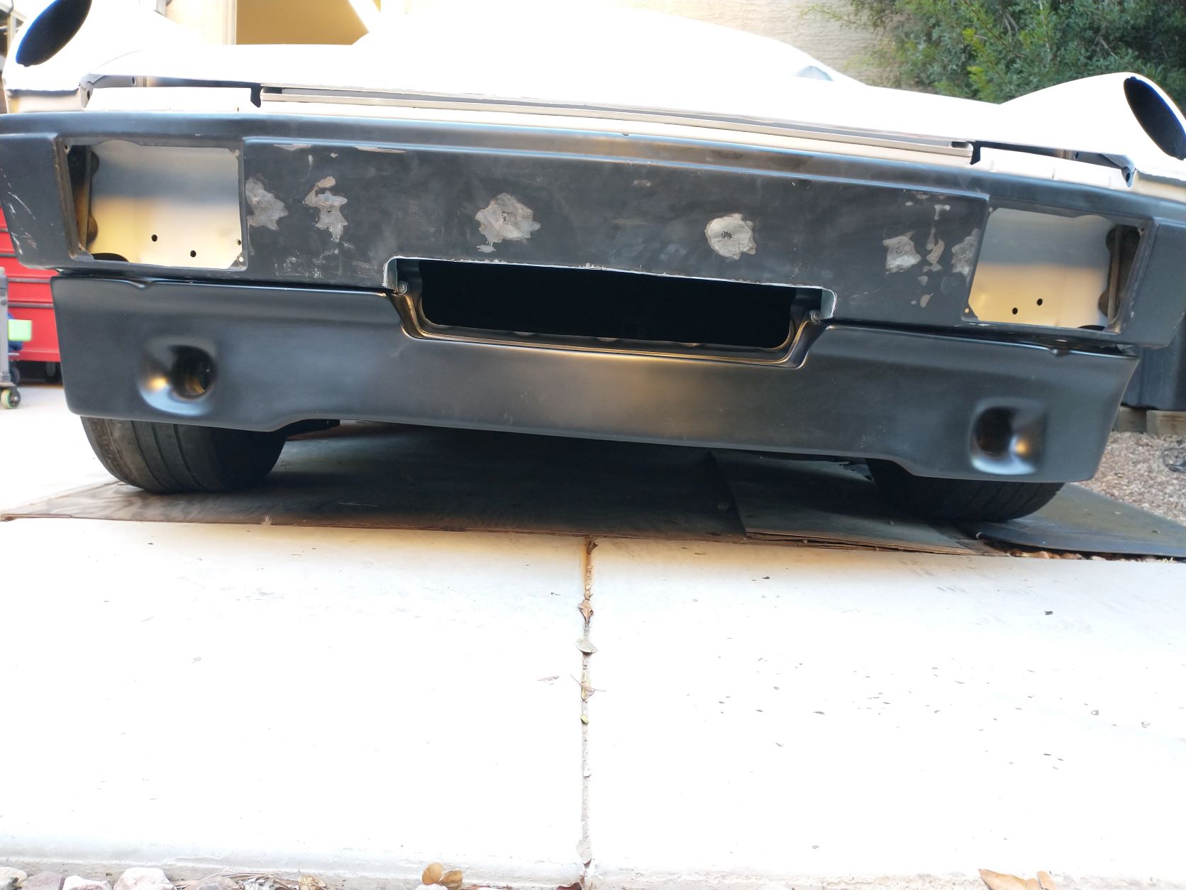

I got the rear bumper cleaned up, painted, and mounted. It was a lot rougher than the front.
I still need to figure out how to fill in that missing chunk in the bumper top (IMG:style_emoticons/default/confused24.gif)

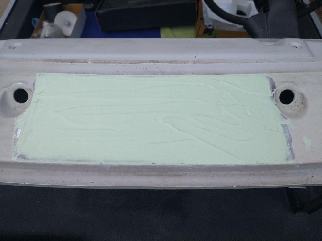

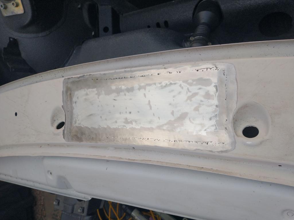

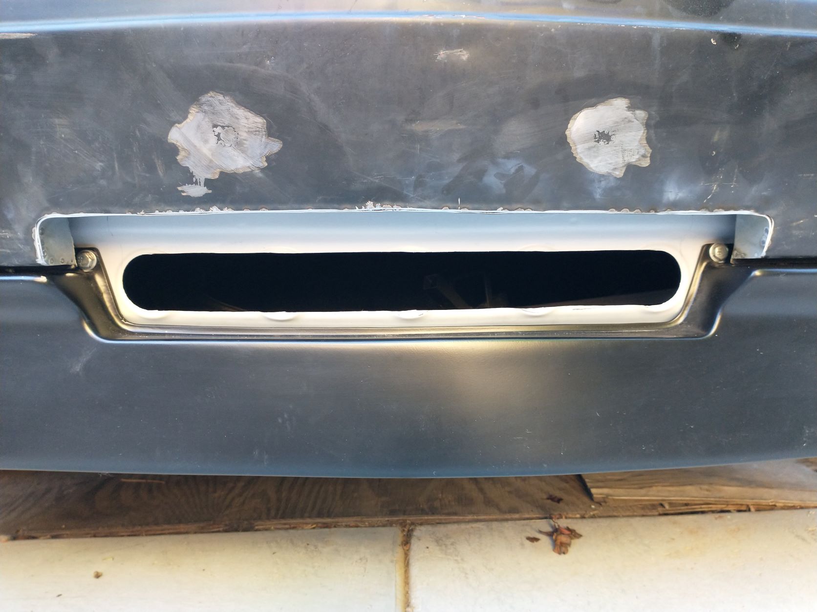

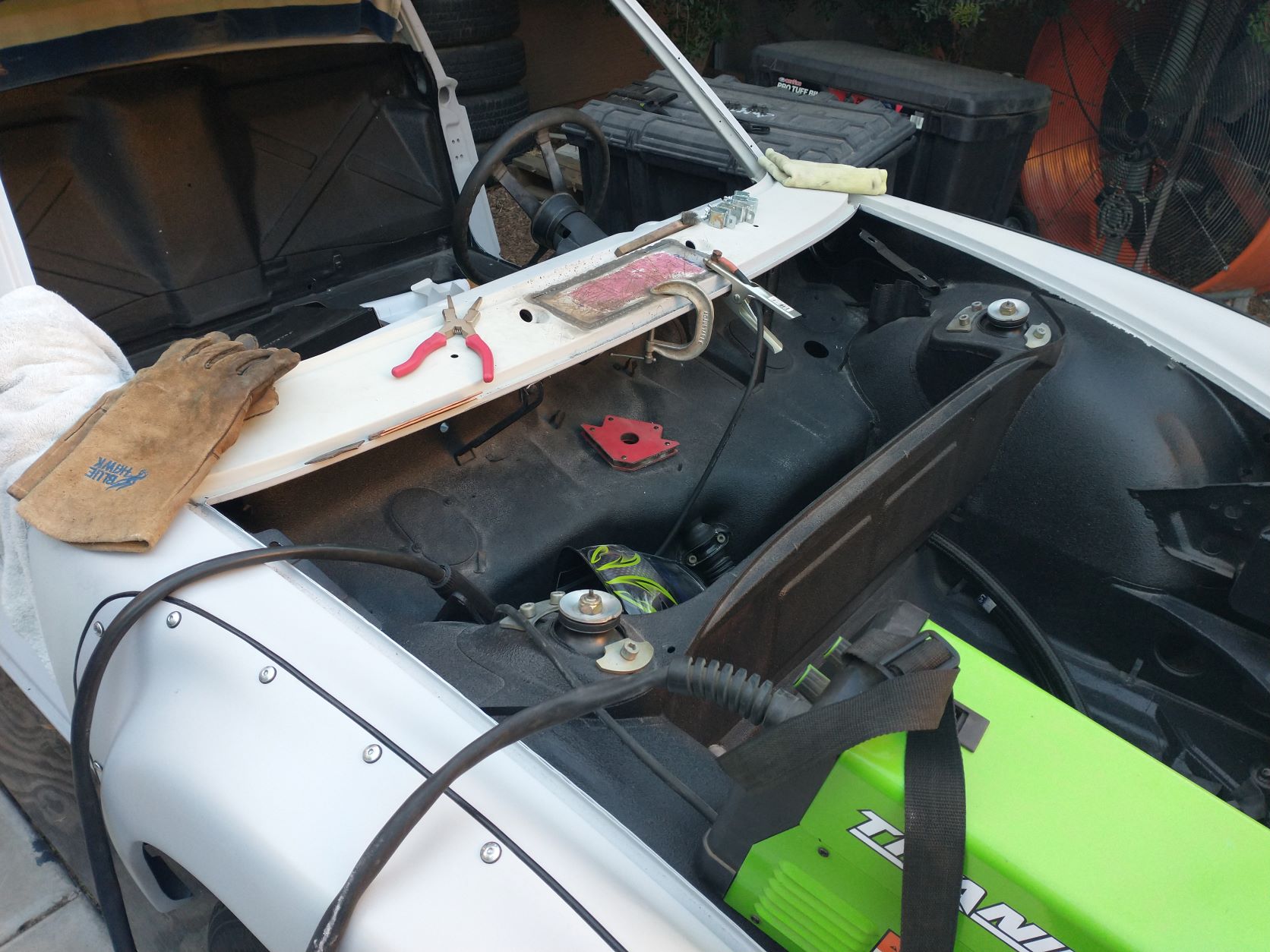

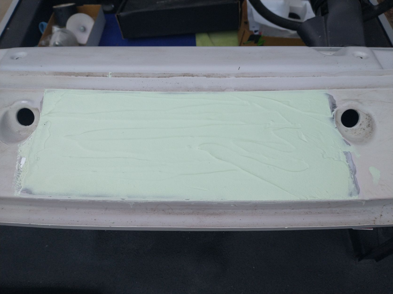

Then I moved on to cutting out and patching the vent/grille on the cowl. I kept trying to figure out how I would handle water getting in the vent and decided the "easiest" thing to do was just remove it. (IMG:style_emoticons/default/welder.gif)
Backing the welds with copper really helps, but clamping/holding the copper in place is quite the challenge! (IMG:style_emoticons/default/headbang.gif)
Quite the tedious process, but came out ok.

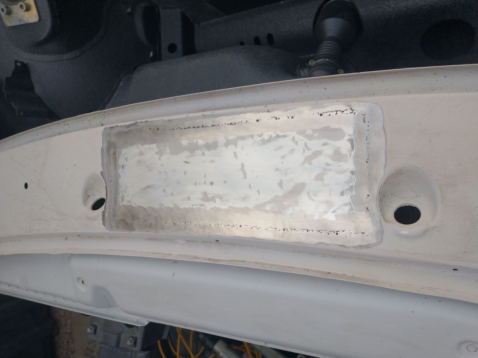

Tomorrow I'll see how level I got the filler when I start sanding (IMG:style_emoticons/default/idea.gif)

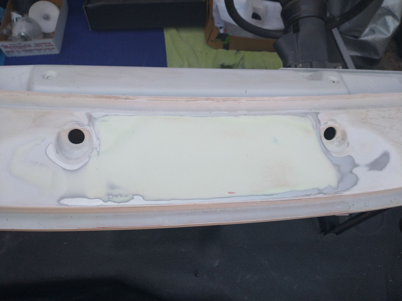

Got it all flat, then filled with glazing putty, then finally all sanded out with 120, then 180, then 320... (IMG:style_emoticons/default/smash.gif)
Just waiting for primer to show up (IMG:style_emoticons/default/confused24.gif)
