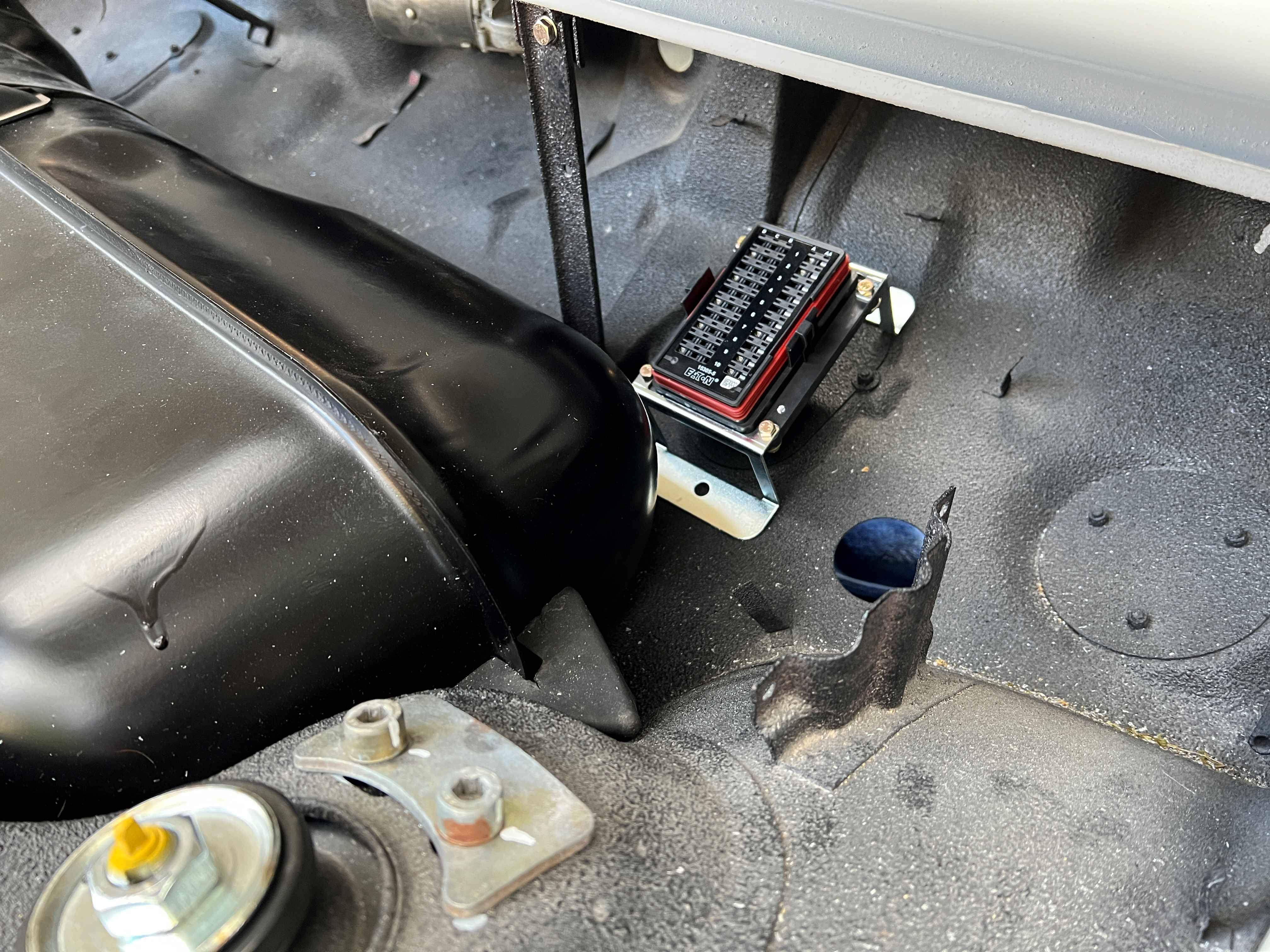

Finally got some mounts for the fuse block. Trying to figure out the best spot to install it. Don't want it under the dash unless it just doesn't work anywhere else. This is right above the original location, and seems like it might work well, while still being fairly easy to access. (IMG:style_emoticons/default/idea.gif)
Just need to determine length for the wires for all the front end items and then get those wires labeled and installed into the fuse block. Wiring is more than a bit overwhelming (IMG:style_emoticons/default/wacko.gif)

Nice work on the 914 and sorry about your son's accident.
A couple of comments. The fuse block should work where it's at as long as you can easily reach it with the tank in and it has a cover to keep moisture out.

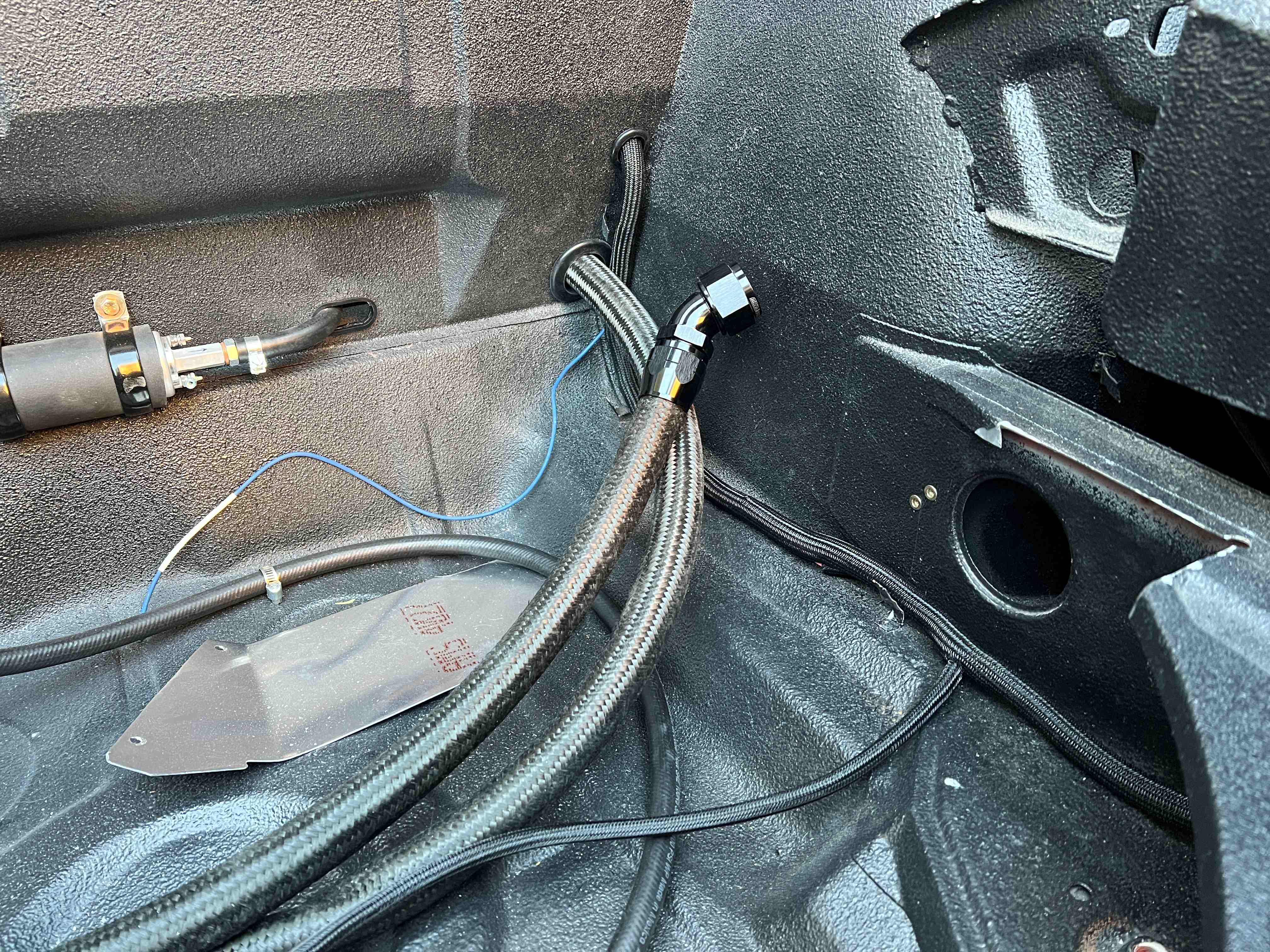

About the tank, not sure if you're going to use the little portal to make the connections to the tank. These can looped around to the driver side and back thus giving ample length to do the connections with the tank out and drop it it. I did this with my 914 and welded the portal closed.
Thanks for the feedback. The fuse block does have a water proof cover & seal. Also, being in PHX area, not much water/rain to contend with.
I have AN adapters on the tank outlet and am using the portal to access and connect them.

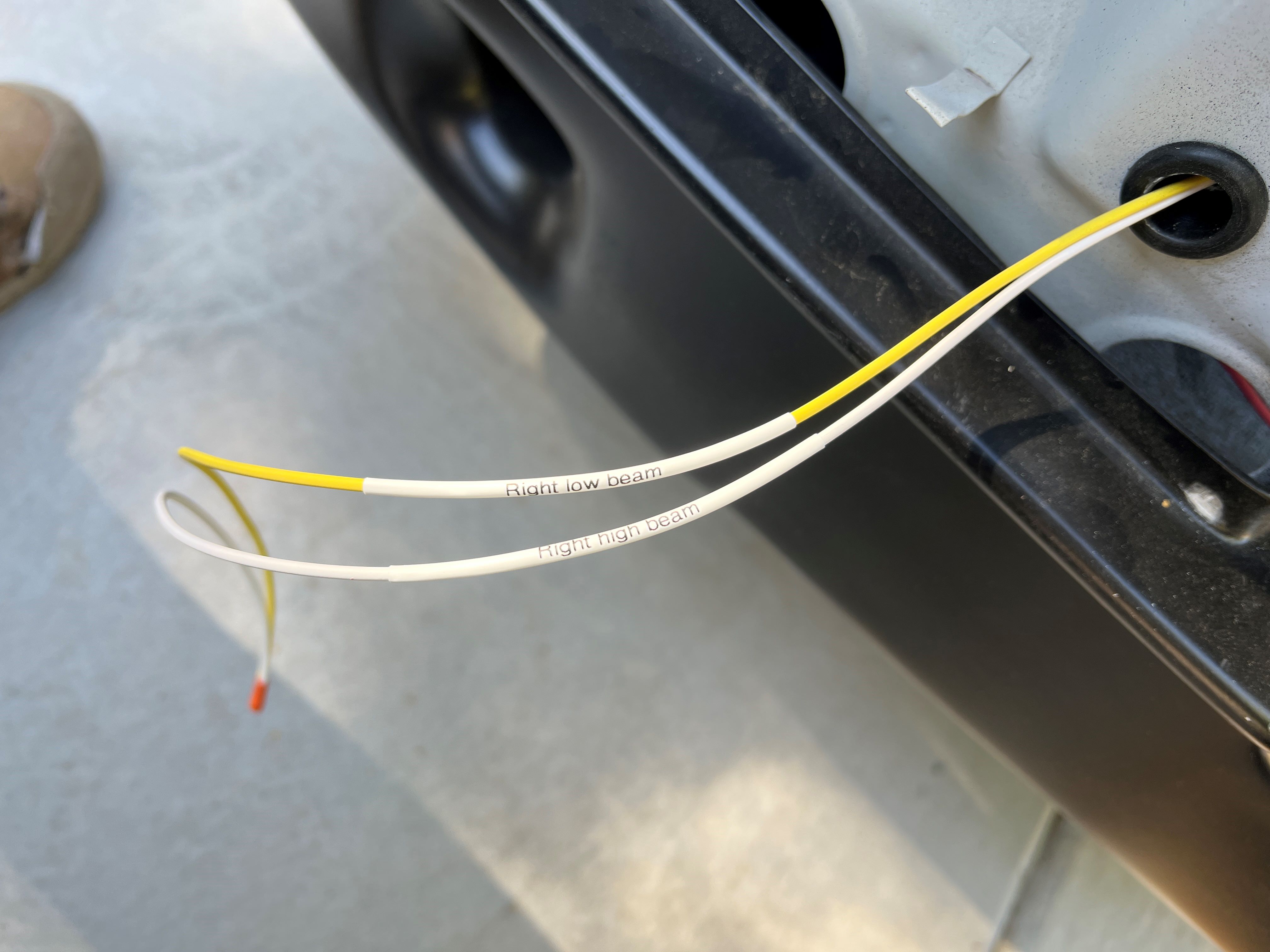

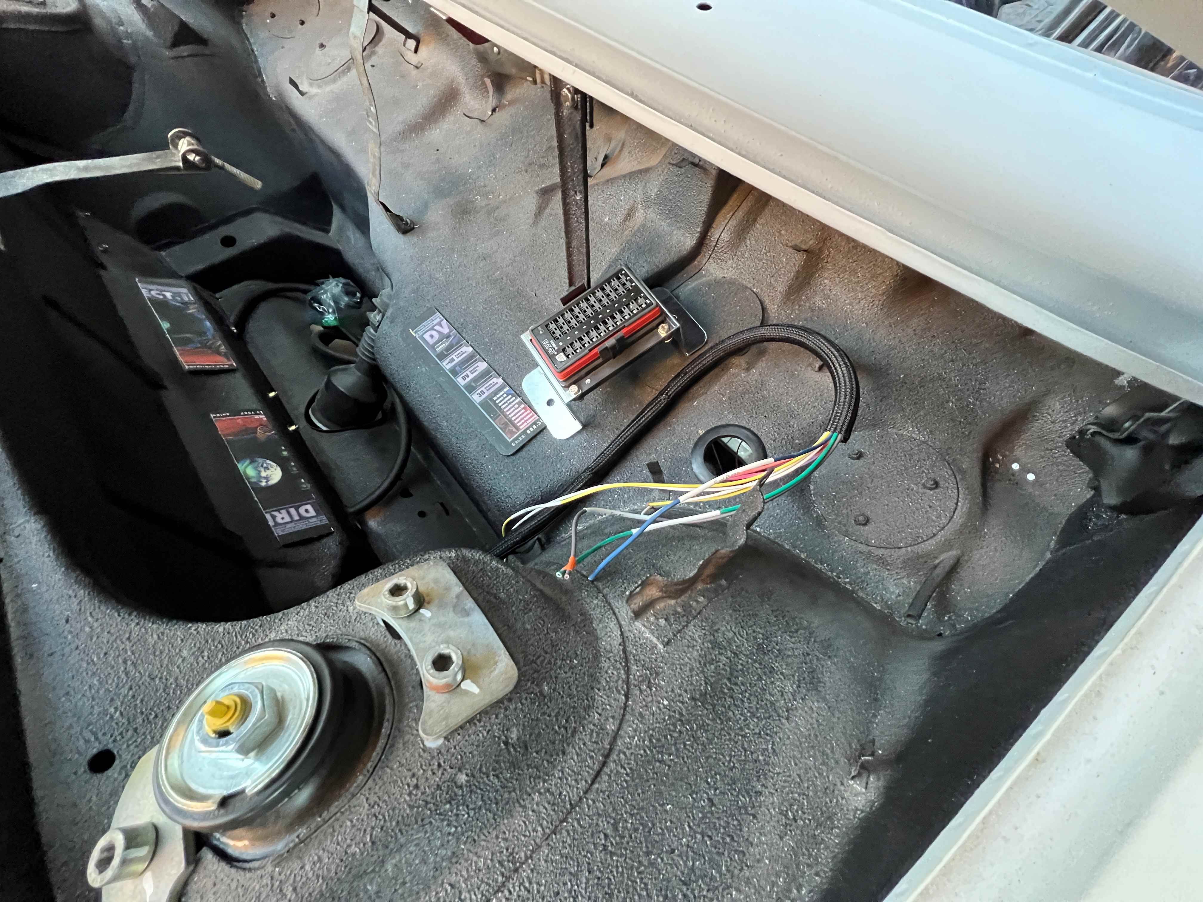

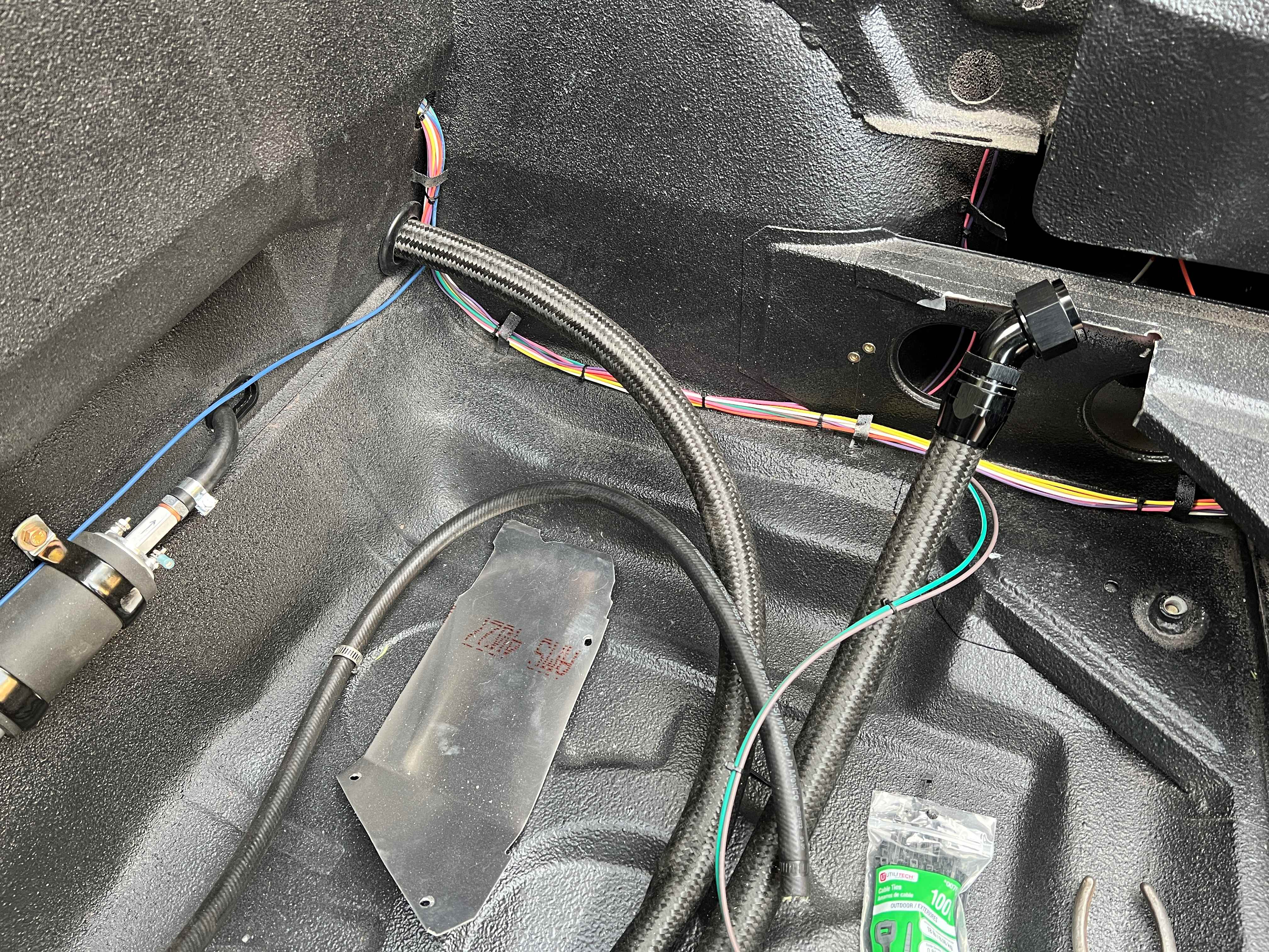

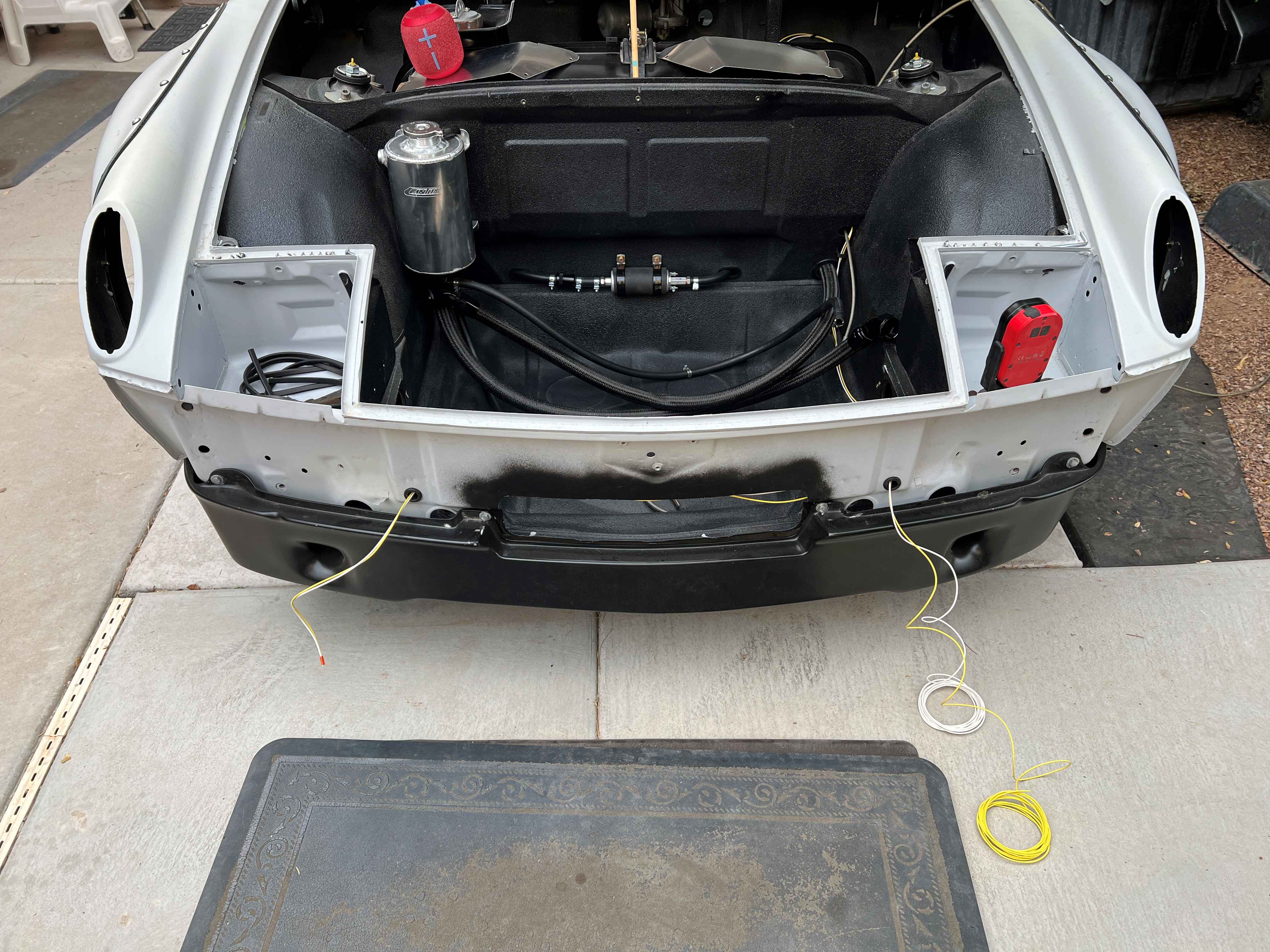

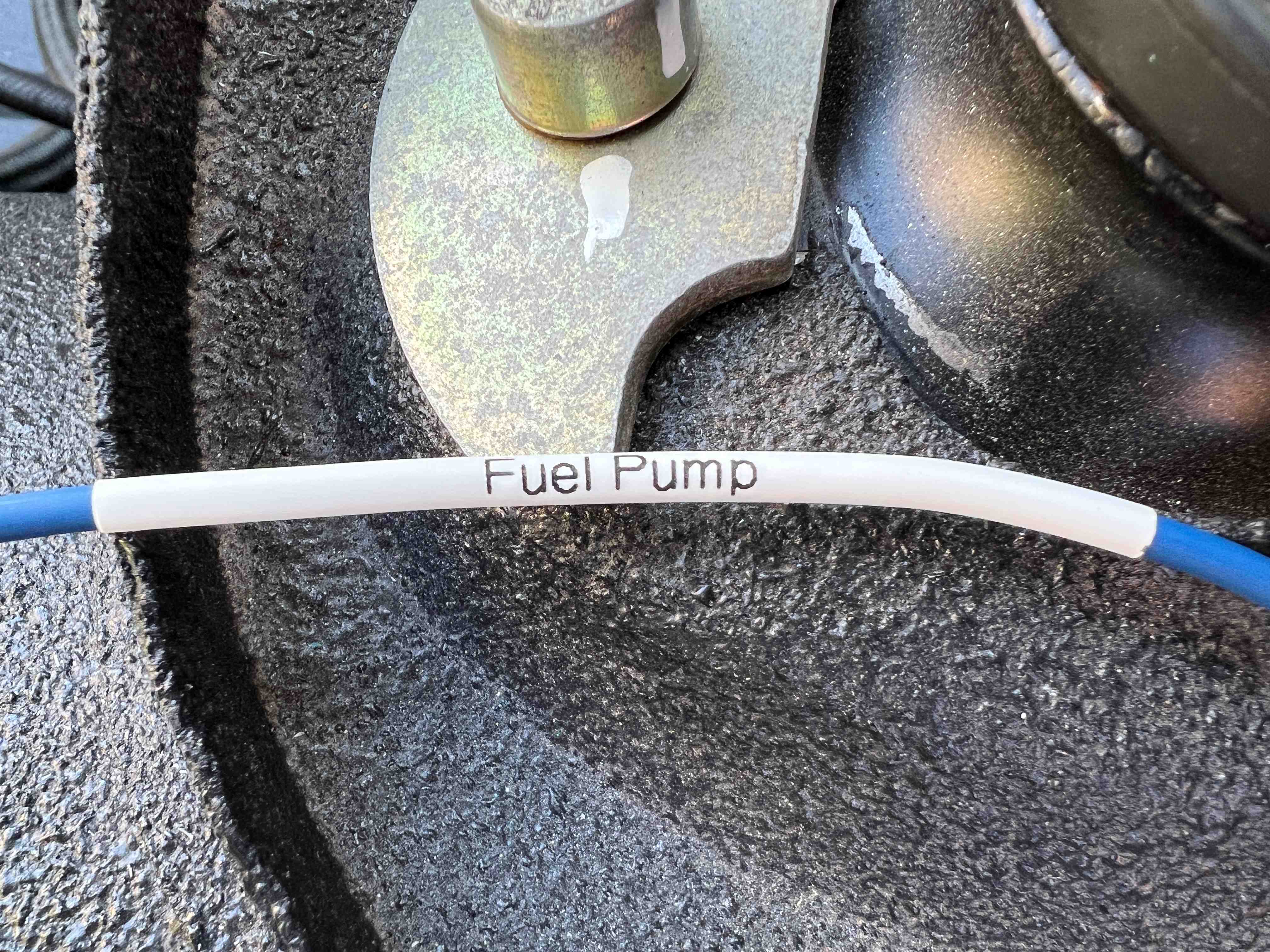

Trying to start running some wires. Still struggling in my head on how to start (IMG:style_emoticons/default/headbang.gif) Figured I would run all the wires that I KNOW go from headlights to relays in the fuse block, or fuel pump to the relay in the fuse block and get them labeled. Then move to the rear and do the same...
The shrink tube for the label maker is super cool!
Still need to find/decide on some type of wiring loom I can put over the wires once I have them all laid out in the car. (IMG:style_emoticons/default/idea.gif)

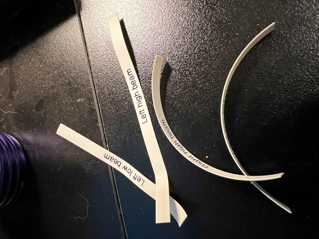

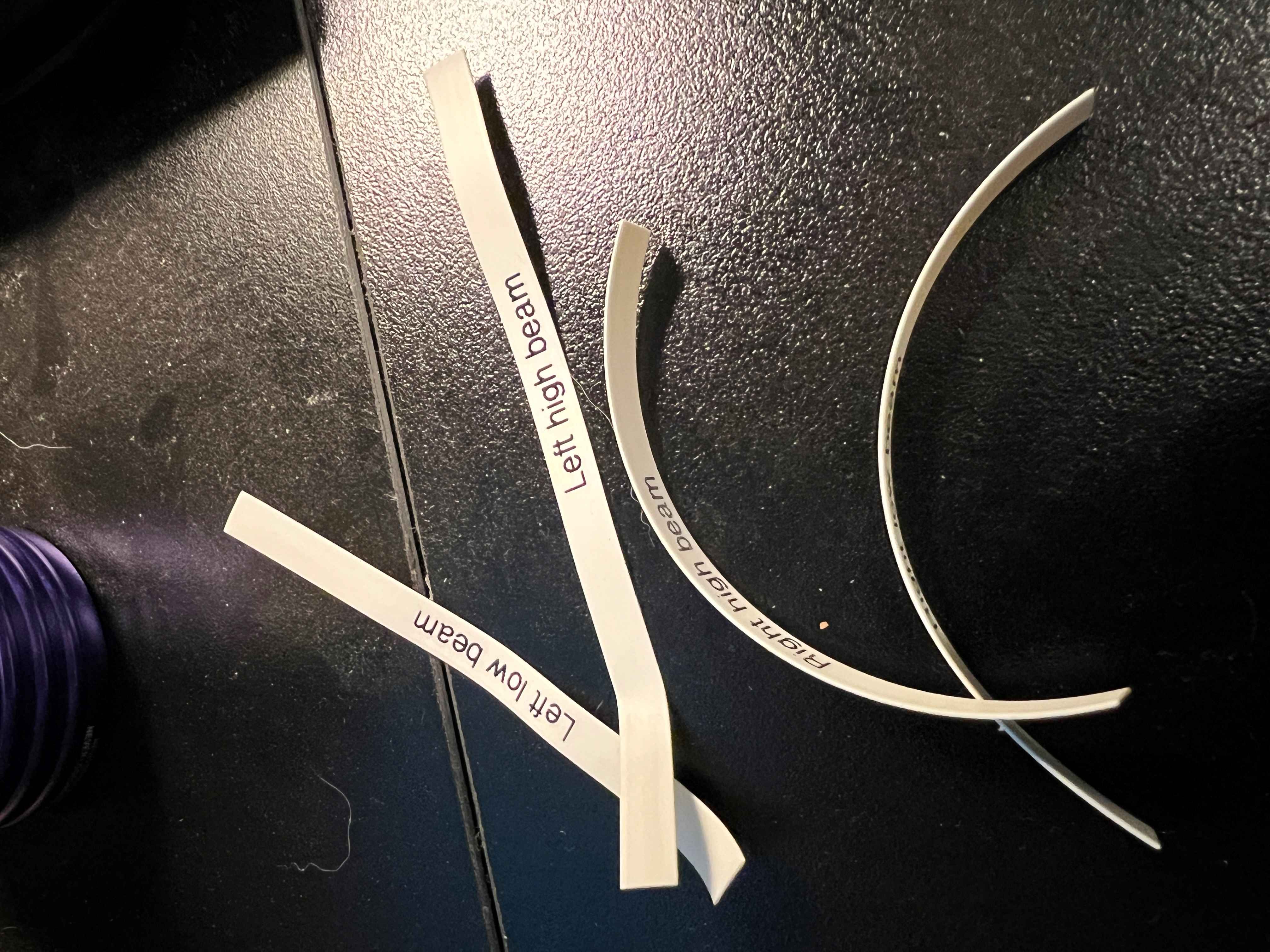

Some more detailed shots of the printable shrink tube labels...

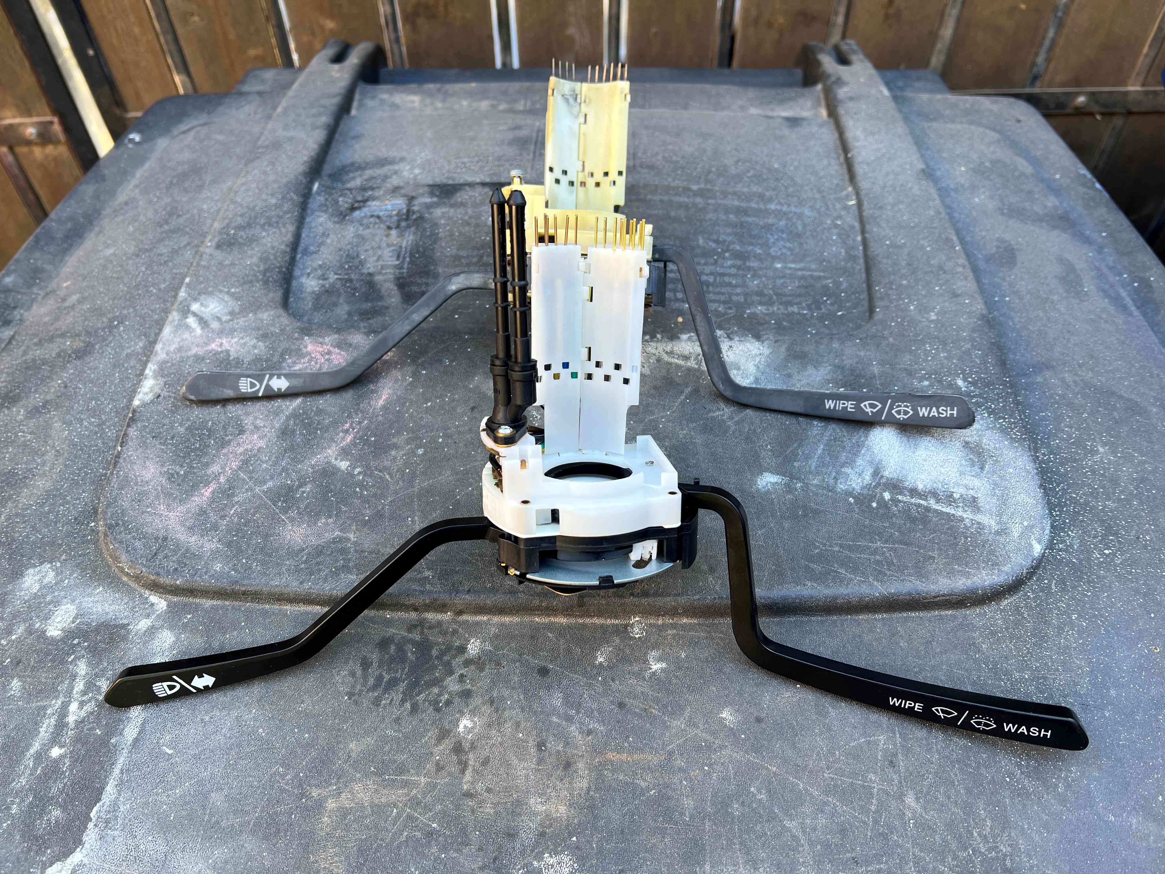

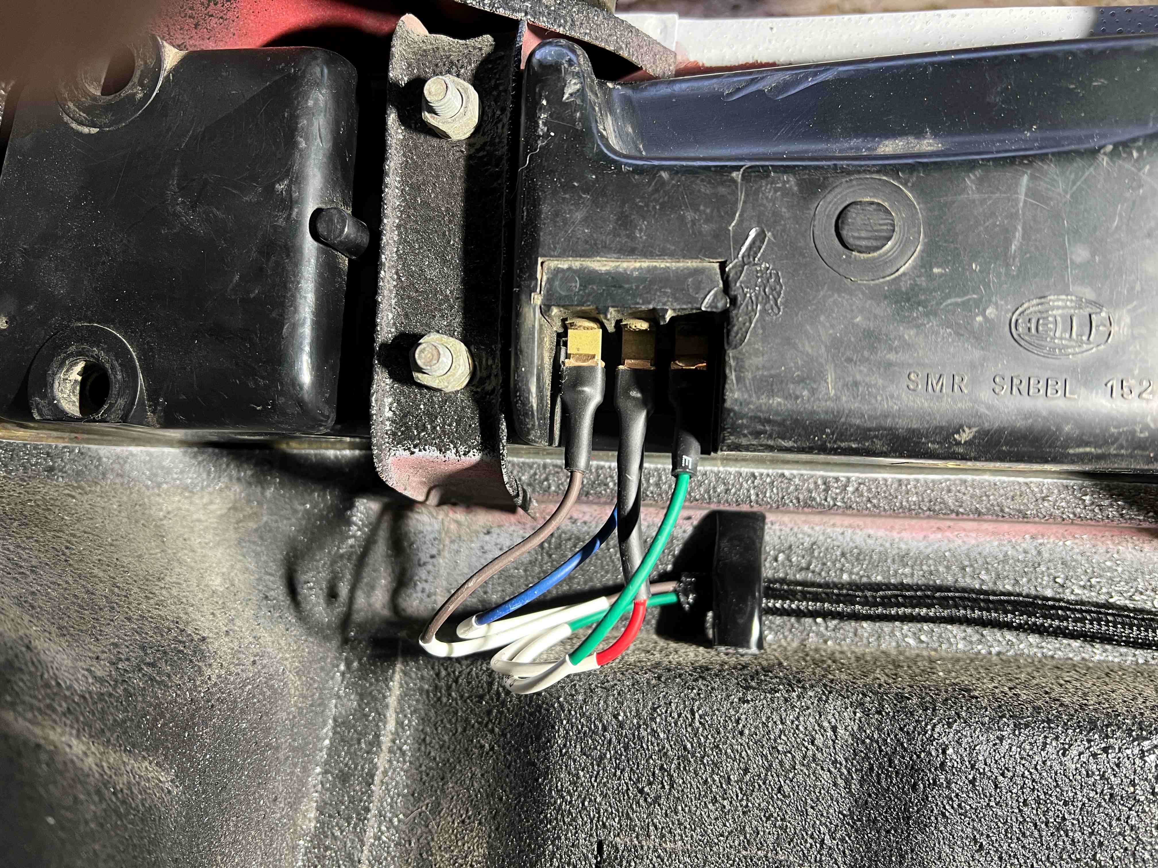

I received my tab cover from 914Rubber, so I measured and cut them to the lengths needed. I got them all installed throughout the chassis and began looming the wiring. A bit hard on the fingers, but works pretty well.
I ordered the incorrect wiper stalk and had to re-order the correct one from Jbugs, but at least I'm not worried about 50 year old plastic crumbling as I reinstall them!

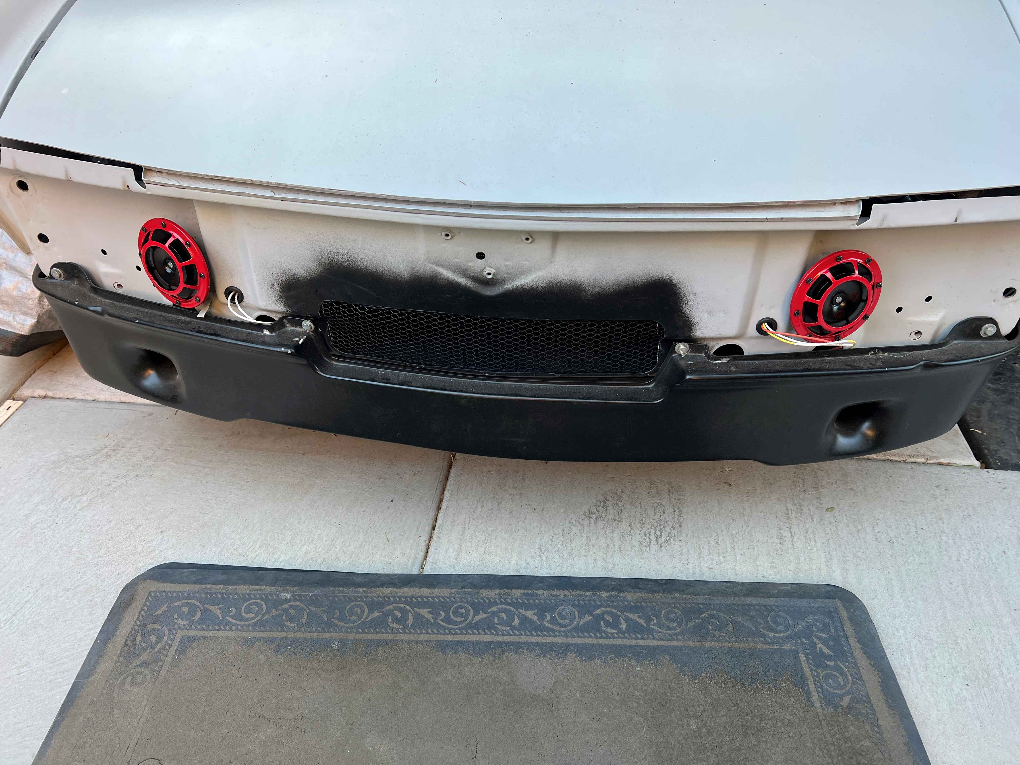

I also got my battery tray welded to the support, welds ground flat in the tray bottom, and some primer sprayed.
I ordered a Hella dual-tone horn set and got them mounted.

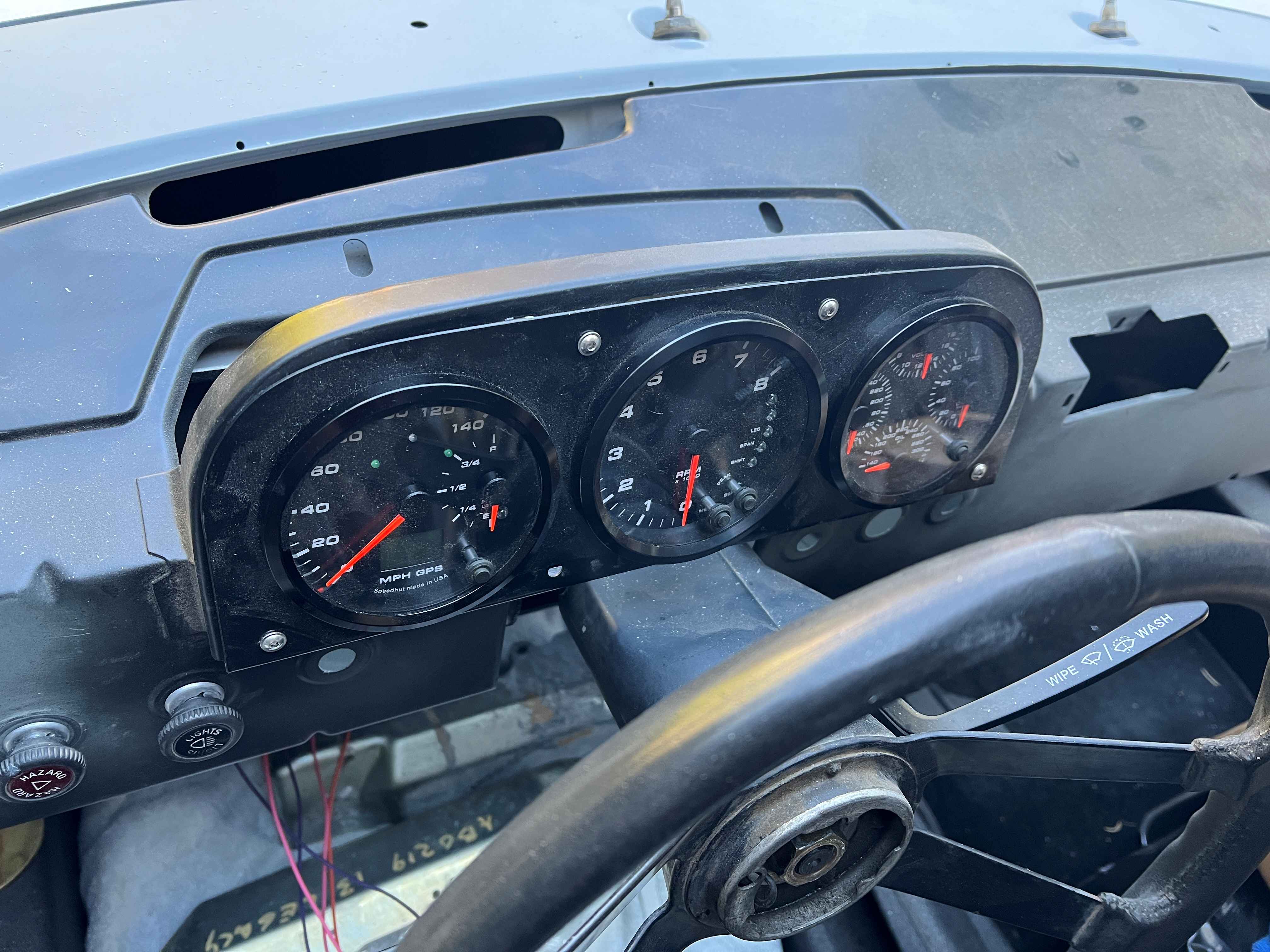

I installed the SpeedHut gauges I bought from Chris just to see how they look, and to have them in place for wiring. Beautiful...
I still just can't get over how THIN they are!

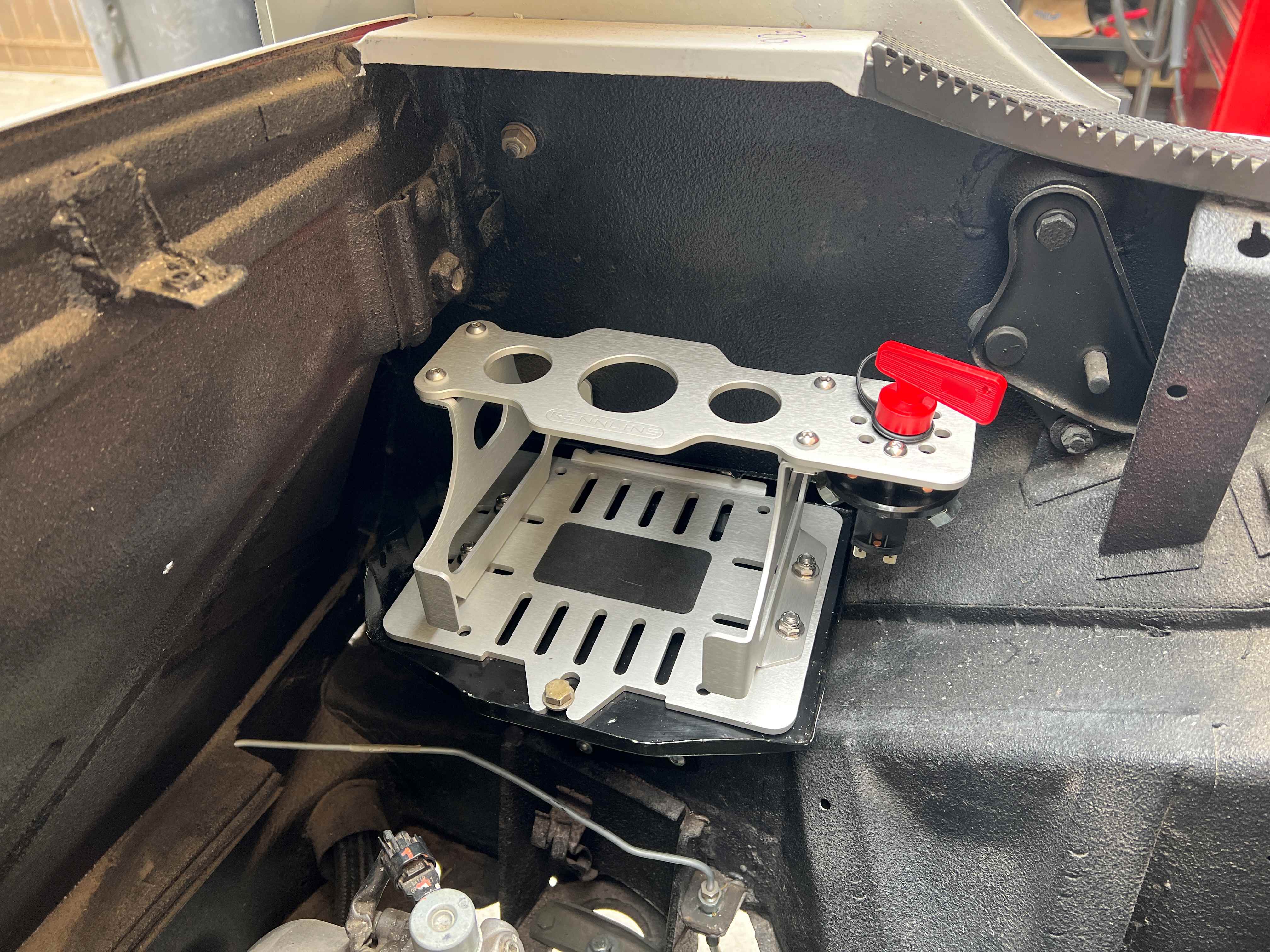

I received my Rennline 6 Pole Cut Off Switch, and my 80A breaker for the main fuse block feed. Just need to decide where to locate each of the components. Trying to do things safely/correctly without over complicating things. (IMG:style_emoticons/default/wacko.gif)

But, I did receive my battery mount from Rennline.
Still need to wire up the kill switch and the breaker for the main fuse block.

My next big hurdle is deciphering the connections for the turn signal & wiper levers, and the high/low beam switch. (IMG:style_emoticons/default/wacko.gif)
