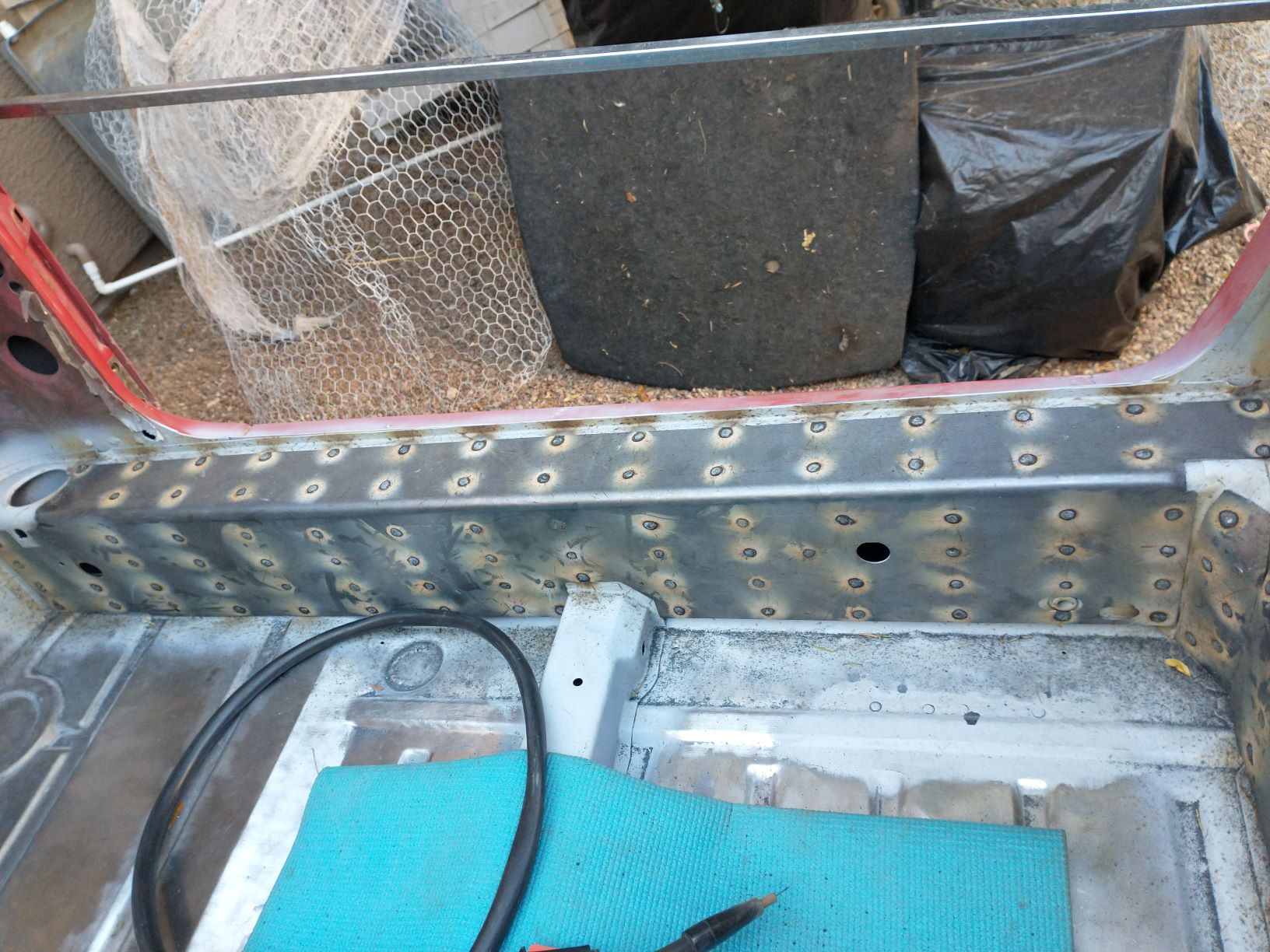

I got each and every hole filled with a screw, and did my best to fit the panels as snug as possible. My hands sure are not used to driving that many screws!
Attached ImageAttached ImageAttached Image
My AWOL order of weld-thru primer finally showed up, so I undid each and every screw. Which is a bit of a PITA as the self-tapping tip never wants to come out! For some reason this reminded me of the pincushion guy from Hellraiser!
I got the backs of the panels all primed, and primed the bare metal of the longs and lower firewall.
Once they were all screwed back in place, I tested my settings one more time to make sure things were good to go. I got the welder and everything I needed setup inside the car so I did not have to climb in & out any more than needed! I would take one screw out, then fill that hole with weld. Then take another screw out and weld. Then I would move to another panel on the other side of the car and repeat.
My welds are nothing to write home about, but the price is right! (IMG:style_emoticons/default/lol-2.gif)

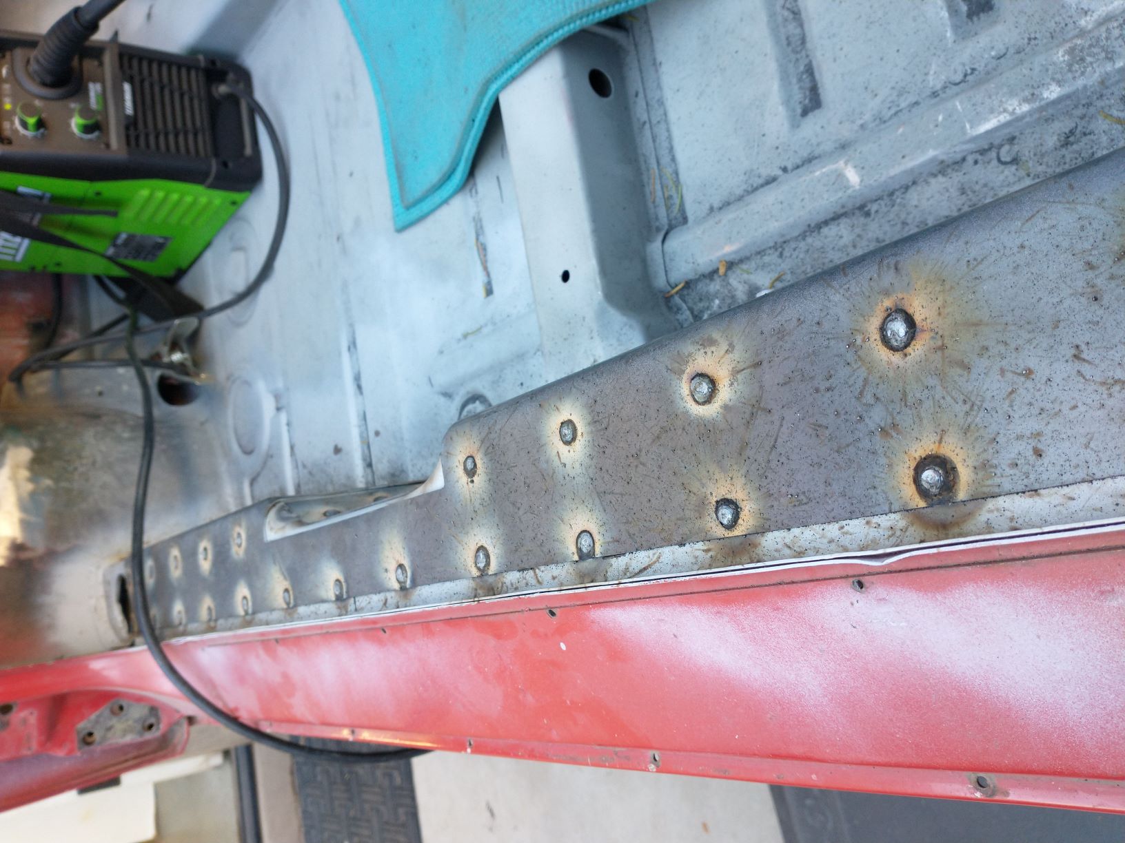

Ran to HD early (to avoid people) this morning to grab a new welding helmet. After washing, clay barring, and "ceramic" coating my wife's Jeep, it was back to finish up the rosette welds. Nothing too exciting, except my knees are really happy all those welds are complete!
The rosette welds came out pretty ok, at least for my skills & equipment!

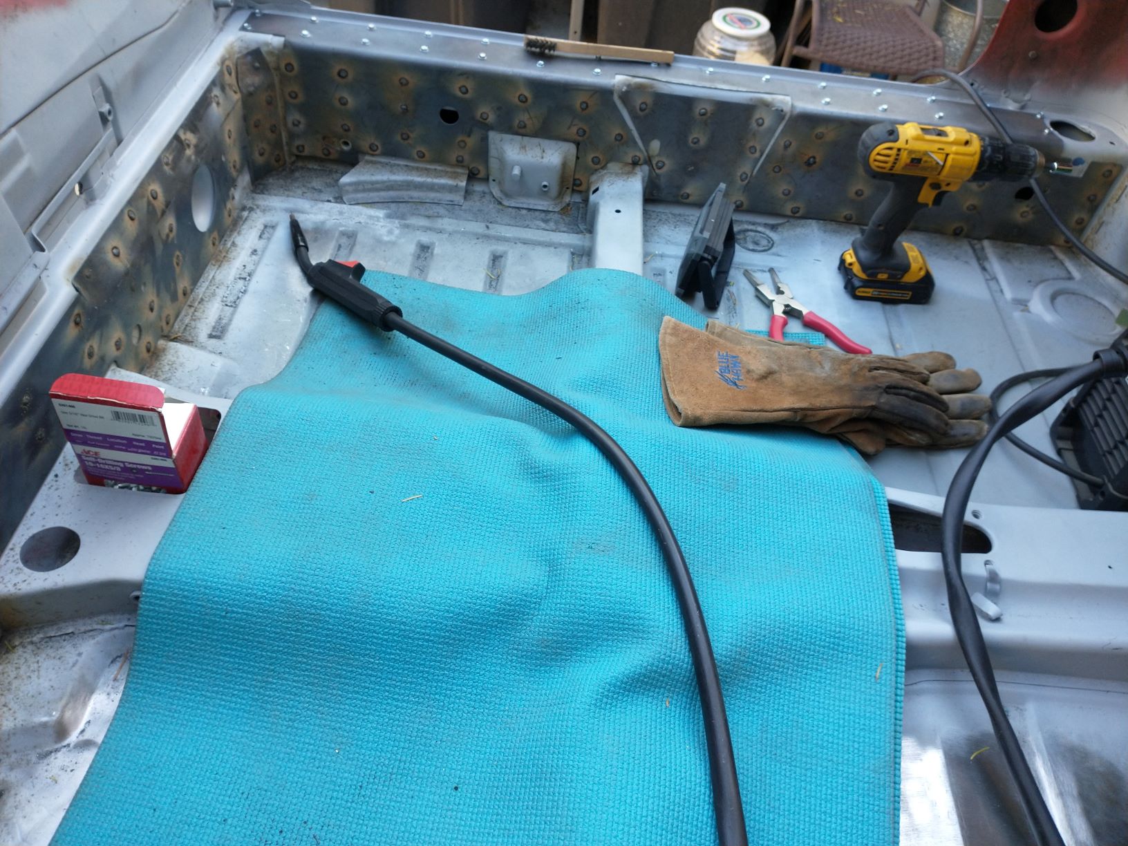

Today was mostly washing/cleaning up my truck, but I did manage to spend a couple of hours on the 914. I got all my rosette welds ground down. A few little spots here and there, but overall not to shabby for me.
I did some test welds, and tried to ensure my settings were ok, and worked on trying to stay straight! Looking a bit better... (IMG:style_emoticons/default/idea.gif)

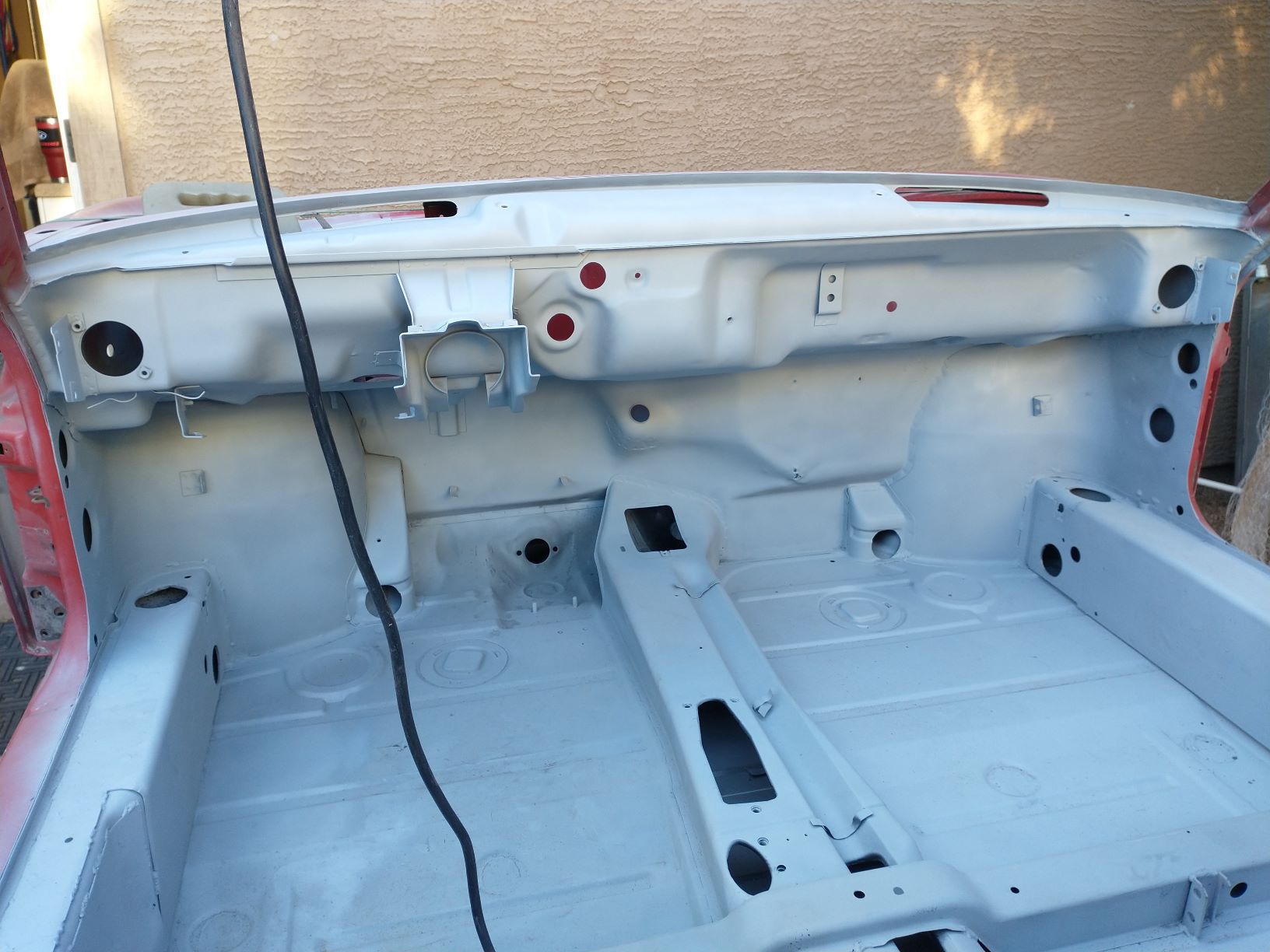

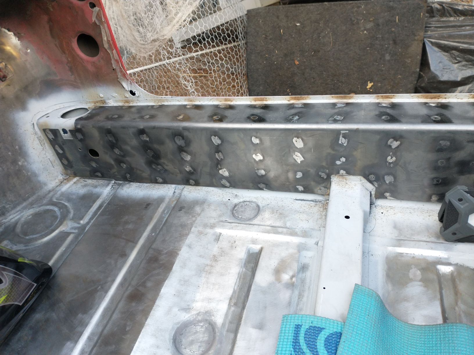

I got the panels all stitched in. Things were going better, so I figured while I was on a roll, I'd just go with it!
Welds looking better...at least for my welds! (IMG:style_emoticons/default/lol-2.gif)
Hit everything with the wire brush, vacuumed up all the debris, and coated with primer to protect it...

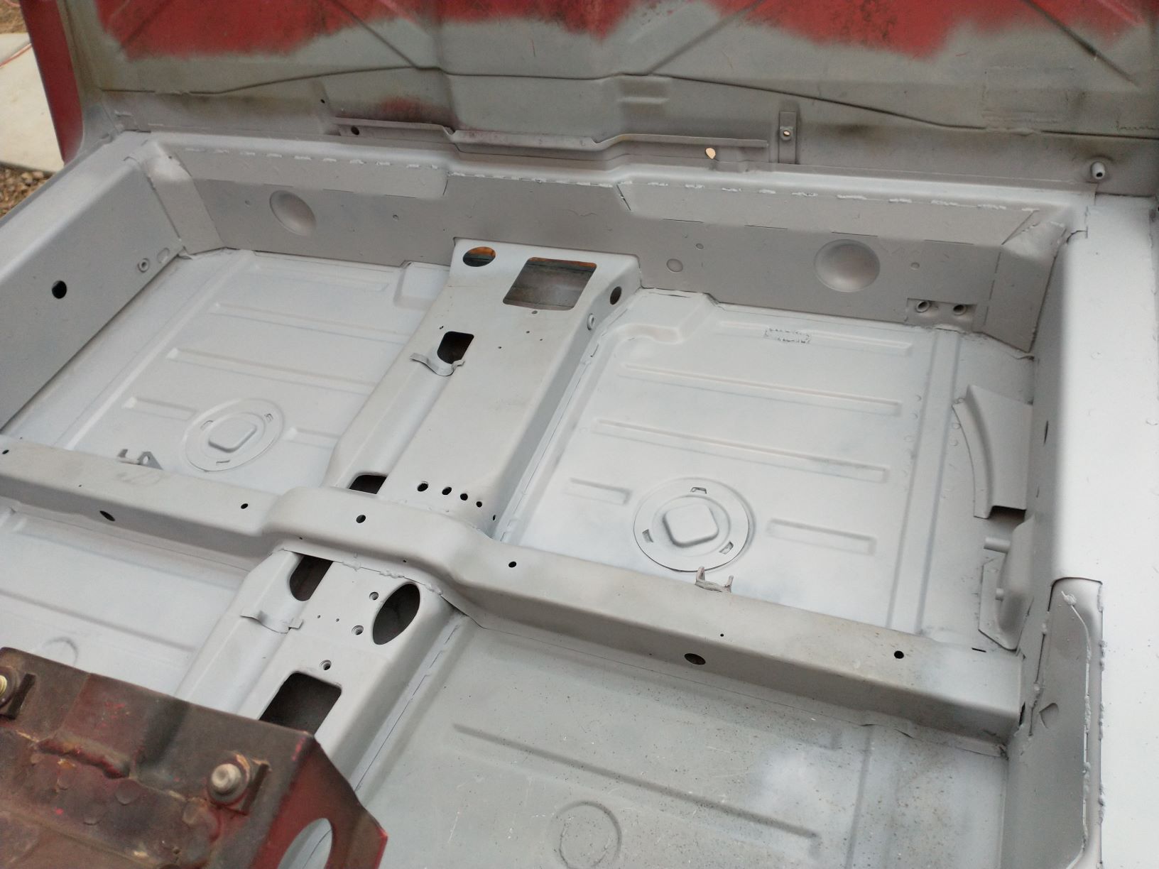

Still just trying to keep moving forward. Inch by slow inch...
Trying to get the interior of the chassis all wire brushed, any rust I find treated, and then a quick coat of primer to protect it. With all the little nooks & crannies I think doing the flares and the outside might seem easier! Still have the frunk to finish up!
I found some surface rust under the dash - seems like a really odd place to rust, especially on an Arizona car!
Not too terrible after cleanup.
Some more surface rust on the firewall, but not much!
I actually forgot to treat the two spots on the firewall before priming, so I looked back at the above photo and hit the right areas with the wire brush so I could treat them. Just try to ignore my amateur patch on the left there! (IMG:style_emoticons/default/confused24.gif)
There was some odd, crunchy sealer just in front of the doors under the dash. Very different stuff from the other seam sealer!
I tried to check all the problem areas to uncover any rust. The usual spots look really good!
There was a bit of rust in the windshield channel, especially at the two bottom corners. Did my best to wire brush it and then treated it too.
The shop vac is seeing daily use, and getting quite the workout sucking up all the paint dust, rust, and metal shavings! (IMG:style_emoticons/default/blink.gif)
