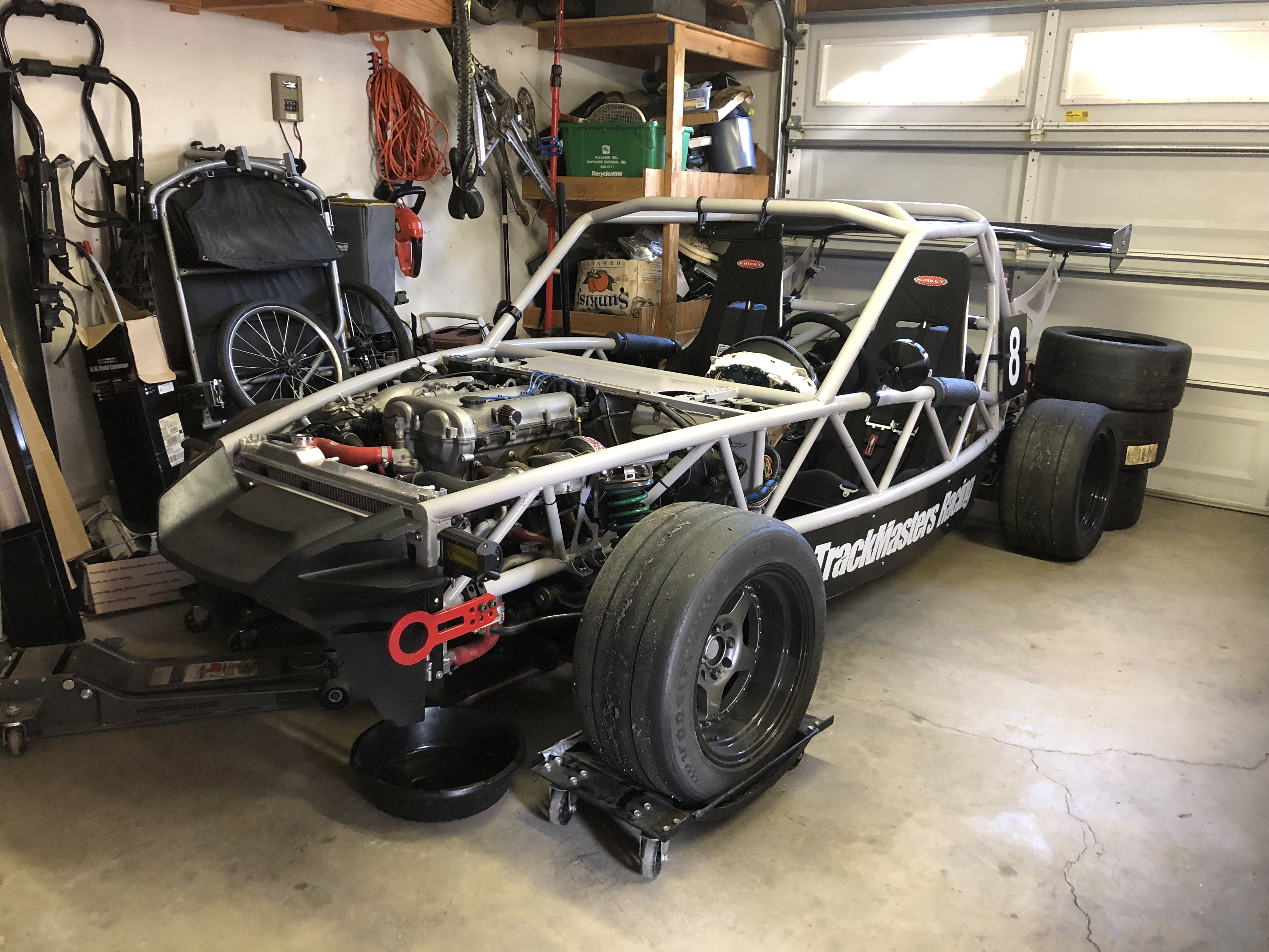

Got a great deal on a track car... getting it ready for whenever the tracks open. Now I don't have to beat up the 914 as much.

Tell us more about it (IMG:style_emoticons/default/popcorn[1].gif)

QUOTE(euro911 @ Apr 14 2020, 04:44 AM) *
It's called an exocet, the chassis is fabricated by Exomotive in Georgia. You buy a donor miata, pull off the body and connect the drive terrain to this new exo-frame. Then you basically have a 1500 lb miata... but I think it looks alot better. It was all set-up for the track, how could I say no? (IMG:style_emoticons/default/biggrin.gif)
You can get them Ca legal with the SB100 like a kit Cobra, but since I have the 914 as my street car I most likely wont want to pay all the reg fees.

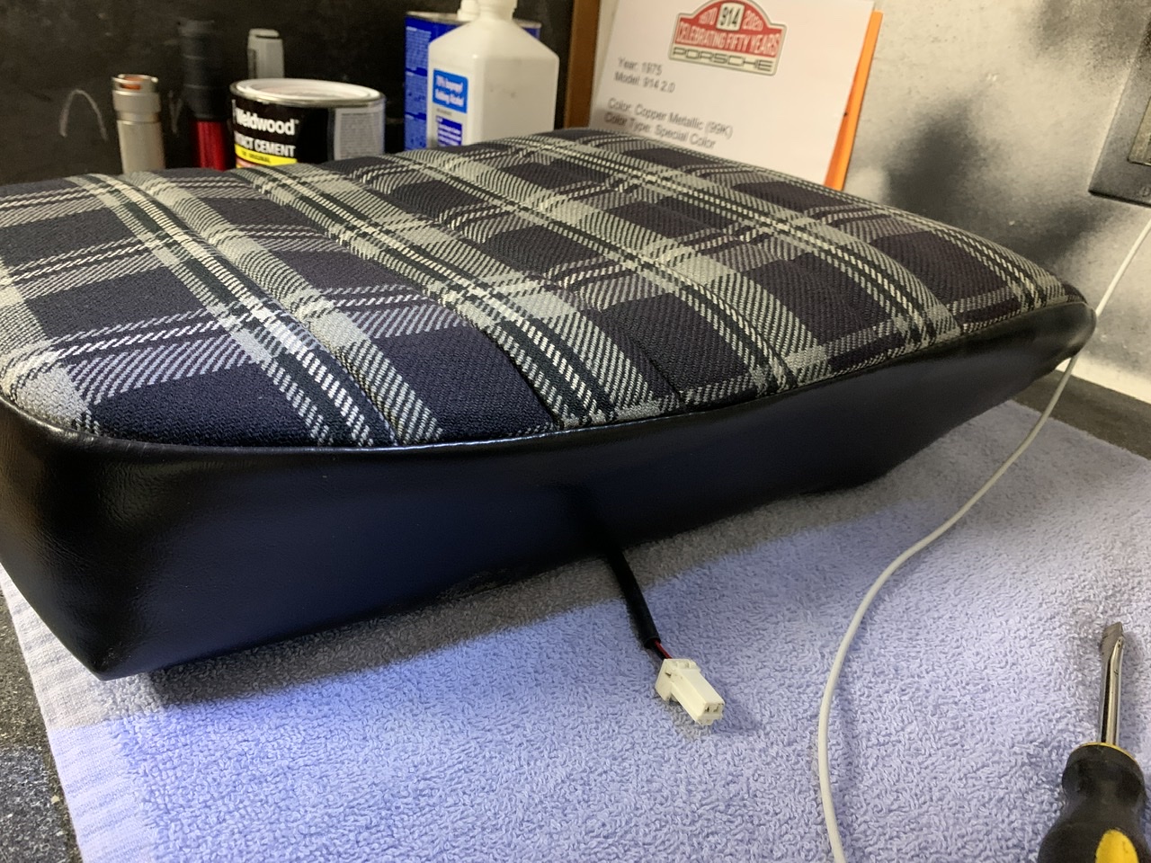

Got to work in the 914 today since i finished power washing the whole house and all the windows and screens!! i removed my seats today to fix the backside of the headrests, and when i did the new seat kits from 914rubber i reused the factory foam, which just didn’t give any decent vision or support anymore, so today i redid the driver seat by adding 1” firm memory foam to the whole seat bottom pad. Big improvement! also happy with getting those headrest material tacked back up in place.

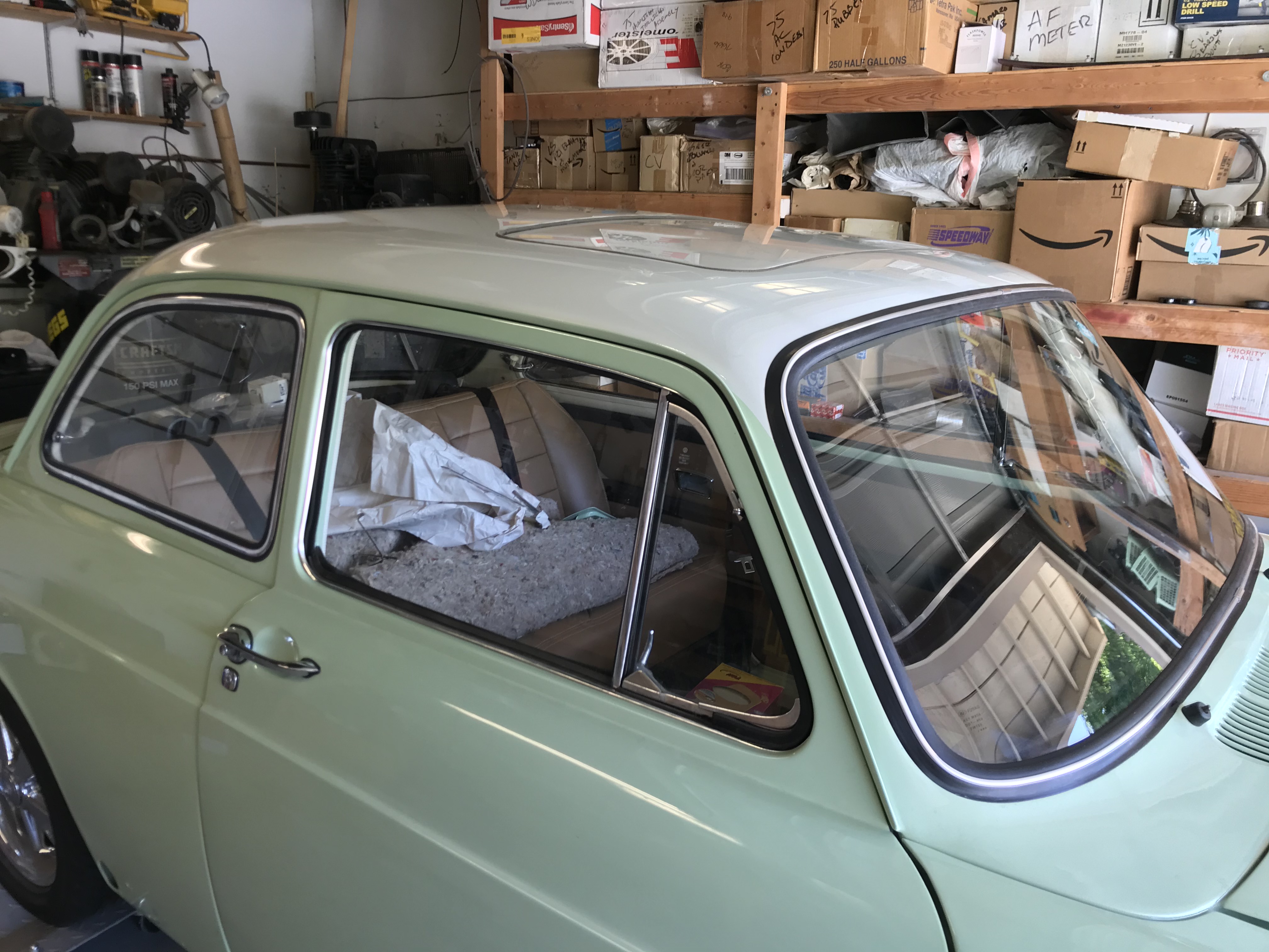

I put in this big ole windshield today all by my lonesome
I am starting to get the hang of installing vw glass with chrome by myself.
I then moved on to installing the sunvisors, fun trying to find the mount holes through a new headliner, then hung the AC unit so I can figure out where to run the lines

'Notch' with Fuchs?

QUOTE(euro911 @ Apr 15 2020, 01:08 AM) *
'Notch' with Fuchs?
6 inch , got them from Coondog

@djway Dwayne - DUDE! Your Notch looks beautiful! Great work. Let me know if you ever want to sell it... seriously.

@djway You have to post more pictures of the notch! (IMG:style_emoticons/default/drooley.gif)
