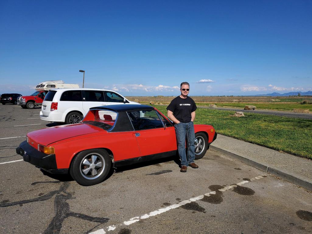

Michelle and I picked up our new to us 914-6 over the weekend. We practiced social distancing and kept safe. Two days home, 920 miles, the 914 never missed a beat.
Here's a picture at a rest stop about 30% of the way home.

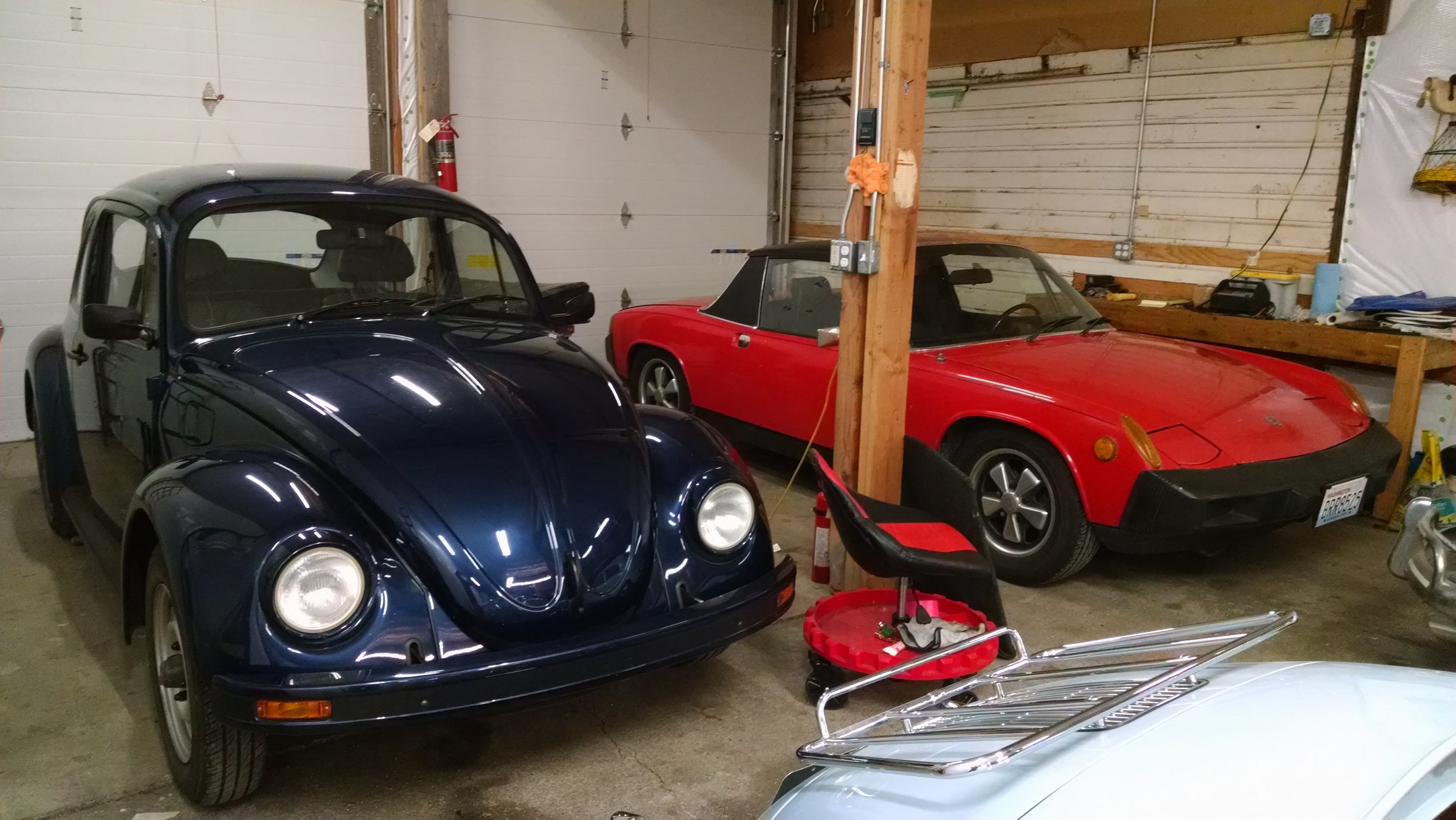

With building a house as my first priority, I'm not getting anything done on the 914-6 other than order up some parts here and there.
I drove it again last week and oh-boy, that is one sweet engine! With CIS, CATS and hydro-lifters, I'm certain the 2.7 isn't living up to it's potential. But it has plenty of power, very quiet and the heat works so fast and so well.
Here's a picture sitting next to my Bug:

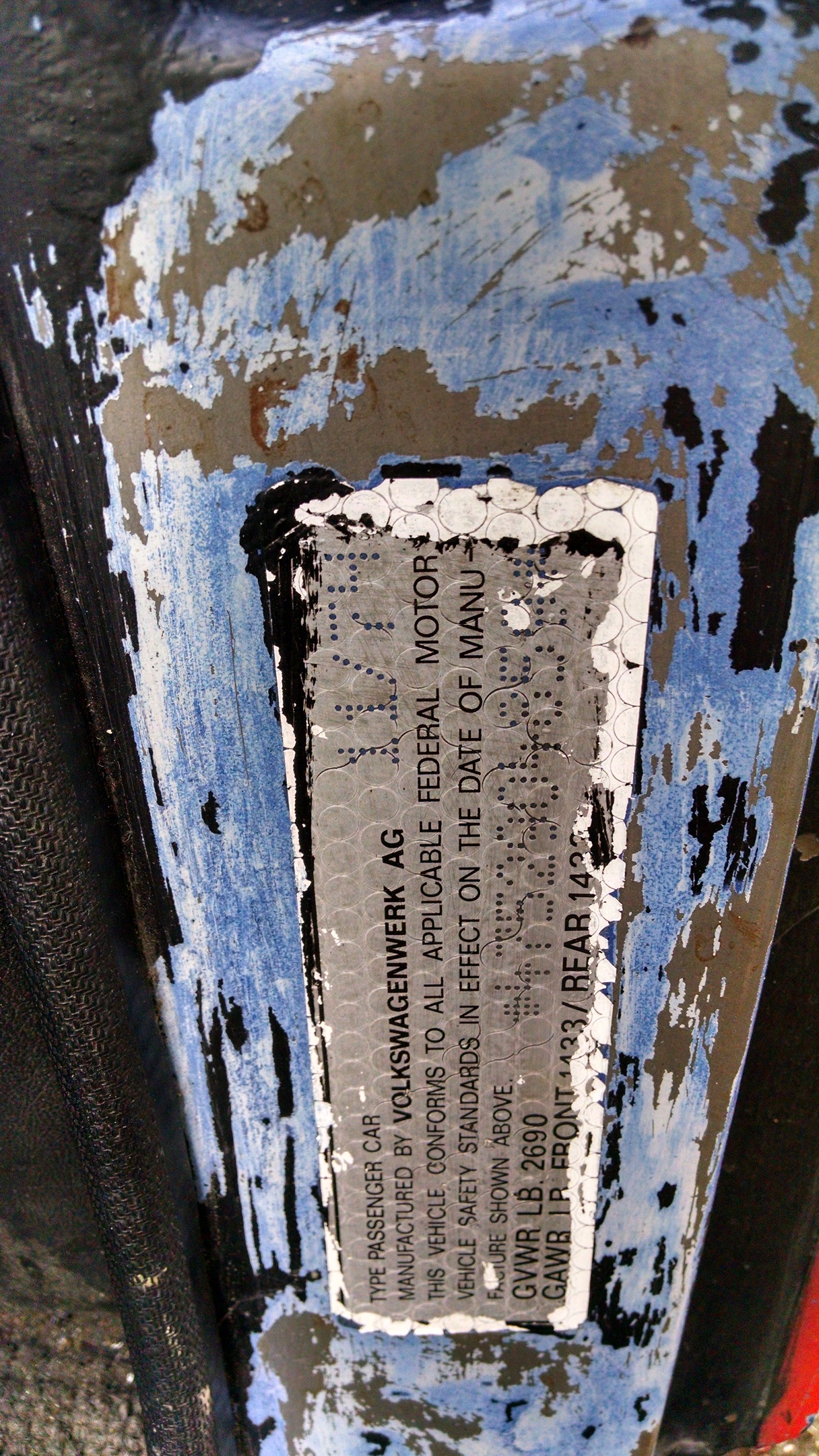

And this is why the paint/color change will happen sooner than later. Yes, you can see instead of painting red in things like trunks and door jams, there is brushed on black paint.
Looks like someone tried to clean around the VIN sticker (New on already one the way from Car-Bone.pl) and destroyed it.
I'm hoping this year I'll get the 914 stripped down and painted back to the original Anacona Blue.
