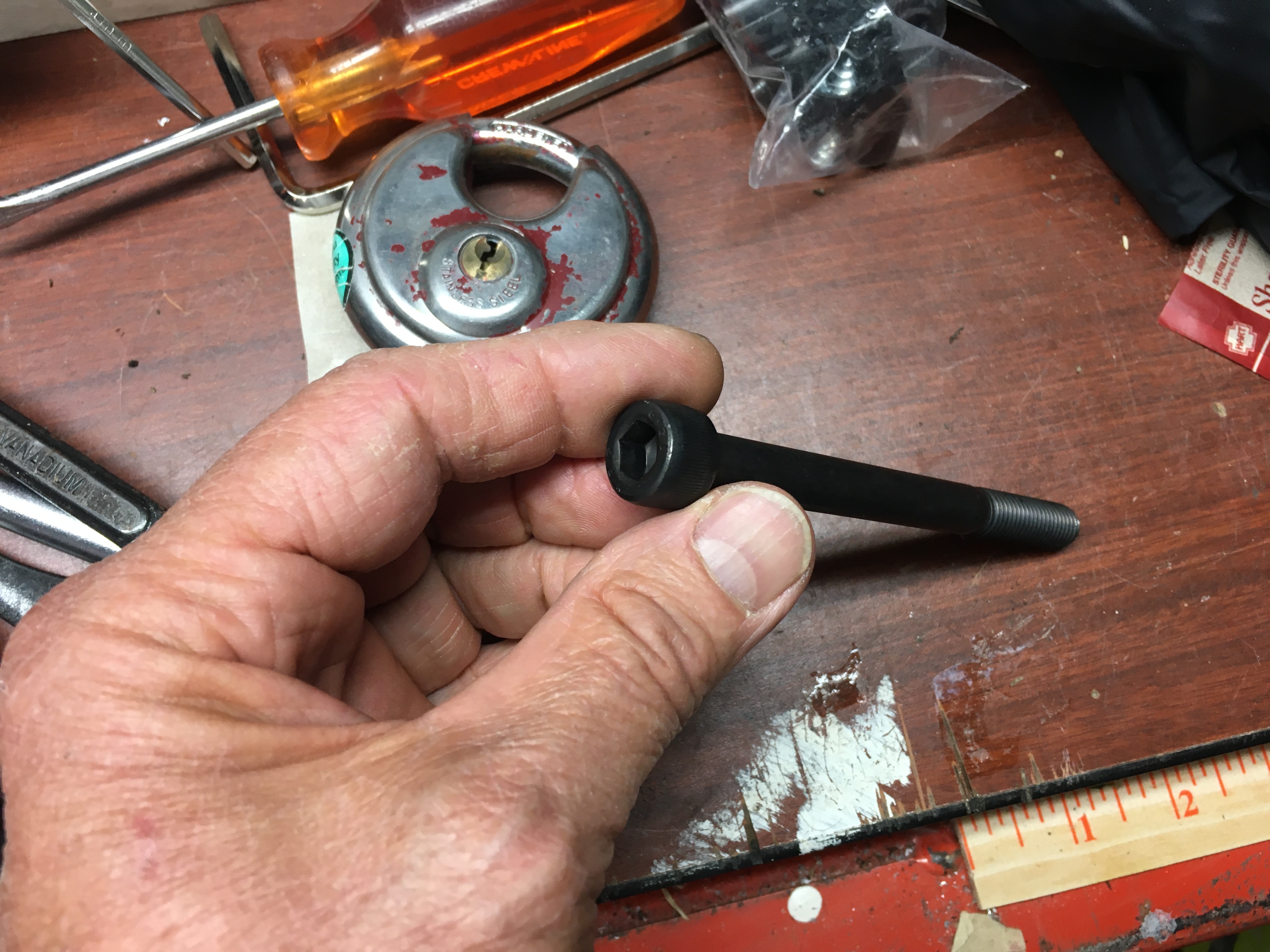

Get one of these bolts with the Allen head for the top of the starter. With an wobble extension you’ll be able to remove the starter after the engine is installed. I paid $4 for one of them but it’s well worth the couple of dollars to save me from trying to use the claw foot wrench to remove the OEM bolt.

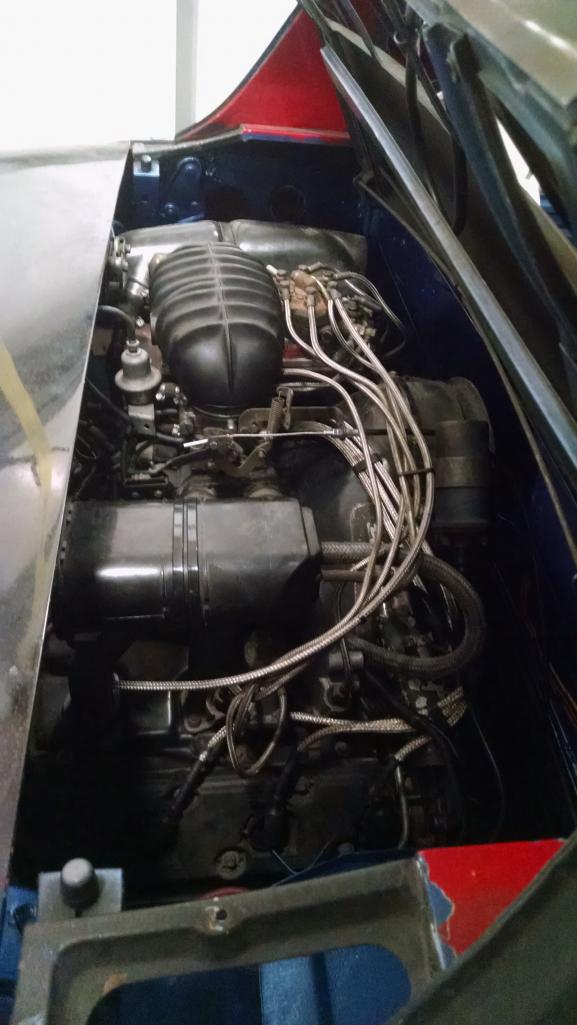

Engine/trans back in, left the axels off since I'm flat towing to the Paint guy this weekend! Finally!
Using the time to get as much done and back together as possible. Wiring cleaned up, fuel system is better and installed the fuel tank evap system. Fuel tank is still out for now, but ran the new line through the tunnel, found a very good used can and perfect mounting spot.
Very excited to finally get this off to body shop and paint.

Waffled back and forth about it. Bottom line is the engine bay isn't nice enough to sand, smooth and paint due to welding, cutting for dealer AC etc. Fixed as much as I could within reason, spray bombed it and done.
Left out things like the oil tank so he has access to inner fender. Trunks and door jams will get painted.
See you Saturday!

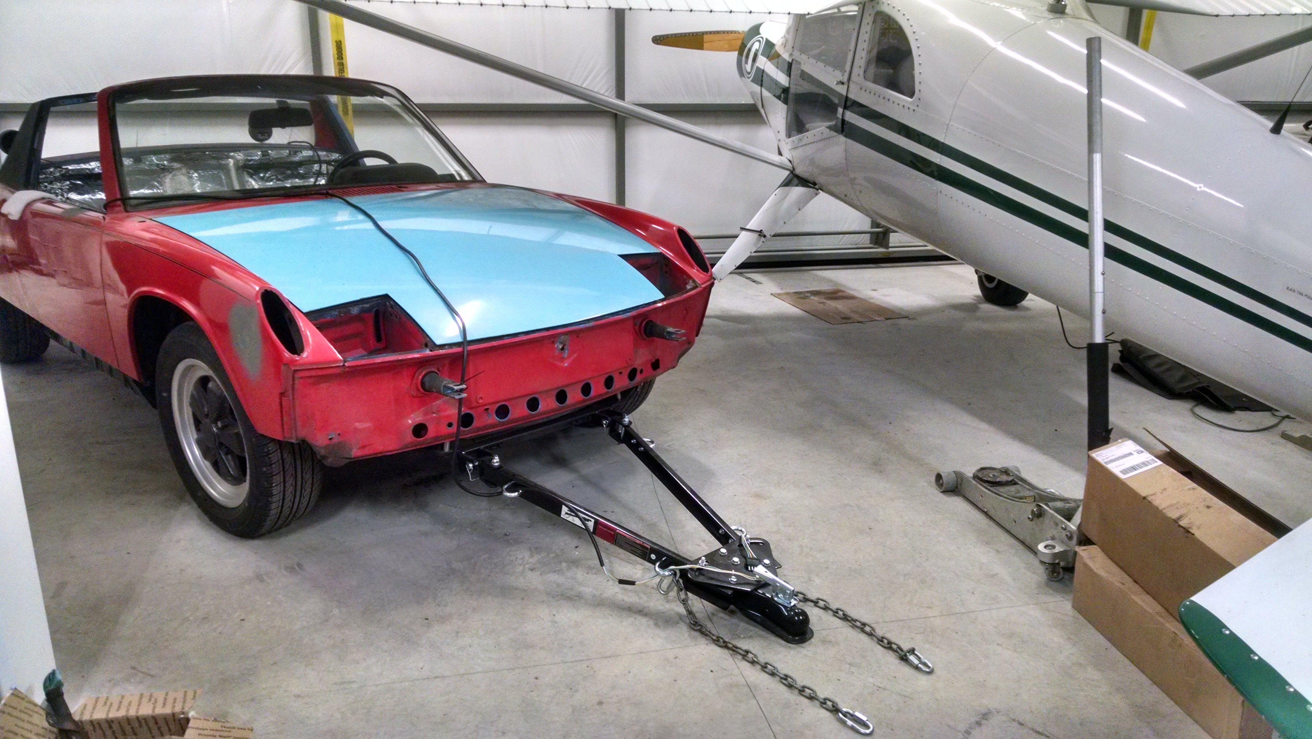

914Werks tow bar with lights all ready to go:

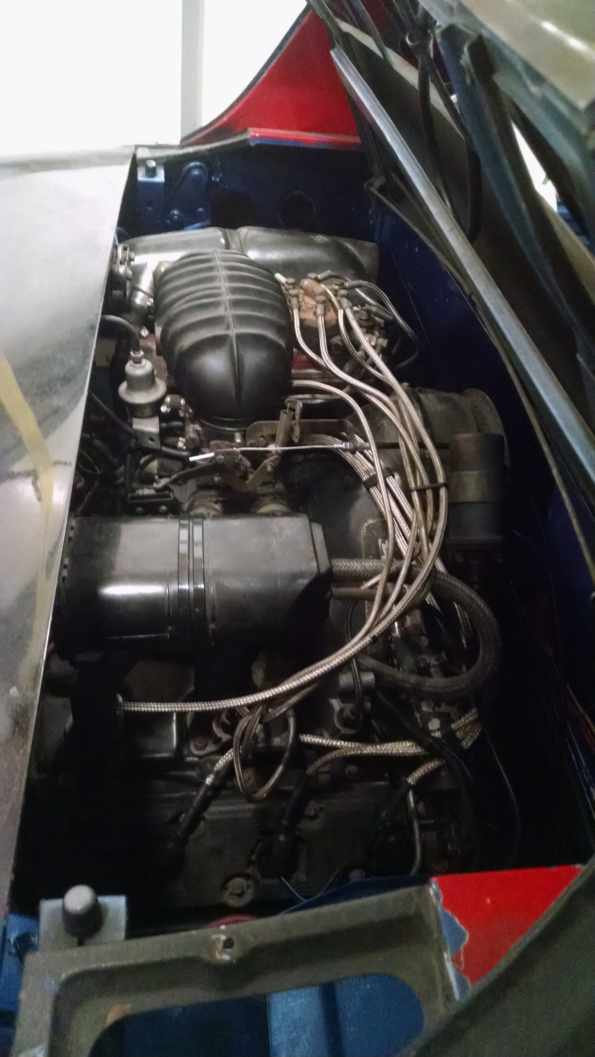

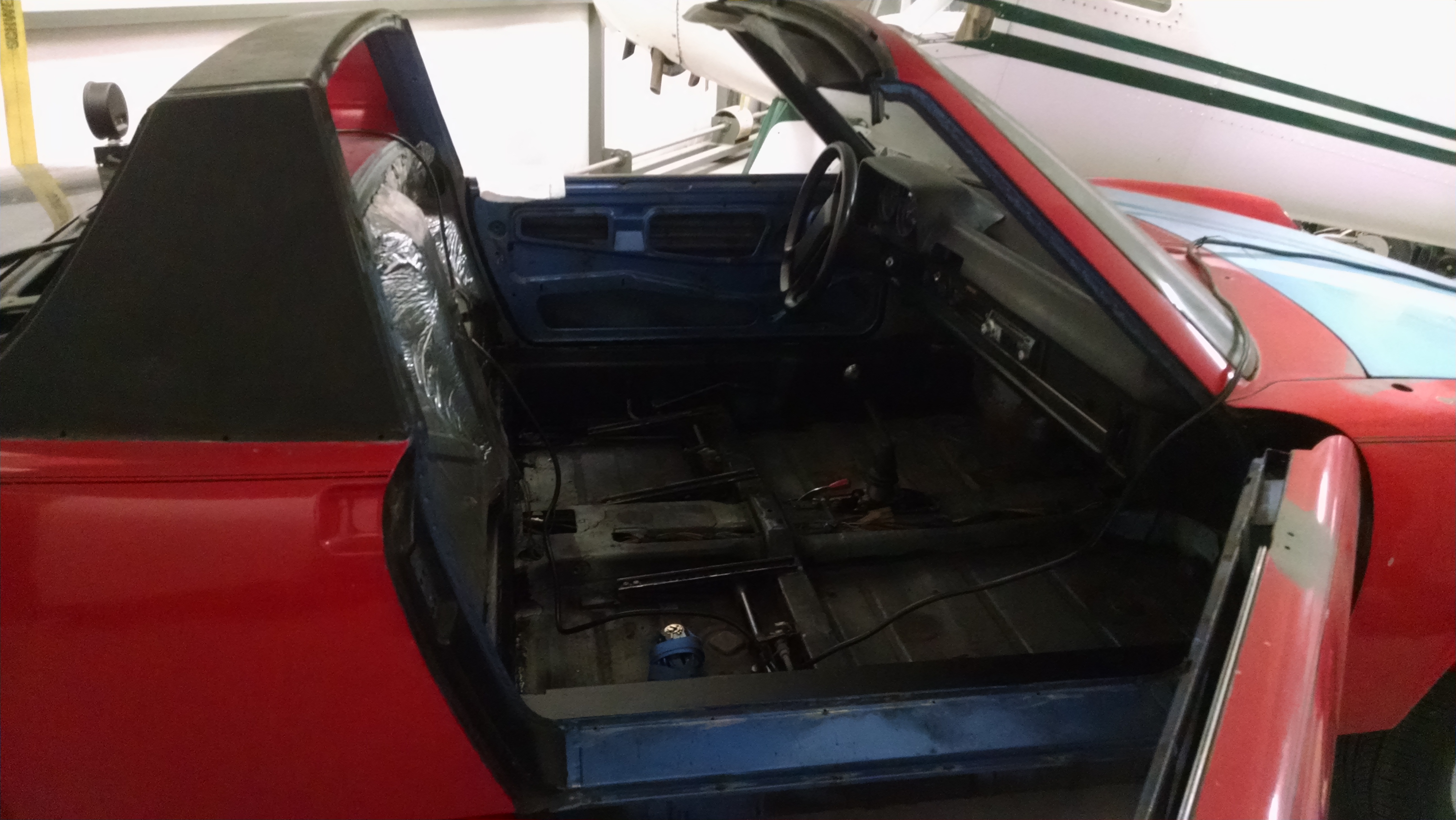

Shaded by an airplane wing, but can see the inner long kit cleaned and painted.
Ran all my cables, new SS fuel lines and evap hose. While everything was out of the tunnel, I cleaned as best I could, poured paint in the tunnel and jacked one end up really high until paint puddled at the other end. Then reversed the process until paint pooled back at the original end. Then stuck modified long stemmed paint brush as far as I could and just smooshed paint everywhere.
Dried for a week, then installed all new stuff.

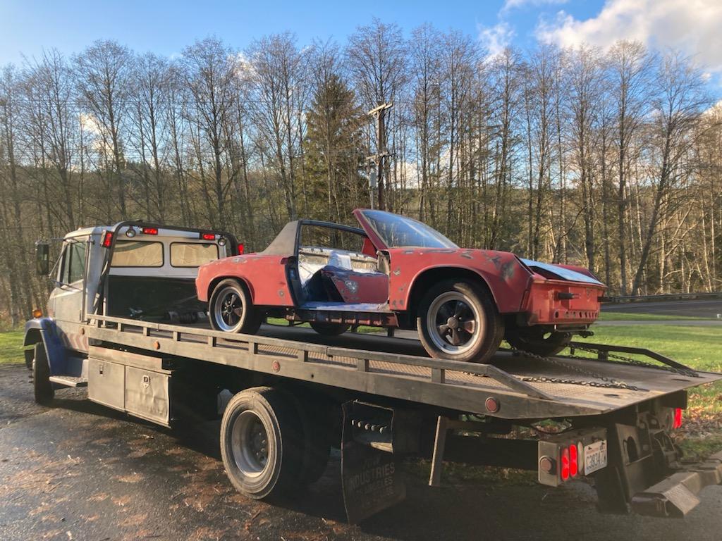

Off we go to our paint guy!

Took two different ferries to get to the paint shop.

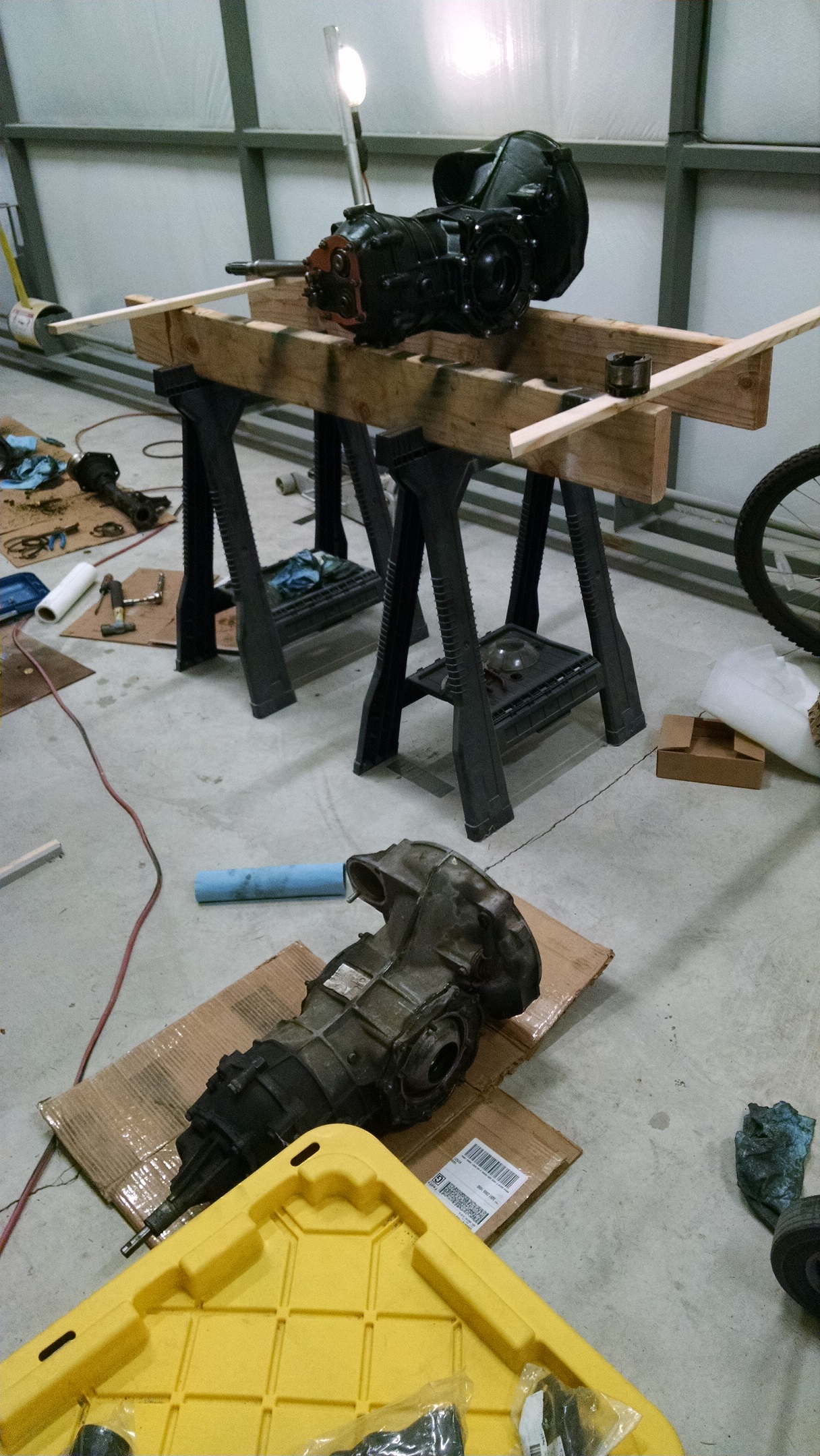

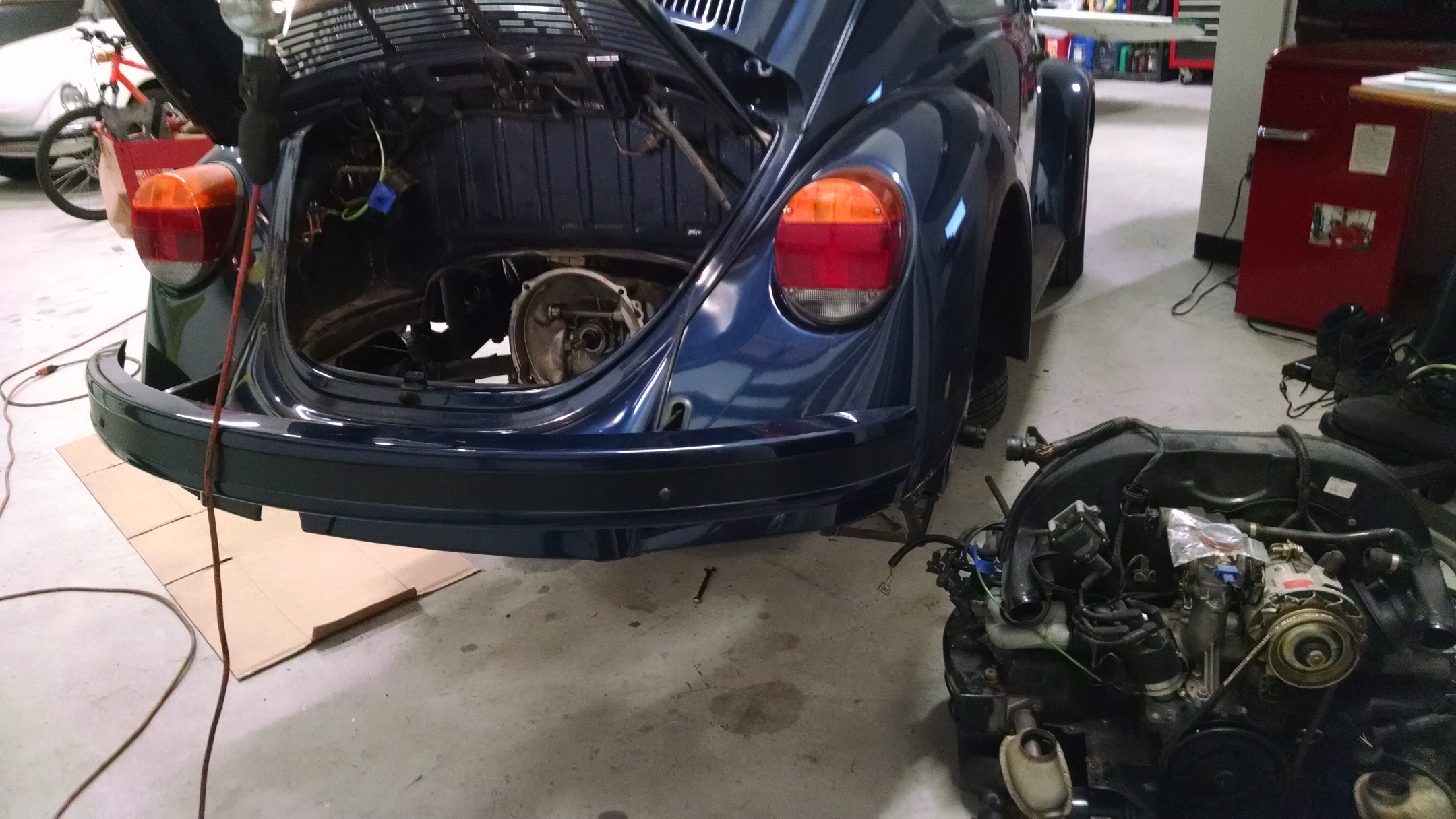

With the 914 gone, I've decided to use the time to swap out the tranny on my Bug. Putting in one of the 4:12 Freeway Flyers from Strictly Foreign. It's been more than a few years since I pulled a Bug engine.

Swapping axels:

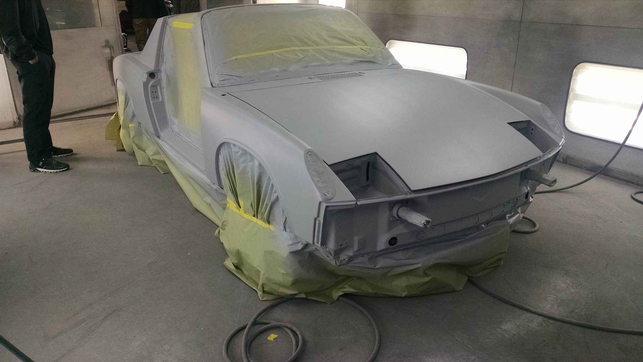

Got a couple of pictures of the paint progress. Told another block sand, prime then paint. 2-3 weeks until finished:
