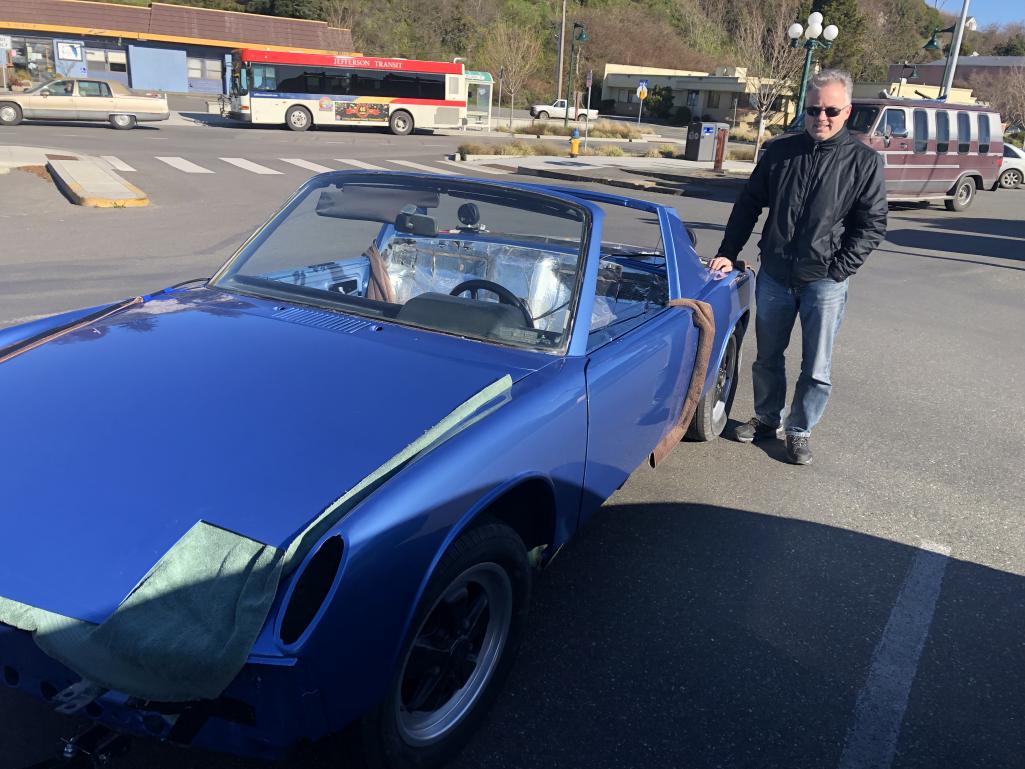

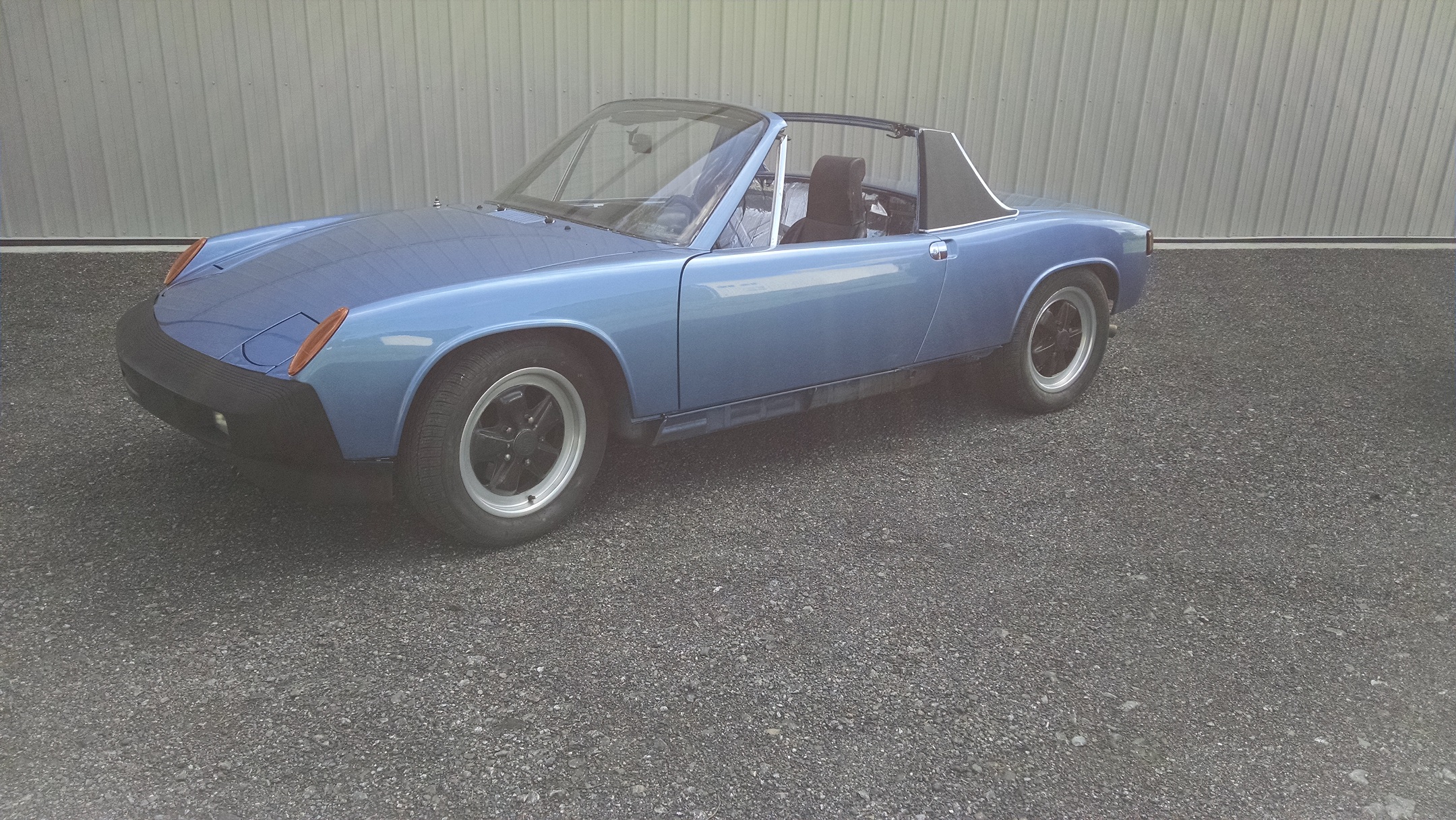

Michelle and I picked up our new to us 914-6 over the weekend. We practiced social distancing and kept safe. Two days home, 920 miles, the 914 never missed a beat.
Here's a picture at a rest stop about 30% of the way home.

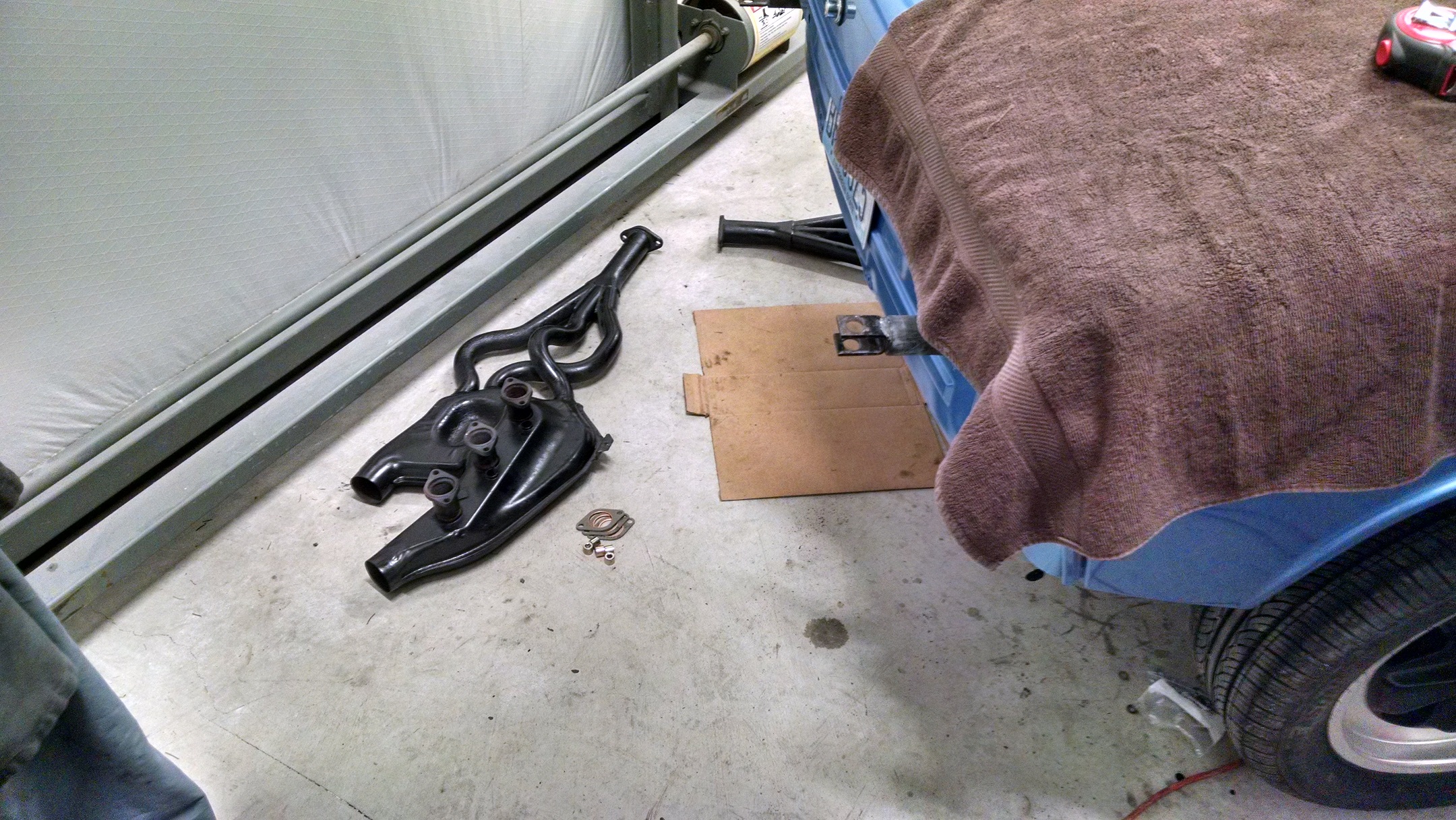

Root_Werks   Picture of the 993 heater boxes. The heater works...   Mar 25 2020, 12:09 PM

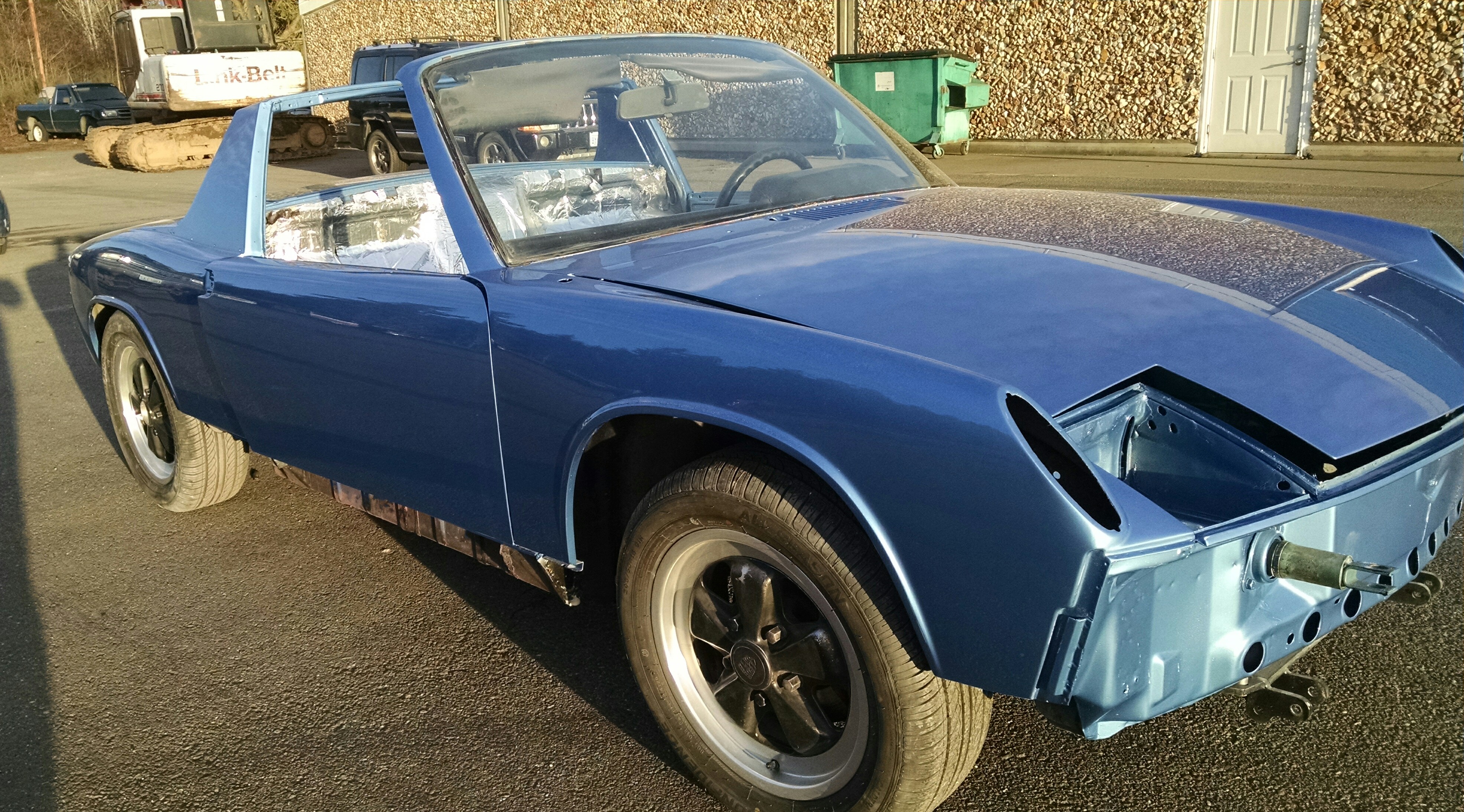

Root_Werks   Sourced a nicer hood as the original hood would ha...   Feb 1 2021, 10:43 AM
Root_Werks   Another picture showing all the colors. :)   Feb 1 2021, 10:51 AM

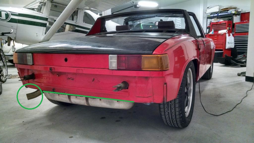

Root_Werks   Going to correct this with a proper welded 90 turn...   Apr 27 2021, 09:27 PM

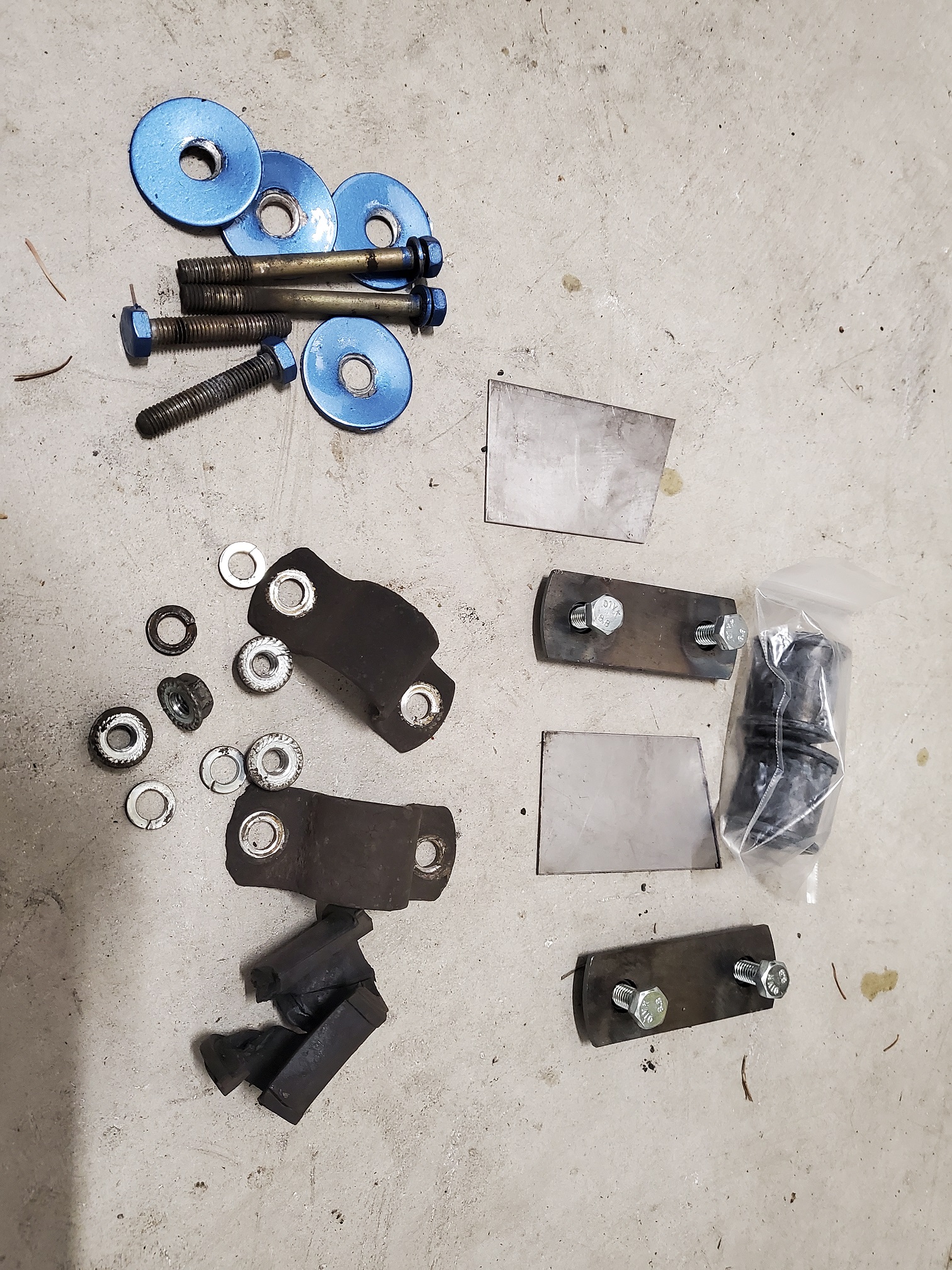

Root_Werks   Pulled the engine to redo some things and replace ...   May 13 2021, 10:02 AM
Root_Werks   Inside the engine bay, you can see the mount plate...   May 13 2021, 10:03 AM
Root_Werks   Had to Dremel, cold chisel and grind for a bit of ...   May 13 2021, 10:06 AM
Root_Werks   The pieces from the constructed mount:   May 13 2021, 10:07 AM
Root_Werks   Maddogs mount welded in place, sorry for the fuzzy...   May 13 2021, 10:08 AM
