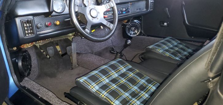

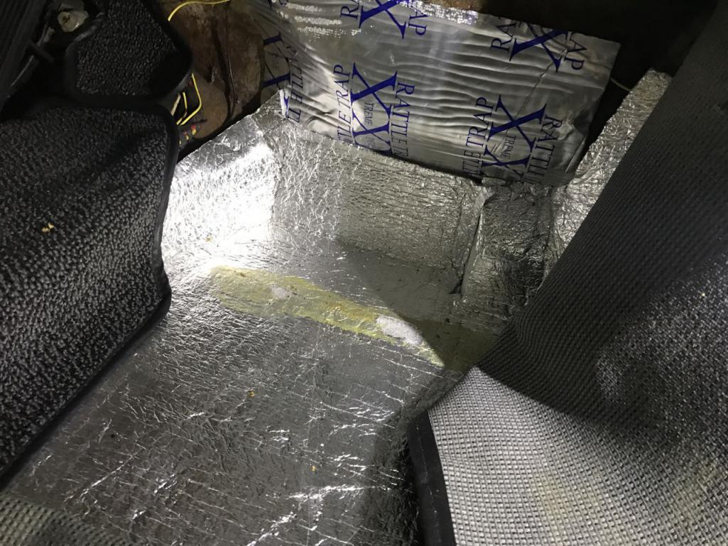

Garland
post May 24 2020, 02:24 PM
Restoration Fanatic
Posts: 1,437
Joined: 8-January 04
From: ......Michigan......
Member No.: 1,535
Went with this one, check out my build page #8
Michigan build

Garland
post May 25 2020, 10:07 AM
Restoration Fanatic
Posts: 1,437
Member No.: 1,535
Loss of About 2 inches On leg room, my wife still requires the foot stool to Be able to reach, and brace her feet against the foot well. I used the integrated amp style finding it produced better base in most cases than a homemade box and separate amp.

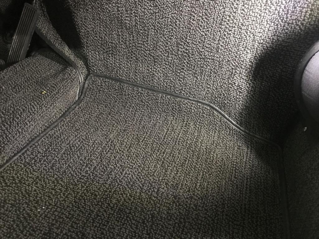

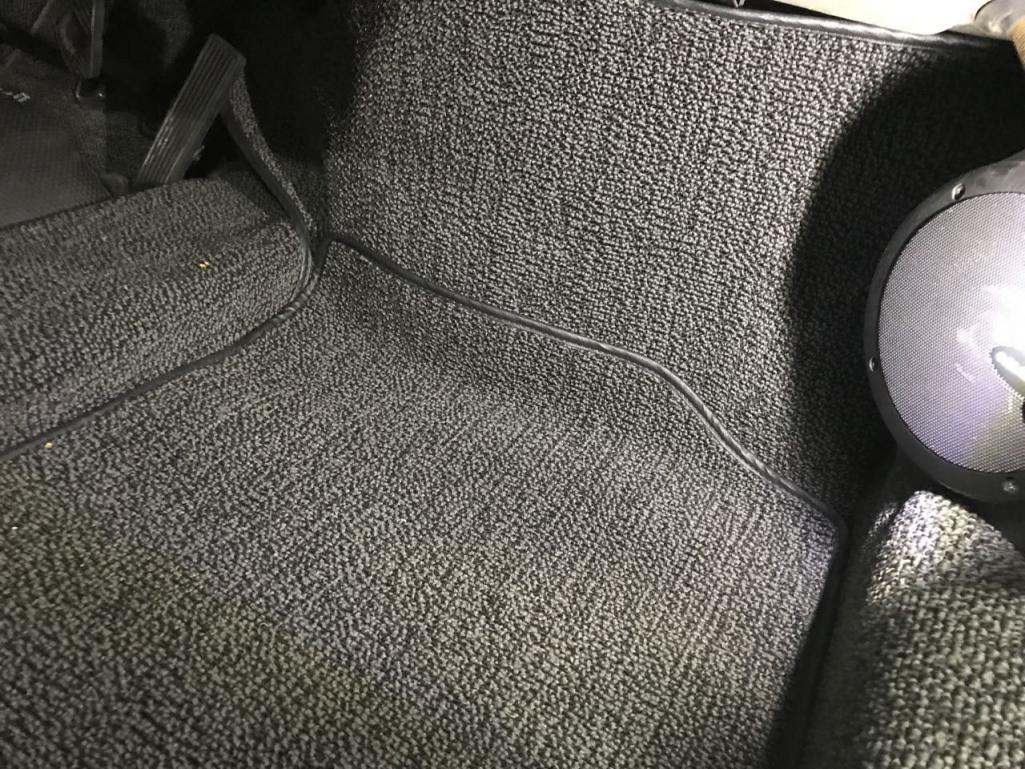

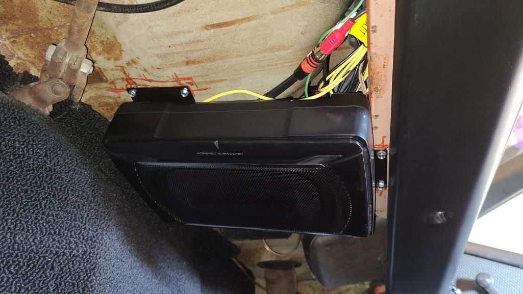

drem914
post Jul 4 2020, 06:27 PM
Posts: 1,080
Joined: 16-May 08
From: Trabuco Canyon, CA
Member No.: 9,062
Well, went with the Kenwood unit. Connected straight up to my existing Blaupunkt head unit. Everything fits behind the bulkhead carpet. So far I just pulled the old foam plug. I still need to clean up the speaker wires a little more before heading out on a driving test tomorrow today.
It certainly fills out the sound from the Polk DB652's in the 914Rubber kick panels. (IMG:style_emoticons/default/aktion035.gif) Will try to post photos once all the wires are cleaned up.

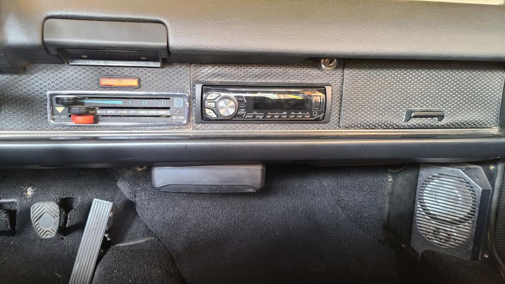

I went with a Kenwood KSC-SW11 unit (looks close to the one you show) hung upside-down under the dash (under the heater controls).
More than enough bass, no lost legroom.

post Jul 7 2020, 05:22 PM
Posts: 492
Joined: 28-February 10
From: Wilmington, DE
Member No.: 11,411
QUOTE(FlacaProductions @ Jul 5 2020, 12:28 PM) *
@sfrenck - interesting approach - any chance of a pic or two?!
Pics of installation under the radio/right of the fan comtrols..
drem914
post Jul 7 2020, 05:56 PM
Posts: 1,080
Joined: 16-May 08
Member No.: 9,062
QUOTE(sfrenck @ Jul 7 2020, 04:22 PM) *
As I am still planning on putting the original center console back in I went the route of going under the front bulkhead carpet

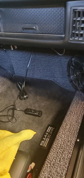

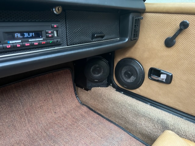

CCE
post Feb 16 2023, 10:22 PM
CCE
Posts: 331
Joined: 28-December 21
From: Mexico
Member No.: 26,203
QUOTE(sfrenck @ Jul 7 2020, 05:22 PM) *
How does this work for the passenger feet? Do they hit it? I Can see in my car the photo you show was in an angle that is not really natural to see, I think it can be very discrete…
I like the solution, very much. Just wondering about the passenger feet.
Please your comments.. here is a picture of mine.
